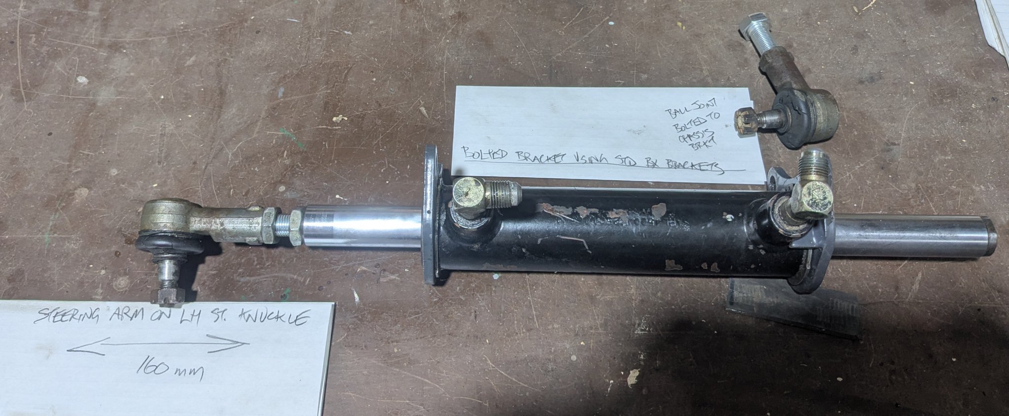

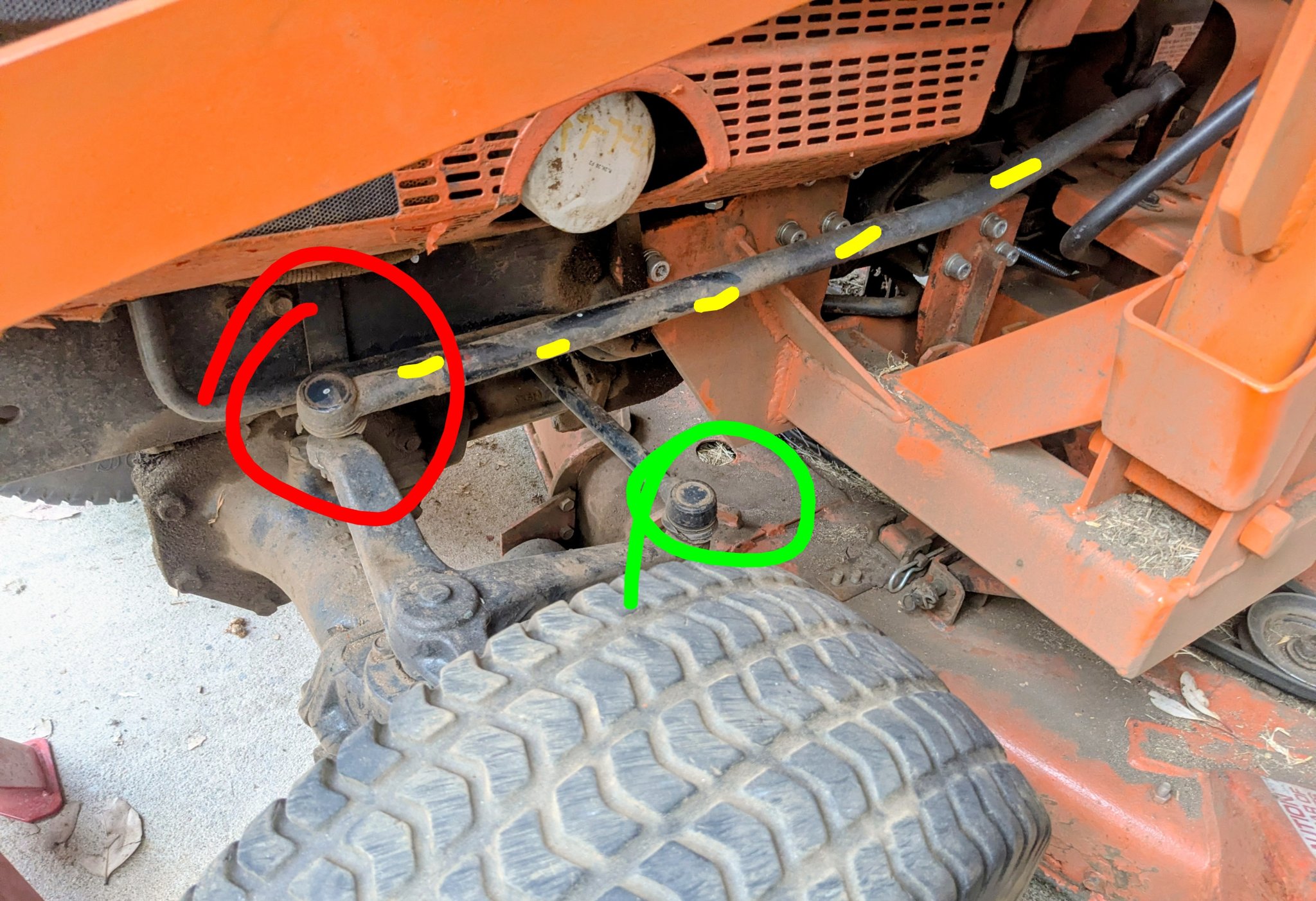

Rather than just looking at it and speculating, I measured a few things....
The full lock to lock left to right travel of the steering connection in the green circle is approx 300 mm.
The full lock to lock forward and back travel of the steering connection in the red circle is approx 150 mm.
The full travel of rod in the double ended steering cylinder is 160 mm, and with the ball joints and tie rod ends fitted it's a bit more than 100 mm longer than the left to right steering link.
I won't be able to swap the left and right steering knuckles as the steering cylinder assembly is too long by a bit over 100 mm and it's travel is too short by 140 mm.
Back to Plan A....
The steering cylinder replaces the dashed yellow steering link with a ball joint attached at the red circle. It's travel is within about 10 mm of the full travel of the yellow steering link. I'll make a bracket that bolts between the standard BX mounting brackets and attaches to the chassis with another ball joint somewhere close to the clutch pedal end. I don't see any of this being overly difficult.
Hopefully some pics of the real brackets when I get around to making them might make more sense than the dodgy description above.
Back to Plan A....

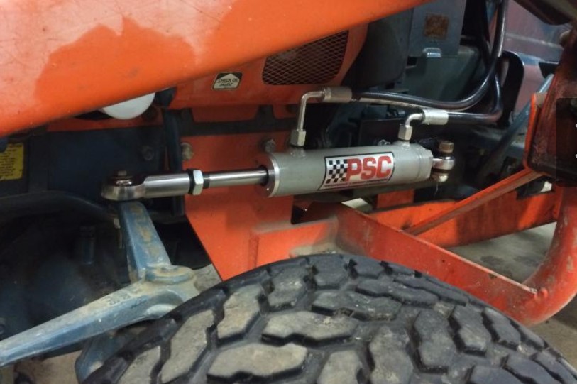

This might be the easier way for you to add power steering.
Thanks. I have seen this video, and it would be an easy way to add power steering for a tractor with a nice strong steering box. The problem with this approach on my tractor is that it would just allow a much greater force to be applied more easily to the input of the small steering box and possibly break it more easily.
