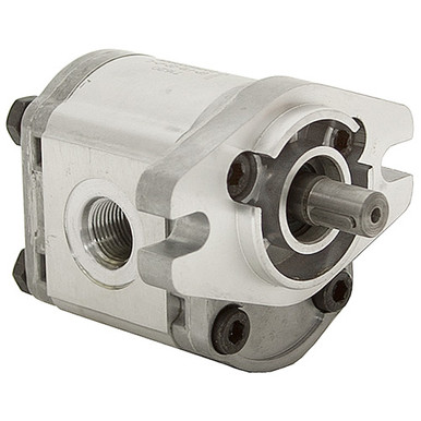

Should be s piece of cake for a guy with a lathe. . The crankshsft pulley on my DT had three theaded holes for mounting a splined male hub. Just turn up a keyed hub to replace the splined Kubota hub and hang the pumo on the frame. Simple and well protected. Easier than the other fabrication projects you have already completed.
You can get a small 2 GPM SAE AA two bolt gear pump that will supply the PS for <$150. They are "tiny^ and max out around 4 GPM.
A much larger SAE A pump would get you a lot more flow and drive the loader but it will be harder to fit in and now you are back to also needing a flow divider.
Thanks Dan - I like your confidence

I think I'll keep it "simple" and leave the loader operating from the original pump and buy a separate pump for the PS. If I make too many changes I'll never finish anything....might never finish anything even if I keep it simple.
