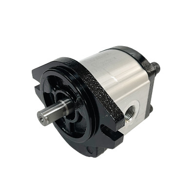

You already have a PS unit. This pump or similar, a shaft coupler, and some plumbing will power it.
G'day Dan - the best price I've found for a similar pump from an Australian supplier is at the following eBay link....
It includes options of 6 and 12 cc/rev. The one you suggested above is about 9 cc/rev.
Does all of the excess flow that's delivered to the orbitrol valve and not used for steering go back to the tank ?
Can I do any harm by having too much excess flow ?
Am I better to choose a higher or lower displacement pump if I can't match the one you suggested ?
Would you suggest tapping into existing lines to use the existing tank and hydraulic fluid, better to fit a separate tank/filter, or doesn't really matter ?

ALL of the flow goes through the PS valve and then back to tank.
The valve will have a flow rating but I have no idea what yours is. Flow ratings are based on pressure drop across ths valve and desugners typically aim for just a few PSI. That does not mean the valve cant handle a higher flow. Higher flow simply increases the pressure drop which wastes energy (HP) in the form of heat. So a little higher is fine but 10X would be a bad choice. I would suggest you lookup the PS flow specification for the donor tractor and use that as your target.
The pump I linked is a SAE AA form factor and yours is SAE A which is physically much larger. I suggest you look for an SAE AA pump - much easier to fit inti the soace you have avaikable and they will be smaller displacement as well. You should have no problem finding them.
I think Concentric is a prominant brand in Europe. There are a couple others but the names escape me at the moment. I dont know what AU import duties are like but I have no problem shipping a pump to AU.

Haha - I didn't notice the "A" - thanks. I'll keep looking and see if I can find out the donor tractor model.

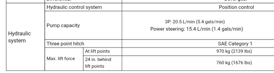

The hydraulic steering components are from a BS2230. I found the following specs:
The power steering flow rates in metric and imperial units in this table don't match - 15.4 L/min doesn't equal 1.4 gals/min, so there's a typo somewhere....
- 15.4 l/min = 4.1 GPM (so is the 1.4 typed backwards ?), or
- 1.4 GPM = 5.4 l/min (so has a 1 been added by mistake ?).
Which do you think is the correct steering flow rate - 1.4 or 4.1 GPM (5.4 or 15.4 l/min) ?

Good attempt at resolving the error but you really got messed around by both being typographical errors that “were close” in both cases.
I would ASSUME that the l/minute is correct since Japan is ”fully SI”.
But good luck in your quest. @TheOldHokie may have the information handy???

Good catch. A quick review of some other BX models indicates priority flow of ~2 GPM. That sounds more lijely than 4 GPM which is the implement side. Too bad you cant measure pressure drop before buying a pump. Hint, hint

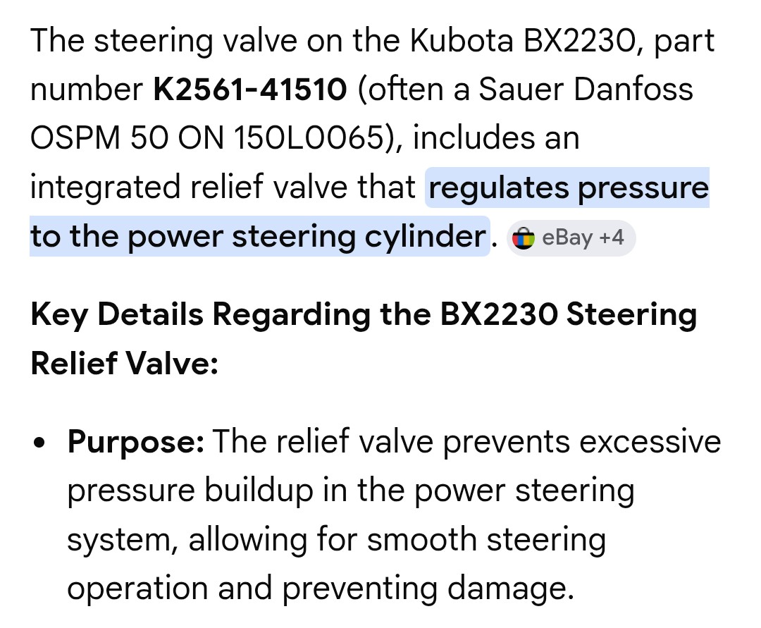

I can't find much info on the steering valve, but found this from a Google search that states that the steering valve had an internal relief valve....
The "max flow the PS controller can handle in neutral" - is there a maximum pressure drop that goes with determining the maximum flowrate, otherwise what determines the maximum flowrate ?

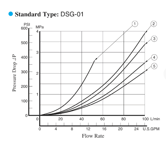

I dont want this to fester into a "paralysis by over analyisis" discussion as happens all to often here. You just need a pump big enough to provide enough flow at idle but not so large it generates excessive heat at 2200 RPM.
That said max flow specifications are subjective numbers. One OEM might use 20 PSI drop and another might use 50. In real life the system designer has to make the final determination based on the overall system configuration. In an open center system ten valves ganged together is a far different situation than one.
In this case I doubt 2 vs 4 GPM is going to be significant in terms of pressure drop in your little one valve circuit. But absent a reliable specification what I would like to see is a pressure drop curve for the valve to sanity check that WAG. Here is an example. These valves are used in applications as high as 20 GPM but more commonly 8-12 GPM. Curve number 2 is the P->T situation we are discussing. If you want to go to the trouble you can measure your actual pressure drop up to 4 GPM using your tractor as a test rig. Its not a lot of extra trouble and what I would do because I hate guessing but I am not you.

I found a Sauer Danfoss part number along with the Kubota part number on a US parts supplier site, and from that found the tech manual covering the steering valve. This included the pressure drop vs flowrate graph below:
The applicable model is the OSPM 50 ON so it's curve 'B'. Approximately 25 psi pressure drop at 8 l/min, and 50 psi at 12 l/min.

Forget lock to lock. At 3 GPM the pressure drop P->T is less than 50 PSI. Plenty of flow and well within the requirements of the cylinder.

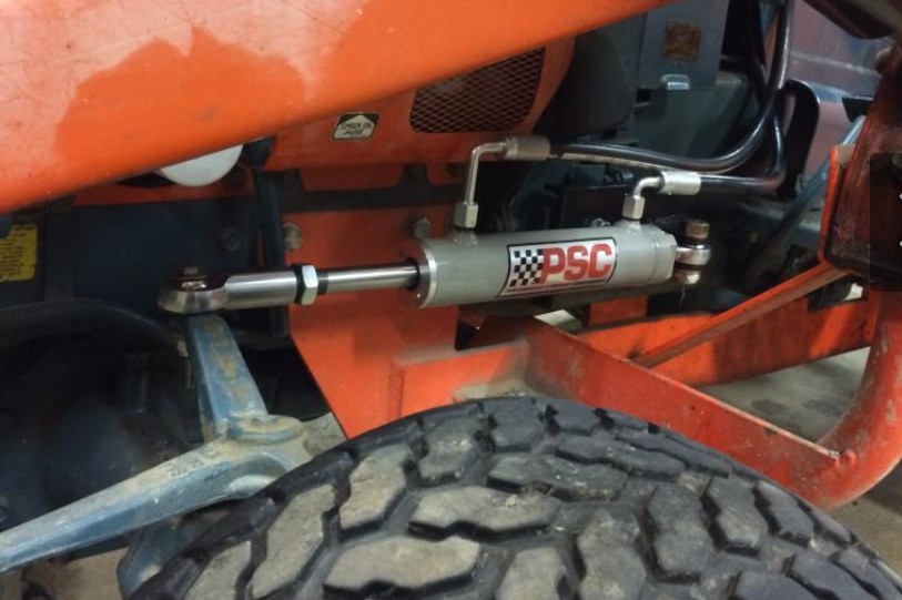

Steering cylinder mounting
I found this pic in a 2016 thread by @hipper (don't know if he/she is still around) covering adapting hydraulic steering to a B7100.
This looks to me to be also the easiest spot to fit the steering cylinder on my B7200. There are no steering arms in front of the axle where it normally mounts on a BX, and I don't reckon there's enough room to put it behind the axle due to the front drive shaft.
The mounting bracket will have to look a bit different as I have a double ended cylinder, but I don't think that will be a problem. On the plus side, the double ended cylinder will give me even steering left and right.
I'm open to other thoughts, so please chip in if you have an idea.

I havs a vaque recollection the OEM kit had replacement steering arms. Might want to look at the parts book for inspiration.
Here are some pump pics. Its an old "unibody" Ford which was a PITA. The box frame on the B7200 should make things a lot easier.
1000004759.jpg 1000004761.jpg dry

Any reason I can't simply swap the steering arms (red and green arrows) from side to side ? I'll have to measure properly tomorrow, but they appear to be parallel (I would have expected them to be angled a little inwards). This would allow the steering cylinder to mount to the front of the axle as in a BX.
