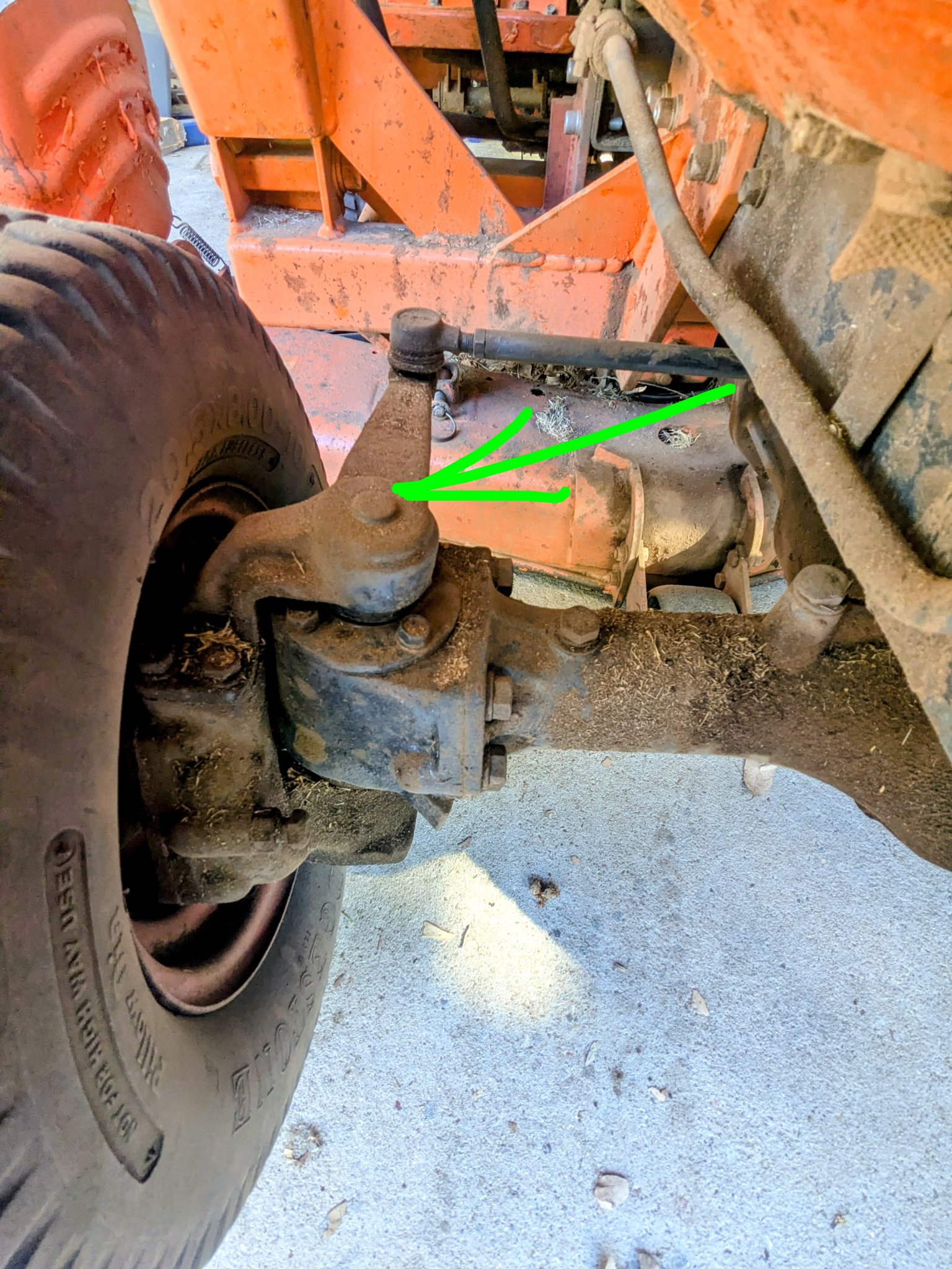

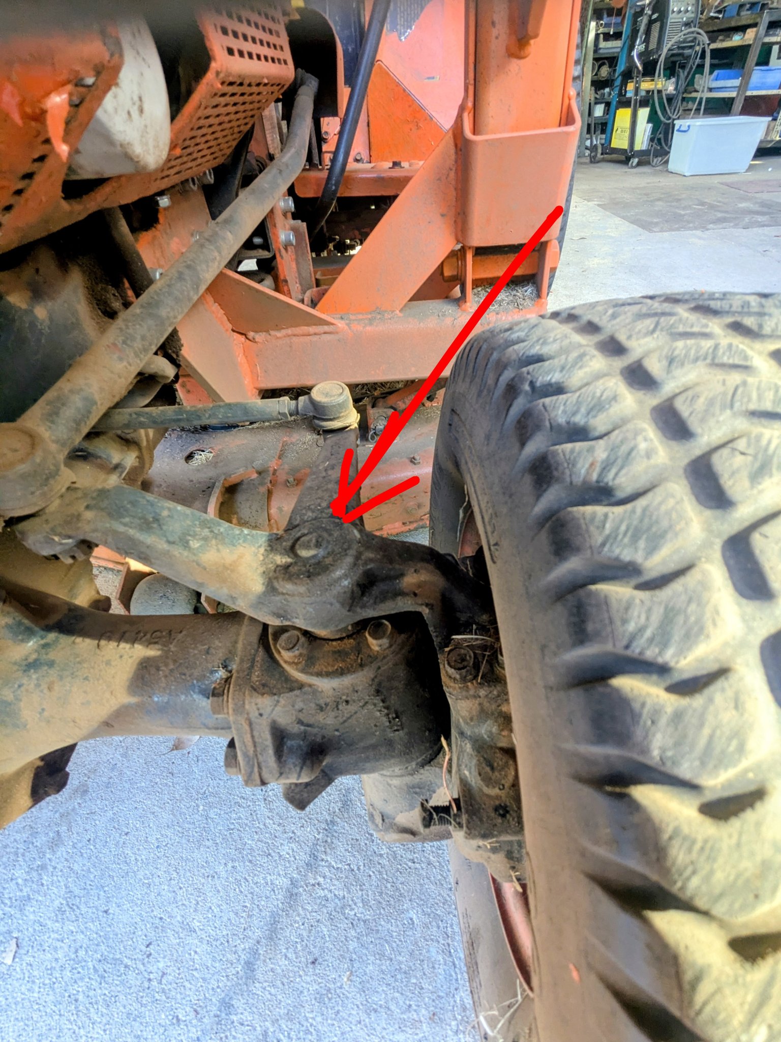

Any reason I can't simply swap the steering arms (red and green arrows) from side to side ? I'll have to measure properly tomorrow, but they appear to be parallel (I would have expected them to be angled a little inwards). This would allow the steering cylinder to mount to the front of the axle as in a BX.

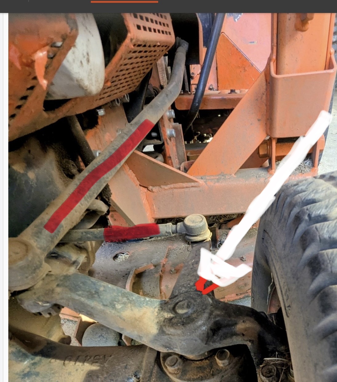

I believe it is supposed to be mounted transverse to the direction of travel. As I see it, you need to remove these two rods on the existing steering system.
The steering cylinder should replace the lower tie rod bar. But I am not that familiar with what you have and how it works really so I may be way off base. I think that the cylinder must be mounted rigidly and the rod has to move freely.

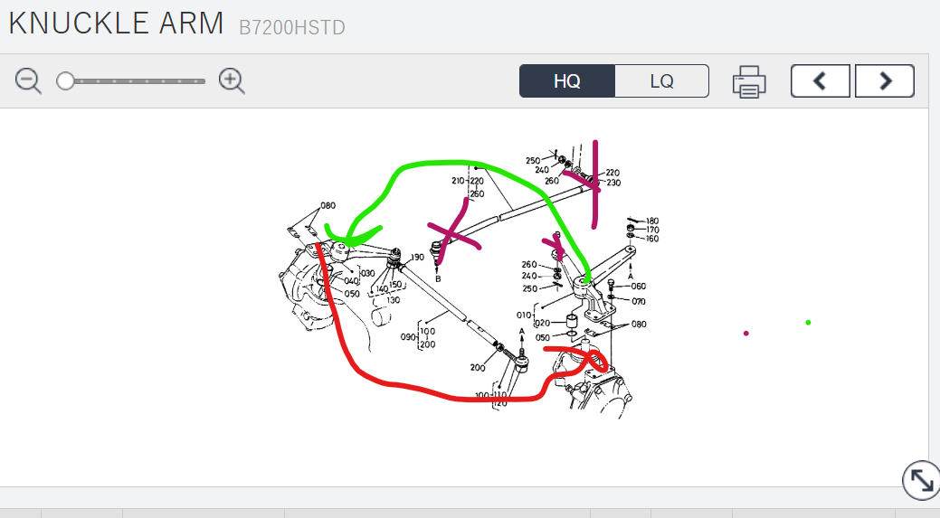

Problem is the knuckles in a B7200 are designed to be driven from just one side. The steering box drives the left knuckle. The left knuckle then drives the right via the transverse tie rod. The double ended BX cylinder isnt well suited to that.

Thanks Russell, but I don't see why it wouldn't work. The long arm is pushed in and out by the existing mechanical steering box to push the arm on the steering knuckle back and forwards.
Replacing the mechanical steering box and this long arm with a hydraulic cylinder would do the same thing. If I go this way I just need to mount it so that an end of the cylinder is "fixed" with the rod allowed to move. Not as easy as mounting a single ended cylinder but I don't think it's impossible. And it still gives the benefit of even left and right steering.

I dont think that cylinder changes length. The barrel is fixed and the rod shifts left and right pulling and pushing the two knuckles.
Yep. So if I fix an end of the barrel to a bracket I'll make, the rod will move in and out and push or pull the left side steering arm. I'll just need to allow the barrel to pivot but not move back or forwards with the bracket. Probably re-purpose one of the tie rod ends.

Take the left knuckle and move it to the right, and vice versa, ditch the drag link and the tie rod and install the cylinder in the front of the axle.
Haha - glad you're keeping an eye on this and thanks for the suggestion....same as what I posted as a question above at post #60. Makes me feel good when someone who knows stuff makes the same suggestion as me.

Dang, I read back 2 pages playing catch up, and that was one more page back on the 3rd page.
I think it should work, the B7100 uses the same setup, yet the drag link is in the rear and the tie rod is in the front.
