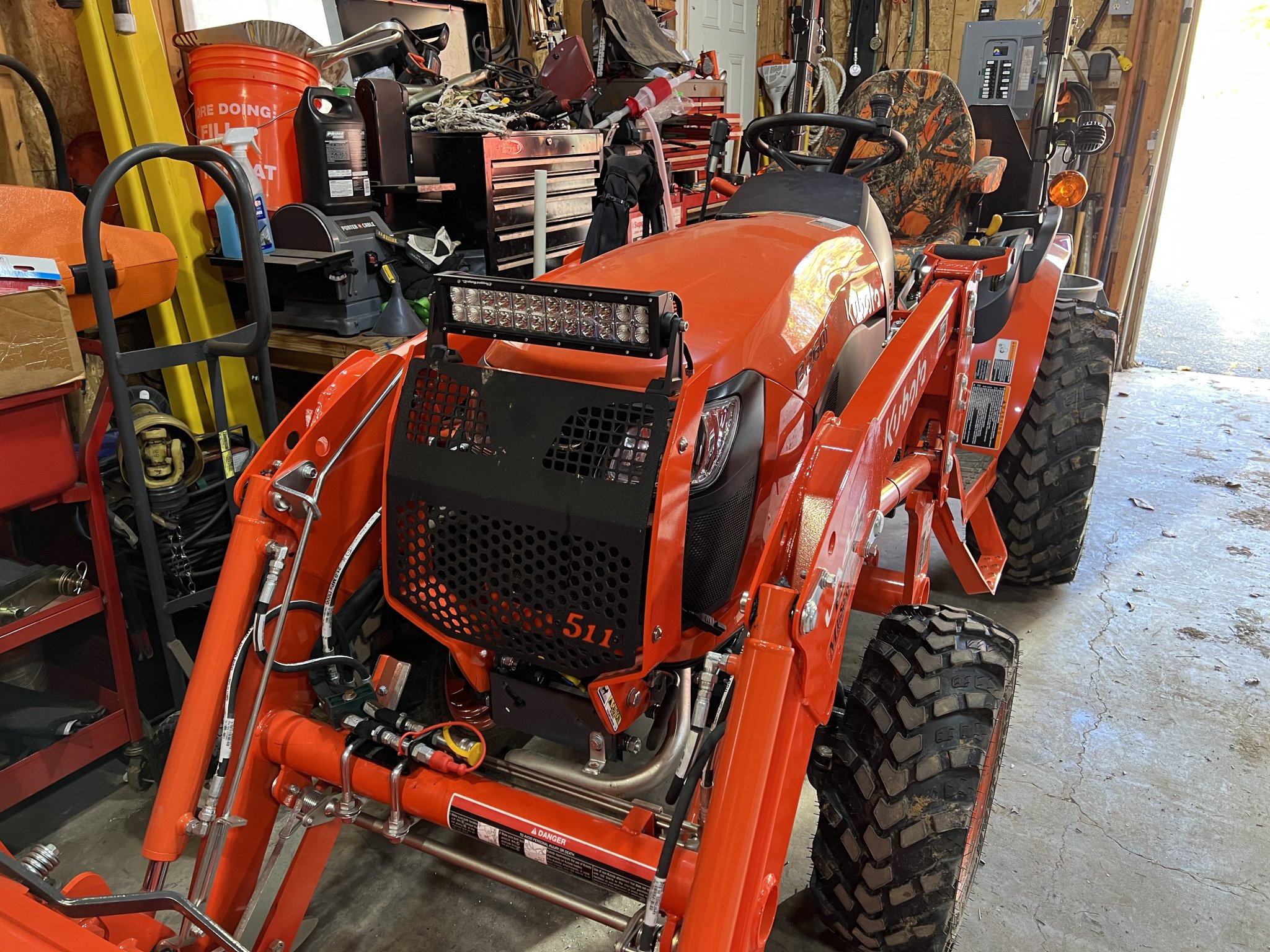

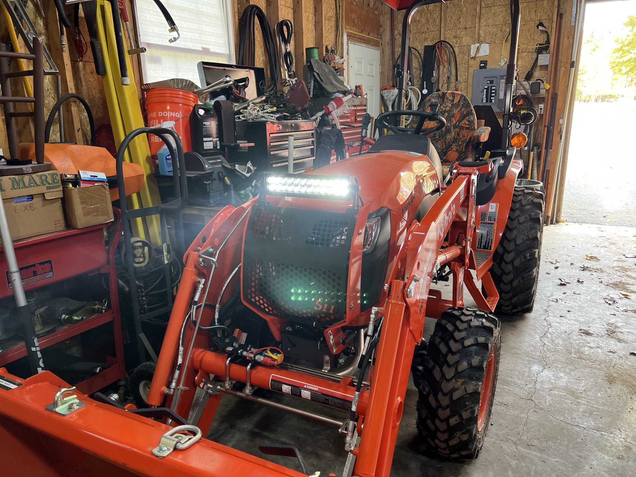

Added a LED light bar to the brush guard since it covered the original lights.

I have the same guard so I added lights to the ROPS. While the guard might look nice, they didn't allow for the fact that the head lamps shine to the side as well as up and down. The guard should have at least another row of holes all the way around each headlight provision. 511, you can send me a freebee for the suggestion.

How much does that light bar obstruct your vision during operation with the bucket?

It don't really obstruct my sight because it's right in the middle I'm used to knowing where things are from the sides I also have a level indicator. I have ROPS lights too that I can swivel to use shining front or rear if I want to.

Yeah I have a set of ROPS light that can swivel 360 so I can use them front or rear. I like the brush guard but like you said it messes up the lights. I took the bulbs out of the original lights and use the factory switch to energize a relay to pickup the LED light bar.

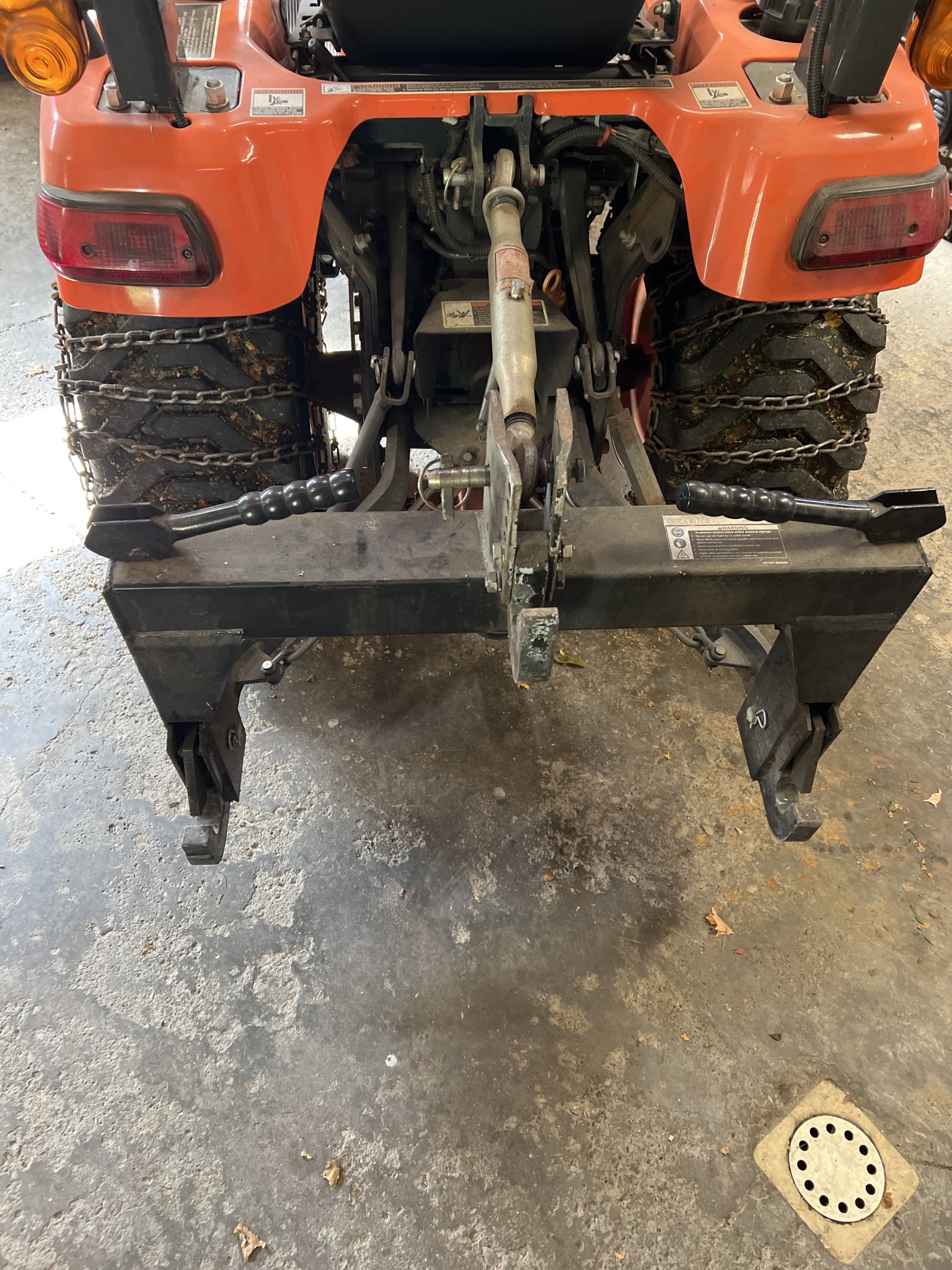

Leaves are down, so chopped them up, pulled mower deck and put chains on.
Lot nicer putting chains on at 60 degrees than 30…..😉
They still need to be “run in” as my Dad calls it. Will take some adjustments after that.
10,183
7,075
Done - took a little tightening on left side after running them in.
A BX without spacers doesn’t allow much room. Need to keep them tight.
These chains have stretched a lot last couple years. They’re about 10 years old now.
The double-ring chains on my old Moline are almost 70 years old…..pretty thin, but they work.
