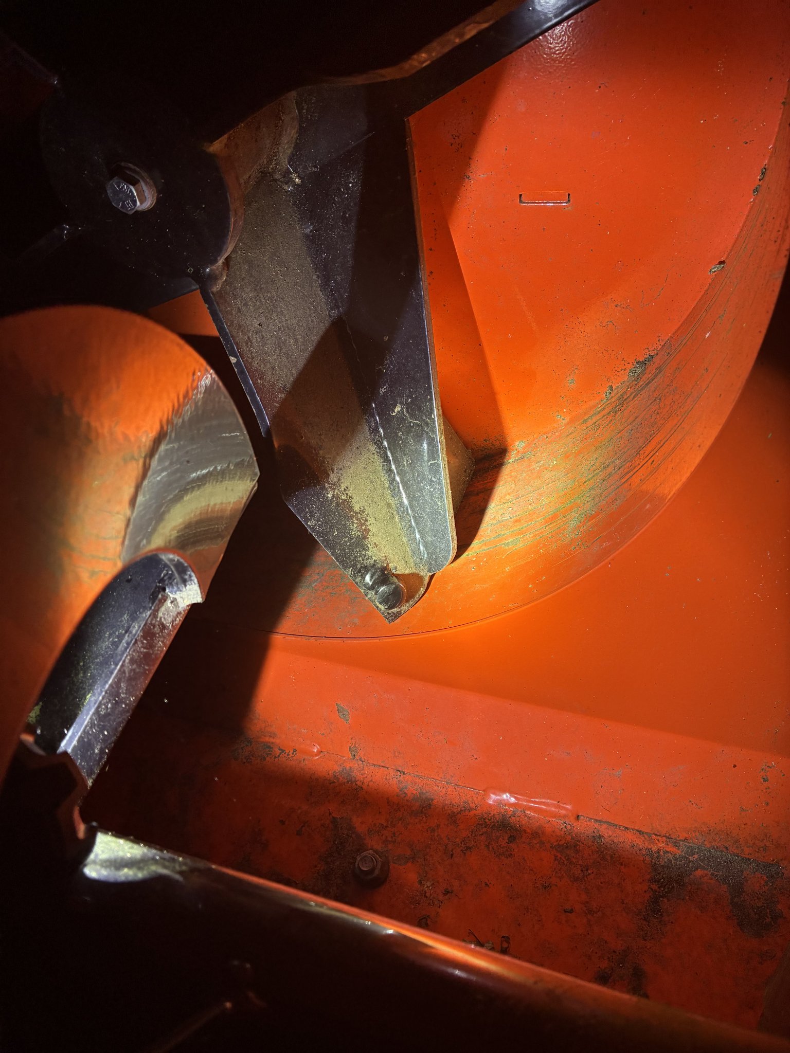

By "propeller" he might be referring to one of the augers. But who knows, a picture would certainly help.

In addition to the shear bolt on the driveshaft I also have shear bolts on the shaft that goes from the gearbox to the chain sprocket and another one on the, what is called in the manual the "fan". This may be what he is referring to.

Thanks for the picture. That is the fan. It looks like something welded to the tip of the blade, perhaps to balance it? It does not look like anything you could torque. There is likely a shear bolt thru the fan to shaft junction that would be torqued to a spec.
nbryan
Jan 3, 2019
1,432
950
Hadashville, Manitoba, Canada
No, it’s on the fin itself. Only on one though. Manual talks about torque it to a certain amount.
If the manal IDs it then follow the manual. I can't see any mention of it in the parts diagrams available online for that blower. Only for the impeller fan mounting bolt.
My guess is for balancing it? Maybe ask a dealer what it is? That's a weird way to balance something that's going to wear it smooth and maybe even have a rock or something break it off?
I'd add some welds if it needed a balancing.

Yeah, went back and read the manual again. Misunderstood what was said. Would have been nice to identify it in the manual to let users know what it’s for. Thanks everyone for helping me on this.

My guess is also a weld to balance the impeller. It's at a good place (back of the blade) so nothing should affect it.
