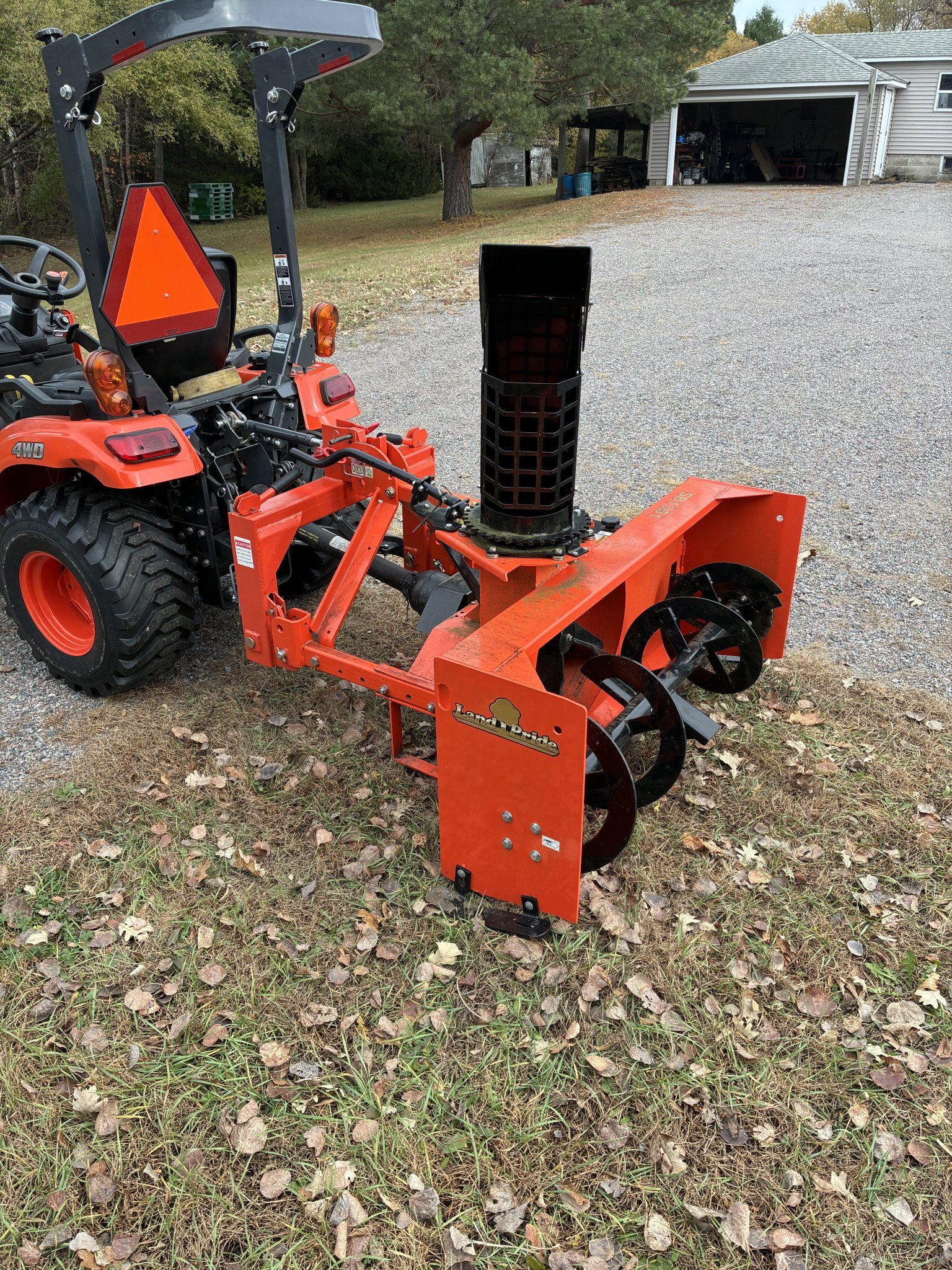

Brought it home this morning.

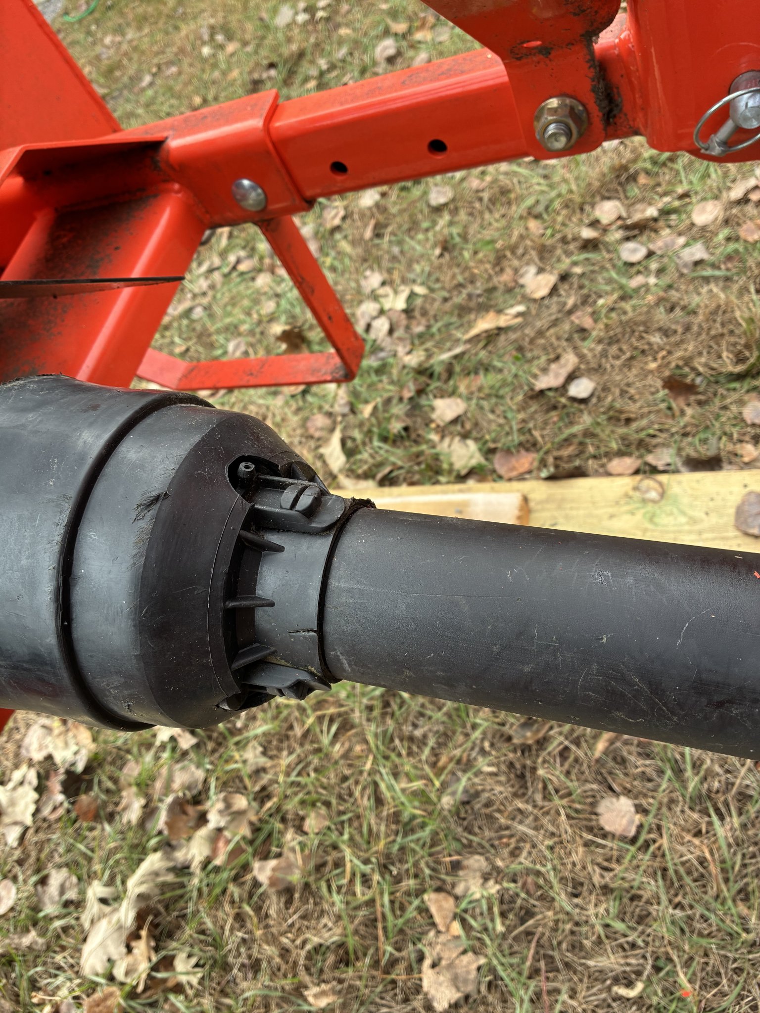

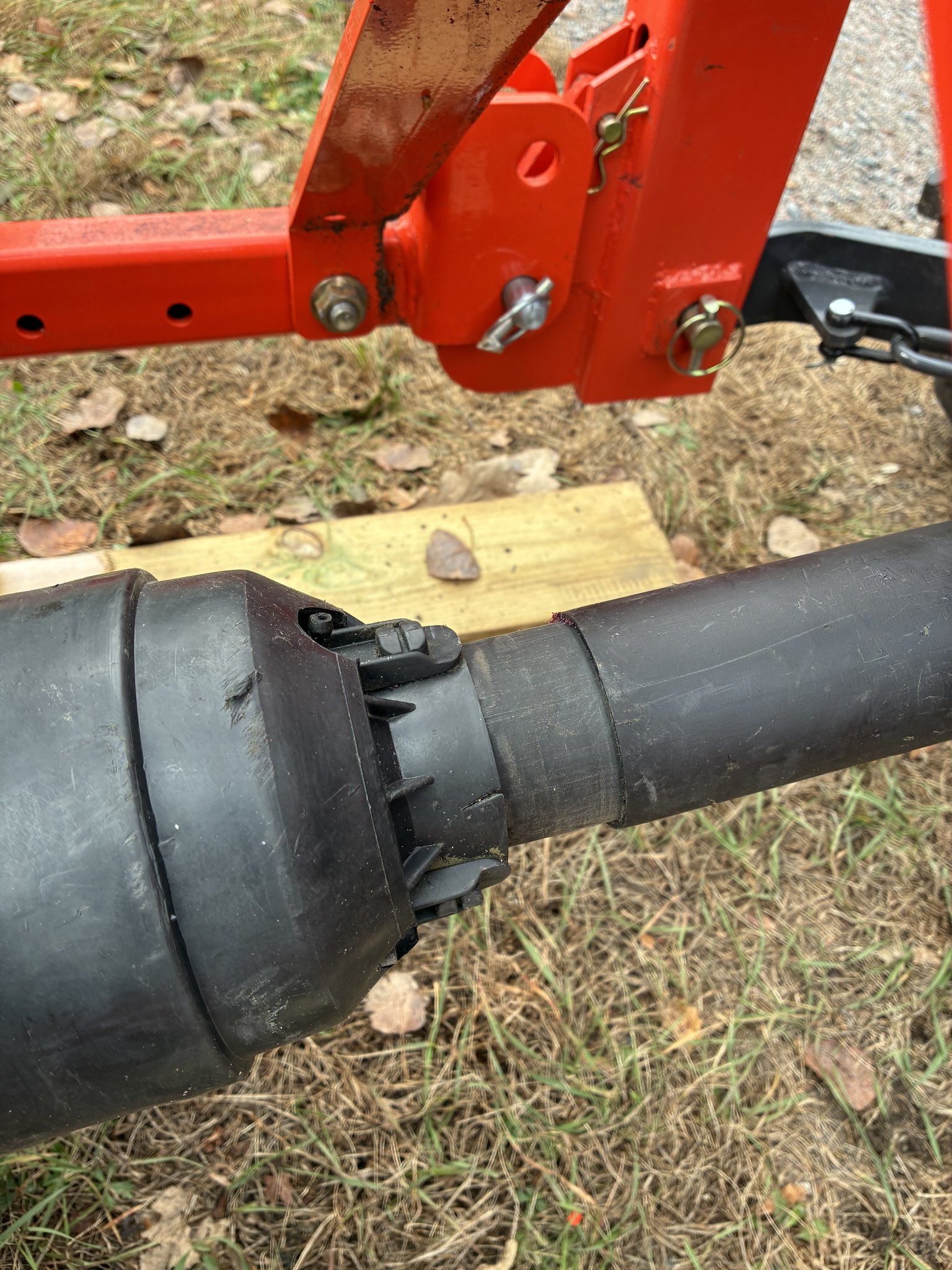

No manual so need to find one. He let it sit out back for almost 2 years. Just finished greasing it up. Use chain bar oil for now on the chain, which needed it. 2 zerks on each side of the auger popped off greasing it. Copper. Will replace them tomorrow with better ones. Here are some pictures of the shaft lowered then 2/3rds up.
will I need to cut the shaft or can I leave it and remember not to lift all the way up?
View attachment 164908 View attachment 164909
If it's too long, cut it so you don't forget.

So how do you cut it? Hack saw? Do you do like 1 inch at a time until it fits when raised all the way? My 1st time dealing with this so don’t want to end up buying another shaft.

Without you having the manual, I don't want to mislead you so I will leave that the more knowledgeable people on this site.
You should be able to find the manual somewhere; it will be valuable information overall.

read the manual. Now I know what needs to be trimmed. Also saw I missed a few grease zirks. Will be calling the dealer for those shear bolts. Hopefully he has them in stock. Thanks everyone for your help.

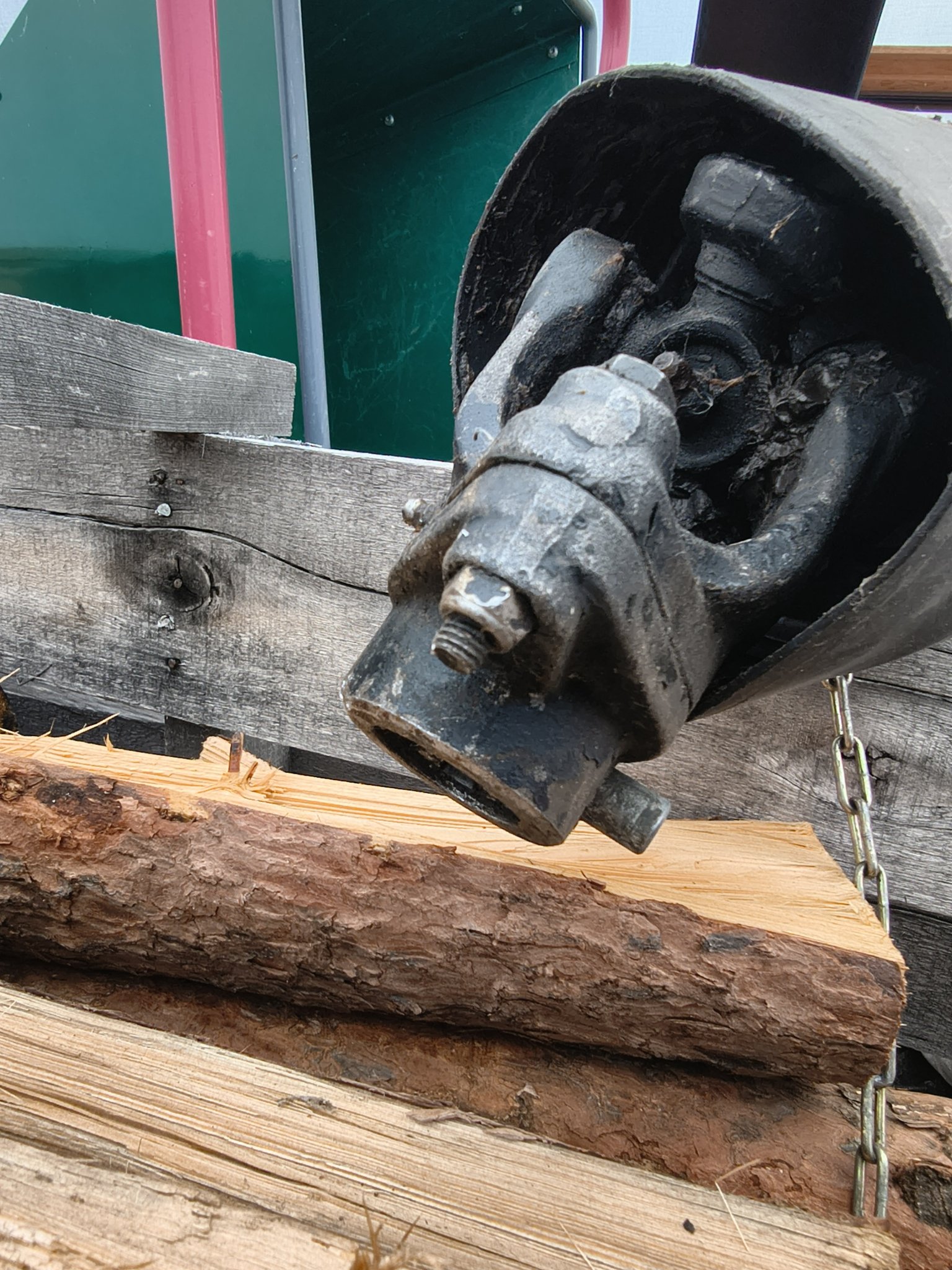

What is that bolt or nut thats on the propeller for? Only on one propeller.

If by "propeller" you mean one of the the u-joints? Where the PTO shaft connects to the tractor and blower?
without a picture of what you mean exactly, I'll guess it's this PTO driveline shearbolt at the implement end?
Sure, get a couple of them, too. Tractor protection in case the implement input shaft seizes up for whatever reason.
It's also important to avoid subbing in replacement bolts with standard bolts even if equal hardness rating. Most all shearbolts have a machined groove at their designed-for implement's shear point.

Adding that the direction the shearbolt is inserted from must also be correct in order to align mentioned relief grooves at the shear plane.

No, it’s on the fin itself. Only on one though. Manual talks about torque it to a certain amount.

If you mean the protrusion on the piece with the splined hole that is bolted to the u-joint as shown in the pic above, that is the shear bolt as nbryan mentioned.
