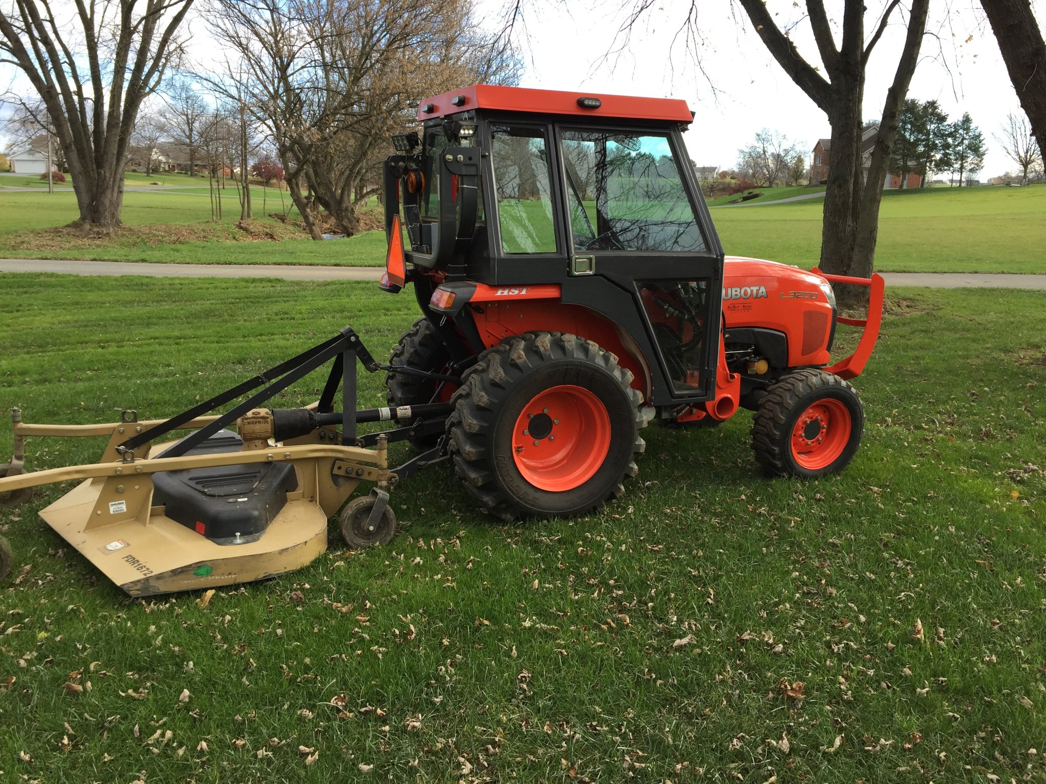

Got a picture ?
A bunch. Two versions of the build are below.
If you're bored, more detail here:
Abbreviated version:
Your cab looks fantastic

That is a great cab build. You should be making cabs for a living. Not sure the costs to build it but you could make a living building cabs. Congrats on a good job building it. (y)
It's a fantastic build -- very professional.
But if he tried to make them for a living he'd have to compete with all the internet forums complaining nice cabs cost too much.
$1,200 materials + 120 hours x (say) $40/hr = $6,000 right there with no provision for overhead (like heating the shop and powering the tools) or shipping or insurance or ...
