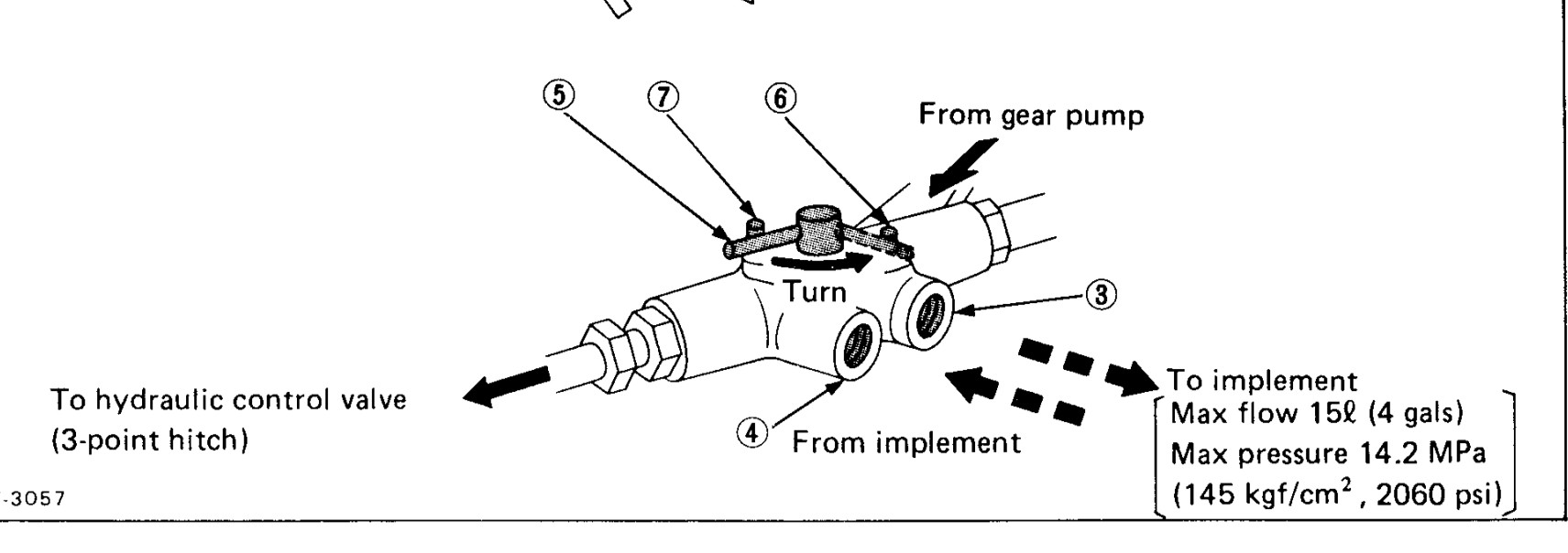

  3. To determine tractor side relief setting the gauge must be connected to the outlet block
  4. Once you have adjusted the tractor relief you can move the gauge to the PB port on the loader and measure there. If its lower than the tractor side the loader relief is set too low. Adjust it upwards until you get tractor side pressure at the PB port. Af that point the loader may be set higher than the tractor side but it does not matter because the tractor always has prority.
Once you have pressure set per the tractor specifucations you are done. Maximum lift is whatever your loader geometry produces.

Many thanks yet again Dan. When you say outlet block, are you referring to the right hand port labelled 3 in the attached pic ? With a gauge connected here, does it matter that there will be no flow, or is that taken care of by the relief setup on the hydraulic block ?
That whole assembly is referred to as the hydraulic outlet block. The right port is pump pressure OUT to the implenent and the left one is return pressure (IN) from the implement.
To measure the relief pressure setting in the block you MUST cut off the flow and force the relief valve to open.
To measure the relief setting in the loader valve you do the same thing at the PB port on the loader valve.
All that takes is a 3000 PSI pressure gauge and appropriate fittings - $30 or less.

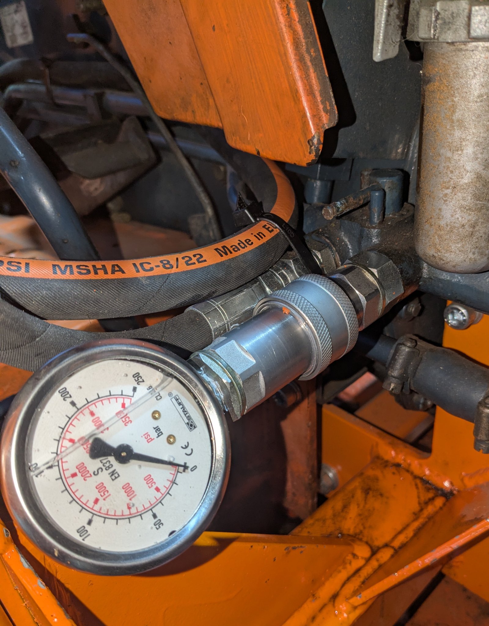

Picked up some fittings today and made a start on checking pressures this evening.
I was interested to see that the engine was quite sluggish to turn over and wouldn't start with the pressure gauge connected to the pressure supply port of the hydraulic block and the hydraulic block valve set to supply the gauge. Must be because it was fighting against the hydraulic pump pressure relief. I was surprised that it made this much difference. Has anyone else done this and seen anything similar ?
To get the test done I set the hydraulic block valve to straight through to take the load of the engine, started the engine, then briefly moved the hydraulic block valve back to supply the pressure gauge for a few seconds, just long enough to read the pressure. Here's what I found:
1000 rpm - 1400 psi
1500 rpm - 1800 psi
2000 rpm - 1850 psi
2500 rpm - 1850 psi
I guess that means the hydraulic block pressure relief is set to 1850 psi. It's nice to have a number, but I don't know if it's good, bad or in between. Thoughts ?

That is 100% normal.
You have measured relief pressure by blocking off the open center (neutral) circuit. That puts a major load on the starter.
In normal operation that neutral circuit is connected to tank and pressure is closer to 100 PSI when starting the tractor.
Your 1850 PSI number is close to factory specificatuon but strikes me as maybe a bit low. I will have to check the manual.

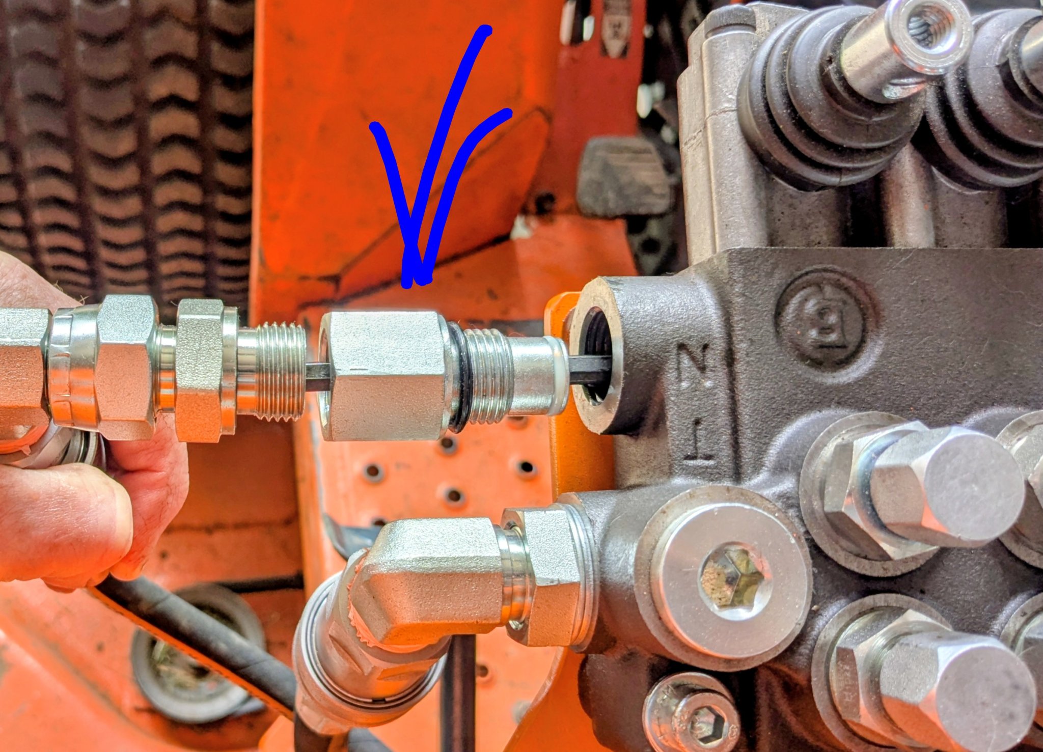

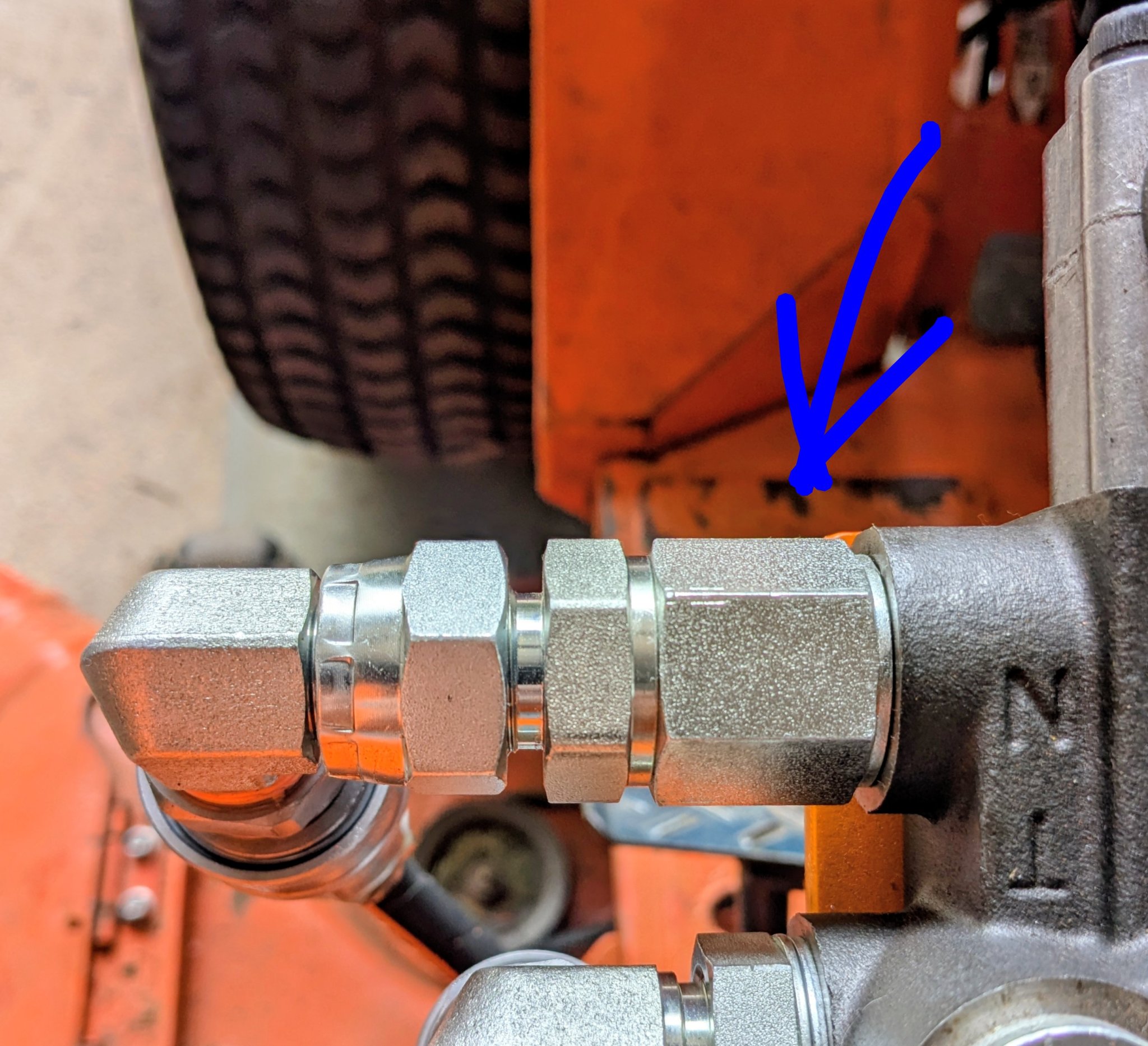

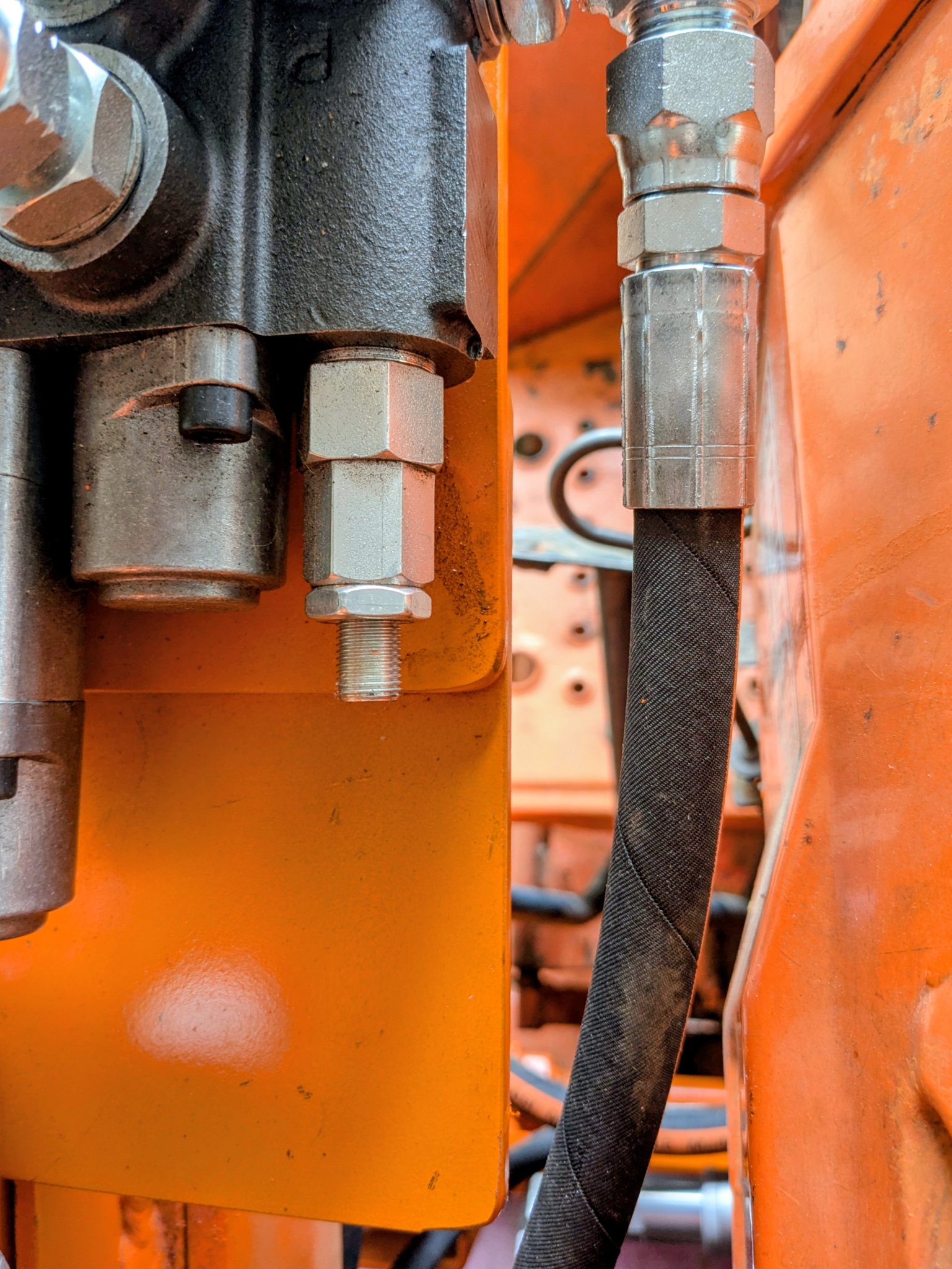

More pressures and power beyond now works.
The fitting for the power beyond port of the loader valve arrived, and the power beyond function now works to supply the 3 point hydraulics. It screwed into the power beyond port and the existing fitting screwed into it.
With this now working I could check the pressures at the power beyond port:
1500 rpm - 1800 psi
2000 rpm - 1800 psi
2500 rpm - 1800 psi
All pretty close to what I measured at the pressure supply port at the hydraulic block a couple of days ago.
I adjusted the pressure relief on the loader valve down - it only took about 1 turn to have an effect so it must have been set not far above the tractor pressure relief setting. I dropped it further to 1600 psi and left it there.
