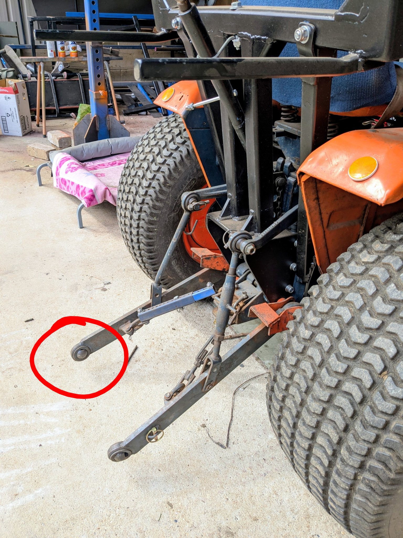

When you refer to "at the pins", is that at the end of the lower arms, circled in red in the attached pic ?

Thats at the pins.

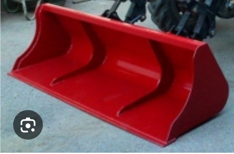

I'm hoping to get a loader bucket made this week. I saw this one with internal ribs while I was searching for ideas. To me, it looks like the ribs could add a fair amount of strength to the base of the bucket without adding much weight.
Since I've never actually used one, I'm really interested in your thoughts. Pros and cons, good or bad ?
My thoughts: more surface area for clay / soil to stick to. If you have sandy soil this should not be a problem. Reinforcement on the outside would not have that disadvantage.
And a nice round shape has a lot of inherent strength already and a good solid front edge would be my preference.
Thanks Hugo. Definitely more clay here than sand.

At first glance, I am not particularly fond of those "internal ribs”, but I can’t articulate why I don’t like them…..I just don’t for some reason.
It seems like they would “get in the way”, but thats all I can come up with……..

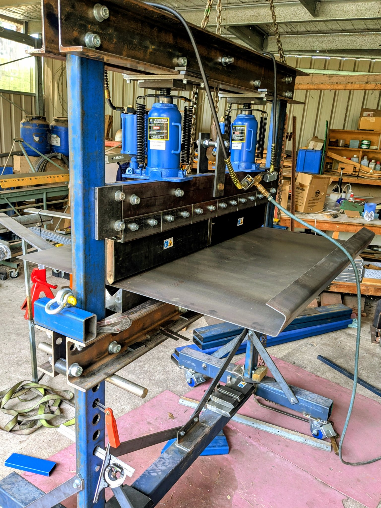

Yep looks like a sheet of steel and some sticks of steel! :p
Haha - it did yesterday. Today the sticks of steel still look like sticks of steel, but the sheet has been cut and has a couple of folds....then I had to leave to see my GP.
