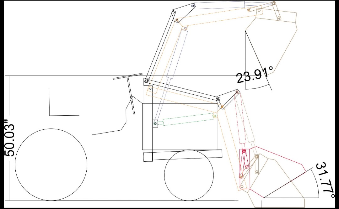

A little time modelling with paper and pencil or CAD software can save a lot of grinding. And there are a number of online calculator websites that can help calculate the hydraulic forces and pressures required. When I built mine I had the geometry pretty much worked out in advance:
NOTE: you will see I played with the link idea and had that geometry worked out but in the end abandoned the plan due to the added weight. The extra steel doesn't seem like much at first blush, but really does start eating into the meager 500# lift capacity envelope I was aiming for.

I've been thinking about how to modify my loader to fix the "won't curl back" problem described above. Since I'm going to be modifying it anyway, I'm considering going back to my original plan of making it mechanically self levelling. At the moment I'm mocking up a version that was designed by @torch that he included in a comment above (see his pic below). Also thinking about a mod to the top levelling arm so that I can pin it to either the normal spot or directly to the top loader arm to allow the self levelling to be easily enabled or disabled.

torch
Jun 10, 2016
2,879
1,125
Muskoka, Ont.
Also thinking about a mod to the top levelling arm so that I can pin it to either the normal spot or directly to the top loader arm to allow the self levelling to be easily enabled or disabled. From what I've read, the main advantage I can see with self levelling is when being used with forks, and the main disadvantages are added weight and reduced curl when raising the loader arms.
It would have to be more than a pin. The pivot is one side of a parallelogram. At least one other side has to be disconnected first or something will bend/break/fail.
I don't see any advantage to disabling it. One issue with a simple, lightweight, fixed, non-levelling design is that when hoisting dirt in a bucket, at max height the bucket can spill out the back and dump some material onto the hood of your tractor. The self-levelling capability would maintain the bucket orientation through the arm's range of motion.
