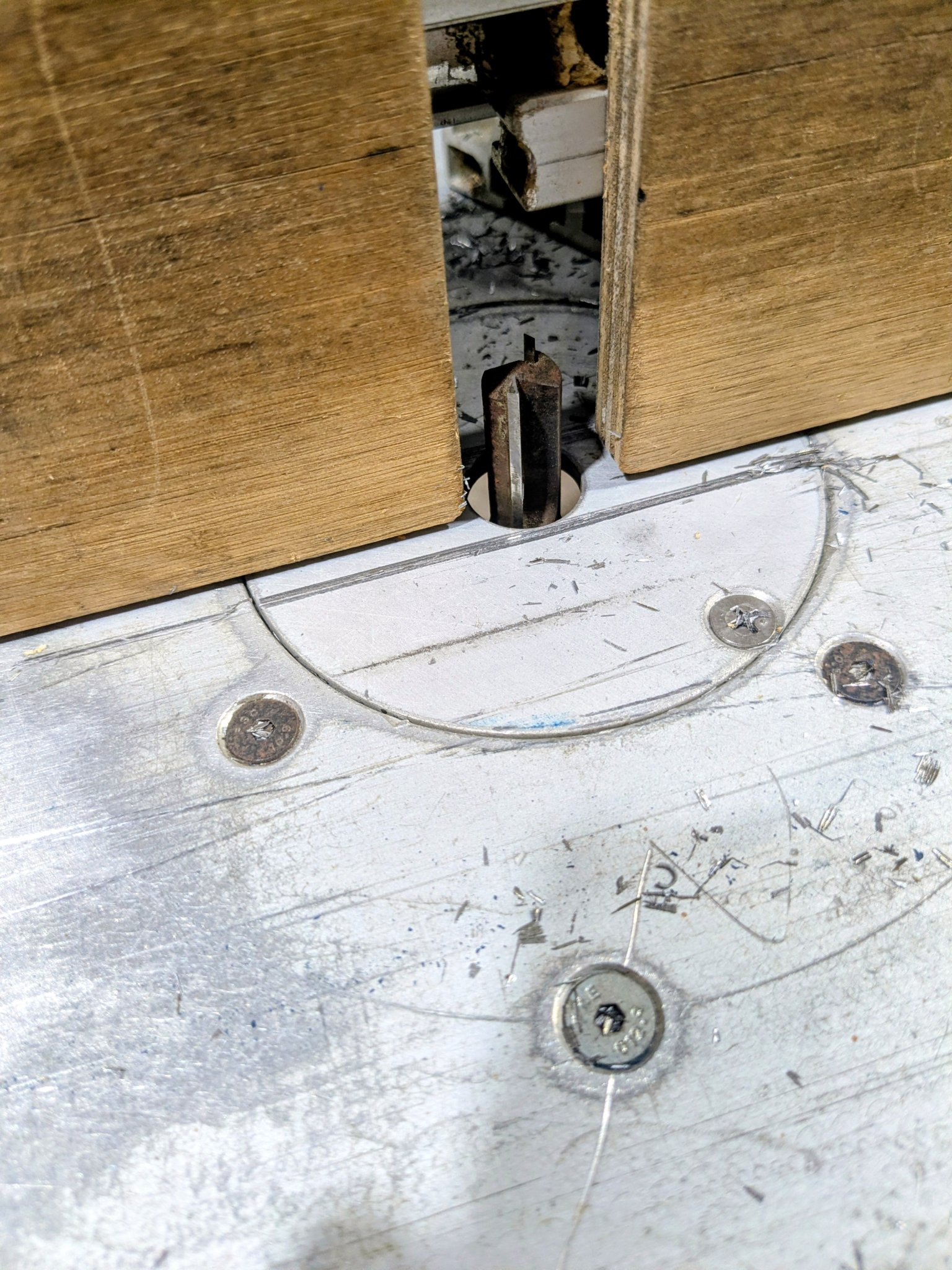

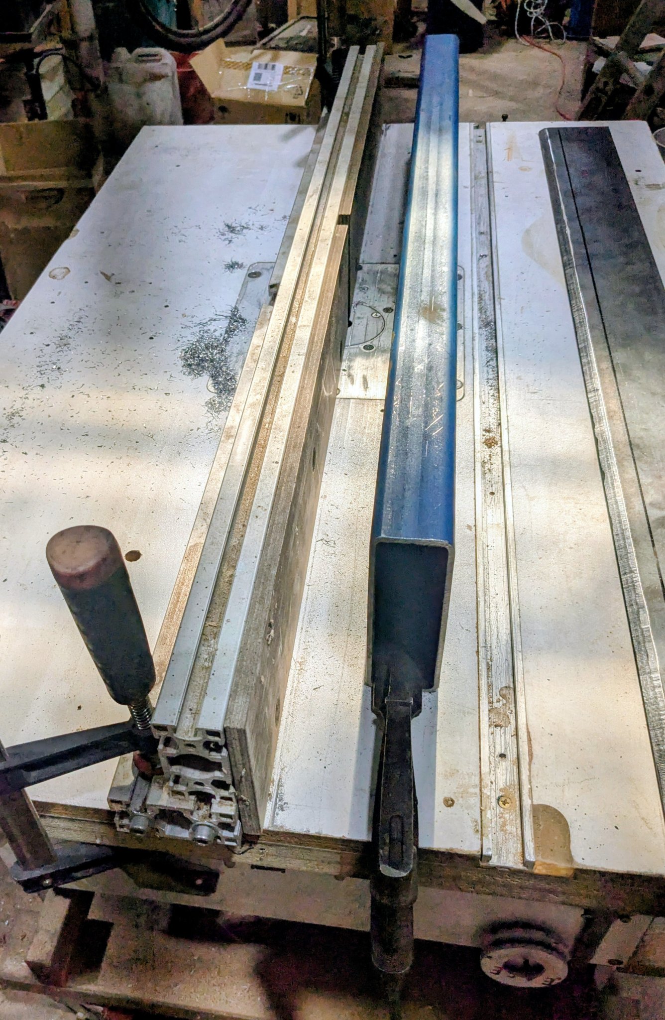

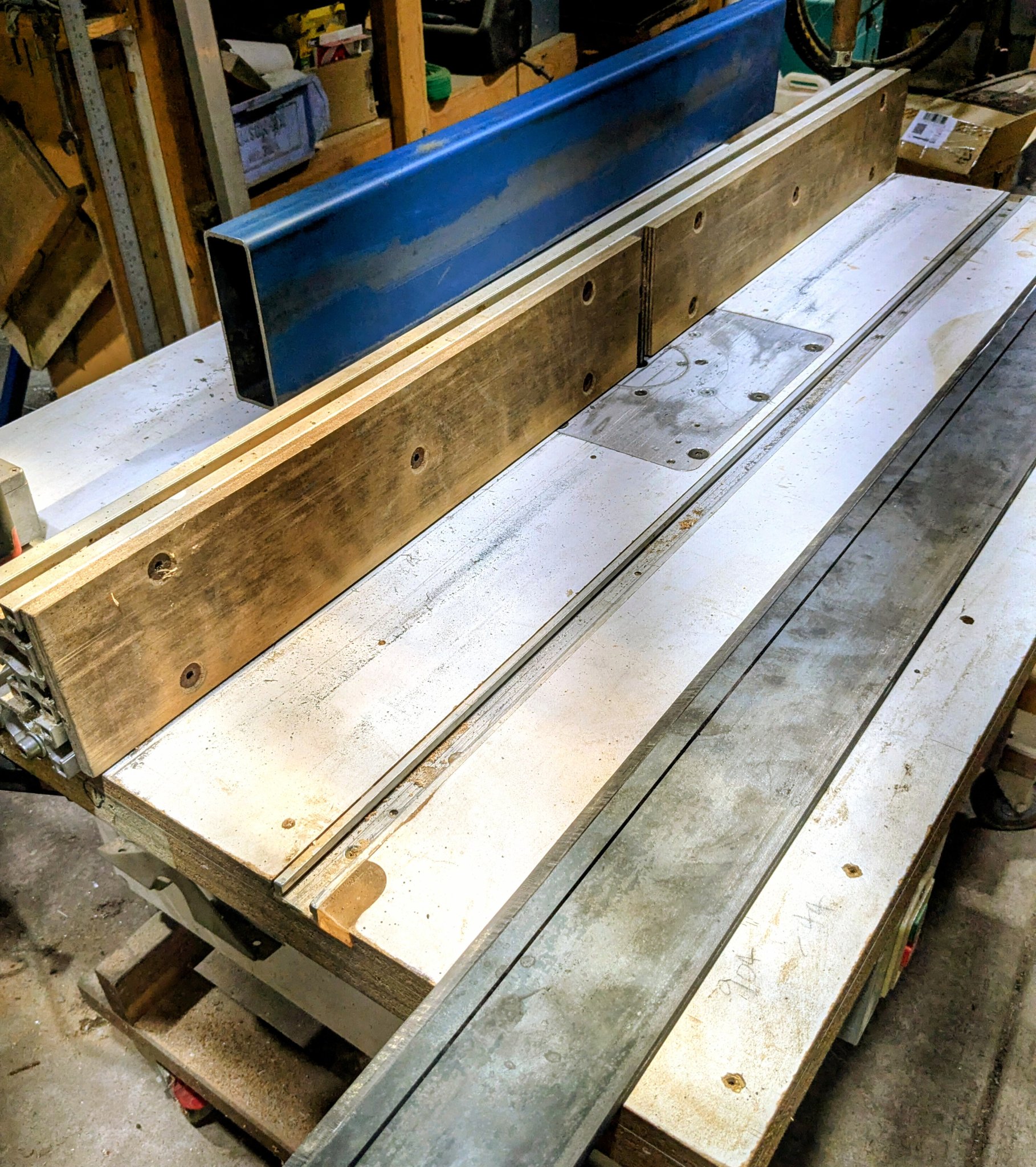

I tried grinding a bevel on a piece of 100 x 10 mm mild steel that I'll weld on to the bucket for a cutting edge, but wasn't happy with how uneven it came out. Don't think it would have bothered the dirt but not sure if the tooth bar would have sat on snuggly, and I'd rather start with it straight.
The router table worked ok to clean up my dodgy grinding.

Was that some sort of “carbide” router bit?

Thanks. Bringing the bolt on tooth bar to a point makes sense to minimise resistance. The bit that I'm making here will be the bucket edge. If it wears too much I'll attack it with some hard facing rods.

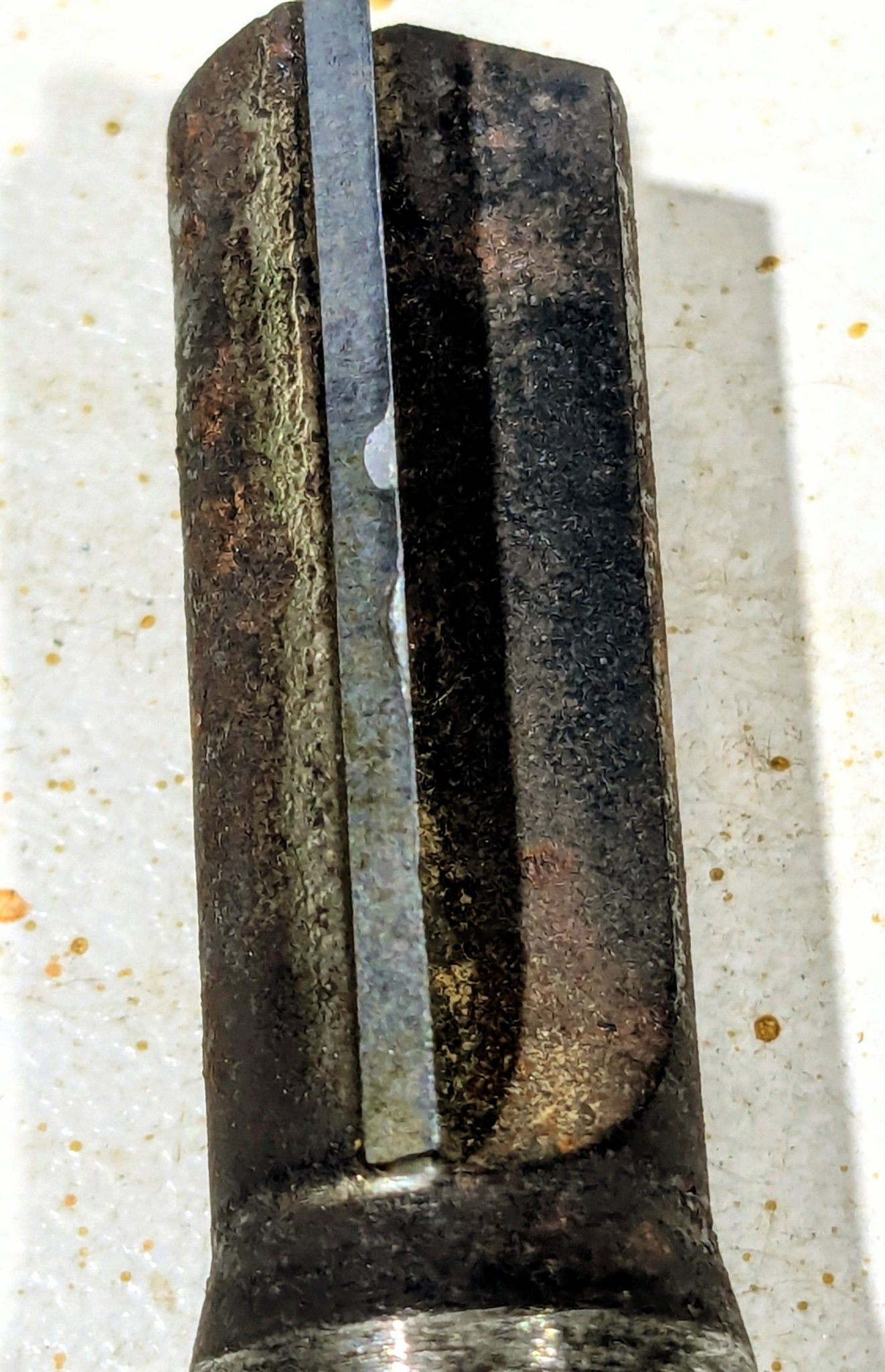

I ground mine first but I wasn't happy with how uneven it ended up so I had a go at it with the router. Much happier with it now. I used a standard 1/2" carbide tipped router bit, same as I use for timber (just not this one), with the router slowed down a little.
I did the same thing a few years ago when I made a pan brake. Unfortunately I don't have a mill.

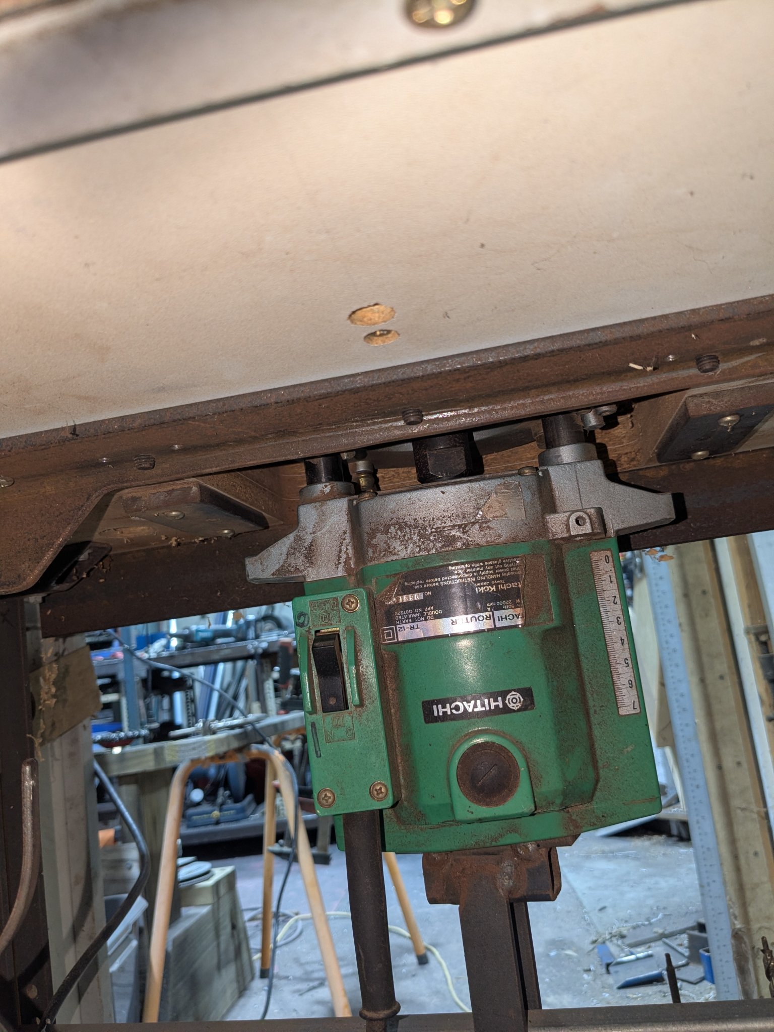

The carbide used for milling wood is a different grade than the carbide used for milling steel. Wood bits are typically C2 to C4 (softer, tougher and less likely to chip in an interrupted cut) whereas steel milling bits are usually C6 or higher (harder, more brittle, holds edge longer in an uninterrupted cut but chips easily ).
Harder grades of wood bits do OK in softer metals such as aluminium but I'm betting that bit is pretty dull now. And I wouldn't try that trick to mill AR5 or similar wear-resistant steel.
You could mount a carbide endmill in the router, but bear in mind that metal cutting requires much lower rpm than wood. For mild steel and a 1/2" carbide endmill you might want the router down at the 1,000 rpm level.

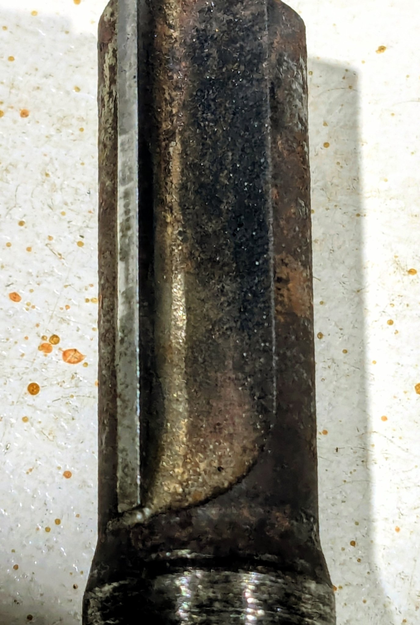

You're right about the chipping. There's a couple of small chips out of one cutting edge (looks worse in the photo than in real life), and both edges are a bit dull but not terrible. I've had this bit for about 35 years and it's had a lot of use, mostly on wood, but hasn't been used for any finish cutting for quite a while.
I didn't realise there were different grades of carbide for wood and steel. Might look for a carbide end mill if I have any more steel to run through the router. Thanks for the tip.

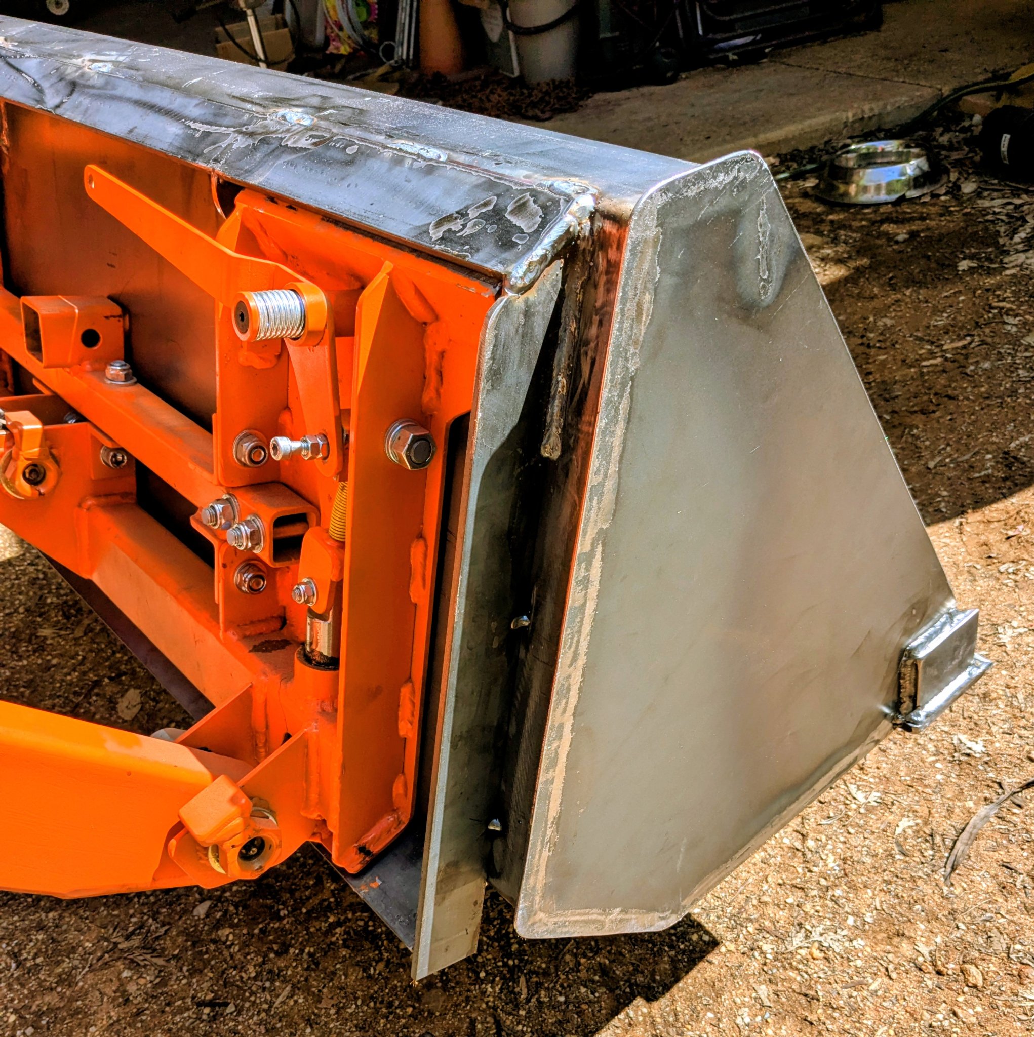

Yea your geometry is off.
Your not getting enough roll back or enough roll over.
This could be caused by bracket location or simply by not enough stroke on the dump cylinder.
I can tell you your too close on the roll pivot point and the roll cylinder attachment point.
Interesting choice using one cylinder, you'll lose a lot of roll back / breakout strength doing that.

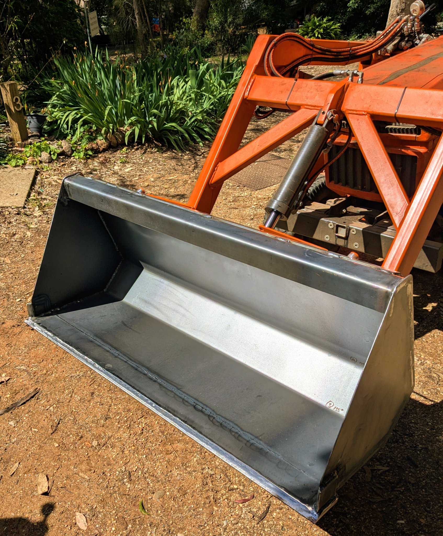

You're right, and I'm now regretting my decision to go with a single curl/dump cylinder. I've just test fitted the bucket made from 3 mm steel, so not overly heavy, and found that with the arms raised about half way and the bucket dumped fully, the position of the pivots plus the extra weight of the bucket means the cylinder can't curl it back. Part of the problem appears to be play in the pivot points that allow them to pull over so that they're almost in line.
I'll obviously have to modify it as it doesn't work as it is. Thinking I'll change it to a more conventional 2 cylinders for curl and dump and pay better attention to placement of the pivot points and making them with less play.
I kicked it and came inside for a coffee - I'll get some pics when I get back out to it.

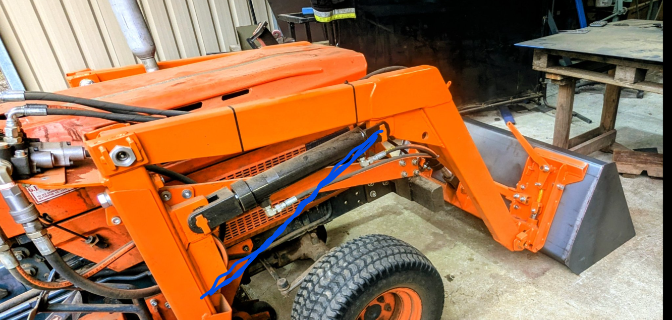

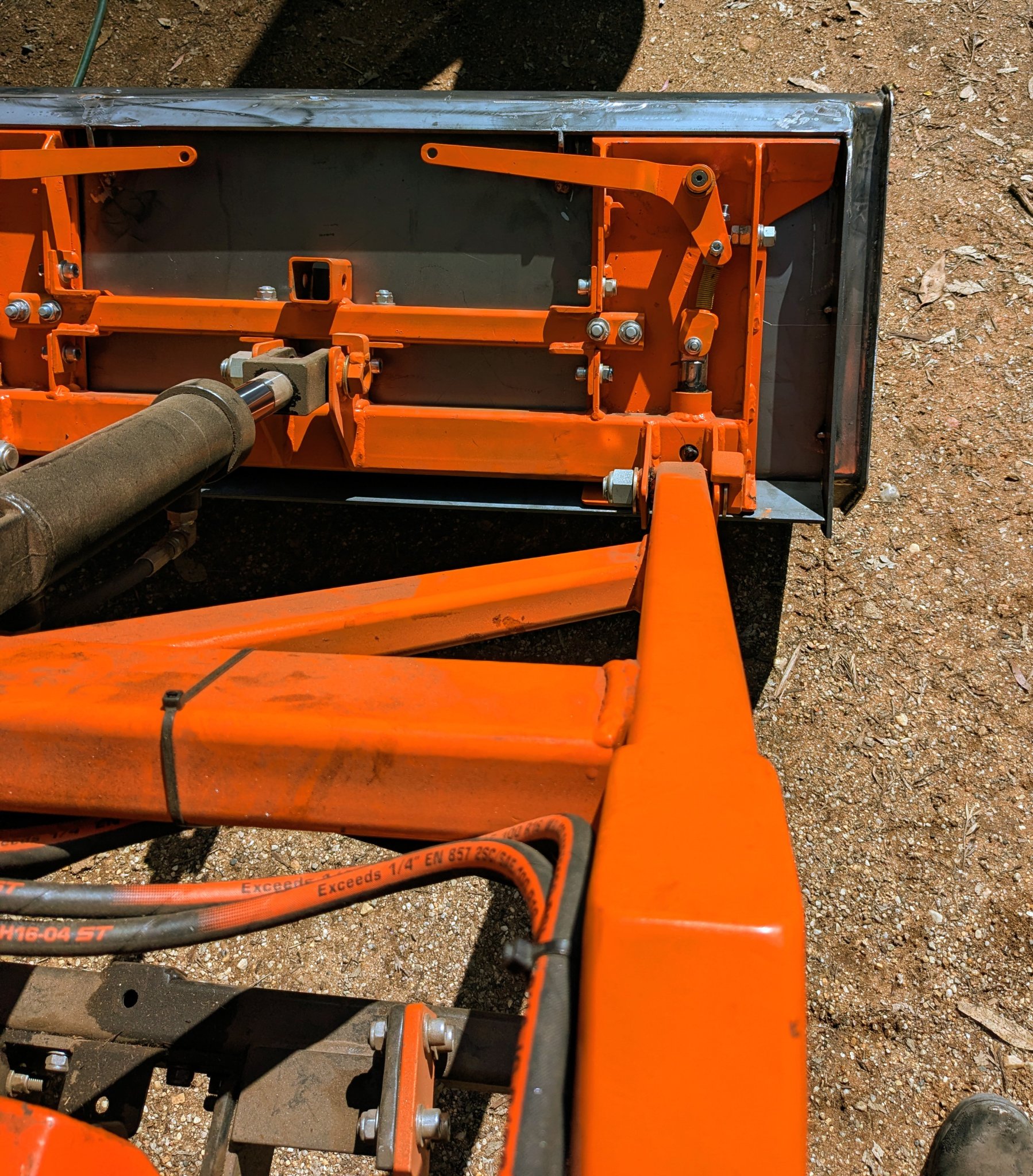

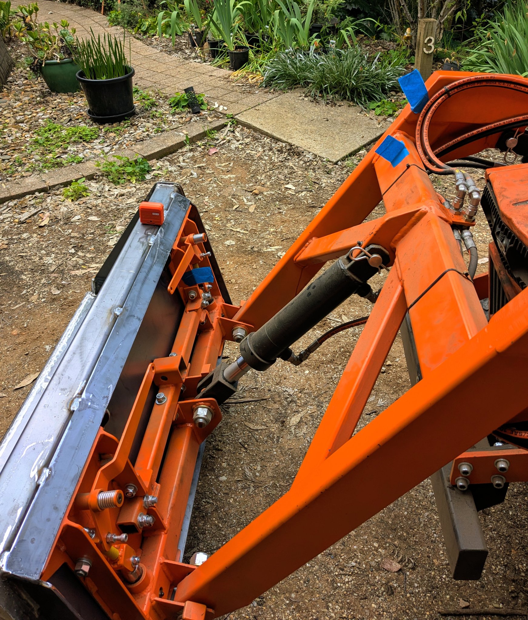

Starting to look at where I might be able to mount 2 longer travel curl/dump cylinders. Haven't really settled on anything yet but here are the options in looking at.
The first pic shows some options for approximate mounting areas for the top and bottom of the cylinders with bits of blue tape.
The second is looking straight down one of the arms - I've managed to get the arms pretty well straight in line with the SSQA locking bits so mounting the top end on the arm will be difficult.
Some more chin scratching still needed to settle on locations, cylinder stroke and modifications required.

Are you thinking of an internal stop in the cylinder or something else ?
Something on the loader arms that stop the SSQA. The LA525 has a piece of metal on the loader arm and on the SSQA that keeps it from dumping too far.
I can take a picture of what I'm talking about tomorrow if you would like.
