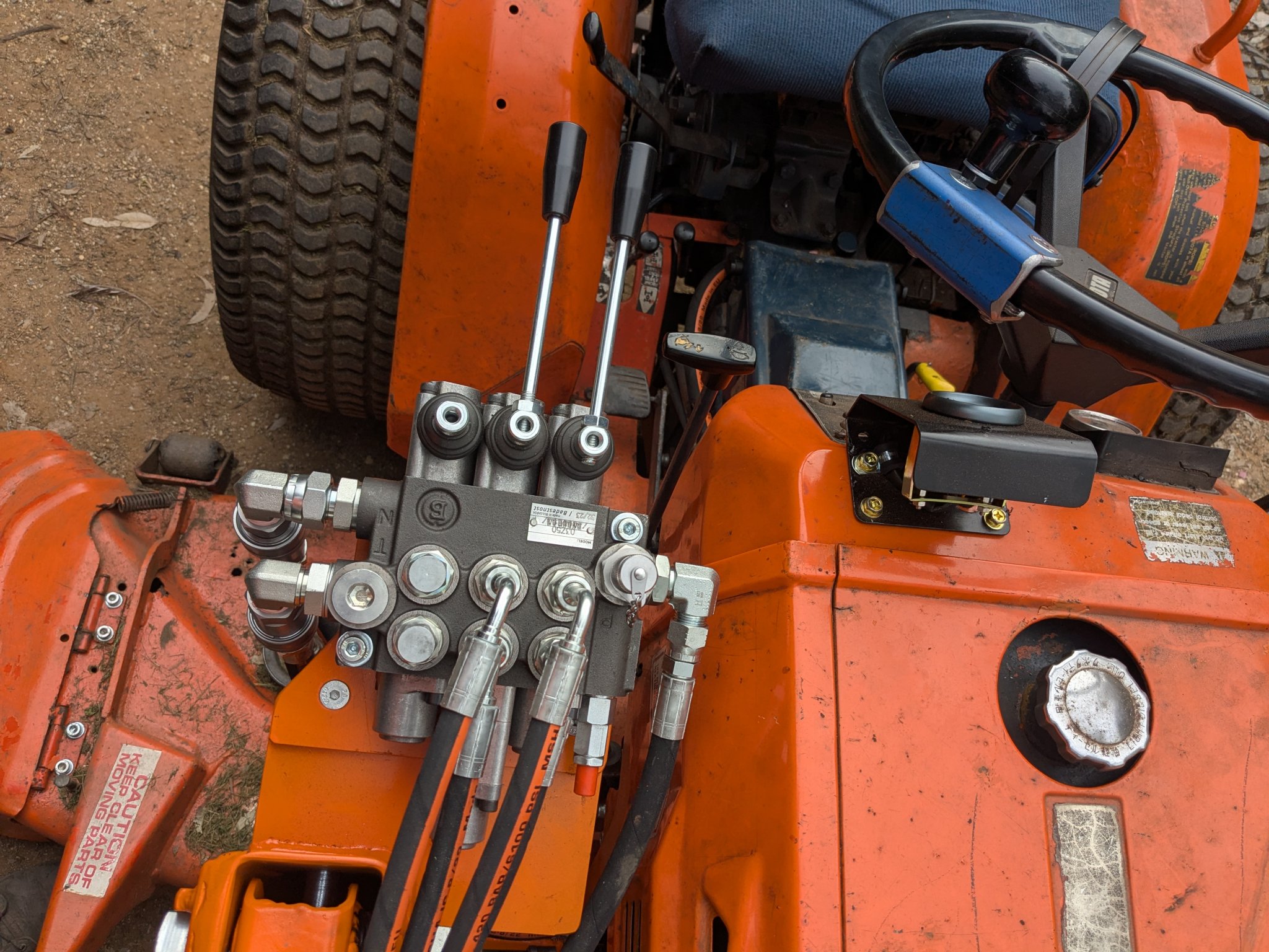

Don't know about the simultaneous flow, I guess I can check by operating both the raise/lower and curl/dump levers together and see if both things move ?
I saw what looked like a pretty neat and tidy joystick setup in a Ask Tractor Mike video and thought I might try to copy it - see pic below. I bought 3 ball ends, just need to make the rest - hopefully not too ungainly 😆.
Yeah that looks pretty much like what's under my rubber boot. The top of the spools are drilled to accept the mechanism. Yours may be different, necessitating some sort of adapter to attach the mechanism to the spools -- that's what I meant by "ungainly".
12,295
7,011

Is it worth the time and expense when you can buy one for $275?
Haha, thanks Dan, interesting question. I like to make things and I have plenty of time. Sometimes I might save a lot of money doing it, sometimes I might not save any.
I'm new to tractors so don't know exactly what will be useful from experience, just going by what I've read in spots like this and what I've watched on YouTube videos.
I went with a 3 spool valve to give me a 3rd function without any further mods except for hoses as I'll probably make a grapple, maybe a 4-in-1 bucket ??? I'll just leave the 3rd spool ports plugged until I'm ready. The valve spools are standard-float-standard, also thinking that the float function might come in handy but don't really know yet. I'd rather allow for it now and not need it than really wish I had it later.
Going this way with the valve meant that the local hydraulic supplier couldn't get one with a joystick to operate the first 2 spools. Hence the joystick conversion.
Is this the easiest or best way to go about it ? Maybe/maybe not, but no idea really. If there are alternatives, it won't change what I've done, but I'm always keen to learn.
Somewhere here someone asked why I bought the tractor. One of the reasons was to use it, initially to mow, then more. The other reason was to make things for it.
12,295
7,011
I like making novel things - not so much re-inventing the wheel. :)
You definitly want float on the boom spool. Had you asked I would have recommebded that joystick valve with float for the loader and an electric valve for the third function.
The electric valve is something you can definitly save $$$ by rolling your own.
It's looking like I would have been better to ask here rather than at my local hydraulic shop.
With an electric 3rd function valve, would it be operated from a switch on the joystick handle ?
I'll Google 3rd function electric valves, then might have more questions if that's ok.
12,295
7,011
Questions are always OK!! Yjsts whyvwe are here.
The reason for electric is to put all three functions on the joystick for one hand operation. Here is a cheapie.

There sre multiplecways to learn. One is the hardxway - frim misrajes. The easy way is asking questions and avoiding as msny mistakes as possible.
So worst case, I use the 3rd function to operate a grapple or something else with a separate lever. Or I adapt solenoid coils that are on electric valves to my 3rd spool ?
12,295
7,011
No - you don't modify the 3 spool valve!!!
The 3rd spool on your manual valve will work fine for a third function just as you planned. An electric valve/joystick combo just allows one hand operation of all loader functions and is more user friendly.
At this point if you wanted you could add an electric valve to the circuit and use it and your DIY joystick for 3rd function. Thats how 3rd function is generally done.
You could then repurpose the third manual spool for something else like rear remotes.
If you wanted to go Full Monty eith the hydraulucs you could buy a new joystick loader valve and an electric third function for the loader. Then move the 3 spool to the rear for rear remotes. Thats a standard configuratuon using all off the shelf components.
NO CUSTOM MODIFICATIONS REQUIRED!!!
I think I get your message, something like don't modify the 3 spool valve ?
Probably best at this point if I make a bucket and at least a grapple so I can use it, them decide if it's worth changing.
12,295
7,011
Right on both counts :)
Plus, why make a grapple or a bucket when you have a SSQA loader?
