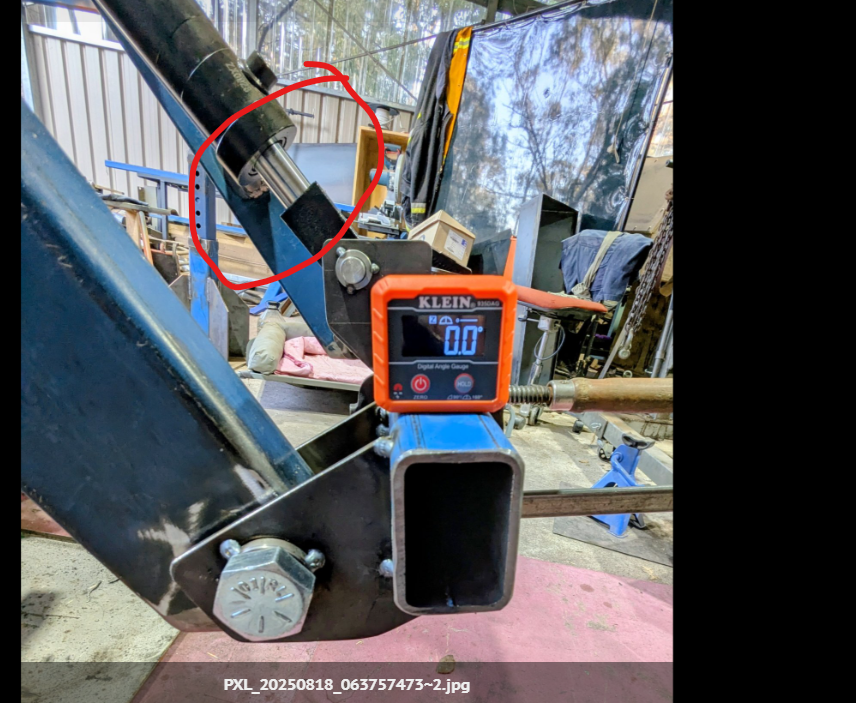

If this is as far back as you can get the cylinder to go, it's very likely that there is a stop inside the cylinder that needs to be removed.
What bore and stoke is the cylinder?
Paul Allwood
Kubota B7200HSTD, RC60-72H MMM, homemade FEL, forks & ballast box, rotary hoe
Jul 8, 2025
631
1,097
Baranduda, Victoria, Australia

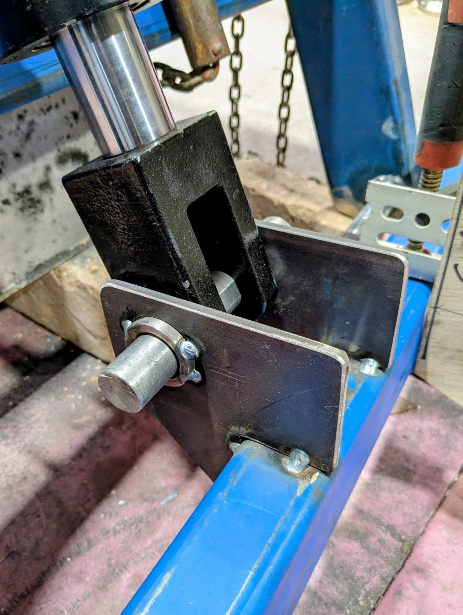

It's 2.5" bore x 8" stroke. This model of cylinder does use an internal stop, without it it's the same as a 10" stroke cylinder. I can only assume they do it so they have more common parts in manufacturing.

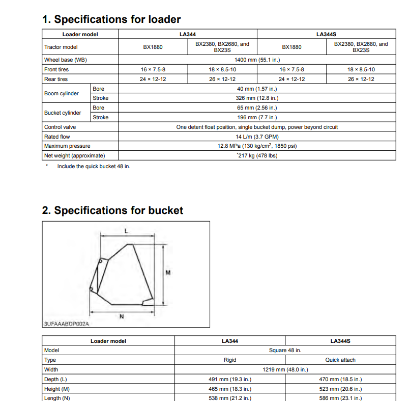

So with the internal stop in place, it still gives a stroke of 8" (LA344 spec is 7.7"). The stop can stay where it is - this is the stroke I want to match the LA344.

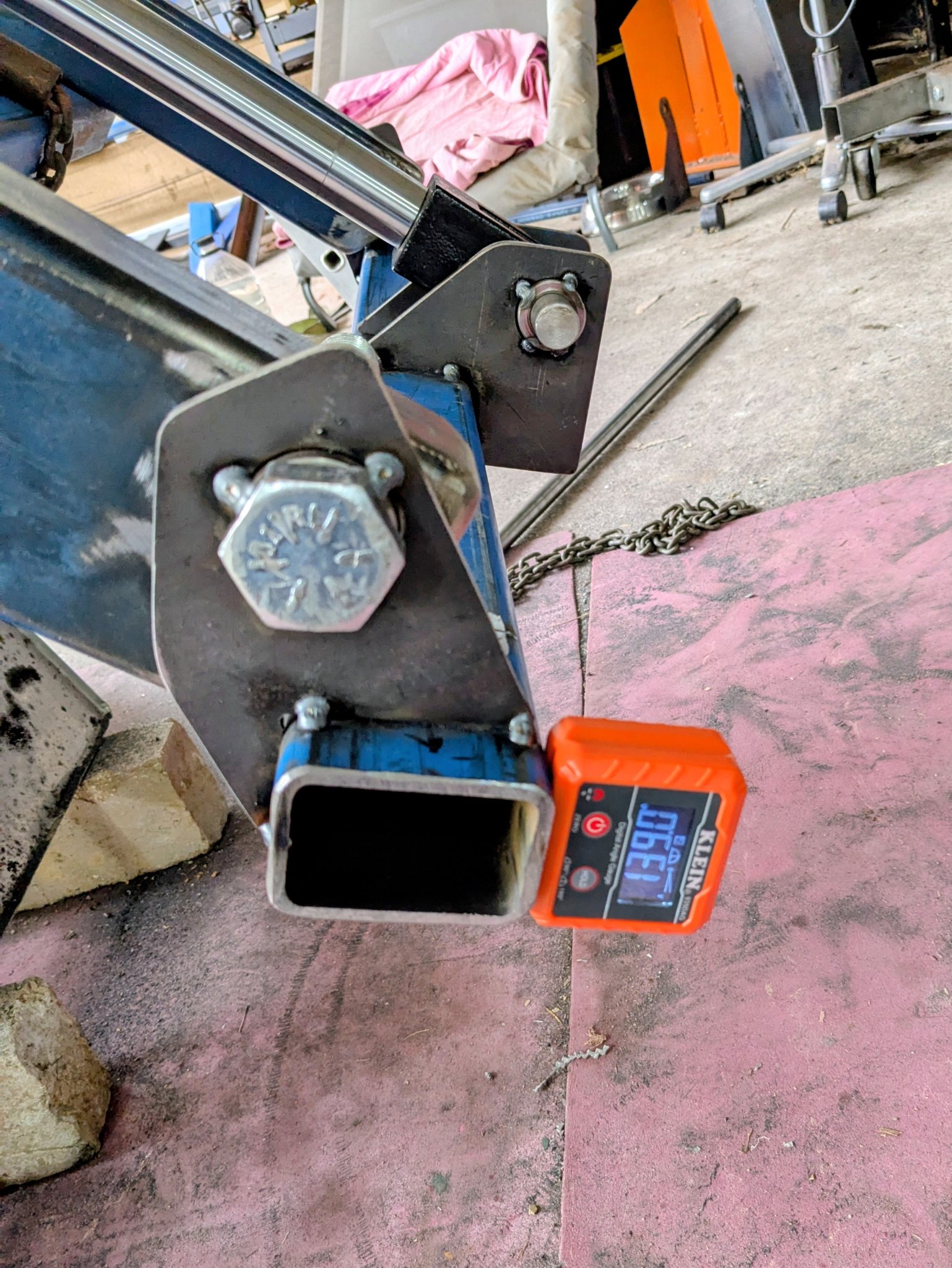

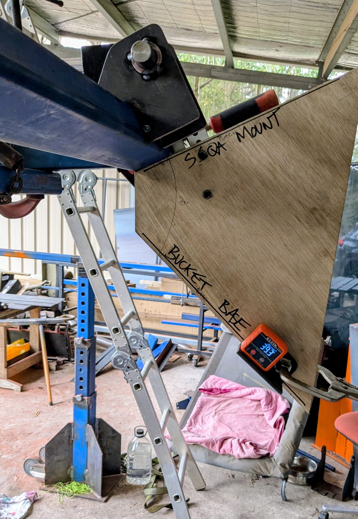

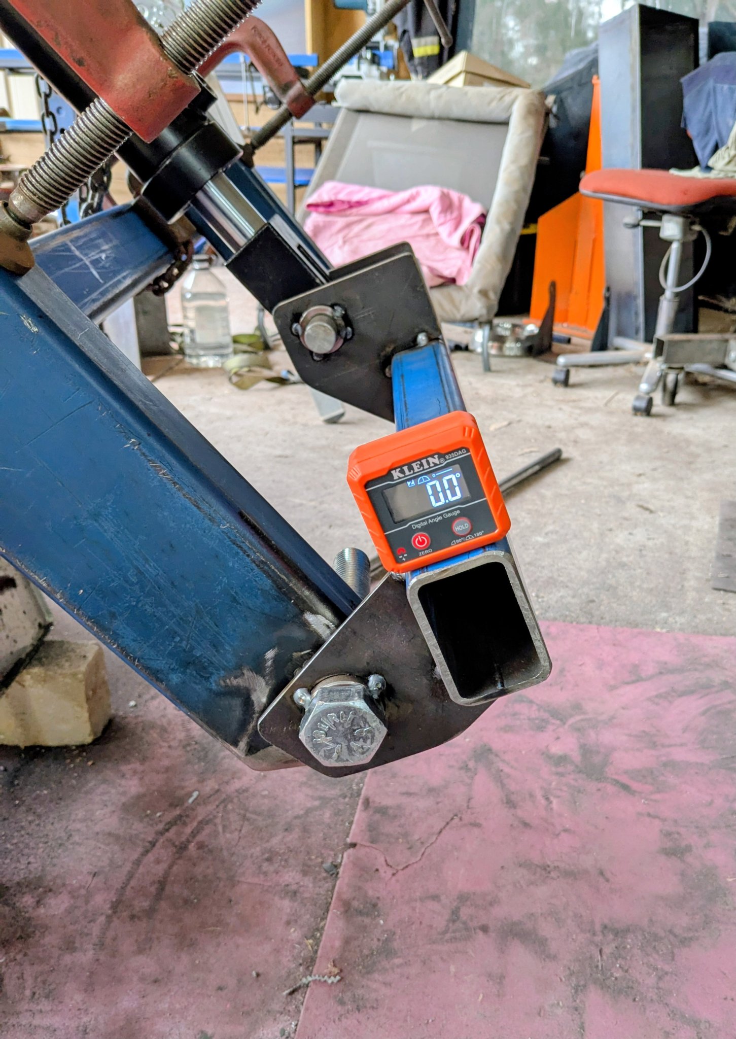

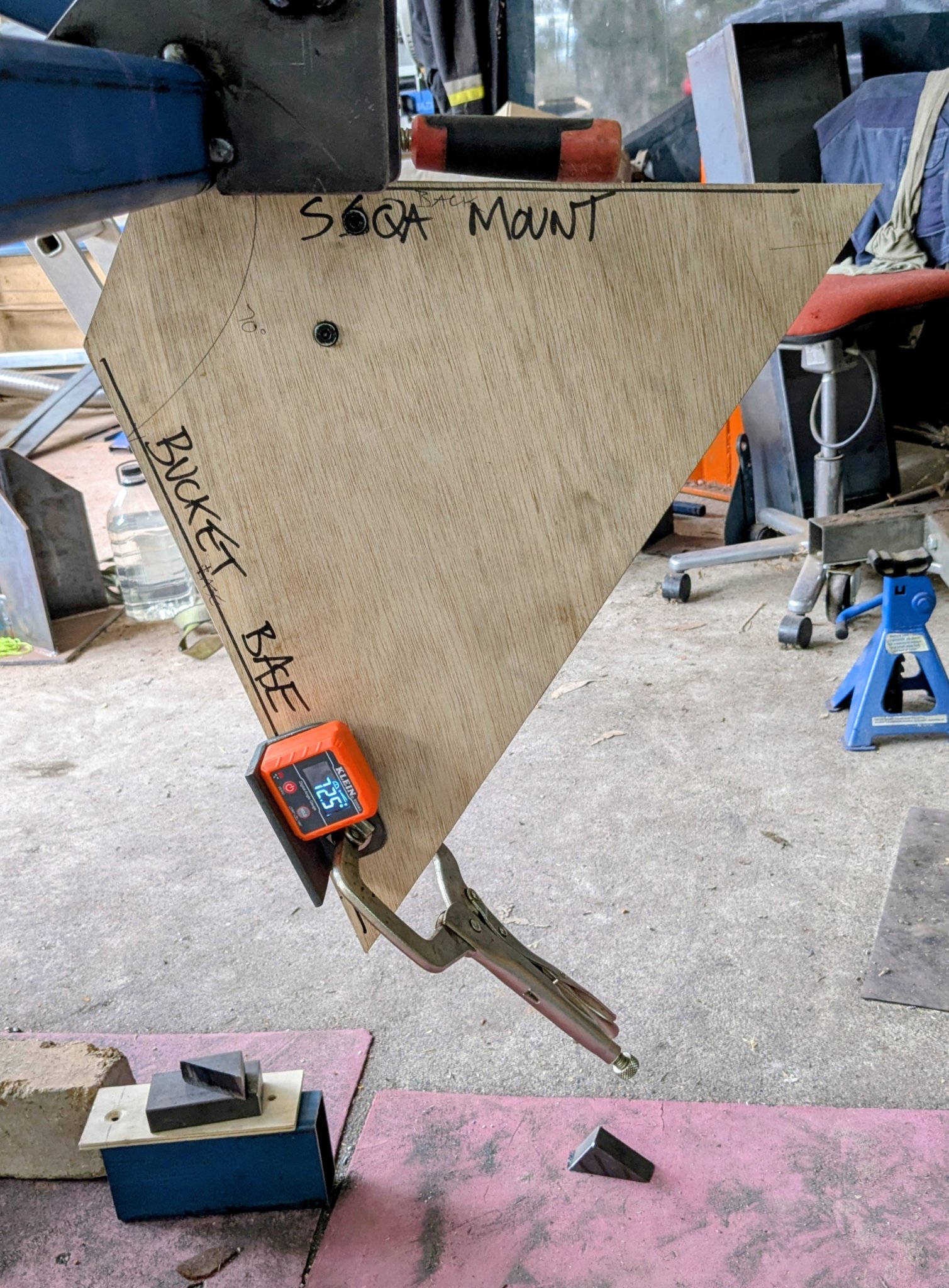

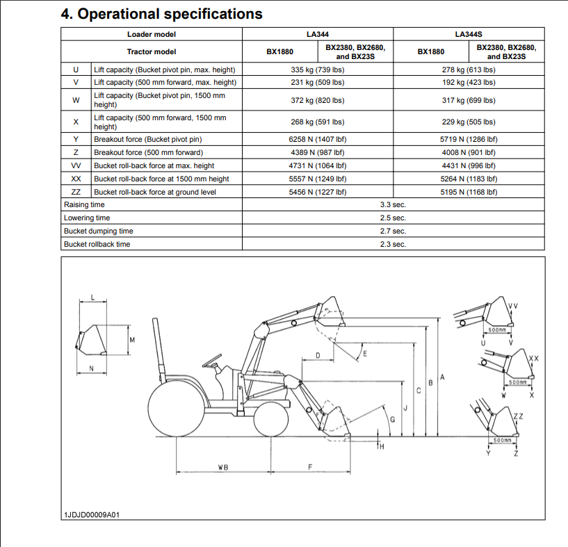

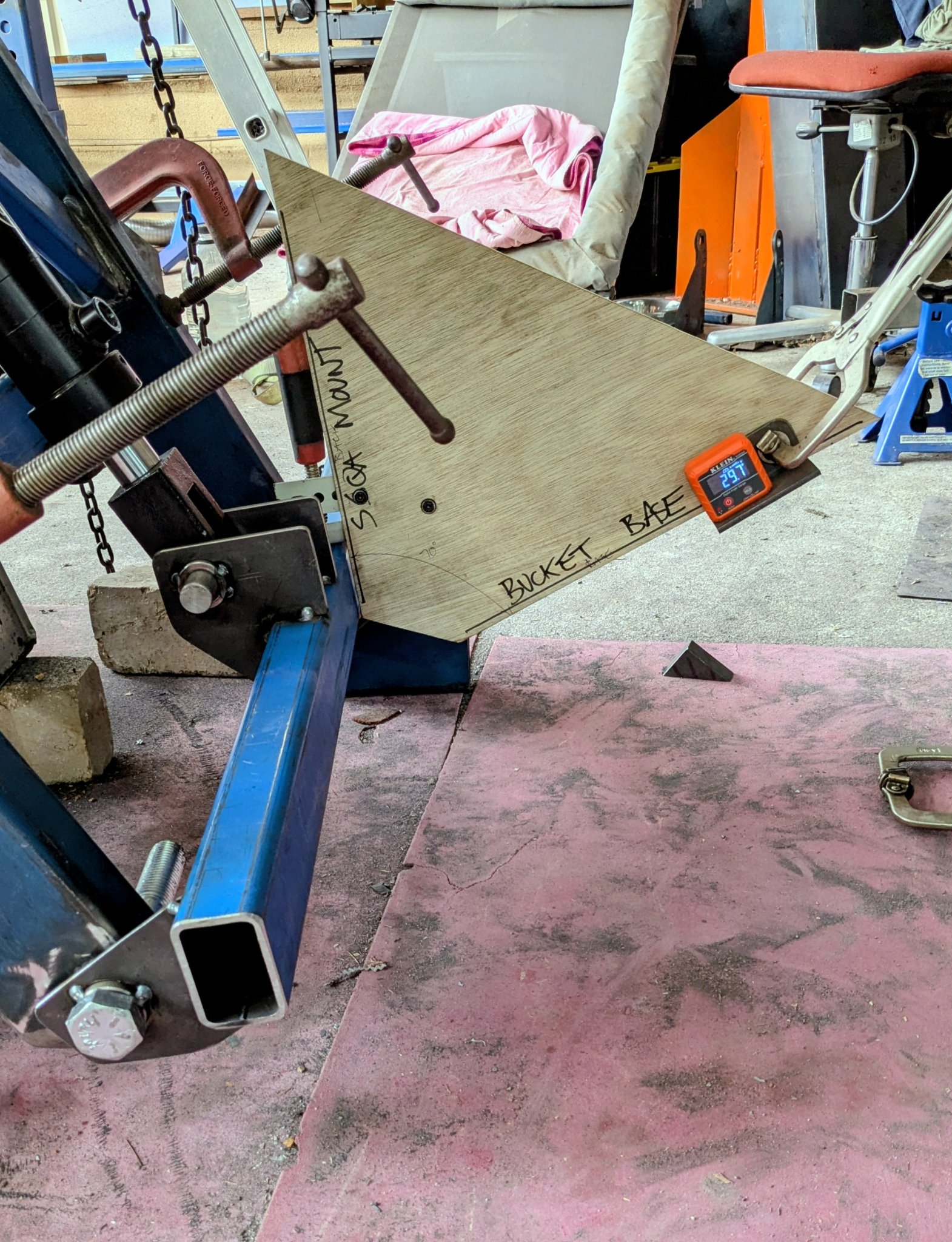

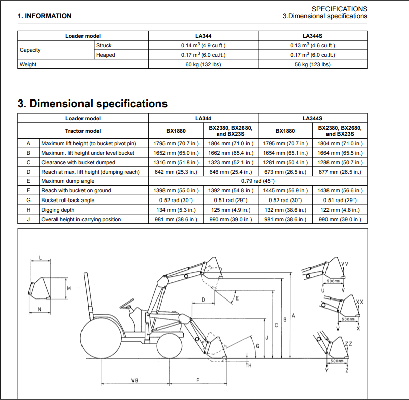

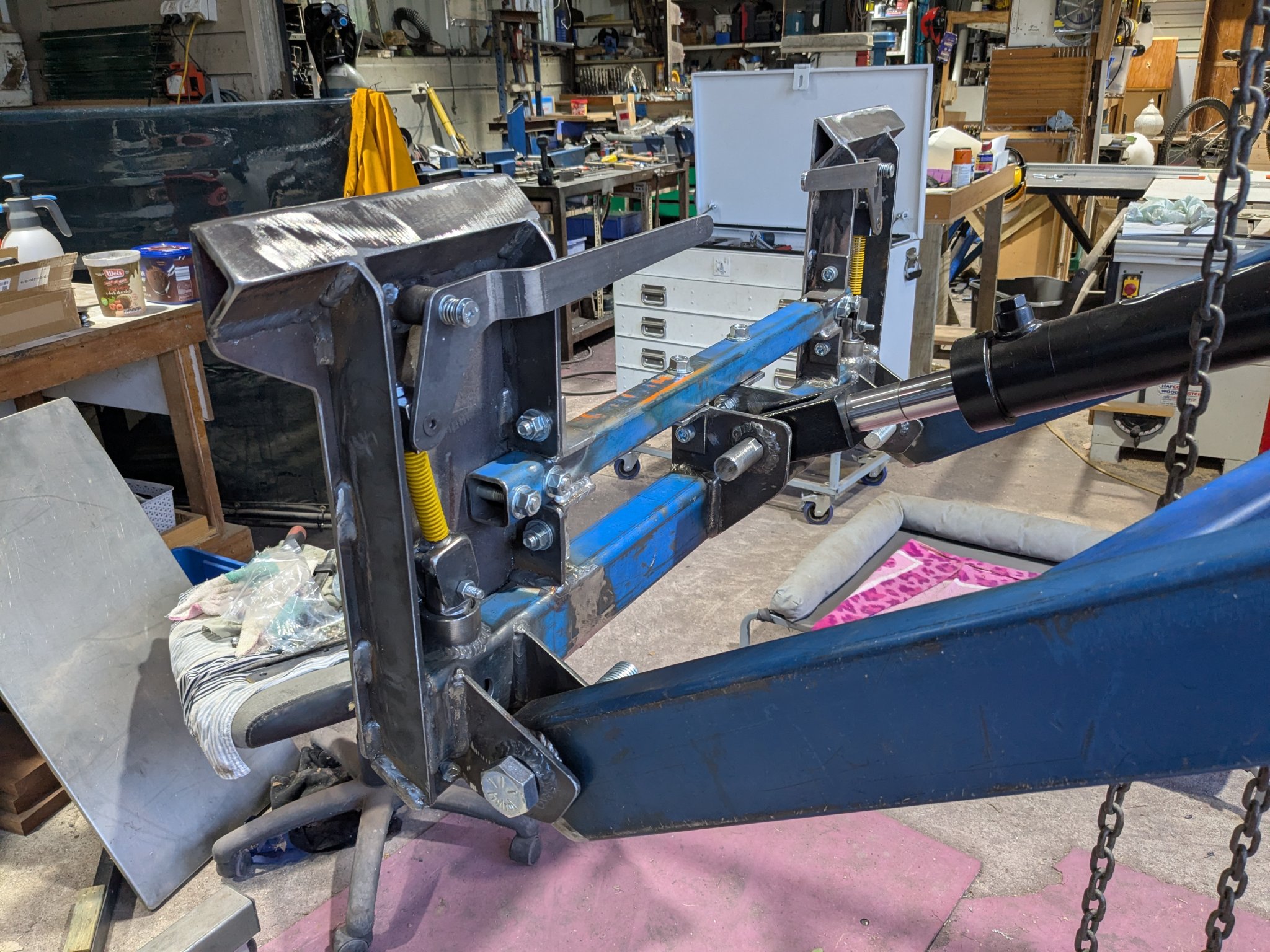

With the original geometry that was based on plywood and cardboard models, I ended up with a total bucket rotation of 110 degrees with my first set of steel brackets. I was aiming to match the LA344 that I'm roughly copying - this gets a total bucket rotation of about 140 degrees.

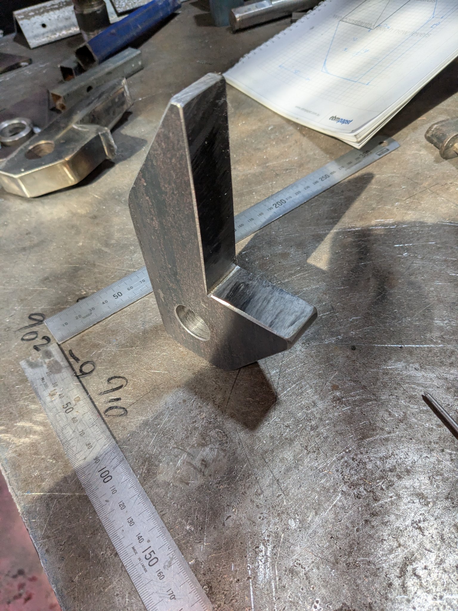

Out with the graph paper and pencil, ground off three of the original brackets and made new ones with some small adjustments. The hole in the bracket at the top of the dump cylinder moved up and forwards 13 mm. The holes in the brackets at the bottom of the dump cylinder moved down 18 mm.
The result:
- Total bucket rotation 139 deg
- Max roll back angle at 150 mm 30 deg
- Max dump angle at 1000 mm 72 deg
- Max dump angle at 1800 mm 39 deg
This geometry matches that of the LA344 as close as I can get it. It does put the pivot points closer to being in line at full curl and full dump than I would have expected before getting started on this project, but it appears to work for the LA344. If it turns into a problem, there's always the grinder. I won't know now until I can try it.
Next step - finish welding the bits I tacked in place then onto the SSQA and bucket.

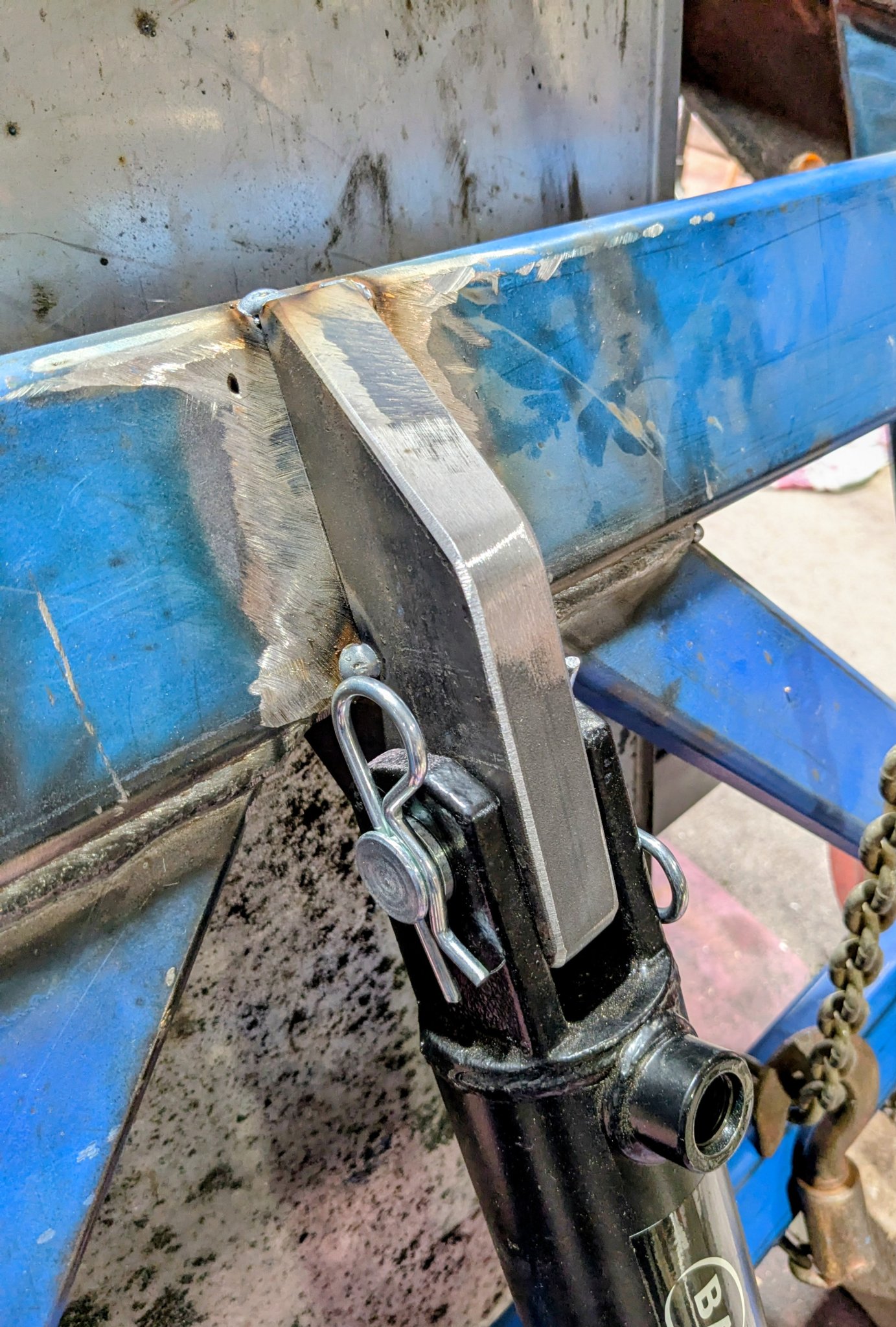

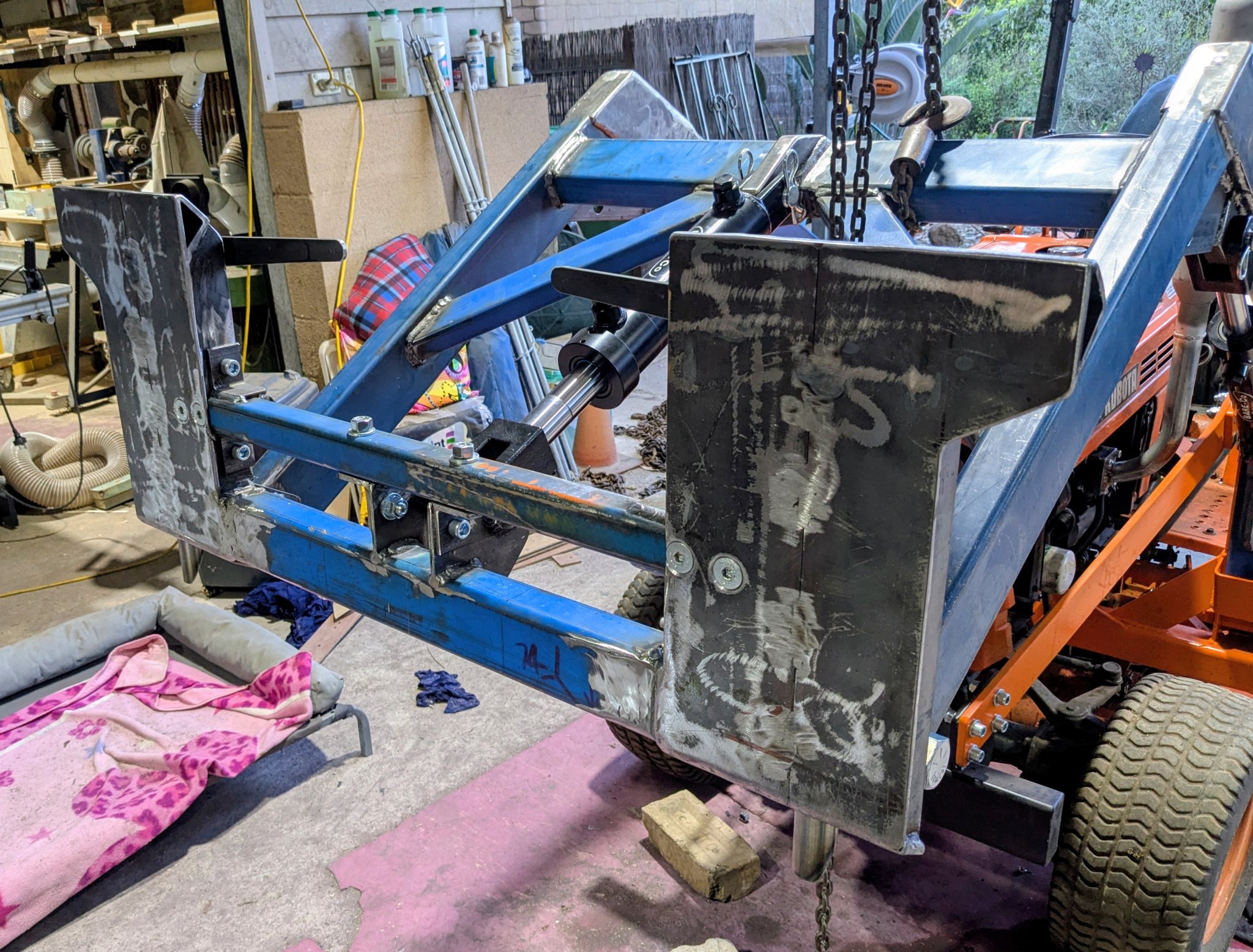

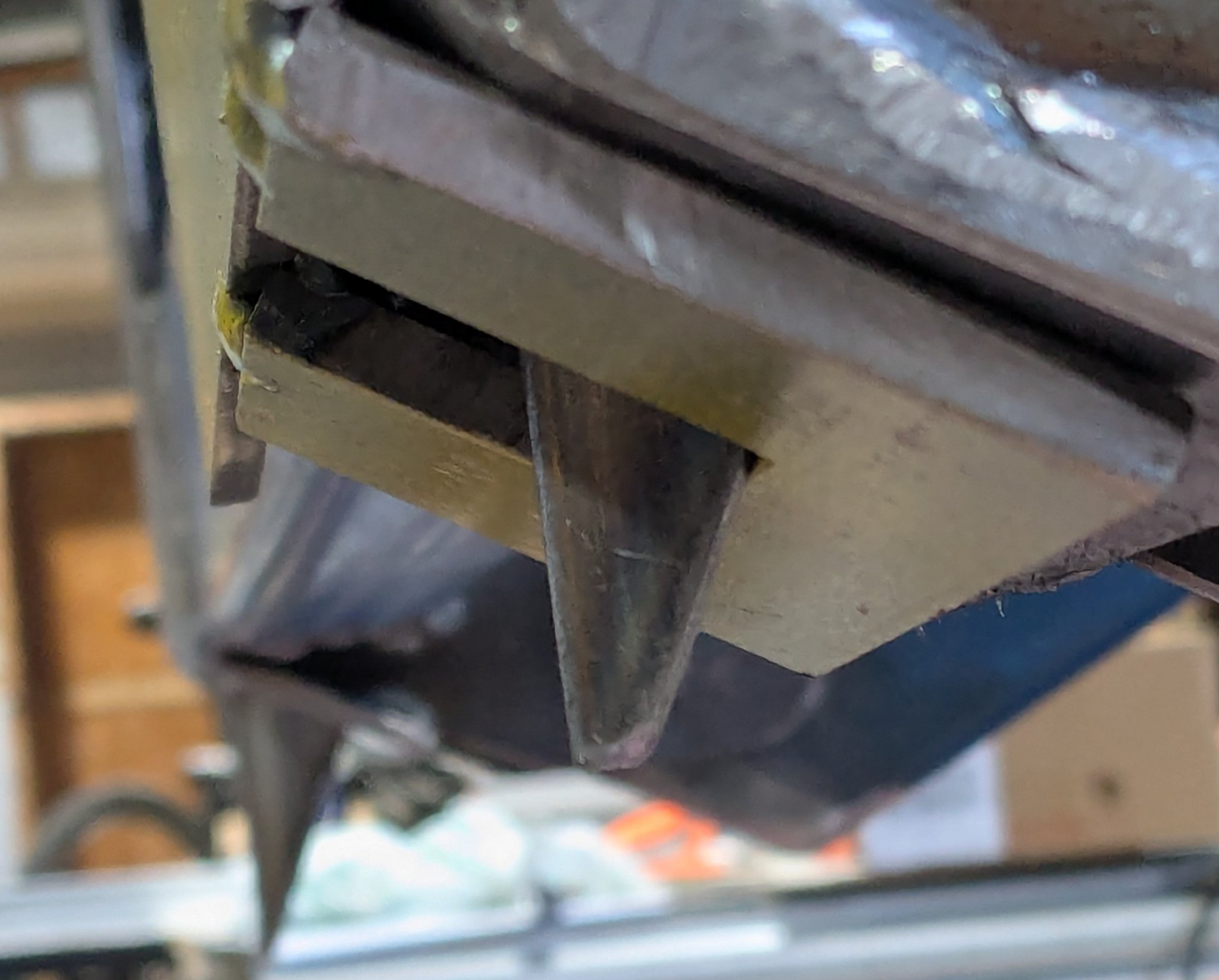

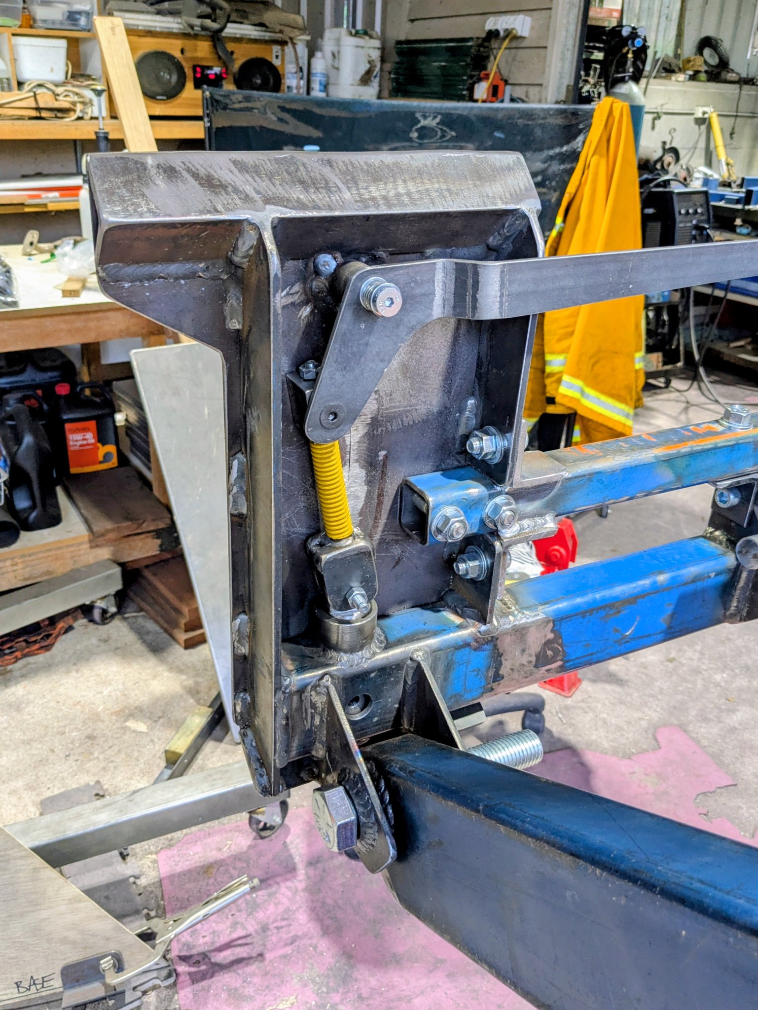

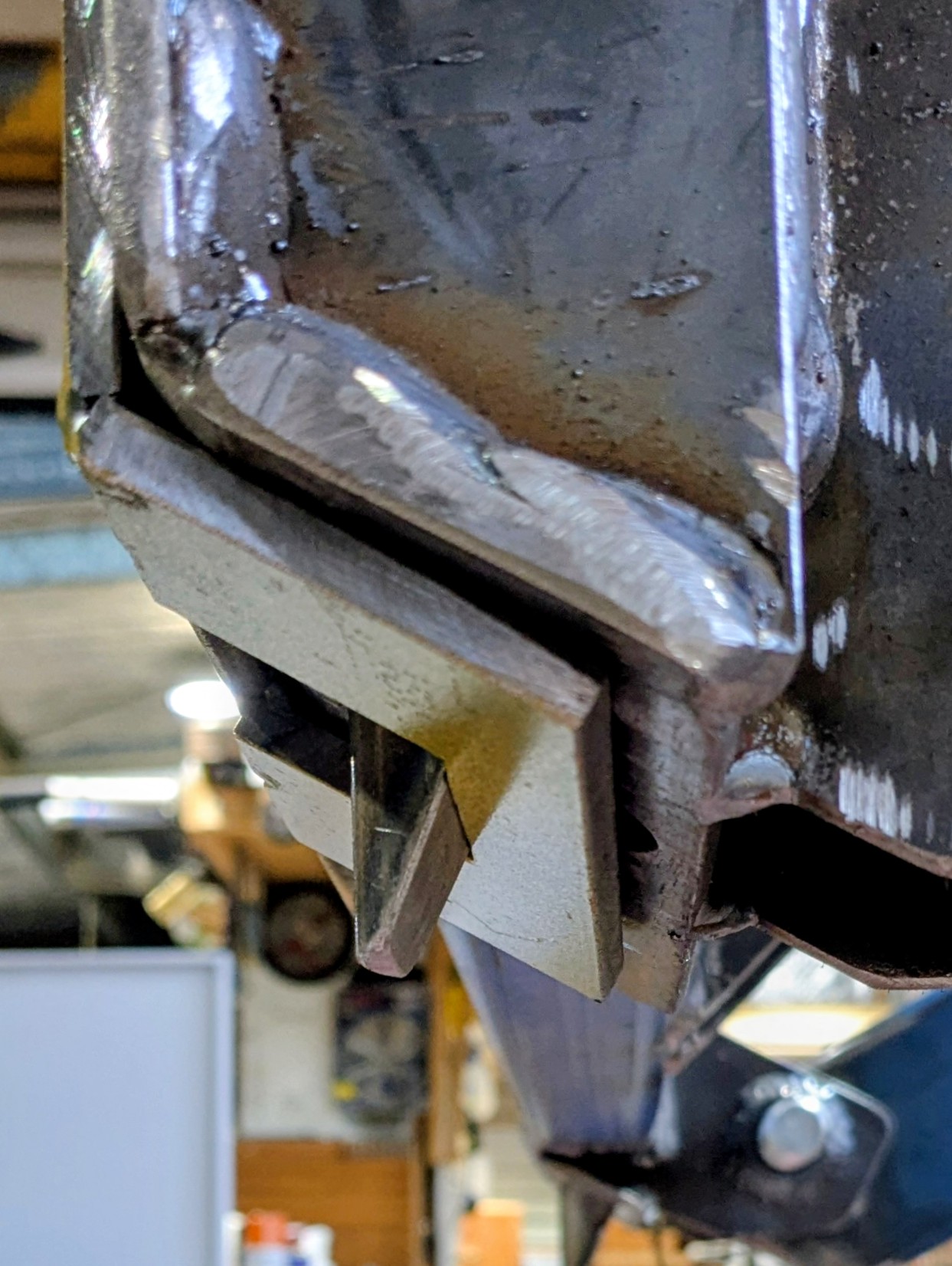

A little more progress
After getting the geometry where I think I want it, I've made a SSQA receiver for the front of the loader. I could have bought some bits and saved myself a heap of time, but I don't reckon it's the same as making it myself.
Turns out I'm really bad at keeping things straight when I weld them. There was enough warping from end to end of the assembly that I cut and re-welded the main RHS cross tube - slowly and with everything well clamped. I also bolted the smaller piece of RHS to avoid warping.
In a couple of the pics there's a bit that is simulating an attachment showing the pin engagement.

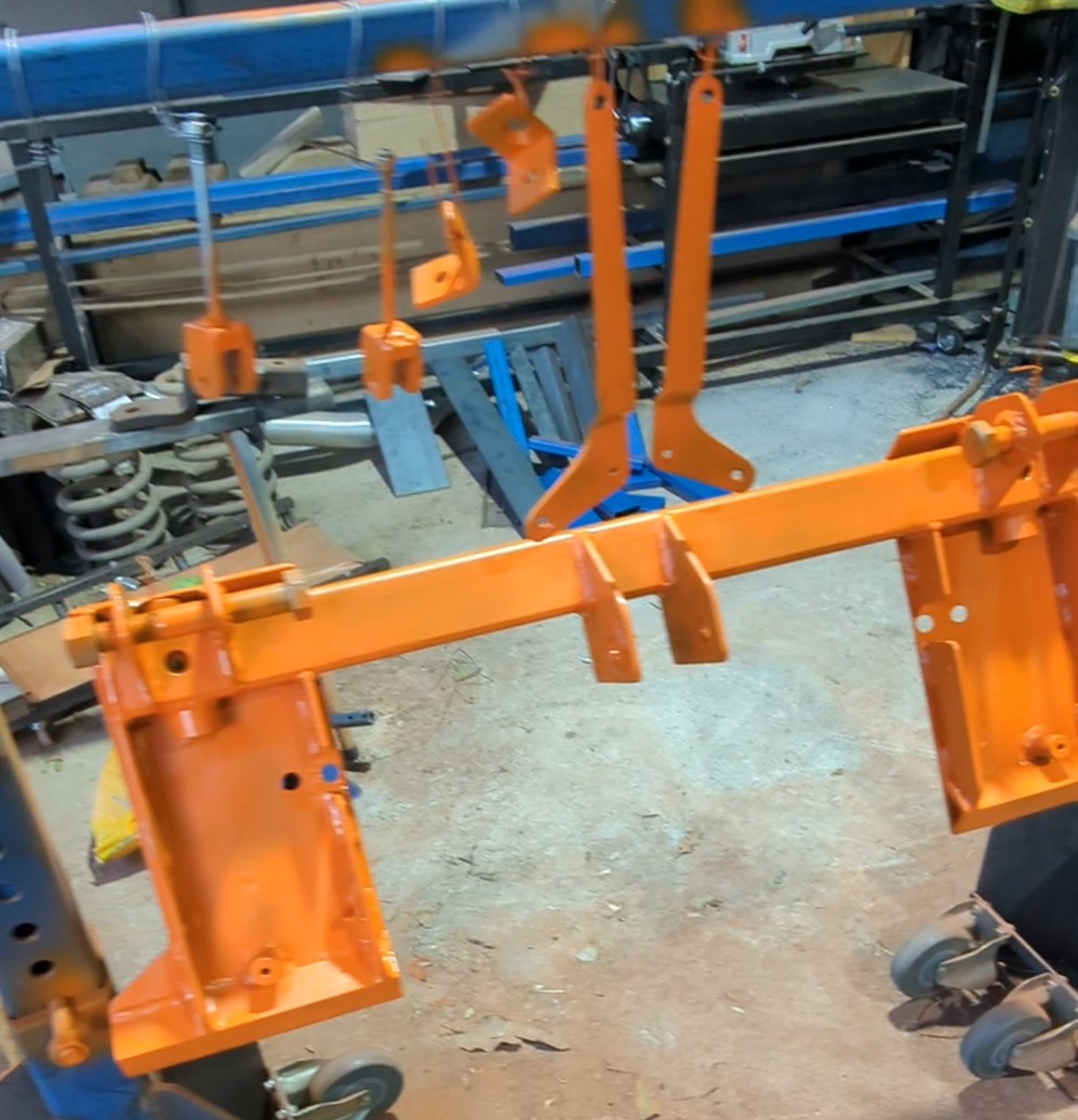

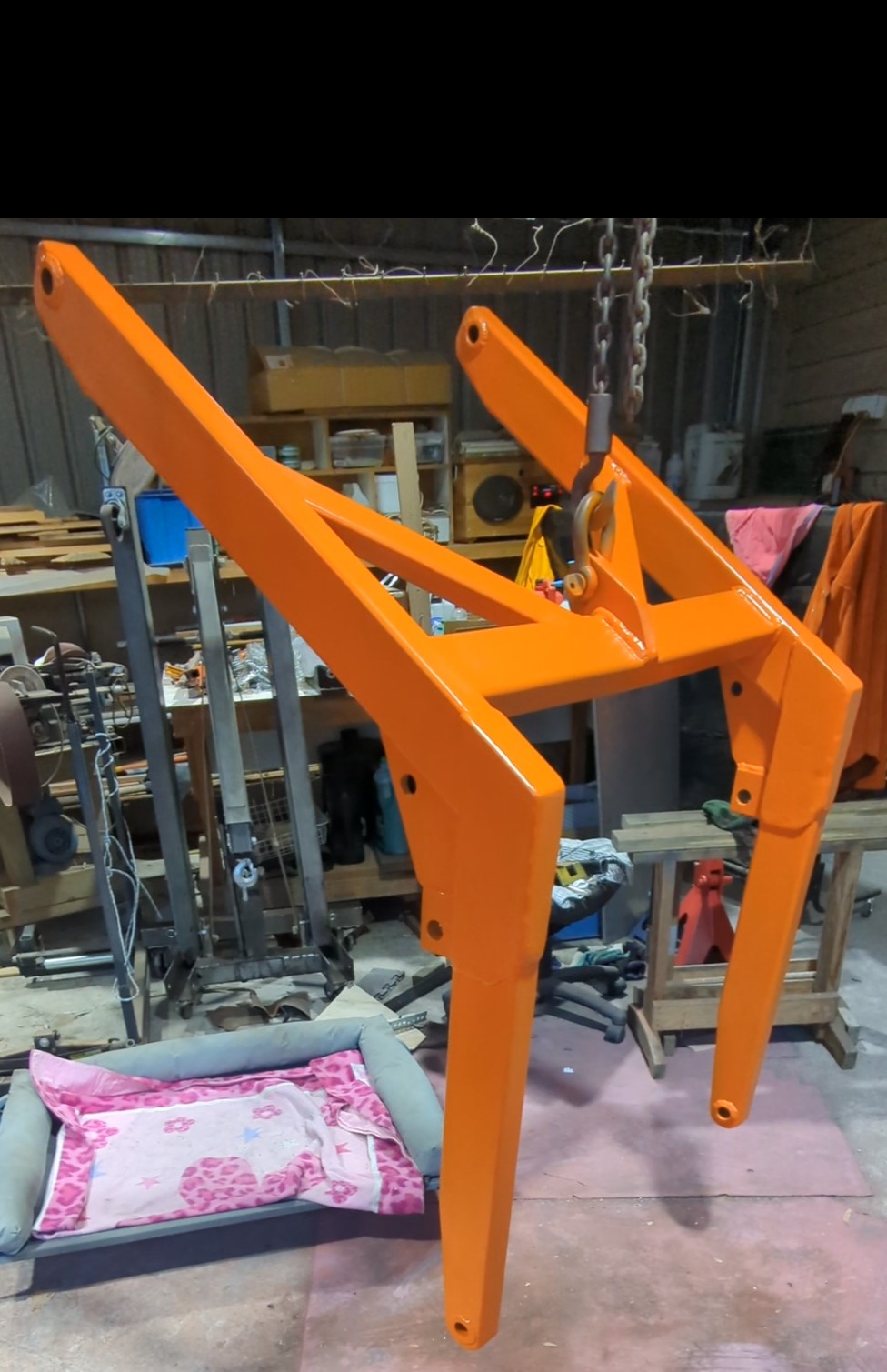

Orange, orange and more orange
Got most of the bits painted yesterday, will hopefully get it all attached to the tractor tomorrow. After that, hoses, connect everything and see if it works. I hope it does.
Then I'll make a brake press to fold the bucket and start on attachments. And make something for ballast - not sure what this will be yet - maybe concrete ?? Open to suggestions.
