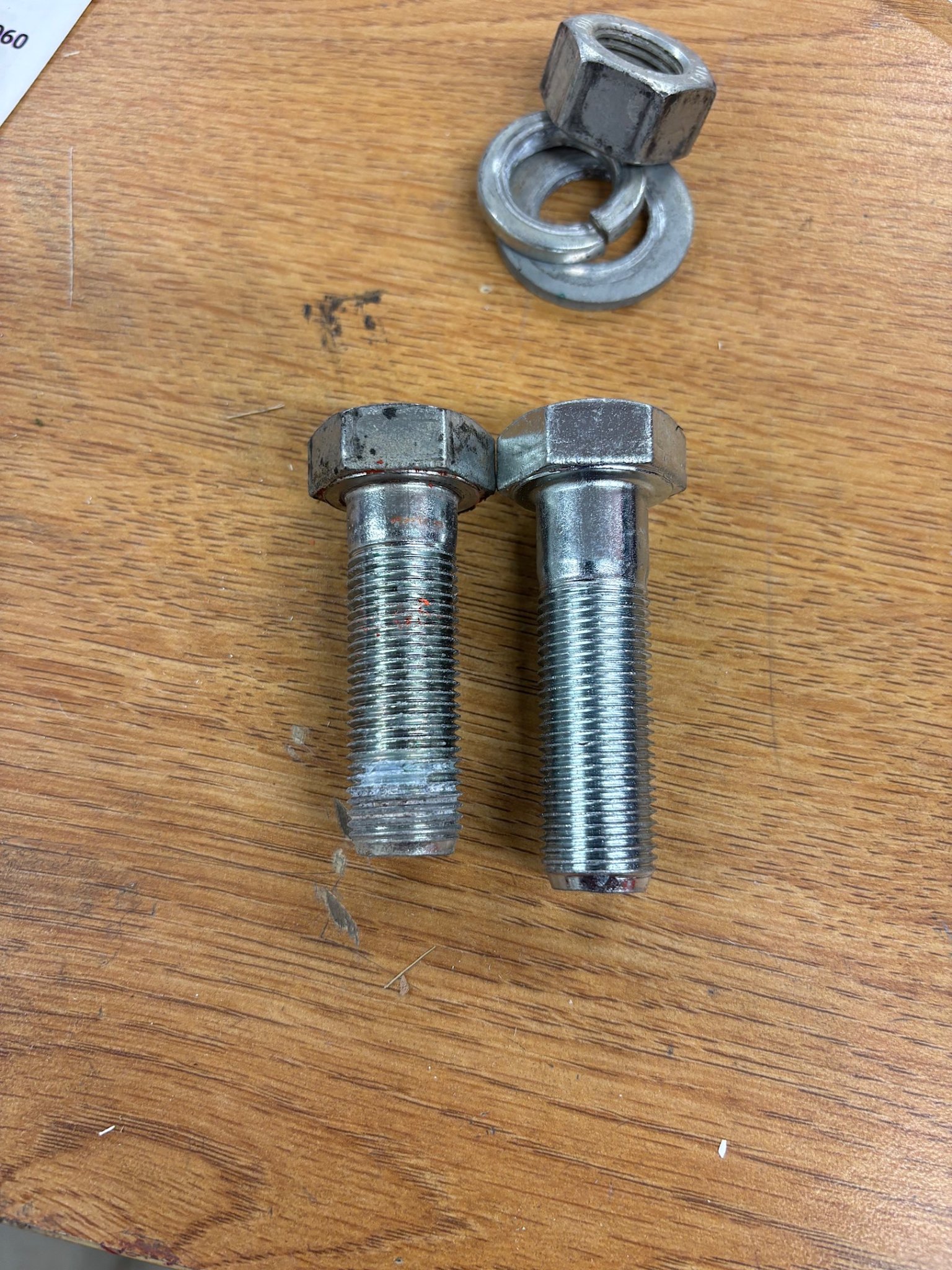

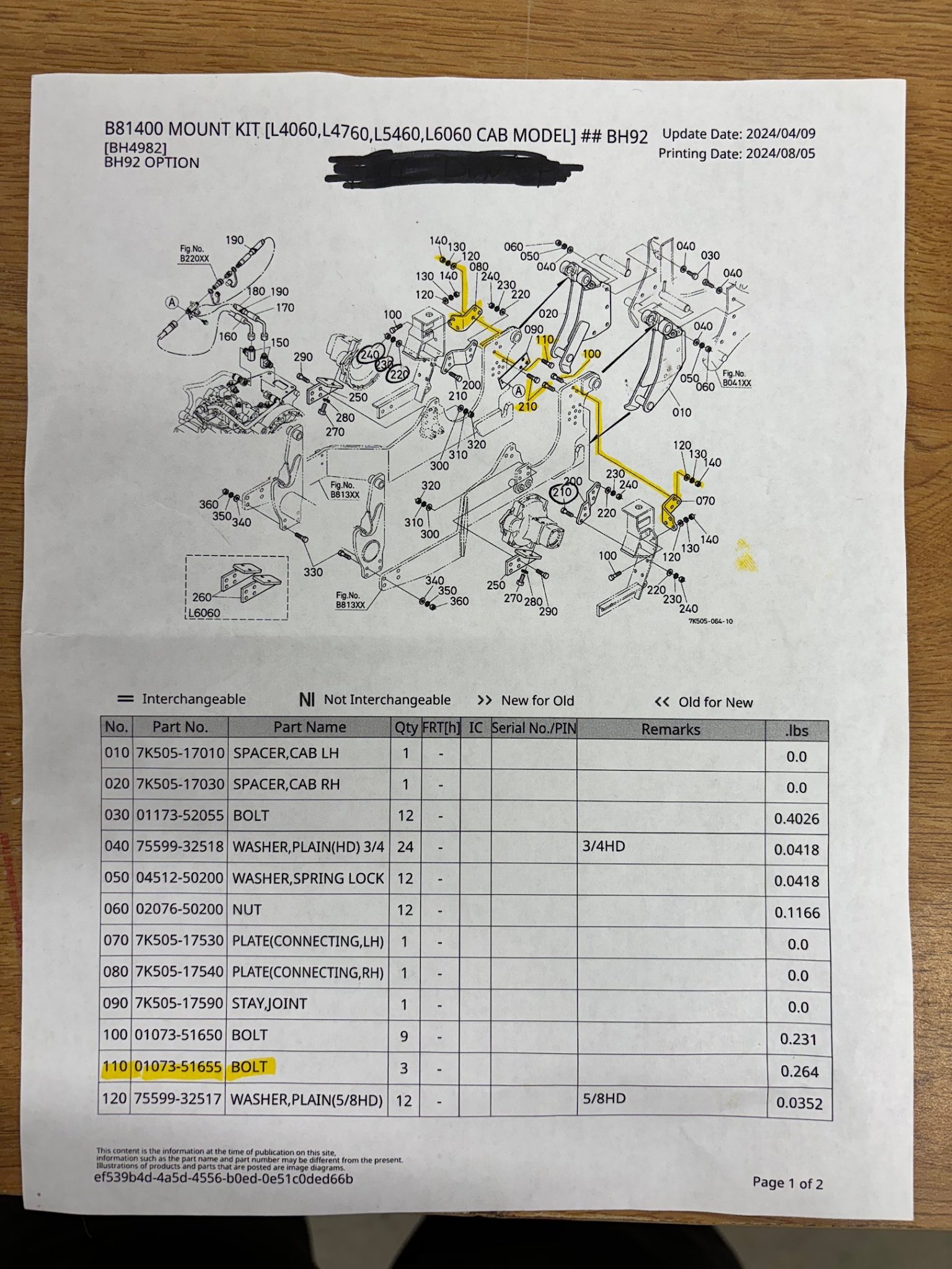

What I really like about this site is all the knowledge and if someone sees something wrong in your post, they respectfully let you know (well maybe @SidecarFlip was an exception).

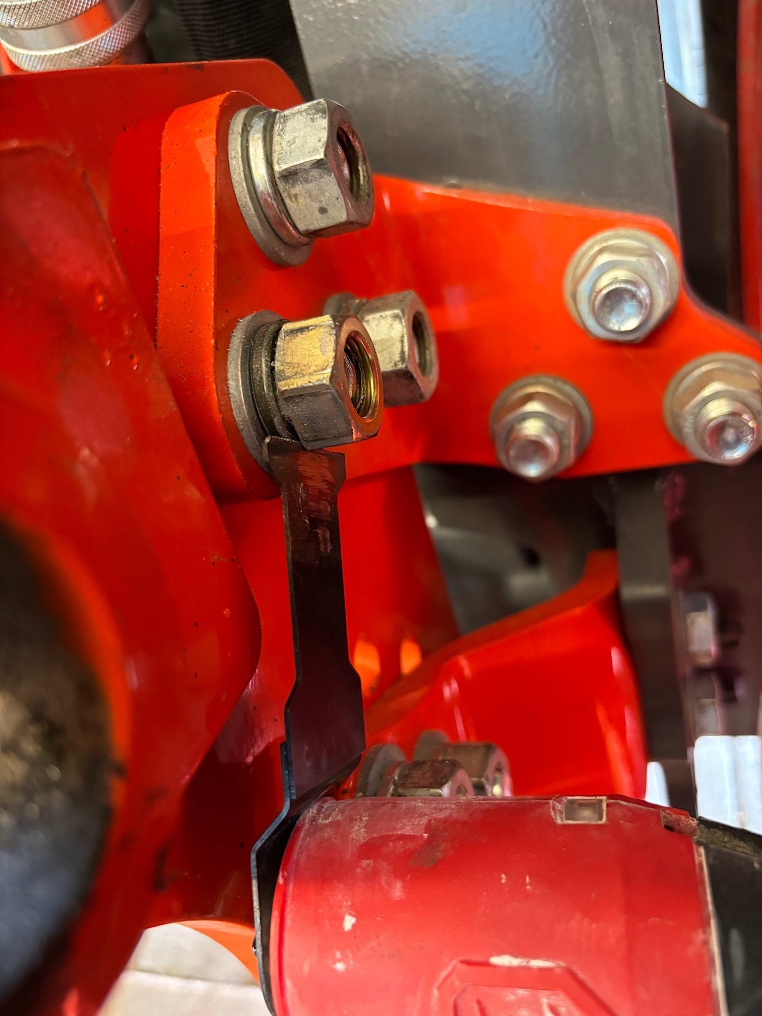

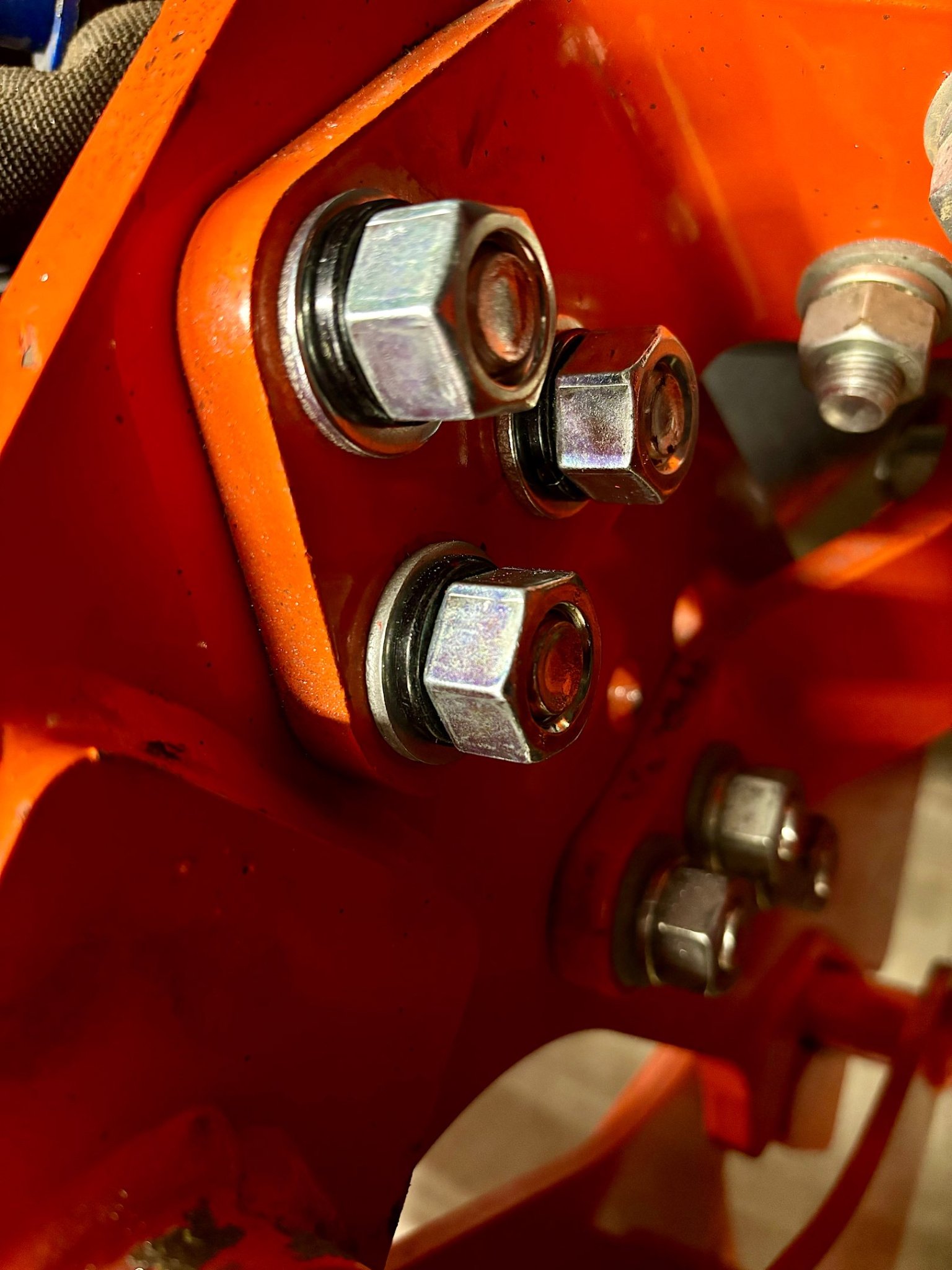

Thanks @lynnmor for questioning the bolt length in post 19,502. I got ahold of parts schematic and used sharpie to trace the bolt. Bingo - been ordering the wrong bolt for 2-years. Since I hadn’t removed 2 of the bolts it looks like whoever installed the subframe used the wrong side bolts for that piece too. There is a L and R and they are different lengths.
Here’s before and after. This explains why I was stripping bolts, not enough bolt into the nut when torquing to specs.
Thanks to everyone that commented and kept my brain thinking.
Big help but I would go another step longer, that would assure that you gain the last bit of strength and leave a margin of safety should a bolt begin to loosen. Bolts can be bought at numerous places and perhaps for a lower price, just be sure they are the same grade.
Just goes to show that sometimes it ain’t the length of the bolt, but maybe it’s if the bolt is in the right place.

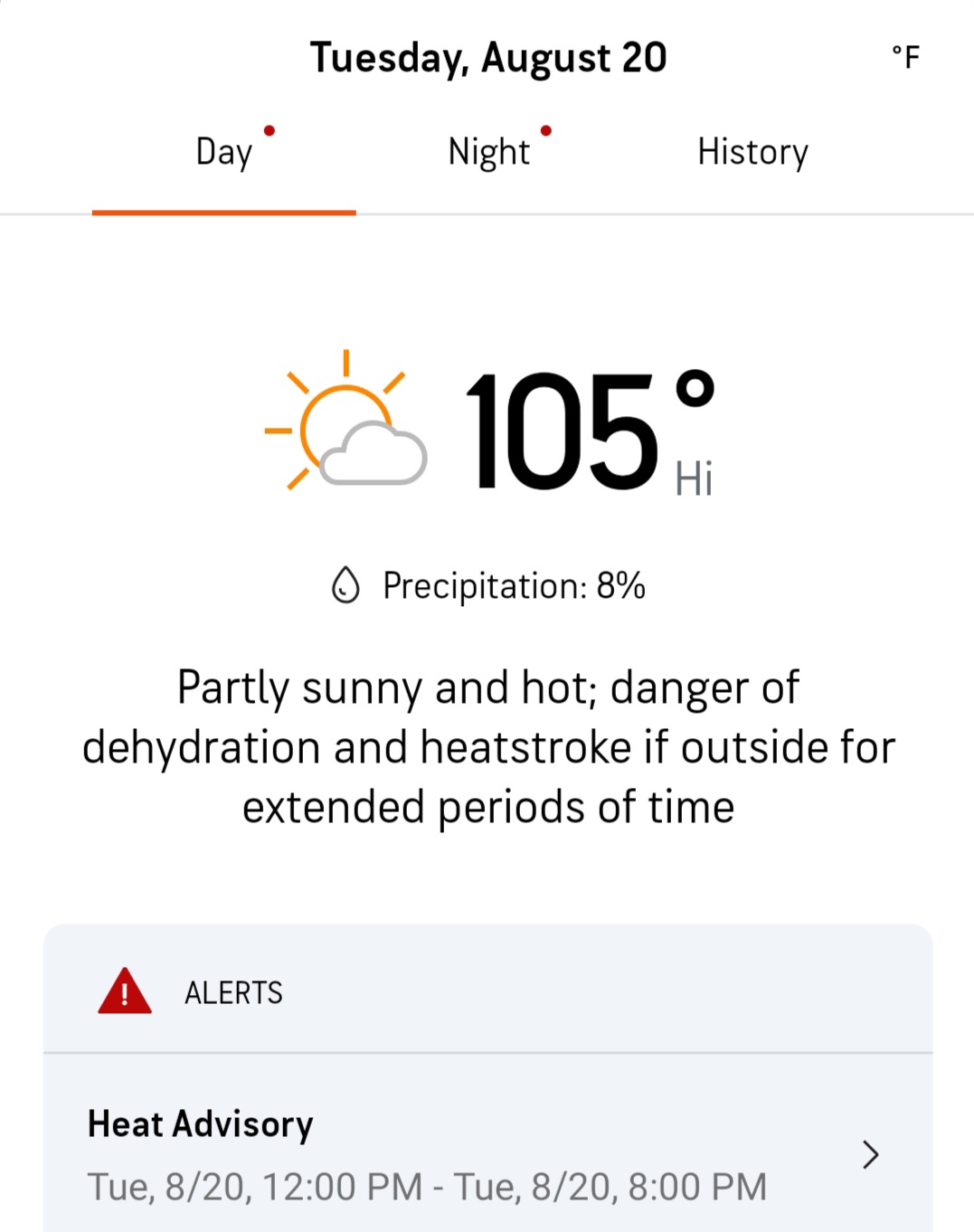

It's gonna be hot week here with the heat indexs hitting 115*.
When I stop sweating, I stop shreddin with the tractor, that means the humidity has burned off. I run into higher risk of starting a fire. If I get off the tractor to move or retrieve an object, the seat will heat up to over 150* in less 2 minutes. Finished my gallon of water before noon, I'm done for the day!
Yikes ! No way I could handle that,

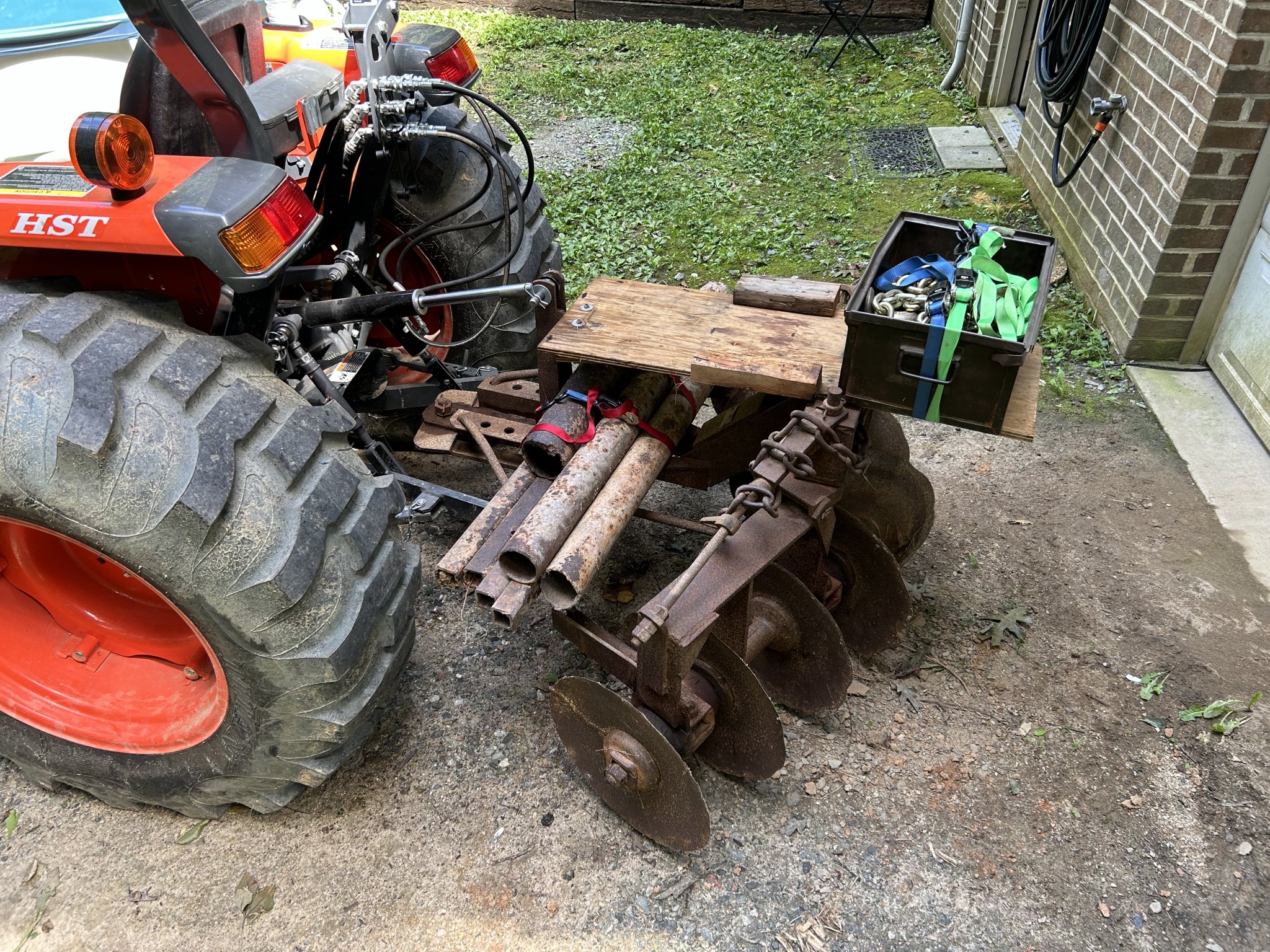

Since there wasn’t a lot going on today, spent a half hour with the forks digging this thing out of the back of the shed where it had a variety of stuff piled on it. When I was a kid, we used this thing in the garden and a couple of small fields. Other than driving with a carryall, it was the first implement I recall running. I could be wrong, but I don’t think it has been out of the back of the shed in at least 30 years. I haven’t used it in almost 40 years.
Covered in spider webs and unidentifiable gunk, but the axles still spin free and there’s something left of the discs. Hit it with the pressure washer a little bit and wire brushed the rust off the lift pins. The board on top is U bolted on to provide a tray for weight. The scrap metal, I don’t recall using but it adds weight as well and it was there so I left it. Put a total of 70’ of 3/8” chain and 16’ of 1/2” chain in a steel box and strapped it on the weight tray.
This was the before. Hard to see exactly how ridged up it is with the way it’s grown up. It is actually pretty rough. I bush hogged it once earlier this year. Had 10” to 12” stuff left in the furrows and 2” to scalping the ridges.
Took me a couple passes to get it working right even though it’s about the simplest implement there is. First, it’s way undersized for the tractor. Started out running around 5 mph. Even with the extra weight, it was bouncing around violently and not cutting worth a crap.
First thought was, this ain’t working; going to need a road trip for a better harrow. Second thought was, 40 years ago this thing would have gotten it done and it hasn’t changed so far as I can tell so maybe I’m doing something wrong. That and all that bouncing around wasn’t agreeable with the weight arrangement.

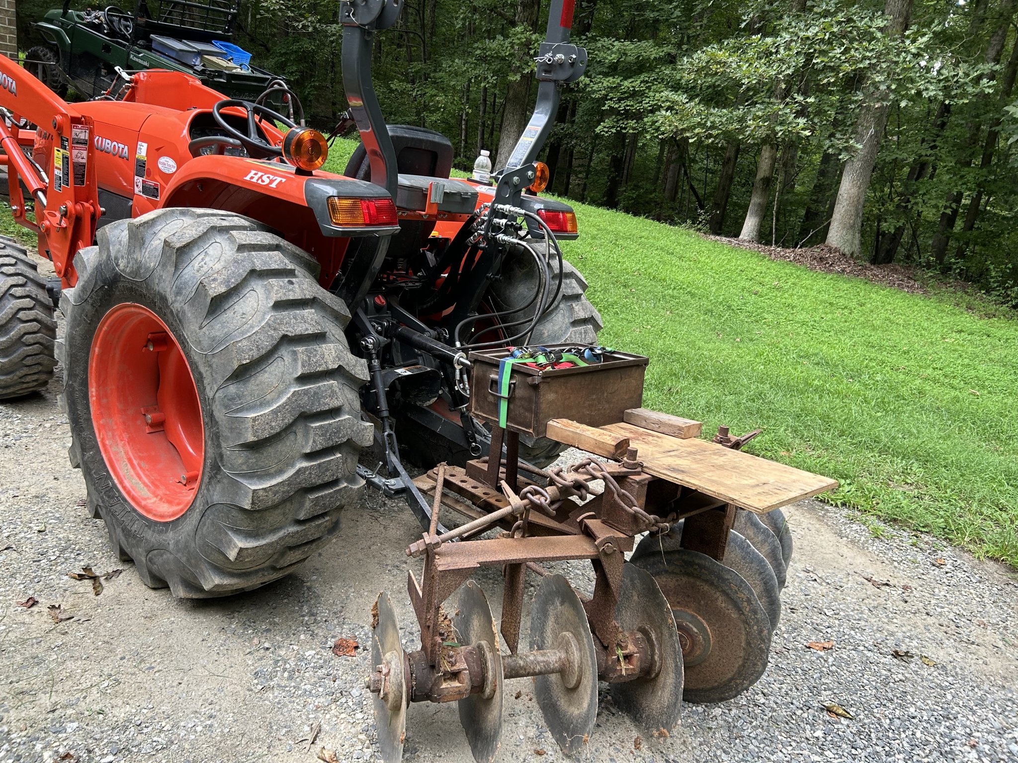

So back to the shop for a redo. Moved the chain box further forward where there’s some blocking to assist the straps. Deleted the scrap metal.
Back to the field to experiment with speed. Did a decent job going really slow and doing some half lapping. If I heard the chains in the box rattling, that sound meant I needed to slow down. Far from ideal but I reminded myself the other option was a pair of four hour round trips so even if it was slow it was probably overall the fastest method.
About 3/4 done a little shower popped up. Didn’t feel like it was going to last long so backed into the entrance to a short trail and spent about 15 minutes under the trees watching it rain.
This is the after. No, it’s not done. Didn’t expect it to be after one cutting regardless which disc was used. The ridges are gone. The eroded places are leveled. The top couple inches of the red clay field are disturbed and, while moist, aren’t overly lumpy. Pretty pleased with it for a first cutting.
Allegedly no rain rest of this week. After the dirt and vegetation dries some, plan to cut it again with full angle on discs, probably at a 45 angle to today’s cut. Then a third cut at 90 degrees to today’s lines with discs at less of an angle and a drag chained behind the disc. For now that’s the plan.
Been a long time since I’ve done anything like this. It started to kind of come back to me as I got into it a bit. There was quite a bit of switchgrass in it already and it’s a native grass so likely that’s what will go back there.

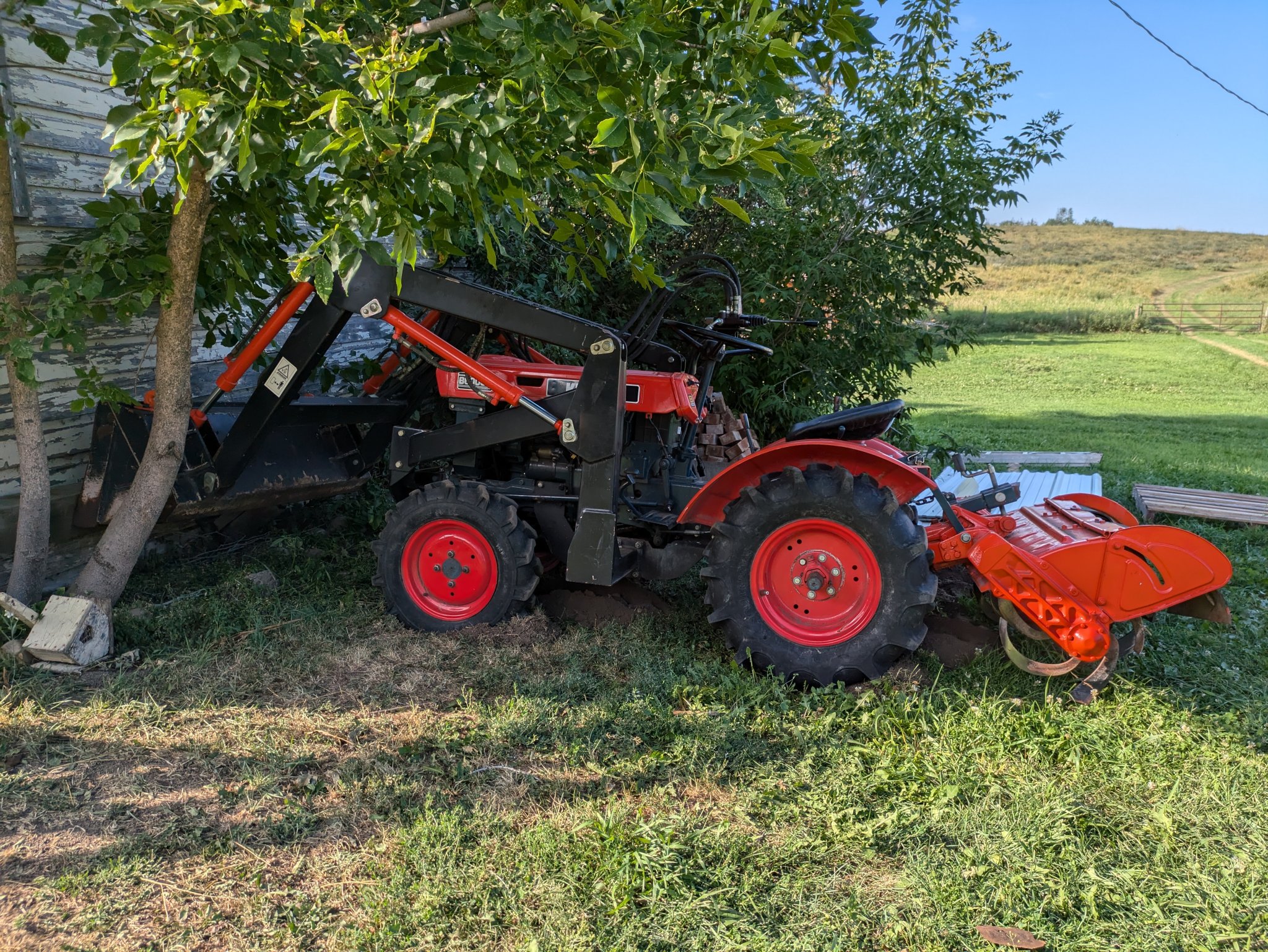

Used the B6000 to push the bottom of my brother's garage/shed wall back onto the concrete foundation.
Dug some holes in the process....
It was built in the 50's and didn't have any anchor's into the concrete.
There was a brick chimney anchored to the bottom of the wall and the weight of it bowed it out.
He removed the chimney and tinned the roof and wanted to true up the wall before fixing up the inside.
dang

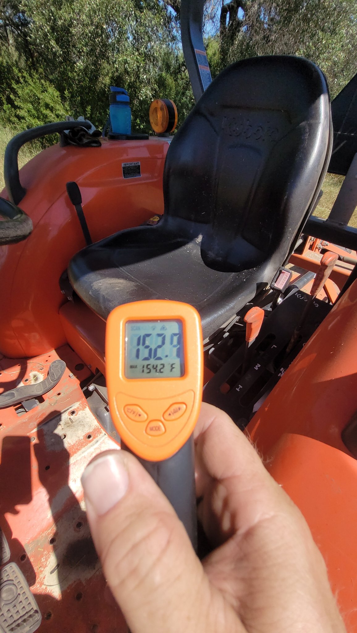

I'm gonna fill and top off the wildlife waterers today, extra salt/minerals for the cows. Yesterday at 4pm I measured the temperature of the shop concrete floor at 101* Items within the shop, atv, tool chest etc. was measuring 104.2* the galvanized metal on the shop was 126*
This week can't pass fast enough.
