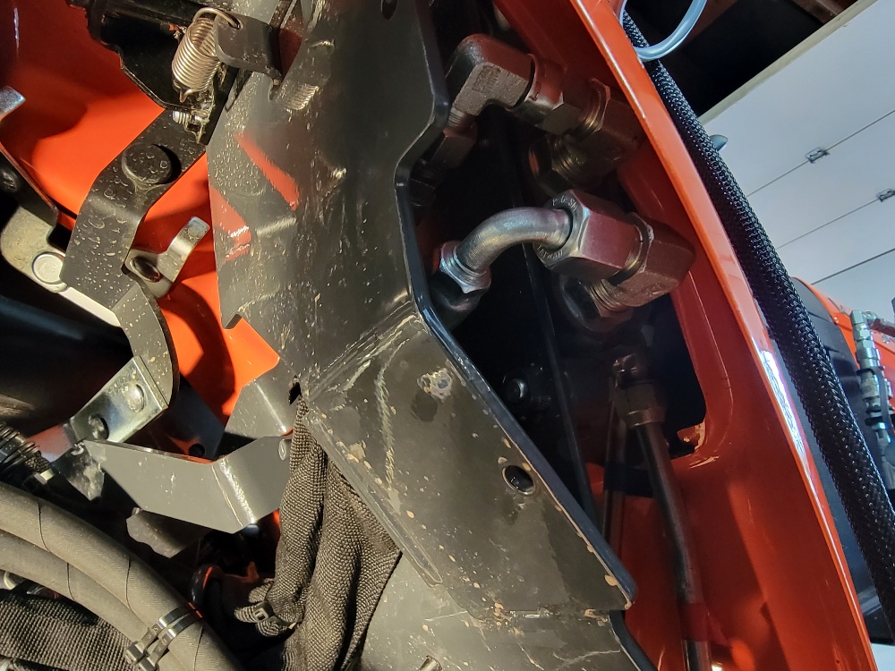

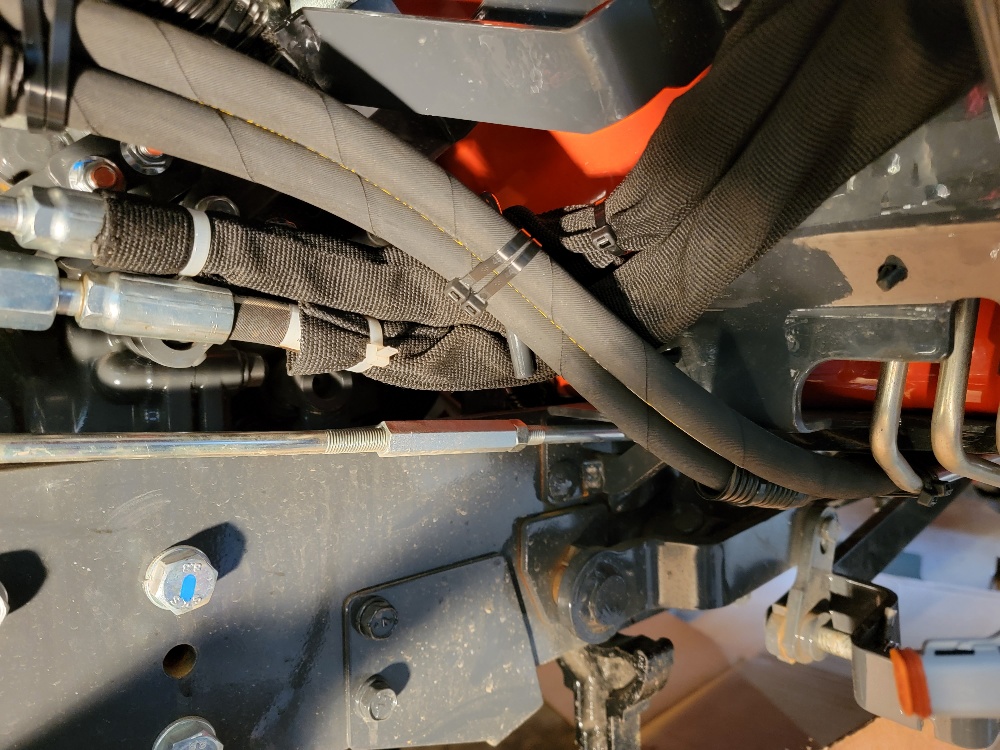

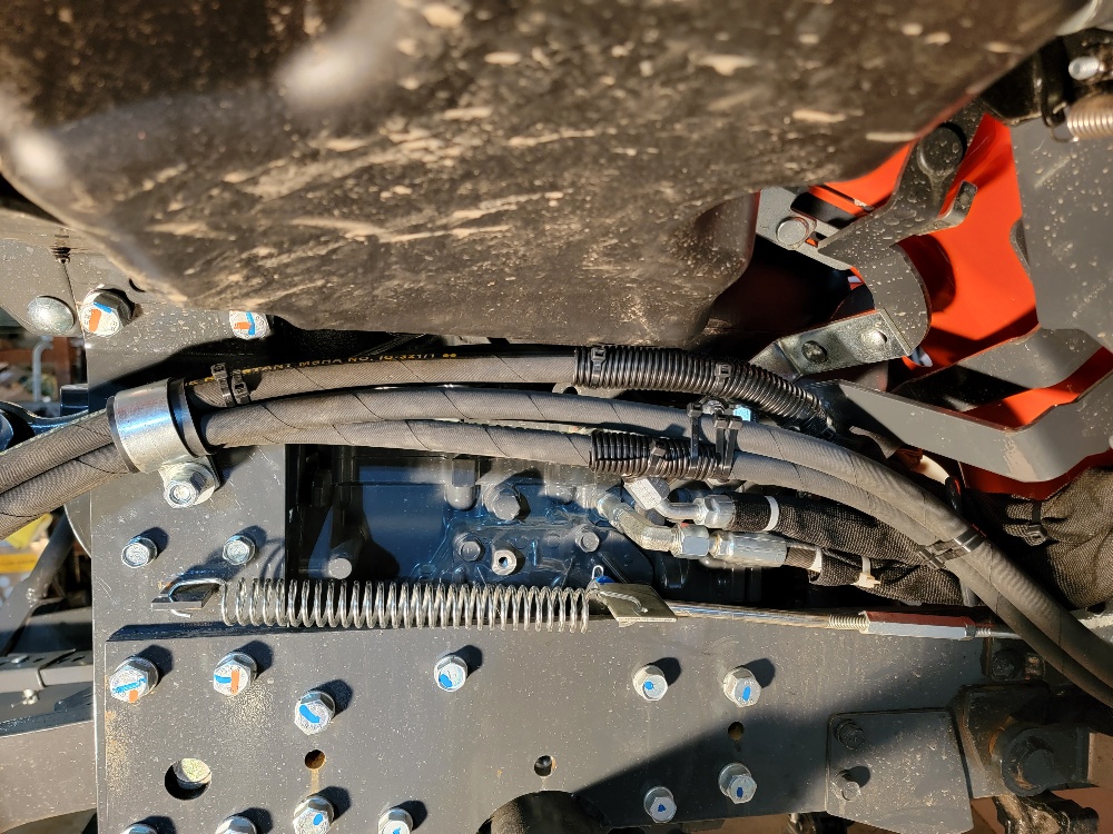

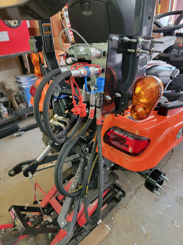

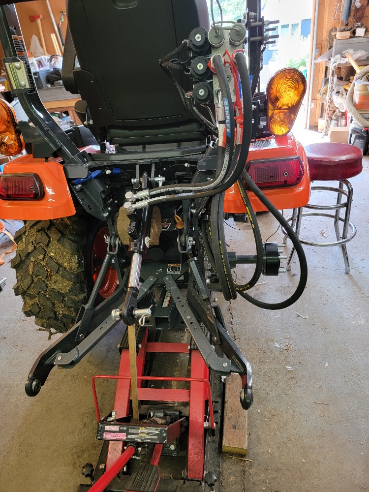

For those who wonder how the lines lay on my BX2380 here are a few. Showing 3 spool system with two rear remotes with feeder line to third function. Hydraulic lines-Tighty uo.jpg Hydraulic_Layout (1).jpg Hydraulic_Layout (2).jpg Hydraulic_Layout (3).jpg Hydraulic_Layout (5).jpg Hydraulic_Line-lay (3).jpg Hydraulic_Line-lay (4).jpg Hydraulic_Line-lay (2).jpg
Thought I'd added show a view of how the 3rd function line and connection went forward. SideView-mirrors (1).jpg

A little excess line on BX, which could be corrected. they come into contact when lifting implement. this may cause so premature wear on lines. I did let Summit know this with marked photos. and I also wrapped hyd. lines, enveloped with radiator hose to cut down on chafing, just a little extra protection.
