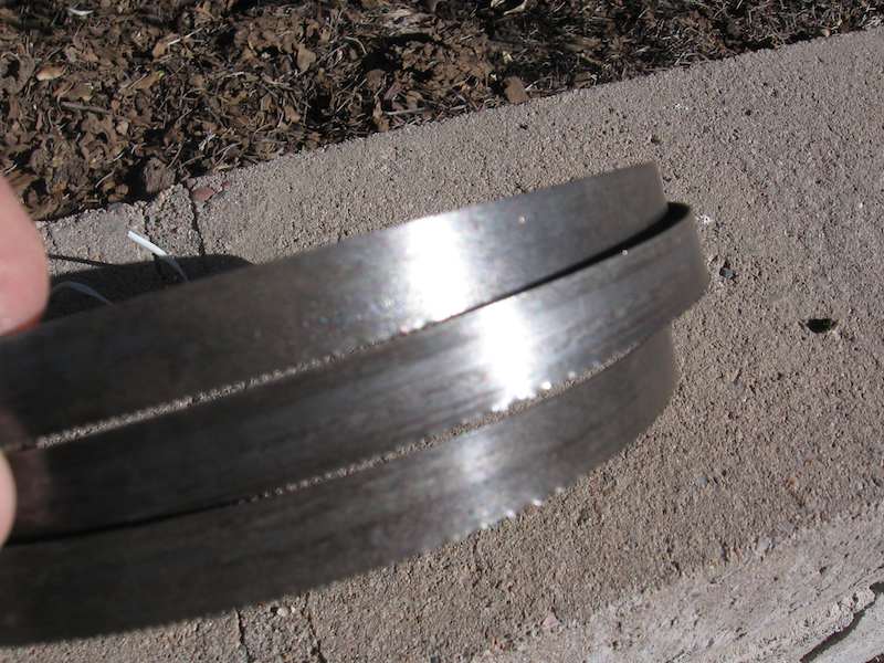

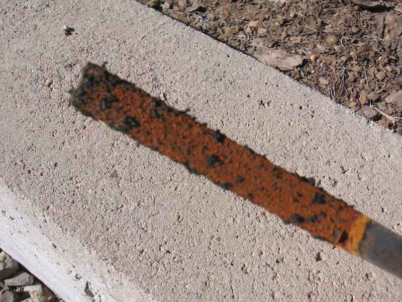

Been rebuilding/repairing an old 1960 era Sears horizontal band saw. Besides being abused & missing a lot of parts, it had been stored outside for years. The saw came with a couple blades which did not appear to have much (if any) use on them, unfortunately they were pretty rusty. Seemed like a good time to try this electrolysis rust removal process.
Used an old plastic tub, 4-5gals hot water, 4 heaping tablespoons of A&H washing soda, battery charger @12v & 10a, 4-5 hrs, flipping the blade a couple times. Pics show before, during, the cathode after 2 hrs, and the results.

Lil foot, those baby's look brand new!!!

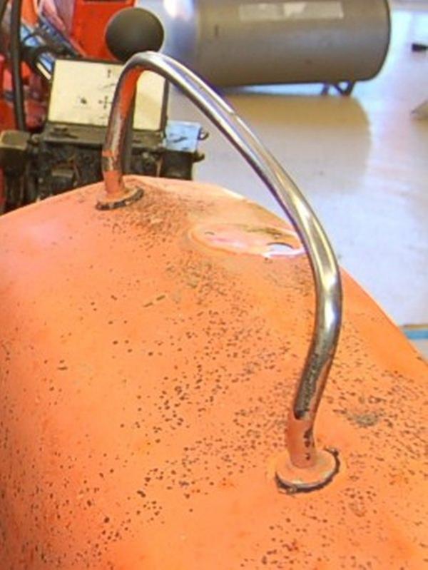

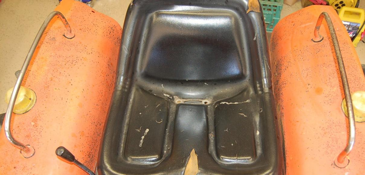

So, I have been sitting here quietly in the background watching this process,
and wondering, rust = good, paint = better, how about rusty chrome?
The rear fender handles are something I have been wondering how to "fix"?
Any thoughts?
Even my wife was impressed! I hit them lightly with a soft stainless brush as a final clean, but it did not take anything off, just shined them up a little. This process will definitely go into my "bag of tricks".
Any thoughts?
Mine are rusty too. Ran them through the tank, and it knocked some of the plating off. Getting impatient though :rolleyes: Gonna hit them with some 80 grit and paint them black :D

Bill, I will tell you how to clean rusty chrome. Sounds silly, but don't say anything until you try it.
Take some aluminum foil, wad it up in a ball (something like the size of a golf ball), dip the foil in some water. Rub wet foil over rusty chrome. It removes rust, just like that!
Cleaned many a chromed bicycle fenders this way.
I will give that a try, but I was thinking more along the lines of removal,
then I could (cost dependent) have them re-chromed.

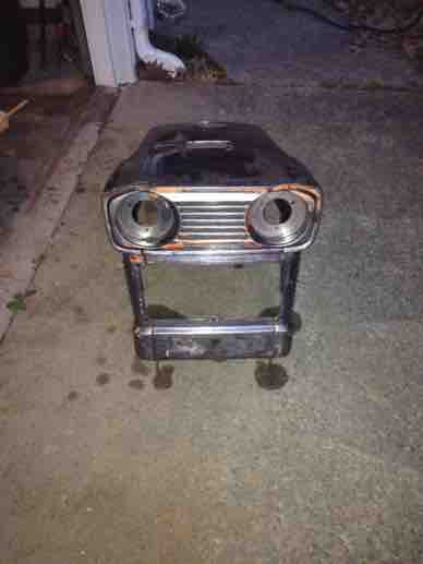

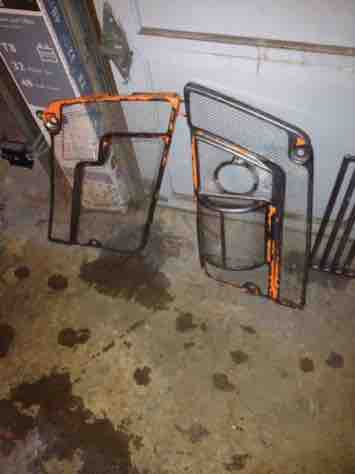

Getting closer to done. Been working on stripping the rest of the paint that has been stubborn.
Two pieces are done. :D The grill, and coolant access cover. The hood is almost done. Got just a couple of spots being stubborn.
Gonna have to steam clean the hood to get all the crud out of the nooks and crannies.
Side covers are a work in progress. The small expanded metal in them makes it a chore.

I sandblased my screens, but then i have a large blast cabinet. Makes all kinds of ugly go away.
