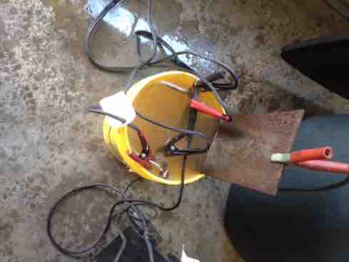

So I set up another experiment with electrolysis :D

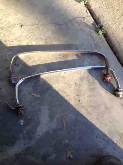

The handles for the fenders :)

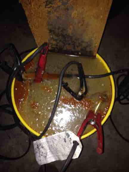

Put the handles in a five gallon pail. Put a chunk of steel in there. Made sure they wouldn't touch. Filled the pail with solution and fired it up.
Getting much better results :D
Just went out and checked. The rust has turned a bright orange and getting some slime on top :D
So as near as I figure, the bigger the piece to derust, the more metal is needed for a conductor :eek:

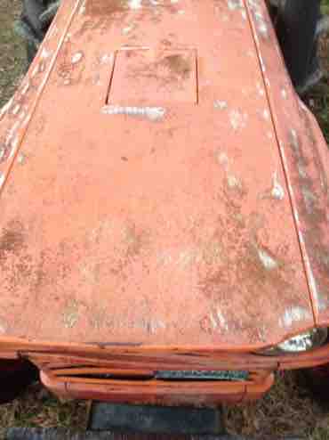

Thanks for showing this Daren! I was wondering what was going to be the best way to try and salvage some of my sheet metal. I just hope I can find a container big enough for my hood.

I don't know how well it will work for the bigger stuff. I sure didn't have much luck with it. It is working great in the five gallon pail though :rolleyes:

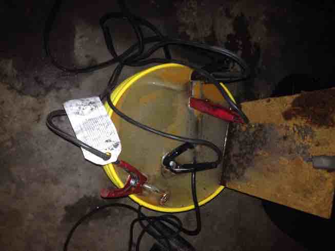

The five gallon pail is looking more promising :D
Checked it this morning and there's a bunch of funk on top.

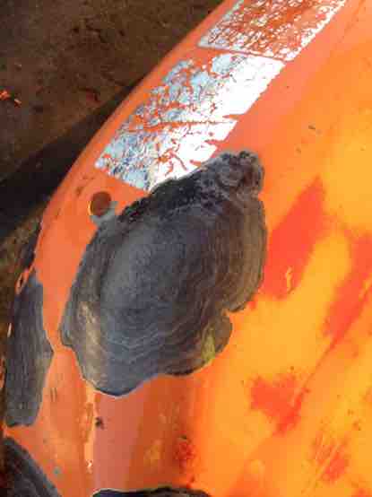

So here's a pic of the two fenders. One on the right went through the tank hit with a pressure washer and then wire wheeled with a die grinder.
One on left was just hit with a pressure washer and then wire wheel

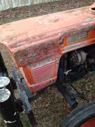

Here's the previous owners handy work. Looks like they tried to address some rust issues before. There attempt was to hit it with a wire wheel for a bit. Said screw it, and rolled on some paint :rolleyes: yes, they rolled the paint on!!!! I found parts of the original l1501 stickers and wire wheel marks when I steamed off the the pink paint :)

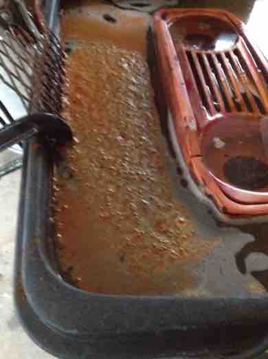

Here's the tank after the hoods been cooking for the night
sheepfarmer
Nov 14, 2014
4,441
677
MidMichigan
Not sure how fast your bath is working, but you might want to flip your part more often than every 24 hrs to avoid getting a line where the water line is. My theory is from using a similar method to electrolytically sharpen fine wires by dipping them in and out of the air solution interface with the power on. Same for applying a silver chloride coating. You could see it working, bubbling right at the interface, more than deeper in the beaker. Could be an artifact of the shape of our parts, wire, but just in case.

Here's a recap, and some things I figured out along the way :)

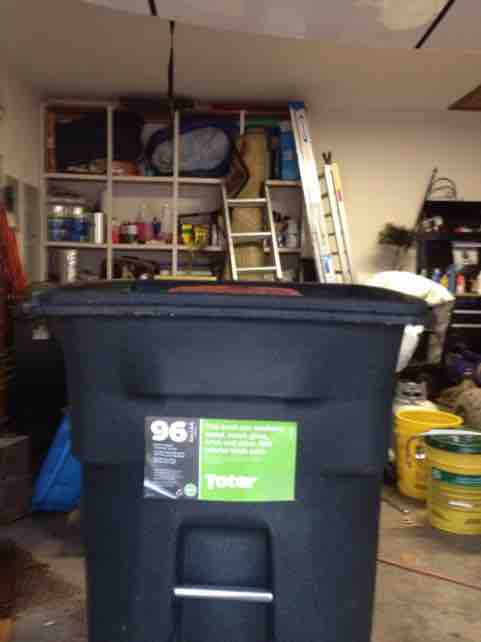

The solution: Mix 1 tablespoon of arm & hammer super washing soda per gallon of HOT water. It dissolves easier. I filled a 5 gallon pail in the kitchen sink and used a wisk to mix it.
Find a suitable container to fit it in :rolleyes: If I did it over, home depot sells a storage lock box that was rectangular in shape and would have fit the hood perfectly :eek: I should have just purchased the tote instead of using our roller trash can that we had. I could have laid a couple 2x4 on the bottom of the tank, set what I was cleaning on them. And got better coverage on my scrap metal pieces along the edge.
Clean any flakes of the piece going into the tank. It also seemed to work better getting any grease, and dirt off as well. The fender and hood were pressure washed before going into the tank.
Clean the metal pieces lining the edges of the tank that the positive hooks too. In this case, just buff them down with a grinder. Pay really close attention to where your cables hook too it.
Clean a spot for the ground cable to hook to the piece that is to be derusted :p process won't work without a good positive and negative connection.
Try too keep the metal close to what's being cleaned with out touching. 1 to 4 inches seems to work really good. And the more positive metal in the tank with the part, the more dramatic the reaction in the tank.
If the process seems to stall out. Pull the scrap metal pieces from the tank, and clean them again with a grinder. Hook the positive back up to them and place back into the tank.

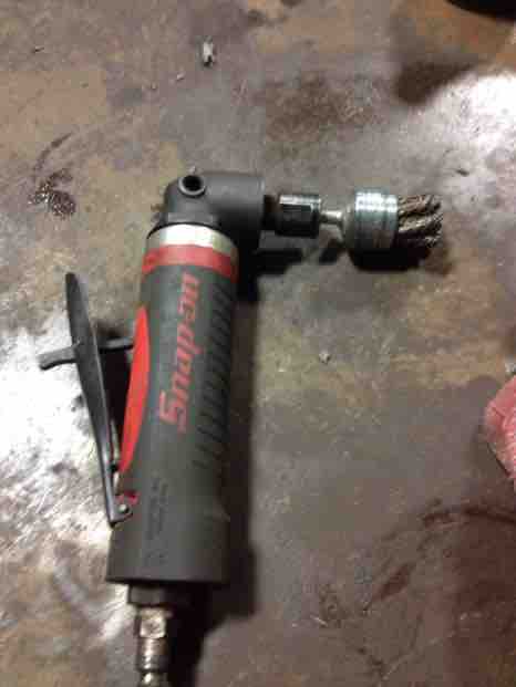

A Heavy Duty Wire Wheel is the ticket for cleaning the oxidation off the part that was cleaned. 2 minutes with the wire wheel, compared to a 1/2 hour scrubbing with a stainless steel brillo pad. Here's a pic of the wire wheel I used.

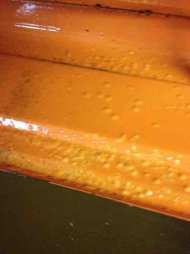

Not sure what's different this time around. :confused: But............ It's bubbling the paint off the hood :D
The only thing I can figure, is the mix was originally in cold water. Mixed the water yesterday up hot. So the water is warm.
My coworker had said his plating process didn't work worth a darn using cold water. The same must be true for this process :rolleyes:
