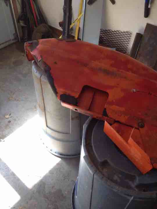

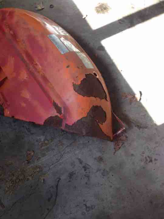

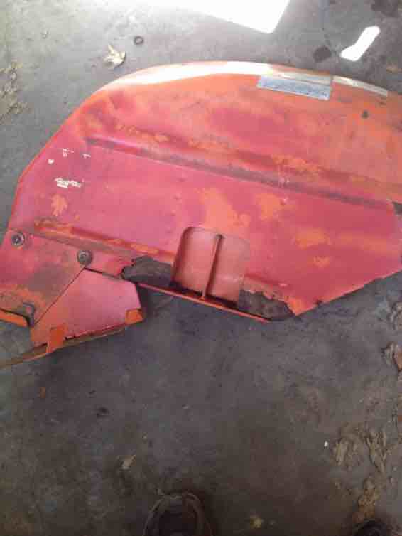

Anyone got any tips, recommendations, products for extensive rust removal?
The bota has extensive rust on the fenders that is spreading. :eek: looking to attack this thing once and be done with it :D
