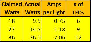

200mph
Mar 3, 2017
1,229
66
PA
GK527,
I'm using the same 6.5" lights and tested the current draw. Each unit consumes 2.06 amps when powered by 12.60 volts. You have plenty of extra capacity with the 10 gauge wire and 30 amp fuse.
I've been very satisfied with the light output these lights. Did you find them deficient another light bar is being added?
gk527
Kubota B2650
Apr 6, 2017
140
Central Kentucky
GK527,
How did you test them? That’s something I haven’t learned yet. All I did was take the watts/volts=amps calculation.
No these lights are great. I’m just adding the additional LED spot for range since the others are floods. I really don’t need it but I already have the mounts and open spots on the fuse block. Why not. First time I’ve ever done wiring like this. It’s fun! Ha!
Next I might add some single row small lights under the floor pointing to the side. Who knows. I’ve got the bug now to keep modifying.
200mph
Mar 3, 2017
1,229
66
PA
How did you test them? That***8217;s something I haven***8217;t learned yet. All I did was take the watts/volts=amps calculation.
Used a power supply, volt meter and of course the lights themselves. I actually test a number of similar LED lamps of the 18, 27 and 36 watt variety.
Set the meter to DC current and adjust test leads to meter accordingly... It's rather simple if you have a common test meter.
Here's a link that demonstrates how to measure amps (not mine). Ironically the youtuber tested 27 watt LED and got the same values as I did in the attachment.
https://www.youtube.com/watch?v=5xMDWzUPk_w
Hope this helps.
