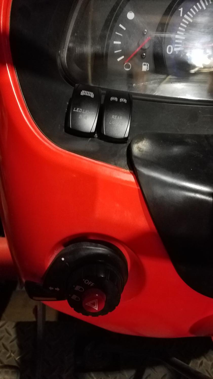

Switches on dash

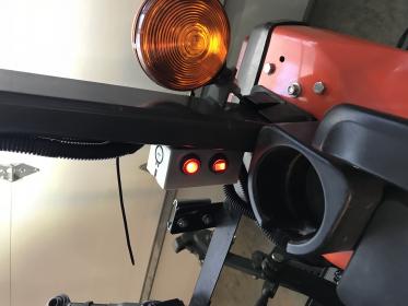

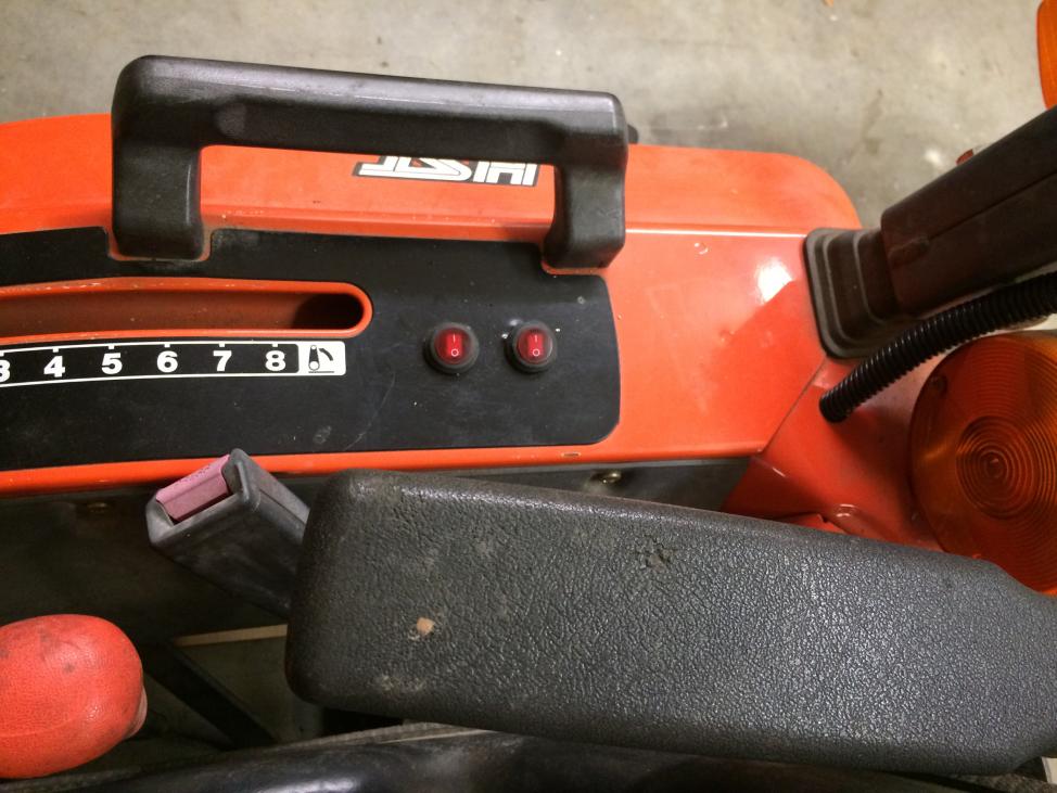

I started with a piece of 3” wide channel iron, which is the same width as my ROPS. I drilled holes in it to mount the lights and to run the wires through, then cleaned it up and painted it and the U bolts black with Rustoleum. Using channel iron gave me easy access to the wires when installing and it hides the wires after it’s installed. The wiring is in black corrugated conduit held to the ROPS with black cable ties and I ran it through the body near the turn signal. The switches are weatherproof (IP67) and mounted right behind the TPH control – one for the light bar and another for the two rear facing working lights.
The lights are a 72W 12” Nighlight light bar facing forward and two 18W 4” Nighlight work lights facing backwards. For the wiring I used pre-made harnesses with relays, fuses and switches all in one . I did need to solder on some additional wire to make the run to the lights, but not for the switches. I used connectors near the lights, so I can remove the assembly as one piece without cutting or removing the wiring.

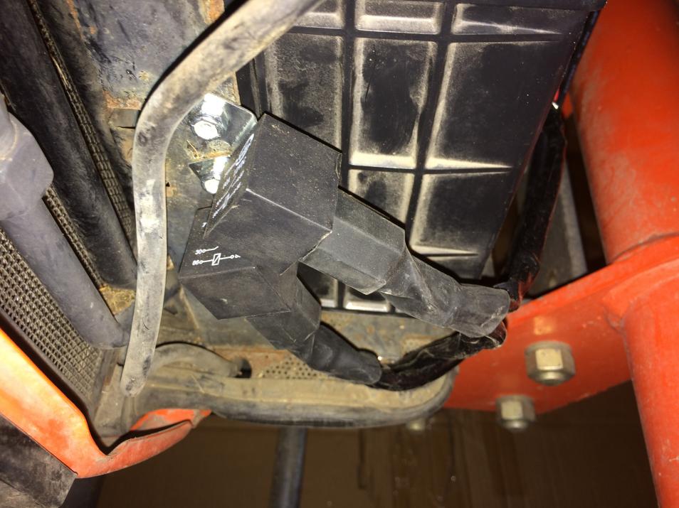

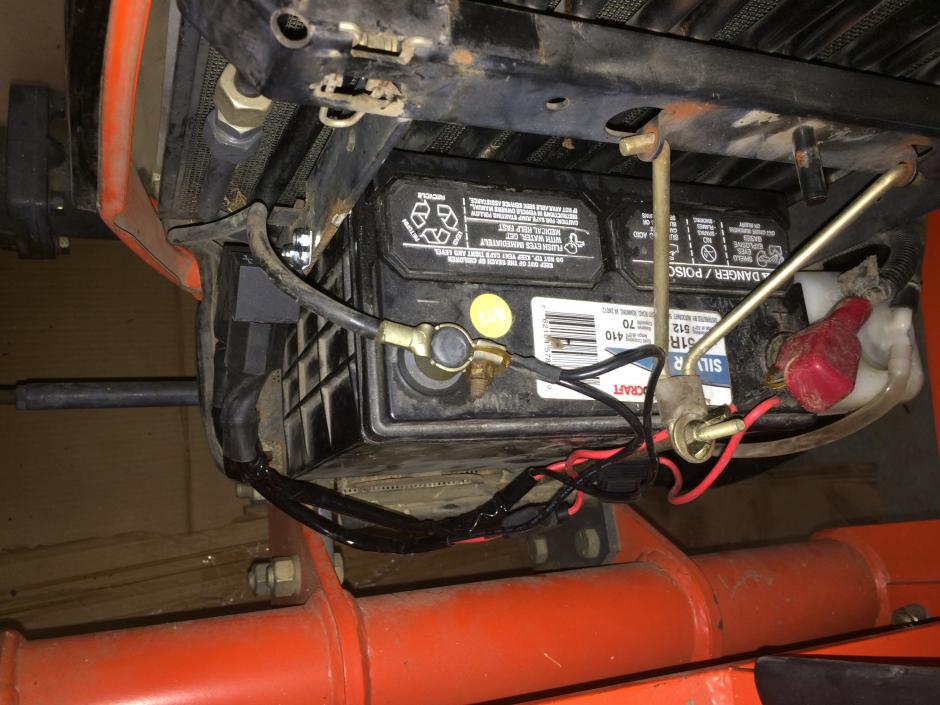

Thanks for the compliment. I used two of these wiring harnesses:
https://www.amazon.com/gp/product/B0727Y6F5K/ref=oh_aui_detailpage_o02_s00?ie=UTF8&psc=1
I’ll try to get a pic or two tonight, but here’s the gist for how I hooked them up. The harness connects directly to the battery and I connected mine to the bolt that tightens the battery cable connection to the battery post since the connector is not large enough to fit on the post itself (the picture will explain). I didn’t feel the need to swap out the connectors for ones that will fit on the post, but this could be done pretty easily. There are short leads to a relay with a 15A fuse on the positive side. The relays have a short piece of metal with a hole in it (possibly a heat sink), so I used that to bolt them to a vertical metal bar next to the battery and in front of the radiator that already has holes in it. The relays have two sets of wires coming out, one to the switch and the other to the lights (it’s the ones to the lights that were not long enough and I had to solder additional wire on). I drilled a hole in the ventilation plate under the battery that allows air to the radiator, so I could run the wiring underneath the tractor.
The lights are not connected to the ignition. So, for better or worse, they can be turned on while the tractor is not running. I’m not overly concerned about accidentally leaving them on or them being accidentally turned on. They’re bright enough and close enough to the house that I’ll know if they’re running.
As for the current draw, with all the lights on I’m looking at 108 Watts, which is 9 Amps.

Here's the pic of the relays and the battery connections. I hope it helps.
