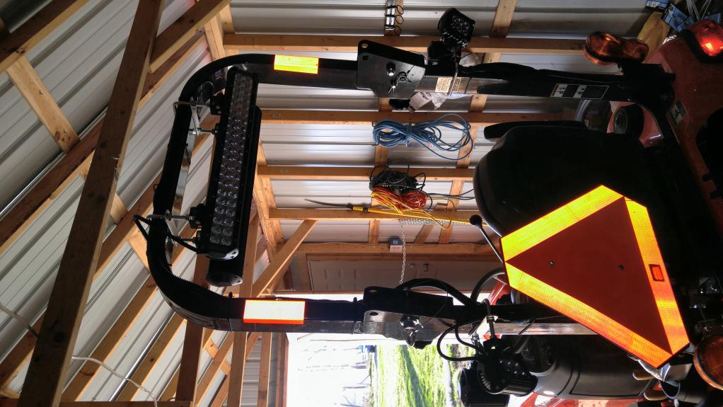

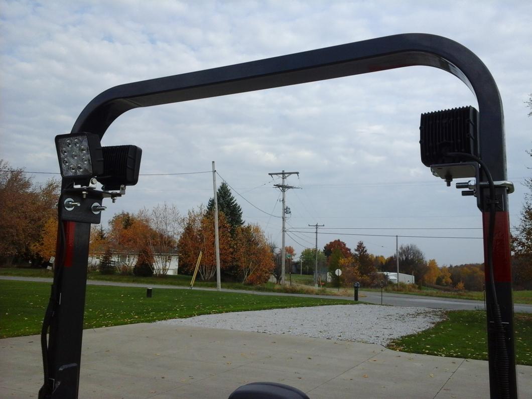

Hopefully these will turn out well. I used stake bed pockets that measured 3x1.5 inches and used flat stock to mount across the top of the stake bed pockets to the ROPS. I painted the pockets and top brackets the ROPS grey. The LED light bars are 12inch 72watts. The lights are IP68 rated so they're good to go for weather up this way.
I used a wiring harness that has a remote key fob to turn on the lights. Just need to run the wires and make them look nice and tidy before getting into anymore working with it.
When I was checking out how to power it from the rear, there was only two wires instead of three....one black ground, and one red with black stripe. I guess the newer BX's have the 3rd wire.
All and all, I think it turned out pretty good as far as a solid mount setup and the wiring was pretty simple.
I looked at stake pockets, too. Maybe try them for a different mounting location, but this one works, except it should have been on the left side.
I'm left handed, and tend to look over my right should when backing up. The location I used tends to be in my eyes when going in reverse.:eek:

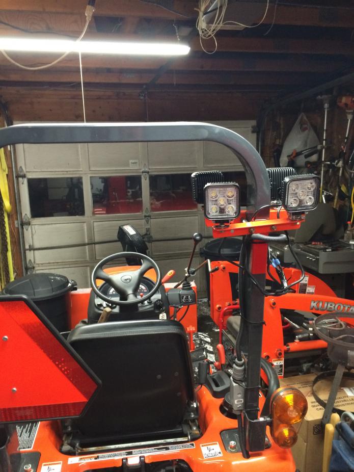

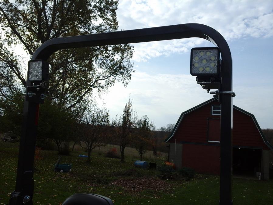

Well, decided to try a high mount. Nothing fancy; just angle brackets.
10,299
7,304
Came out pretty good. They clear my noggin so far.

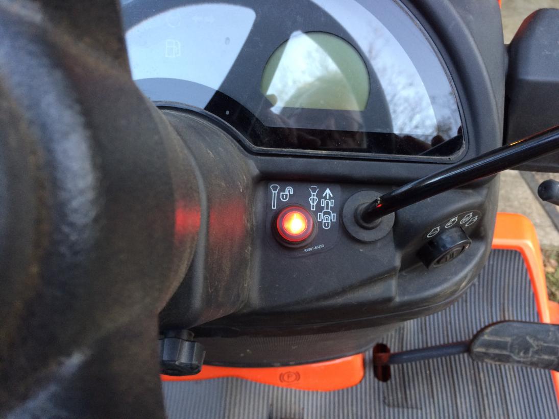

Realized my switch got broken over the summer. [emoji31]

Watch your head. I would probably bust my head on the bottom of the brackets. Well probably long before that, I'd lose them from a tree.
I like the height. You won't be getting blinded by them as I can with mine.

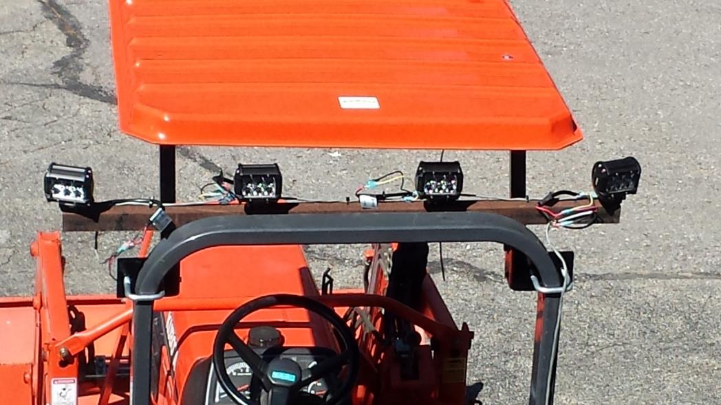

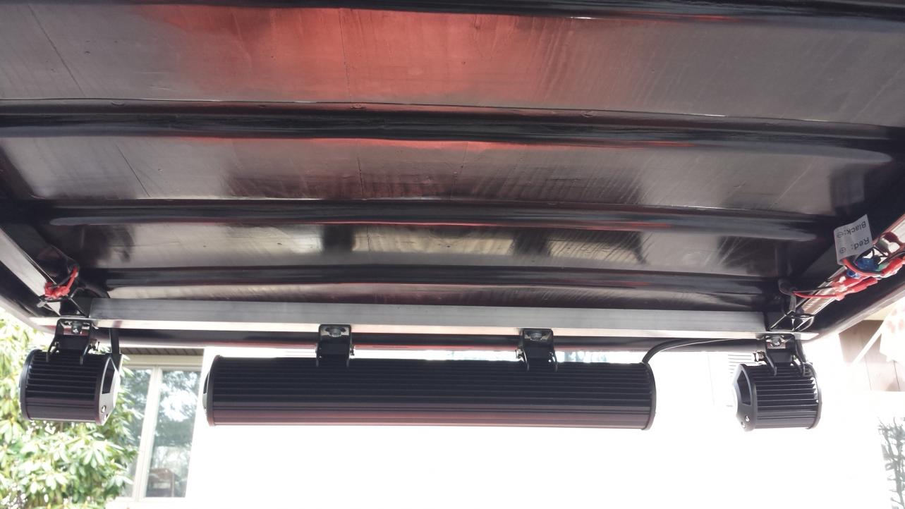

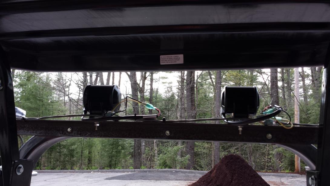

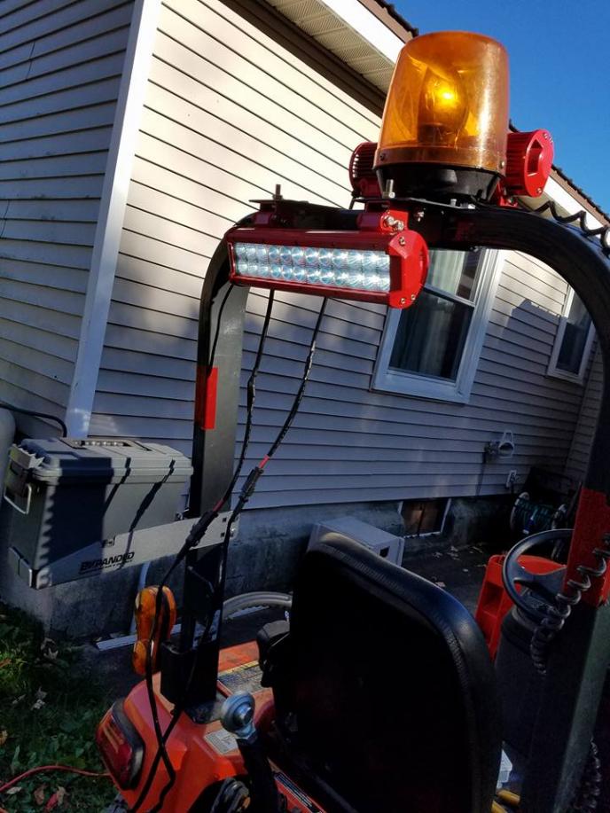

Just realized I never put up pictures of my ROPS lights. I installed a canopy and updated my lights after installing it. Here are the pictures...

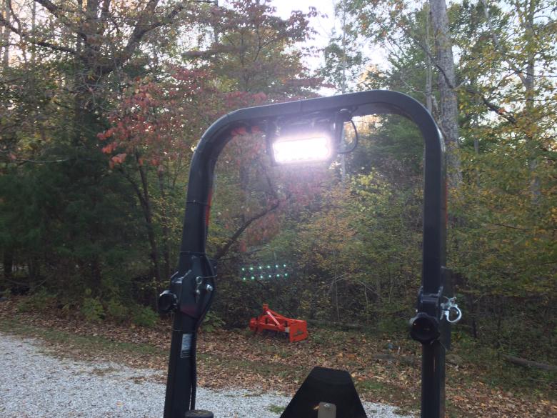

Mike and OC455 - I've run the tractor several times since posting the pictures at #44 and 45.
Your BX2350's have the same ROPS as my BX2360?
Thus far - no hitting my head. I'm 6'4" and 240 or so, if that helps.
At first, kinda pissed the brackets bent in when tightening, but think that may help ease sharp edges. I also rounded the corners on a grinder some.
The lowest part of the bracket could be cut off, but wanted to keep the extra holes for other lights, if needed!
Haven't used at night yet. We'll see, so to speak!:p

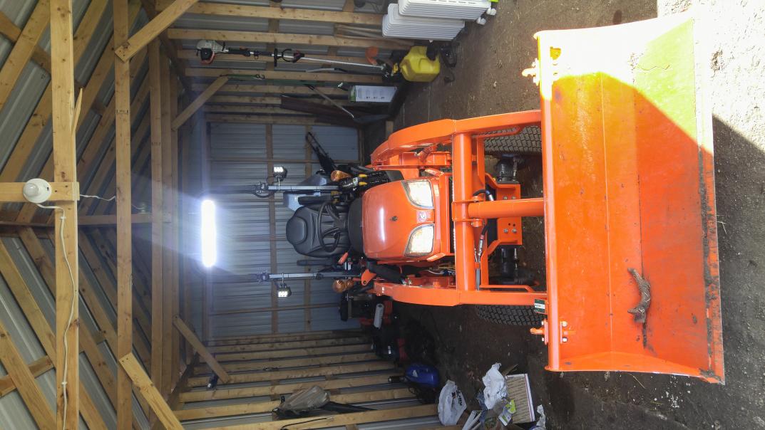

Just finished today dressing up my BX, wanted to get them on before the snow flies. The lower lights (just below the ROPS pivot point) on the front are aimed out where the blower will throw snow, and the rear are pointed at the 3 point. I put it away before the dark, but it sure lit up the shed.

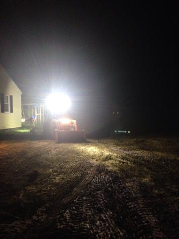

Got mine wired and got to try them out tonight. A 22" spot/flood combo up front. In the rear, I have 2 flood/spot cubes.
