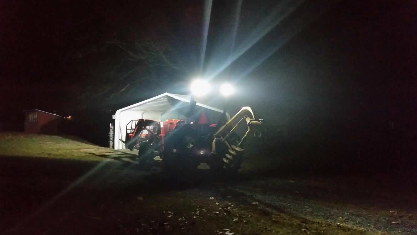

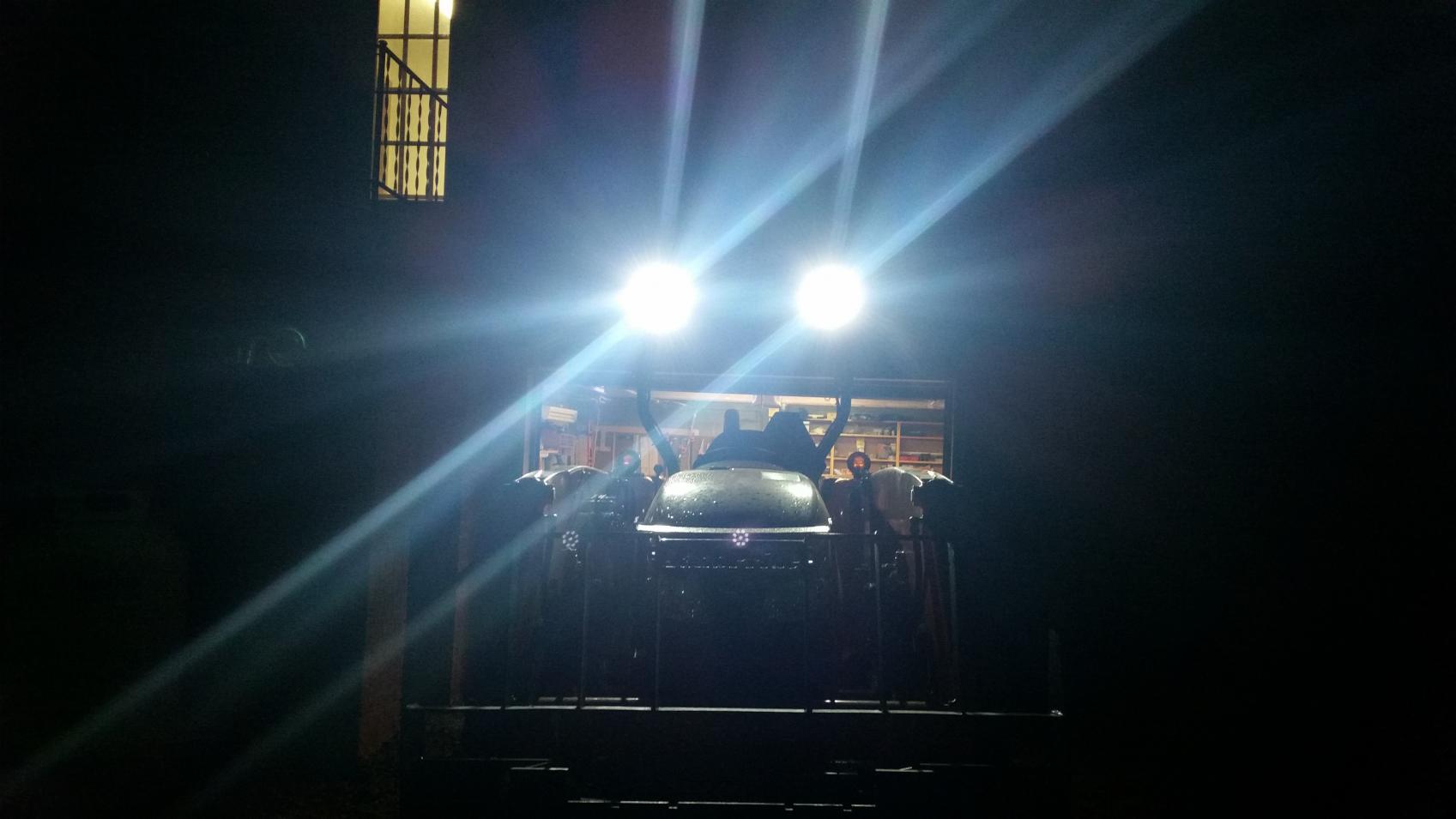

Just finished today dressing up my BX, wanted to get them on before the snow flies. The lower lights (just below the ROPS pivot point) on the front are aimed out where the blower will throw snow, and the rear are pointed at the 3 point. I put it away before the dark, but it sure lit up the shed.
I like the side lights! Nicely done sir.

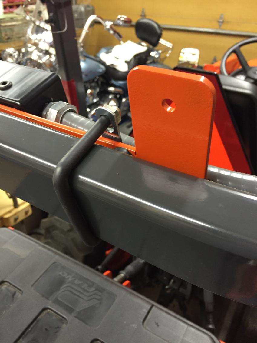

Mike and OC455 - I've run the tractor several times since posting the pictures at #44 and 45.
Your BX2350's have the same ROPS as my BX2360?
Thus far - no hitting my head. I'm 6'4" and 240 or so, if that helps.
At first, kinda pissed the brackets bent in when tightening, but think that may help ease sharp edges. I also rounded the corners on a grinder some.
The lowest part of the bracket could be cut off, but wanted to keep the extra holes for other lights, if needed!
Haven't used at night yet. We'll see, so to speak!:p
Mine I'm not worried about busting my noggin', more worried about my big fat head getting in the way of the light.

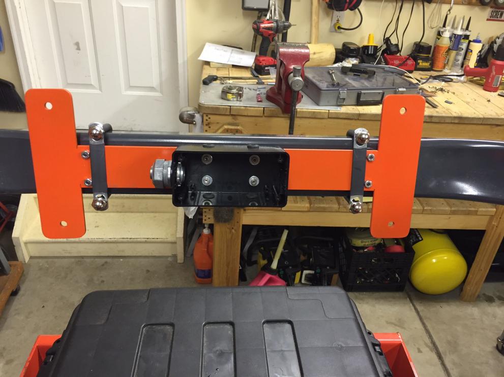

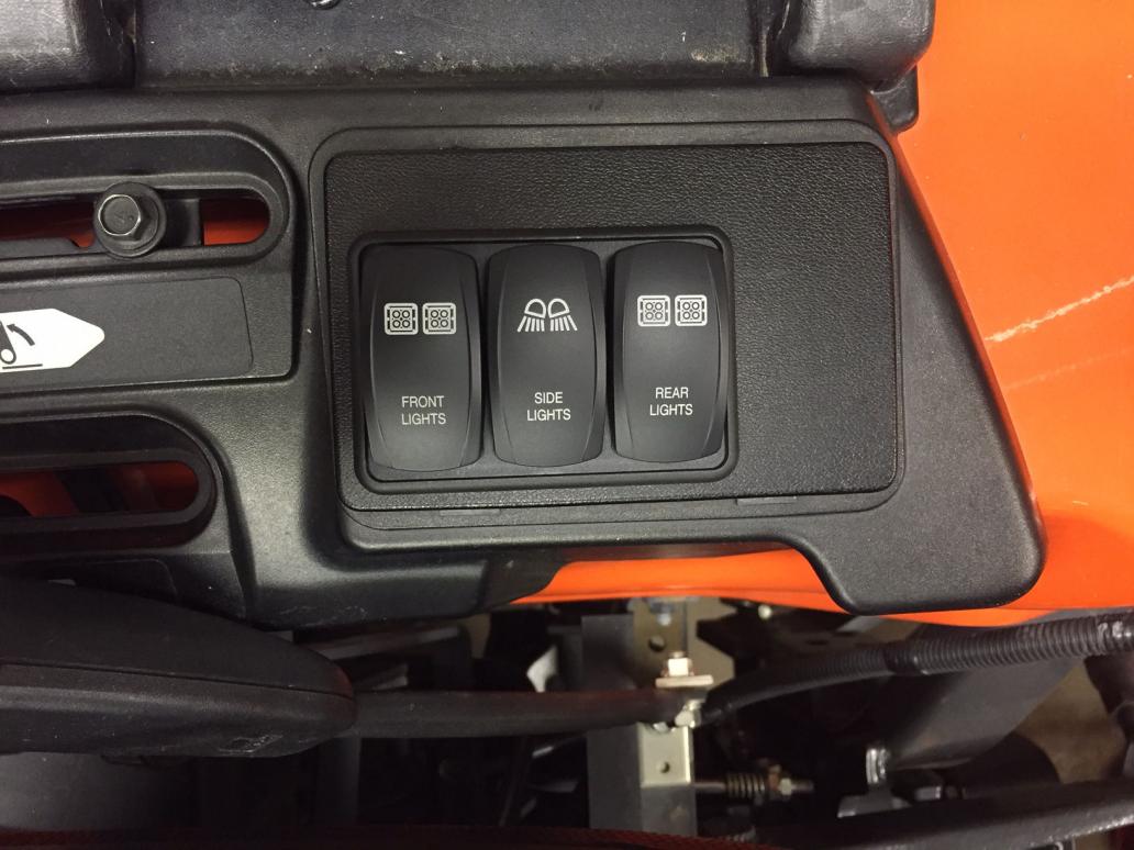

Good evening,

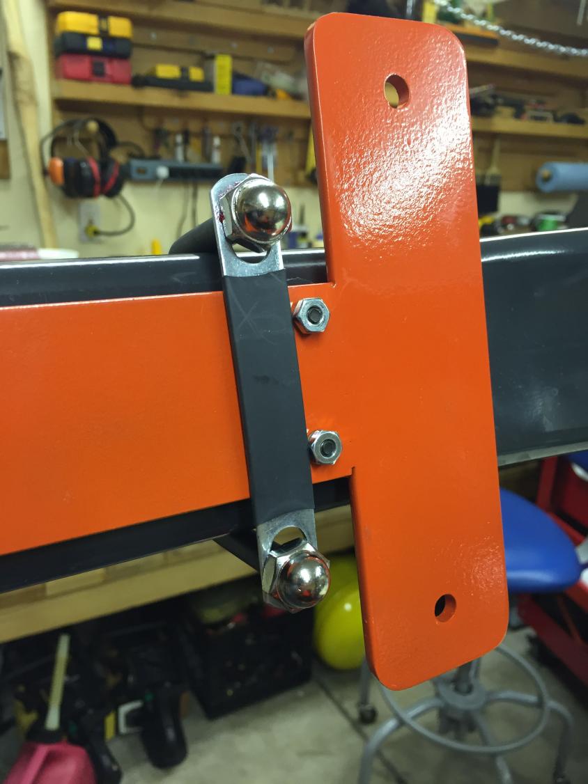

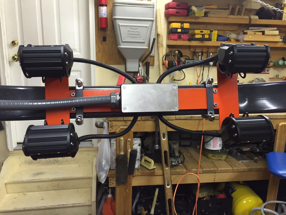

Well everyone has posted some great pics and shown their ideas, so thank you. Attached are some pics of my ROPS light setup. I will have a total of 6 lights; 2 18W LED forward lights and 2 18W LED rear lights on the ROPS and 2 18W LED lights, one on the sides under each floorboard. This is just the beginning and I will post more pics as I get more done on this installation...

Very nice like the bracket idea. Flex tubing I would skip. I will be taking the bracket idea. Thanks

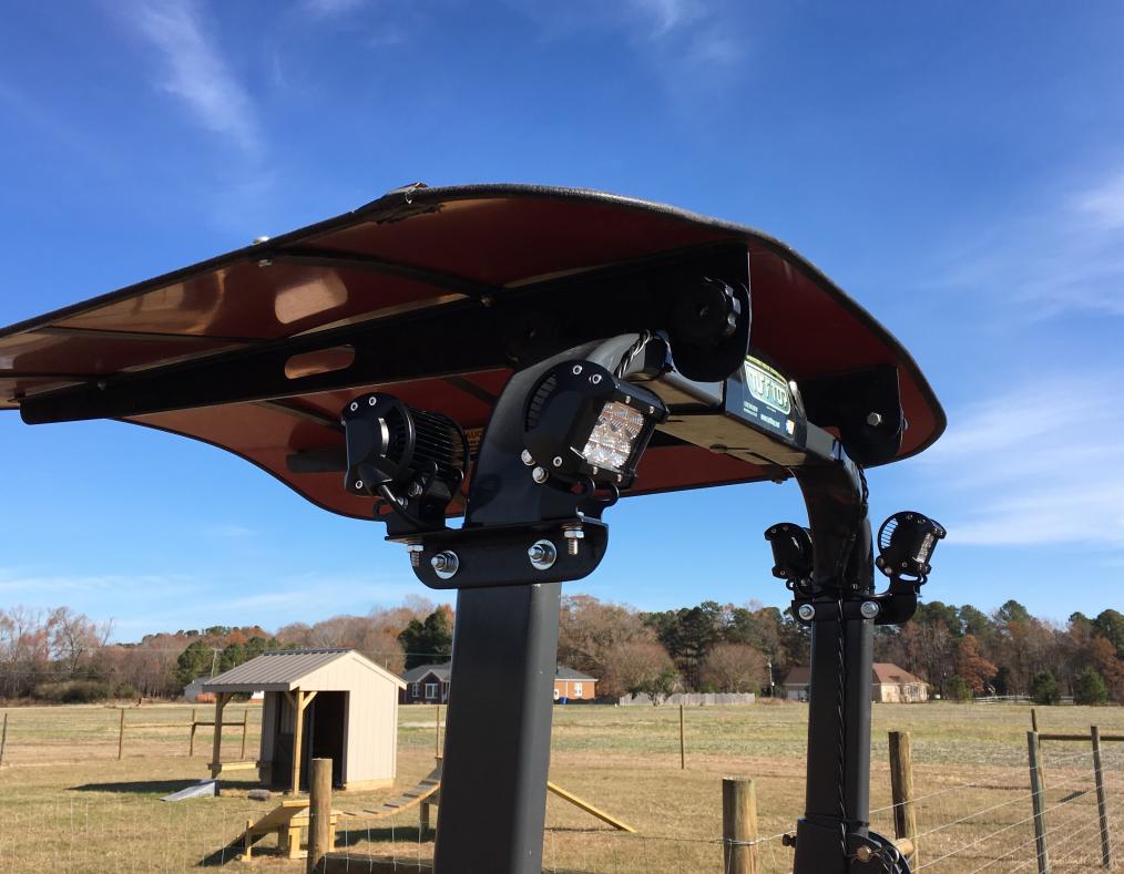

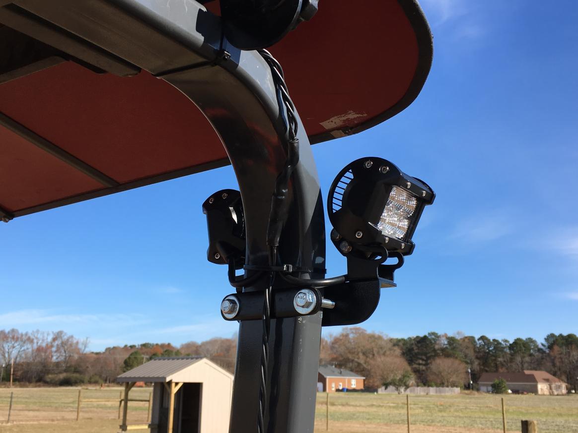

Installed mine last night. Wife got me the Double, 2-light kit (4 total lights) off of RopsLights.com for Christmas. I couldn't find many reviews on the company or the kit but decided to give it a try. I couldn't be more happy with the kit. The guy that makes these definitely knows what he is doing! It was one of the best/easiest/most thought-out kits of anything I have ever used. Yes, they are expensive, but I didn't have time to cobble up all the parts and do it myself since I have too many projects going on right now (building livestock fence). Anyways, I have 2 LED lights facing forwards and 2 facing rearwards. The fronts work independently of the rears because they are on their own switch. Each lamp is 2565 lumens and can easily swivel any direction you want.

I like the way you have them mounted with the bracket on the outside and light facing in. Slightly further away from you head. Mine are mounted completely on the inside and I can blind myself until I've turned my head completely.

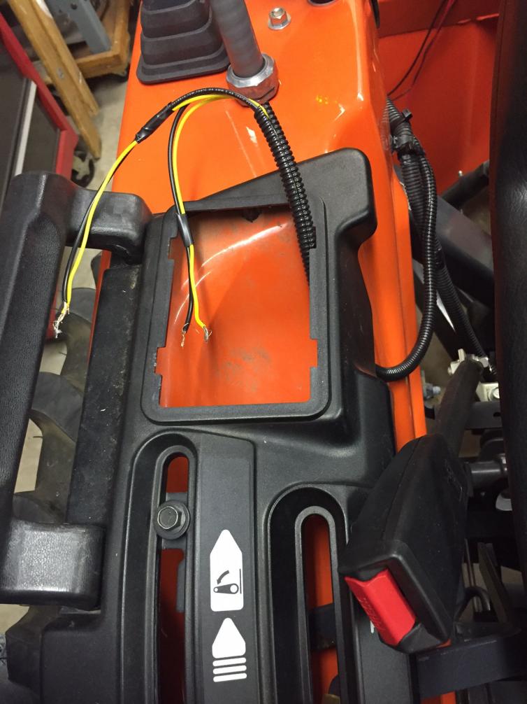

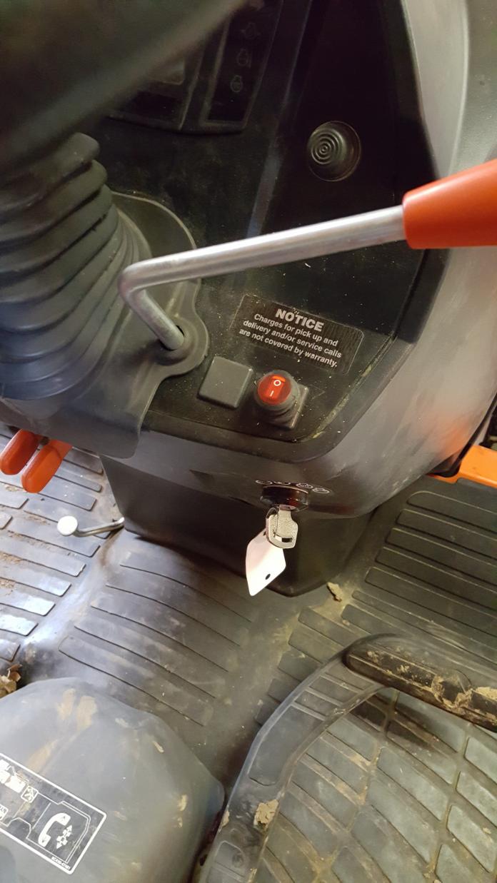

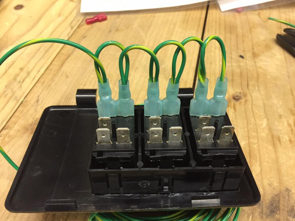

My installation is similar to others posted here. I made the mounting brackets out of some angle and flat bar that I already had. I wanted the lights mounted on the outside of the ROP and as high as possible. We mounted individual switches for the front and rear lights in the plastic panel to the right of the seat. I wasn't paying attention when I bought the switches and they are 120 volt so the led's are not currently working. I have found the same switches in 12volt and with orange led's so these will get changed out soon. Power was pulled from the factory work light circuit at the right rear taillight. All wiring connections are sealed with heat shrink. The lights are super bright and I am really happy with them.

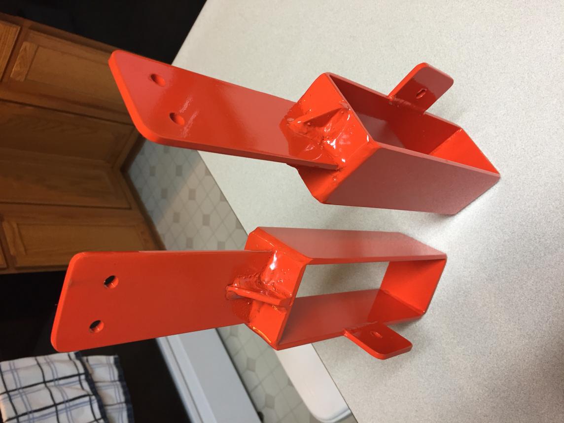

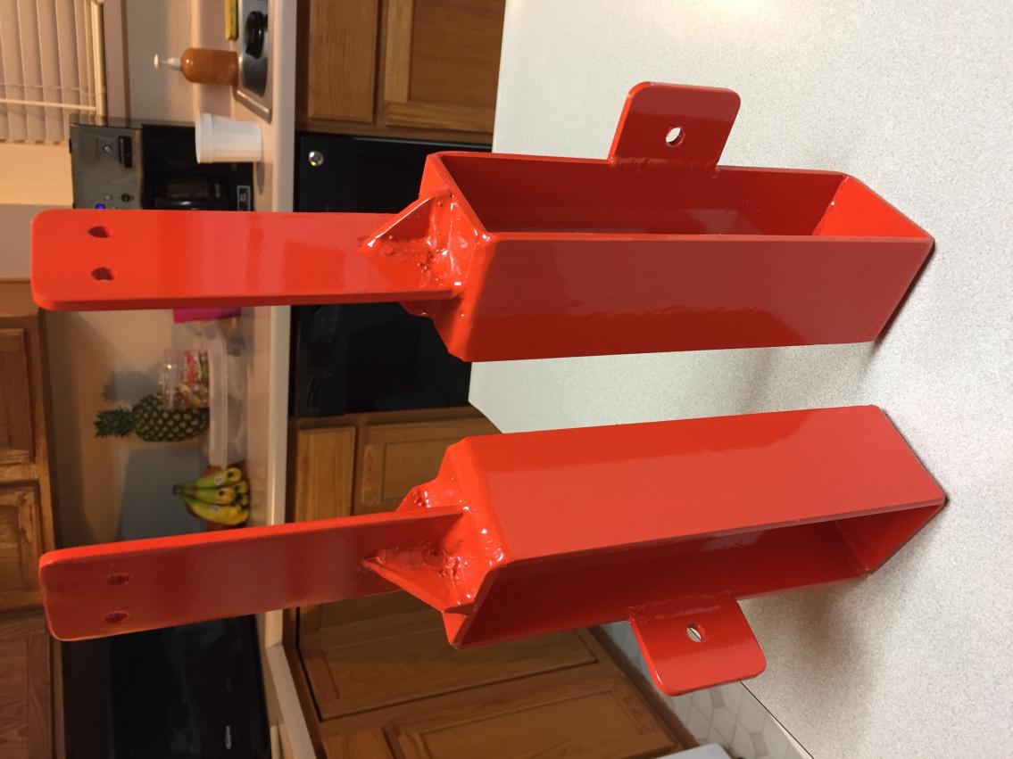

So I finished fabricating the enclosures that will protect the LED lights that will be mounted beneath the floor boards. Tomorrow night I'll be mounting them and then attaching the lights and running the wires to the switches...
More photos to follow!!!
