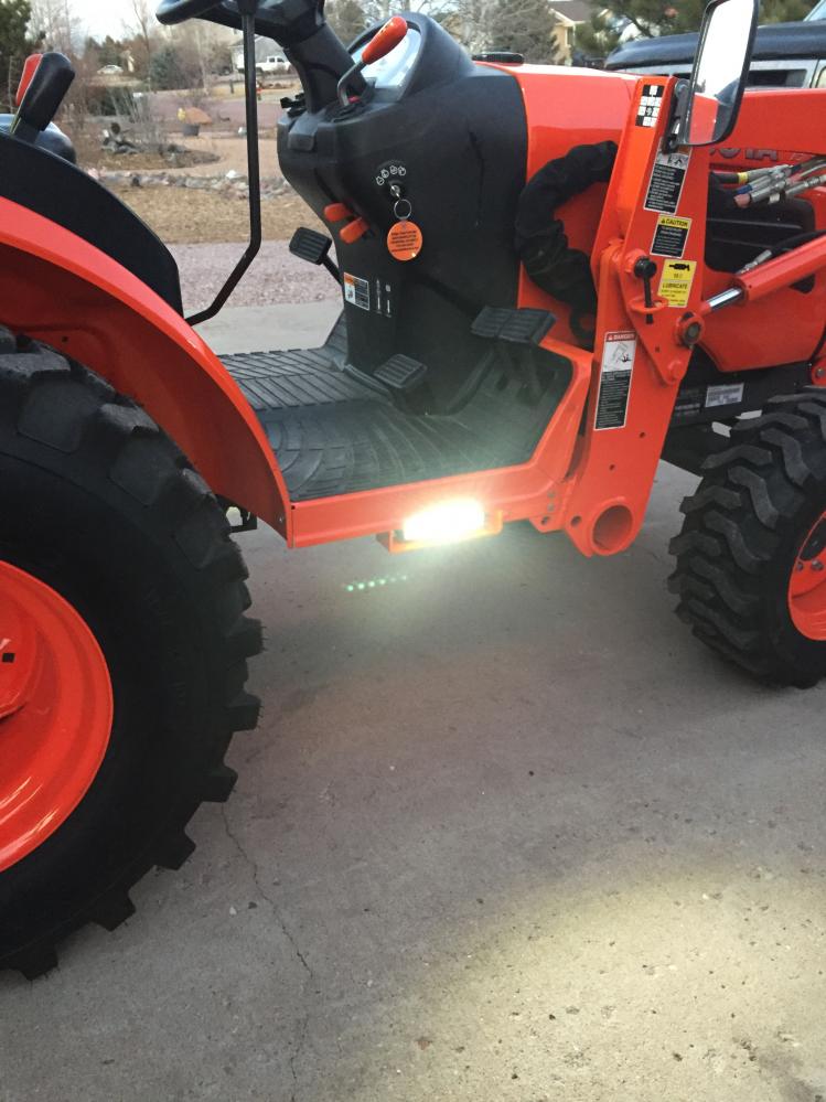

I really like the lights you added to the tractor. Was that a Kubota kit you bought? I am not too savvy when it comes to electrical things. What are you like cutting and splicing into to give them power? Or is there like a plug or fitting or something?

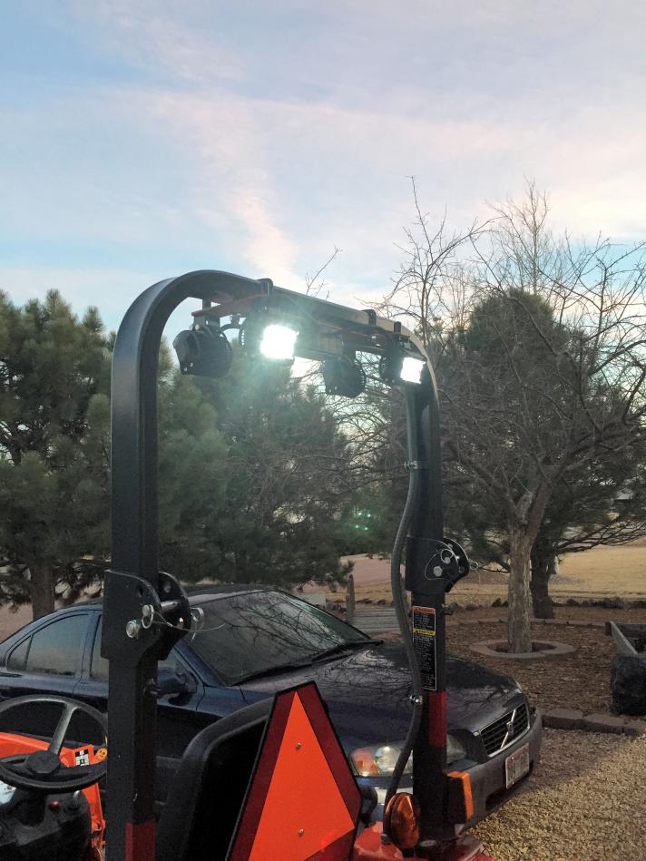

I finished with my ROPS Lights last weekend. I like your side mounted lights. I bet that helps out a lot when getting down off the tractor.
I used LED pods from superbrightleds and switches from otrattw.
1. ROPS lights.
2. Switches installed.
3. Switches at night.
4. Rear ROPS Lights.
5. ROPS and Head Lights.

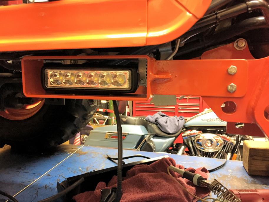

LOVE the lights. The backhoe lights will come in handy while you burry the body of the guy who brings your daughter home after curfew! LOL
On a side note. I see that it looks like you are the only one in this post who actually drilled into the ROPS. Seams like all others used a wrap around mounting bracket approach. Should the ROPS be punctured? is there a MAJOR problem with drilling the ROPS? Getting ready to start my light package. I was thinking of drilling and tapping the ROPS and even plumbing the wires inside the ROPS. Will I be violating any major international law by doing so or is it just not smart? Some of the bracket installs look solid as a rock and very clean. all this has me second guessing my approach.
Please advise.

Yes, I drilled two (2) holes in my ROPS for 1/4-20 bolts and didn't think twice about it. I have read tons of comments in hundreds of threads regarding any modification of the ROPS in any way, shape or form. It's akin to Roe vs. Wade. My position is very simple: it's my tractor and I'll do whatever I want with it and to it.
On Monday I brought it to my dealer for my new BH65 installation and the owner absolutely loved my clean neat installation. I sheepishly broached the subject of the two small holes I drilled into the ROPS and the voluminous opinions on forums I read. He smiled and laughed and said two small holes for bolts will not adversely impact the structure integrity of the ROPS...pointing out that the hinged joint has a greater likelihood of causing a ROPS failure than 2 small bolt holes...
Your installation looks great...thanks for sharing...

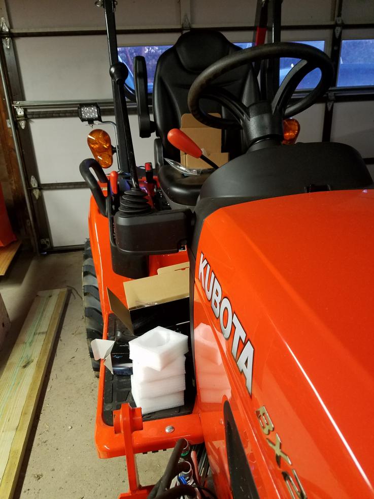

I am still working on the wiring but I got my aux lights mounted on the BX last night. I didn't want to drill holes in my new tractor so I decided to use the bracket for the amber lights. Easy install, cheap, no holes in the tractor but I give up a little on illumination since they won't be mounted high.

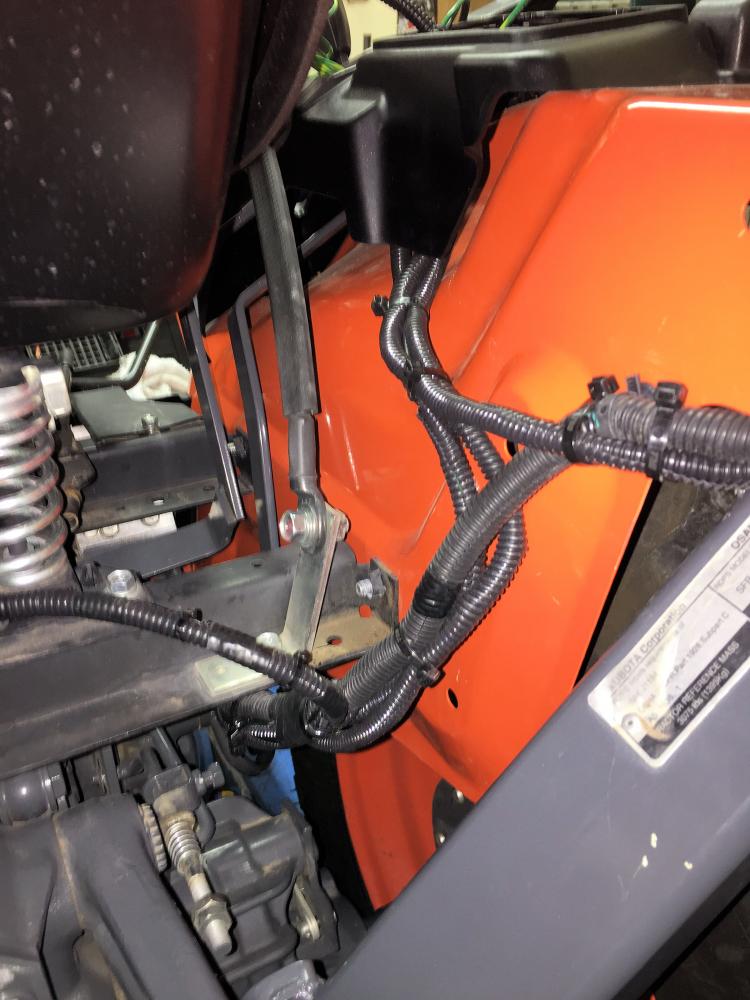

I just read through this entire thread, and maybe I missed it; can anyone show me where they got power for their aftermarket ROPS lights? I thought that there was an available plug on the Kubotas (I have a B2650) that is already fused and linked to the ignition for power only when the tractor is on.
I would prefer to tie into that location if there is one available on my tractor.
I already have have the dealer-installed halogen work light on the ROPS, but want to add some additional lights. I'm hoping that there is another plug, or maybe I need to get power from the same wires that feed the halogen light?
There is a bundle of wires under the rear of the seat taped up with electrical tape. However, if you have the dealer installed lights, those have already been used and you will need to add a fuse block like some of the other guys in this thread have done. Or ditch those crappy factory halogen lights and replace with LED.
