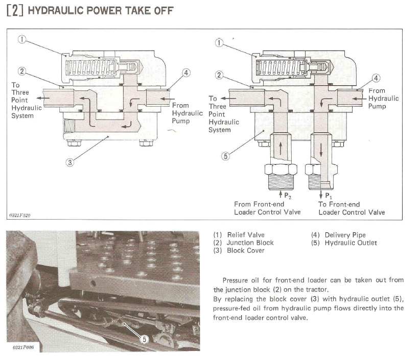

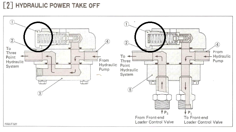

Dan, I got this from the loader manual. If I am reading this right, The Junction block that goes to the loader looks to have a relief valve, and i guess flows right back into the trans case.
PoTreeBoy
L35 Ford 3930
Mar 24, 2020
3,965
2,463
WestTn/NoMs
So, is that junction block bolted to the transmission case so that the relief port, located on top of the figure, could dump back into the case?

Thats my guess.
If the block contains a relief mechanism that dumps into the tractor sump (Kubota's current design practice) there should be a visible plug of some sort in the block where the mechanism is installed.
I would bet a small sum of money that on a tractor of that vintage Kubota did not hook up a loader without providing a relief circuit somewhere.
Dan / Po, was too late to go crawling under the tractor last night. I’ll go verify the plug here in a little bit. Thanks!
interesting given the torqued-down whine when the loader valve was dead-headed. I guess at idle that’s still a lot of pressure to overcome to get the RV open. But with it sitting empty for so long it also makes me wonder if it’s opening properly.

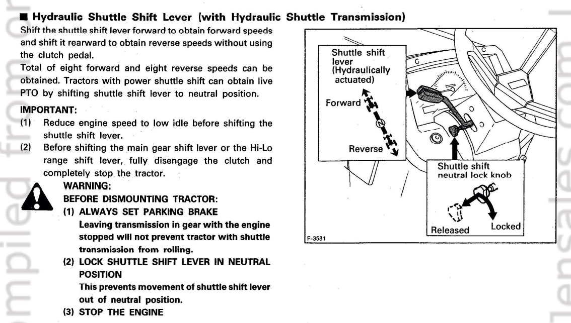

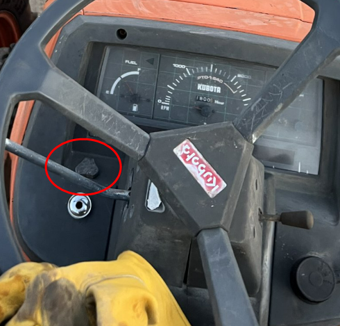

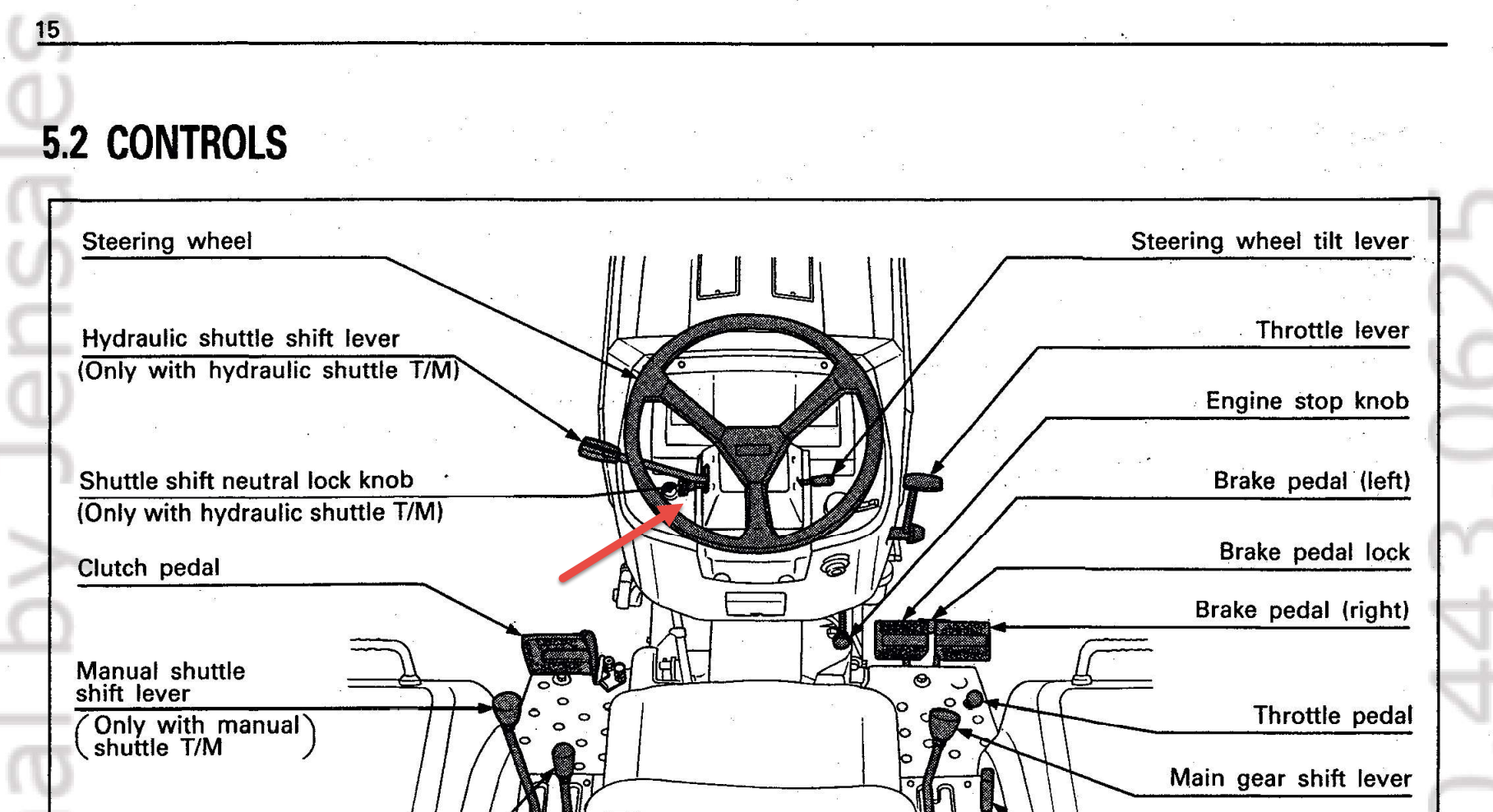

@rbargeron Speaking of:
Do you happen to recall this triangle knob on your tractor?
I found something like it in the operators manual, but it shows under the shift lever, not in the current location on the dash.
There is the possibility I suppose that a previous owner just moved it there and the horn is missing, or something else. Been meaning to look at this but havent yet.

Ok Po and Dan, I got a pic of the junction block. There’s hydraulic fluid under the tractor that I didn’t want to roll around in so this was the best pic I could take.
it looks like the Relief valve block does bolt to the case, and the hex head is the top of the RV. This is view from the rear. The line coming at you is going to the 3ph
Pretty sure there's no horn, they're not common on U.S. tractors.
edit: It's not unheard of for Kubota to make mid-run changes. Mine has turn signals that the early L35's apparently didn't, which moved the hazard lights off the combination switch to a separate switch. Not reflected in the WSM I bought, which should have been the latest.
I read somewhere it was an option...I'll have to find it...I dont remember if that is the location. I'm imagining, the fix-it guy pulled the safety off to get to the hydraulic shuttle under the dash, and then when they finally told him they were picking the tractor up, it was a mad dash to throw what parts he could find back on, any place they might go. :ROFLMAO:
OK, so your pump was protected. You might want to check its set pressure before you reinstall the loader.
