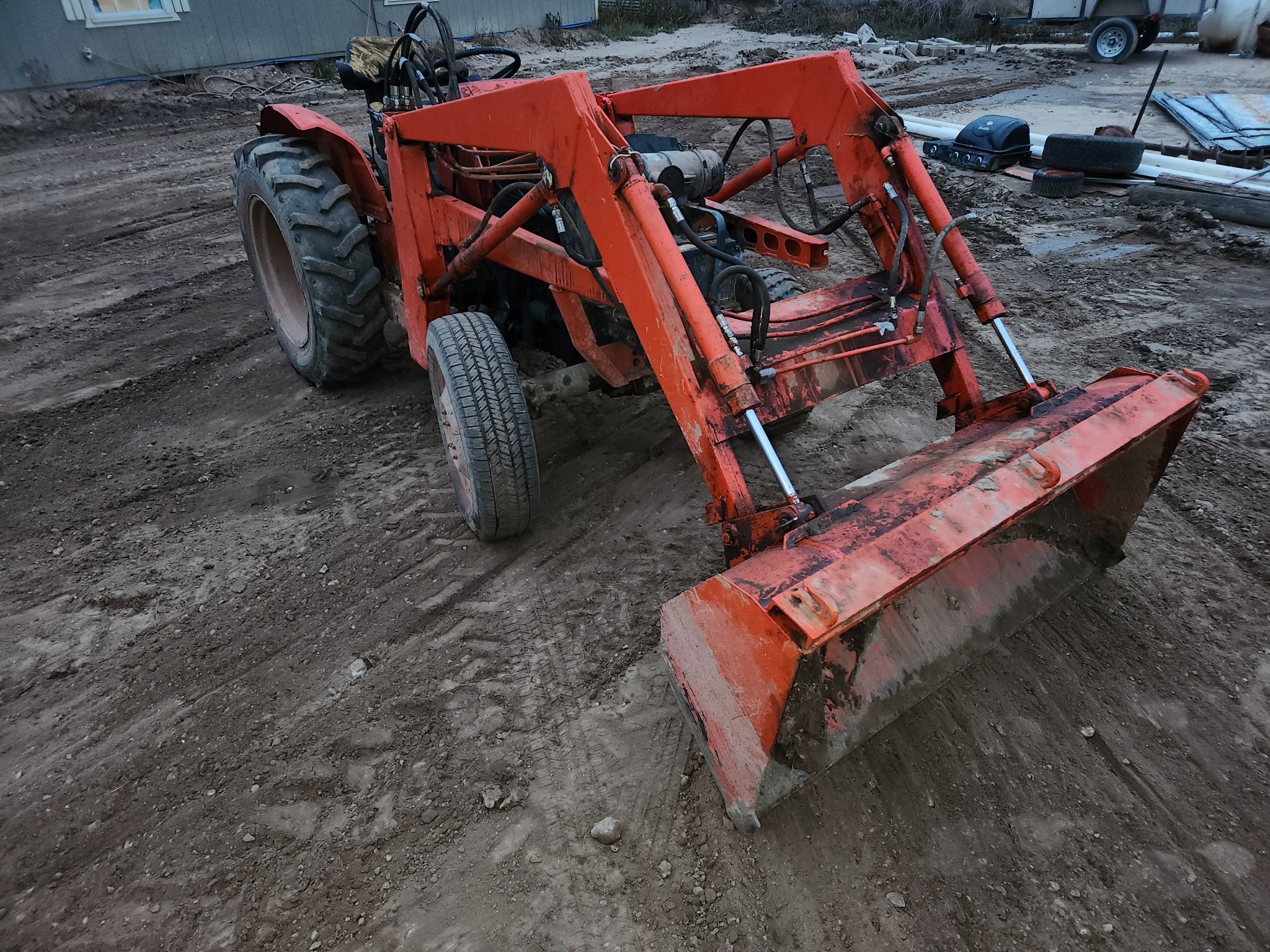

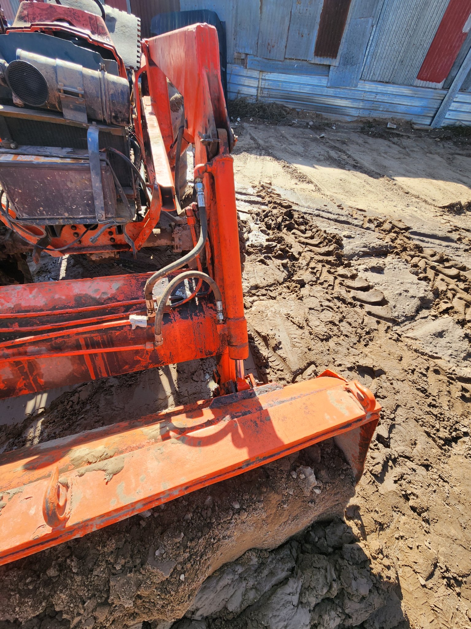

disconnect your leaky cylinder, keep shaping your realm with one bucket cylinder functioning
your machine fully stuck in the dirt, completely empty from leaking all the hydraulic fluid
you can wait around and do other task while waiting for one seal, OR
put you plugs on the leaky cylinder so no fluid can go to it and it is open to move, fill it back up with hydraulic fluid,
go shape you your realm with one bucket cylinder, just dont lift no crazy dirt and break your other cylinder
yes you can do other task and play it safe, but no other task feel as important as shaping your realm
your gonna let a little seal stop you from shaping your realm?

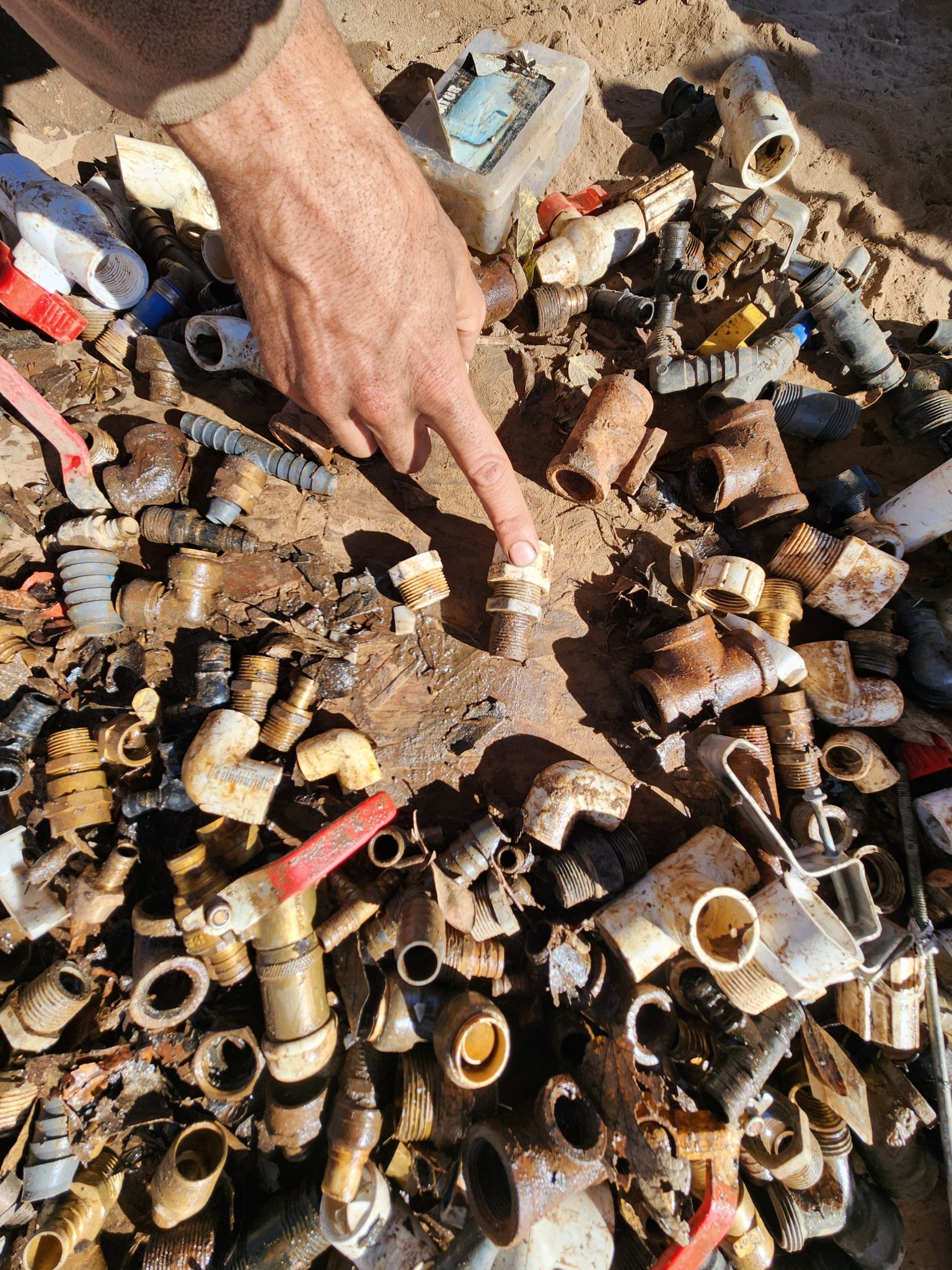

your exact plan: take off both hydraulic line that go to your cylinder, plug them with regular 1/2 plumbing
from what I recall, 1/2 inch plug should seal up your jic 8 female swivel, please let there be plugs that work in your junk pile, but you still need to go get hydraulic fluid
before getting the hydraulic fluid, make sure you have plugs that fit into your jic 8 lines
definitely a bad idea but give it a shot
go you through your random plumbing, find you something that will plug regular 1/2 inch house plumbing
No, regular 1/2 house plumbing does not thread into jic 8 female
Take you a hose with you to part store and get you 2 plugs to stop fluid at that cylinder
12 dollar just for 2 fitting to plug your hydraulic lines
cheapest hydraulic fluid available: 61 dollar from walmart auto center
plug you both lines, add you 3 gallon hydraulic fluid
go shape your realm not using the bucket cylinders, only lift cylinders
while waiting for the seal, you are still able to carve earth without leaking your hydraulic oil
just dont use your leaking cylinders, and your system will hold its fluid
who care if you cant control your bucket? use your massive lift cylinders that are not leaking and shape you that realm
icing on the cake: you actually like the bucket flopping around, it has a self leveling when going backward draigging earth down

Well the next chapter in this tale of woe might just be " robot loader frame twisted from unequal forces",
But I could be wrong.

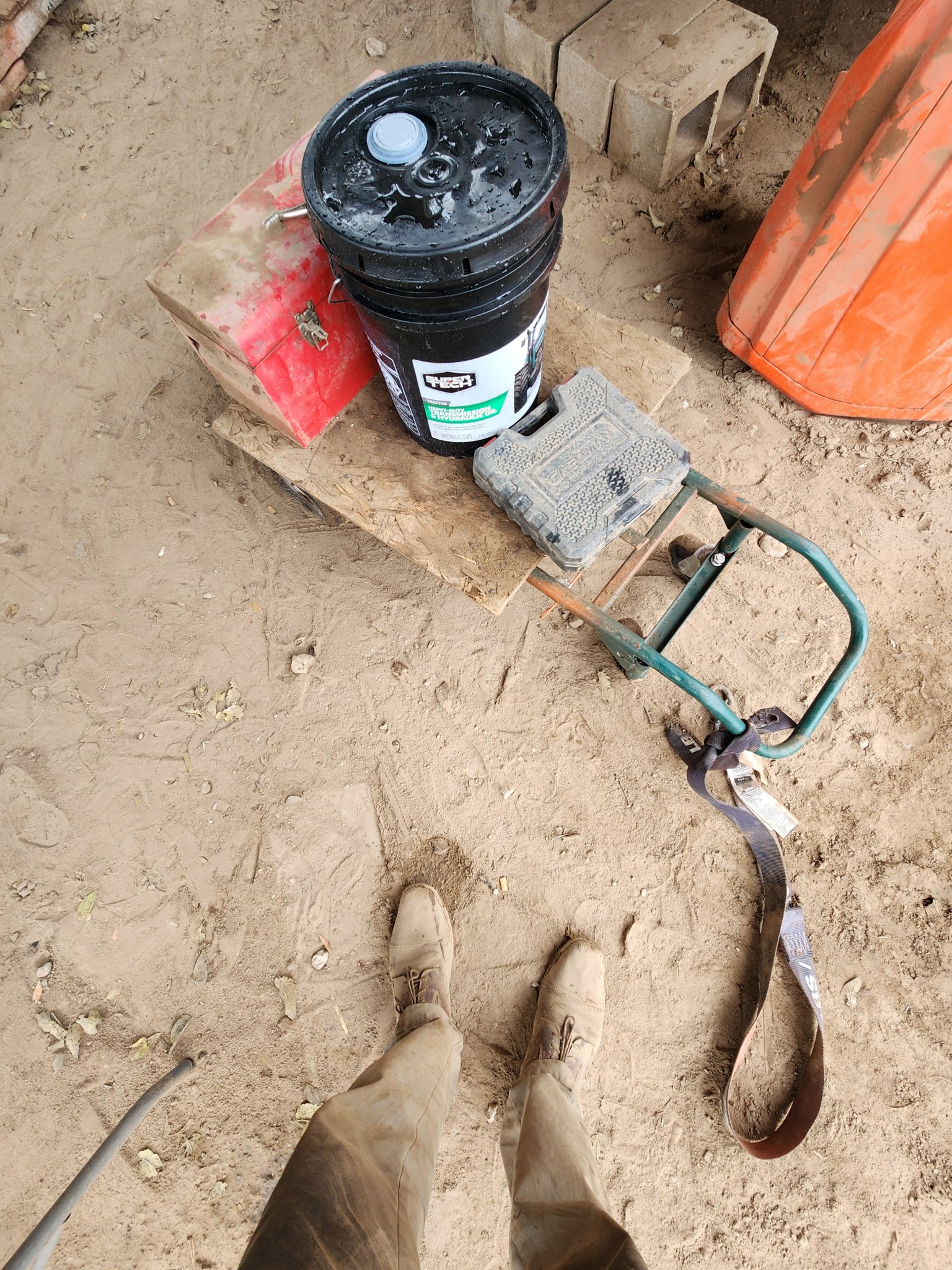

favorite new tool: drag you around all your item using your 4 wheel dolly on a strap that you pull
moap you around your shop with less effort, moving all item until your machine can grade that realm
lug you around your other L295 pile of part, with less effort using your 4 wheel dolley

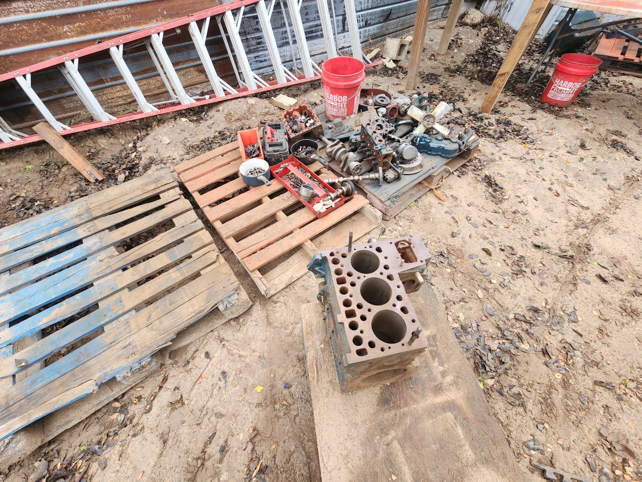

lug away your other diesel engine in parts away from your shop,
only when you lift the block do you realize how it can create enough power to lug around your realm

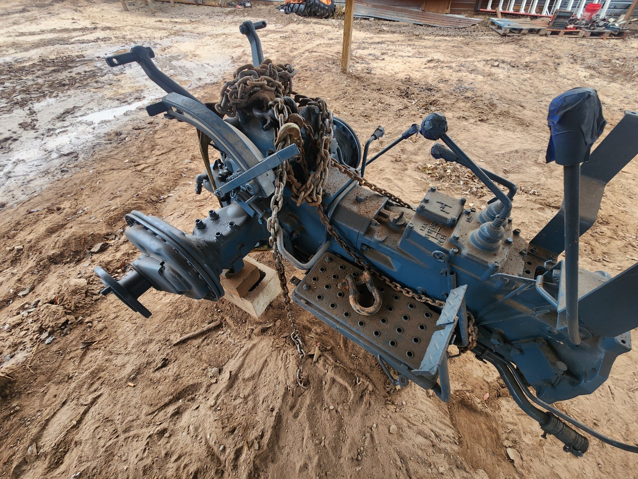

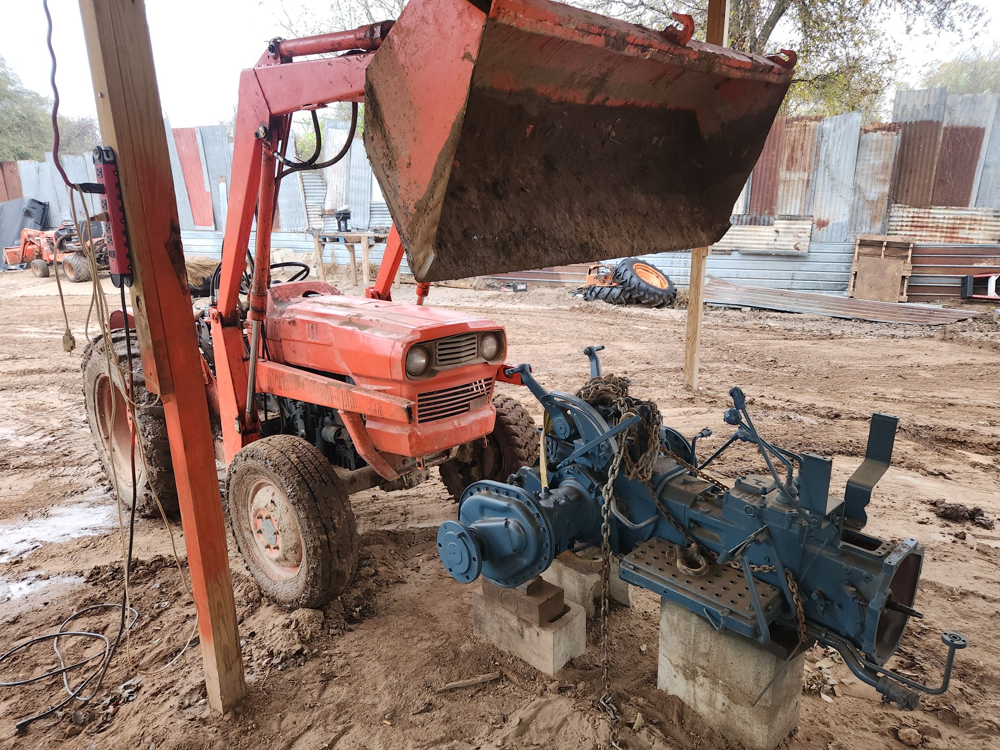

chain up your other L295 to lift
get your L295 loader above it, lift it up and move it to close to fence
you almost flip your tractor trying to lift your other L295 chassis
you can see the wheel off the ground, you had to drop your chassis
you thought your tractor can lift the chassis, no, what is in that chassis that is so heavy?
new plan: lift up one side at a time, get your 4 wheel dolly under it, strap it to the chassis, then
drag around the whole contraption using your loader and get it on a pallet somehow
lift one end of your chassis, get your dolley under it

spend you couple hour moving L295 chassis with another L295
got your chassis on your dolley, put a strap
move around your chassis with your loader
Cover your other diesel engine with pickup truck bed liner
Finally, 10 hours of moving stuff
Your L295DT ready to build your shop
