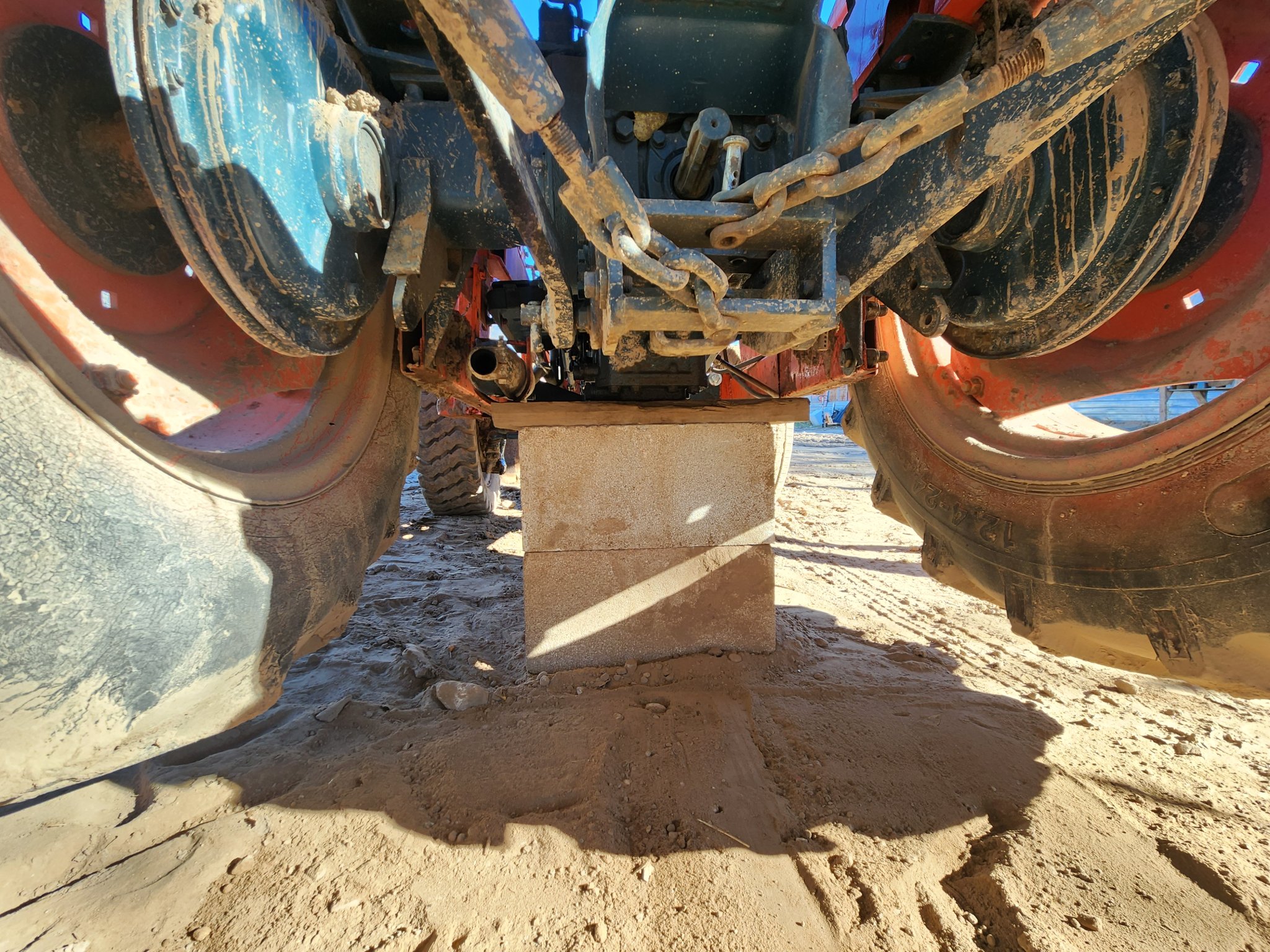

It looks like he crawled under a tractor which was balanced on a 4x4 balanced on a solar powered pneumatic bottle jack. I think there's a lot of room to criticise Joe's wisdom, but let no man condemn his diligence nor his courage.

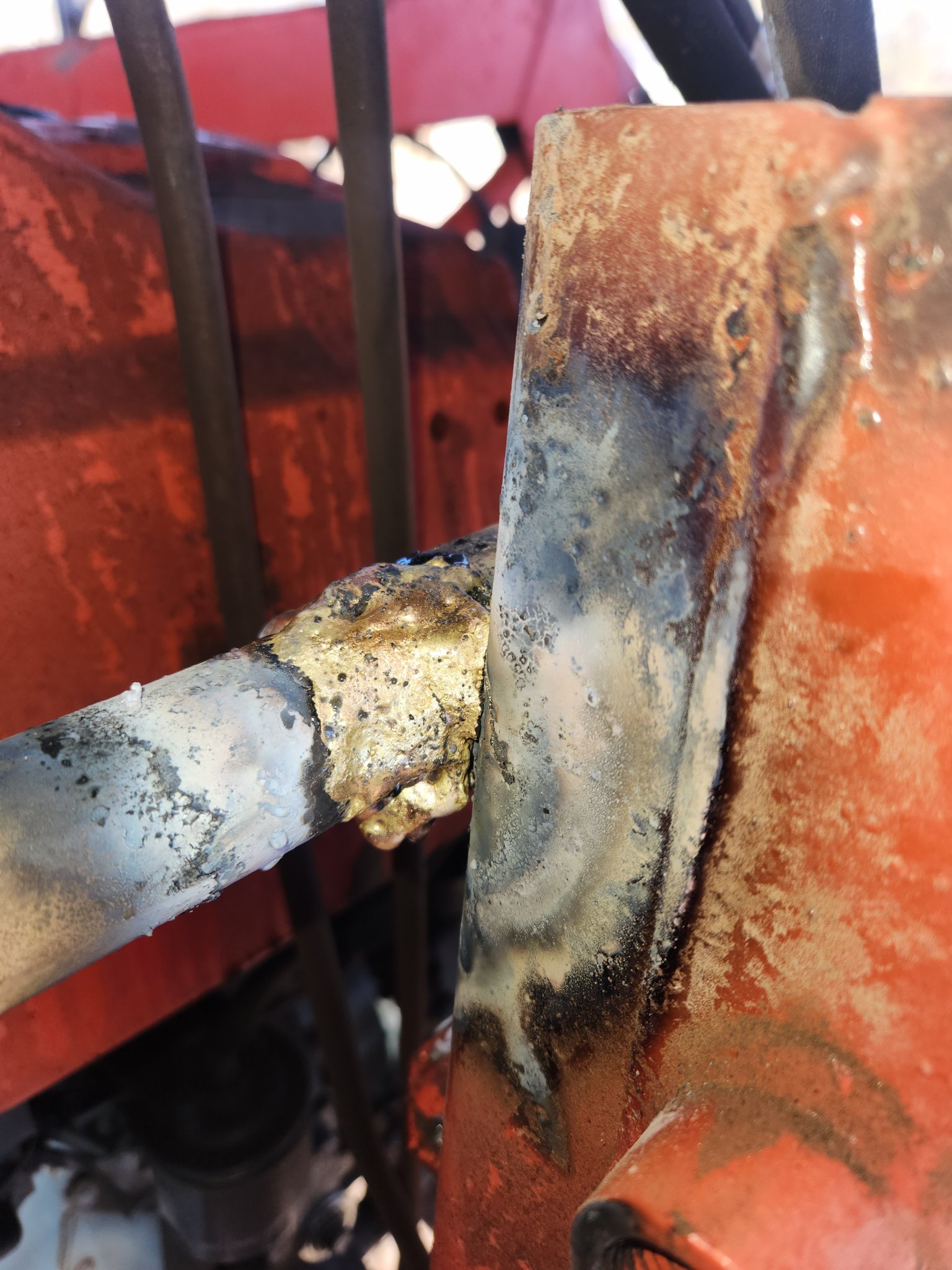

do you couple magic trick, fasten your robot into one entity
huge broken weld making your robot flex drastically when you shape your realm
hit it hard with acetylene until red, come in with your bronze, turn it into one piece magically
sit you back with popcorn witness magic
melt you on your bronze, heat entire area melting it into one
Highlight for them the searing of steel, get your torch high oxygen, get real close to the high point of the intersection, sear you off the high point like you sear your ribeye steak
hit the high point hard for long time, it will spread the heat and make one big puddle, turning the entire area into one entity
Brazing it is very unlikely to hold. :confused:

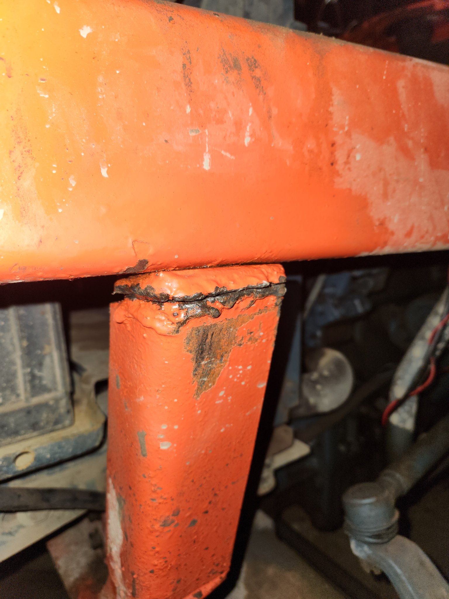

Assess your first magic trick, do you a 2nd magic trick, more bolt content
assess your big magic trick:
that spot that looks open is not where the weld broke, you cannnot see where the weld broke so it is holding, but
fill it up with even more bronze and get it to molten, and do you the searing trick one more time
at this point, it is one piece but add more mass to its connection
you spent 2-3 hour on this magic trick experimenting,
the one experiment you were trying what happen if we get it as hot as possible, can we melt the thick steel into each other without bronze filler?
these magic trick take real time because you are heating a massive intersection of lots of thick steel, smaller magic trick do not need this much heat/time
do you a 2nd magic trick on your broken FEL valve rod, the carving of earth shake your entire robot until all weakness come to the surface, just like the molten when you sear it,

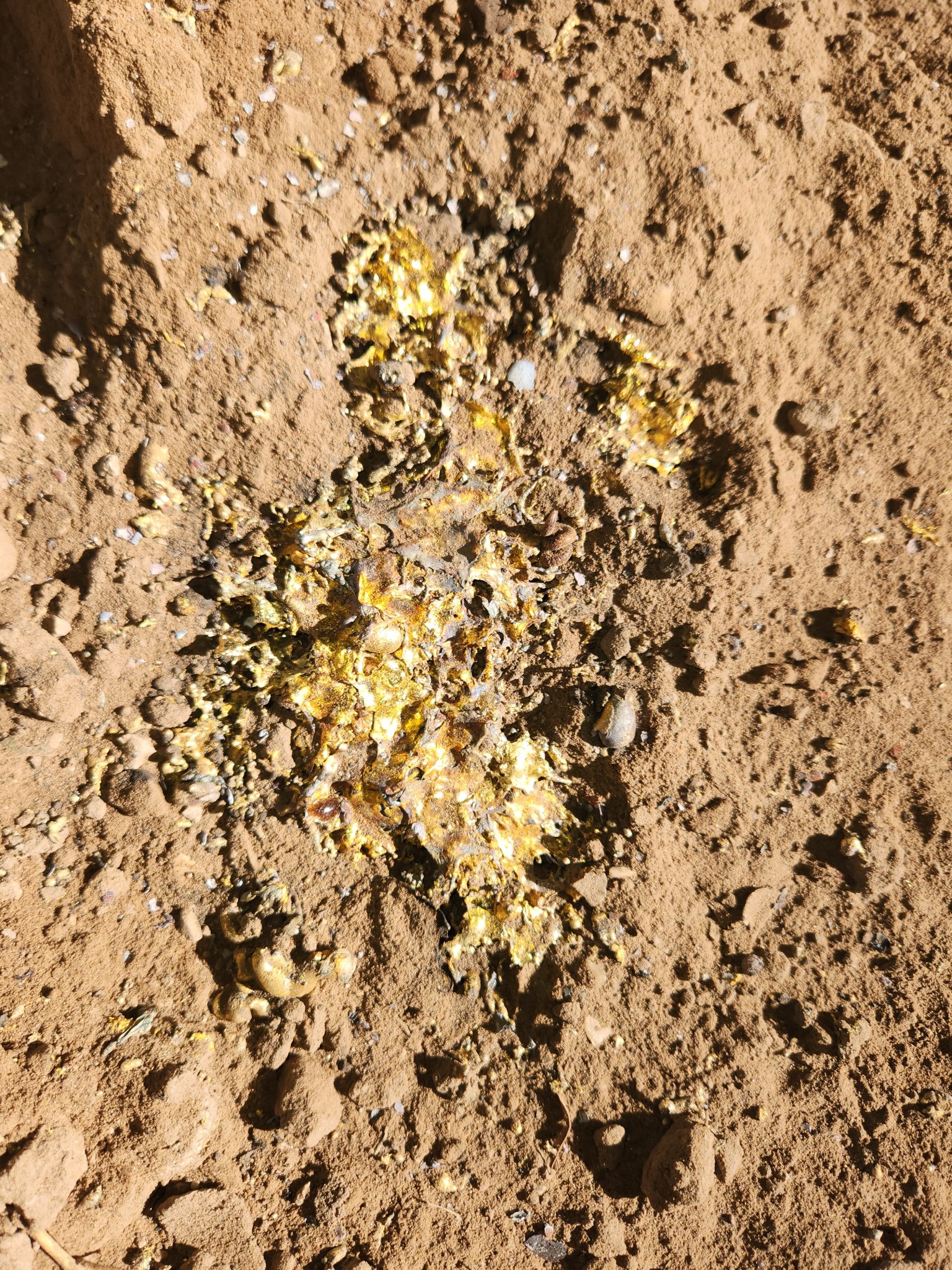

small magic trick, heat you up that steel to molten, let it drip on the ground
as you bind 2 entity into one using actual magic

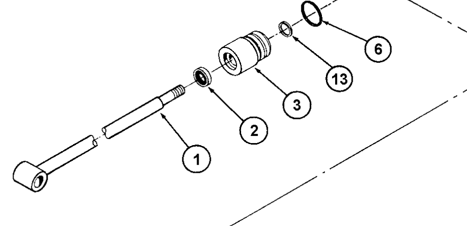

now: look at diagram, study which seals you need
@Sidekick has said the most correct statement that has been stated 50 something page into the thread
"this is hillbilly entertainment only"
consider you the most correct statement while you study diagram and get the part number and order your seal
look you at your diagram, get you seal 2, 13 and 6, and that should stop it from leaking on the ground, don't worry about the internal seals
seal 2: 70050-00400
13: 70050-00417
6: 70050-00310
get you these seal for both bucket cylinder, that should eliminate all leak, not seeing leak from your lift cylinder
order you 2 set of those part
no, you end up getting one seal kit
Kubota 70050-00299
$57 including delivery
with that one kit you should be able to seal up the other cylinder if it start leaking again
you finally order you a seal kit after taking them apart 3 time each already
