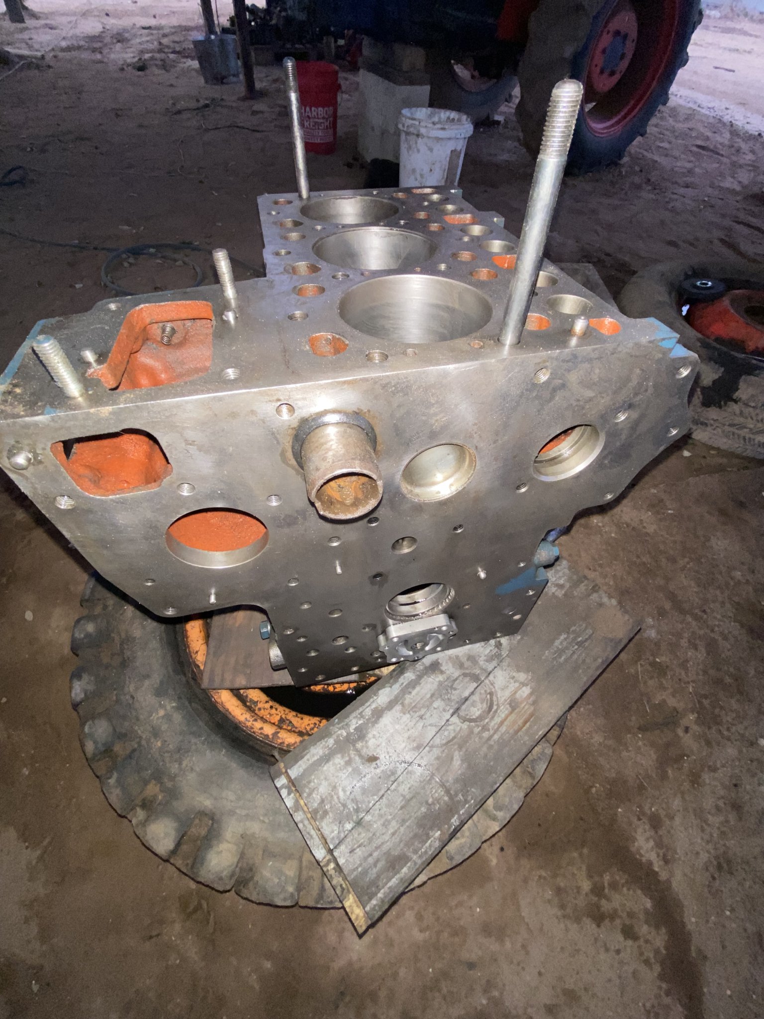

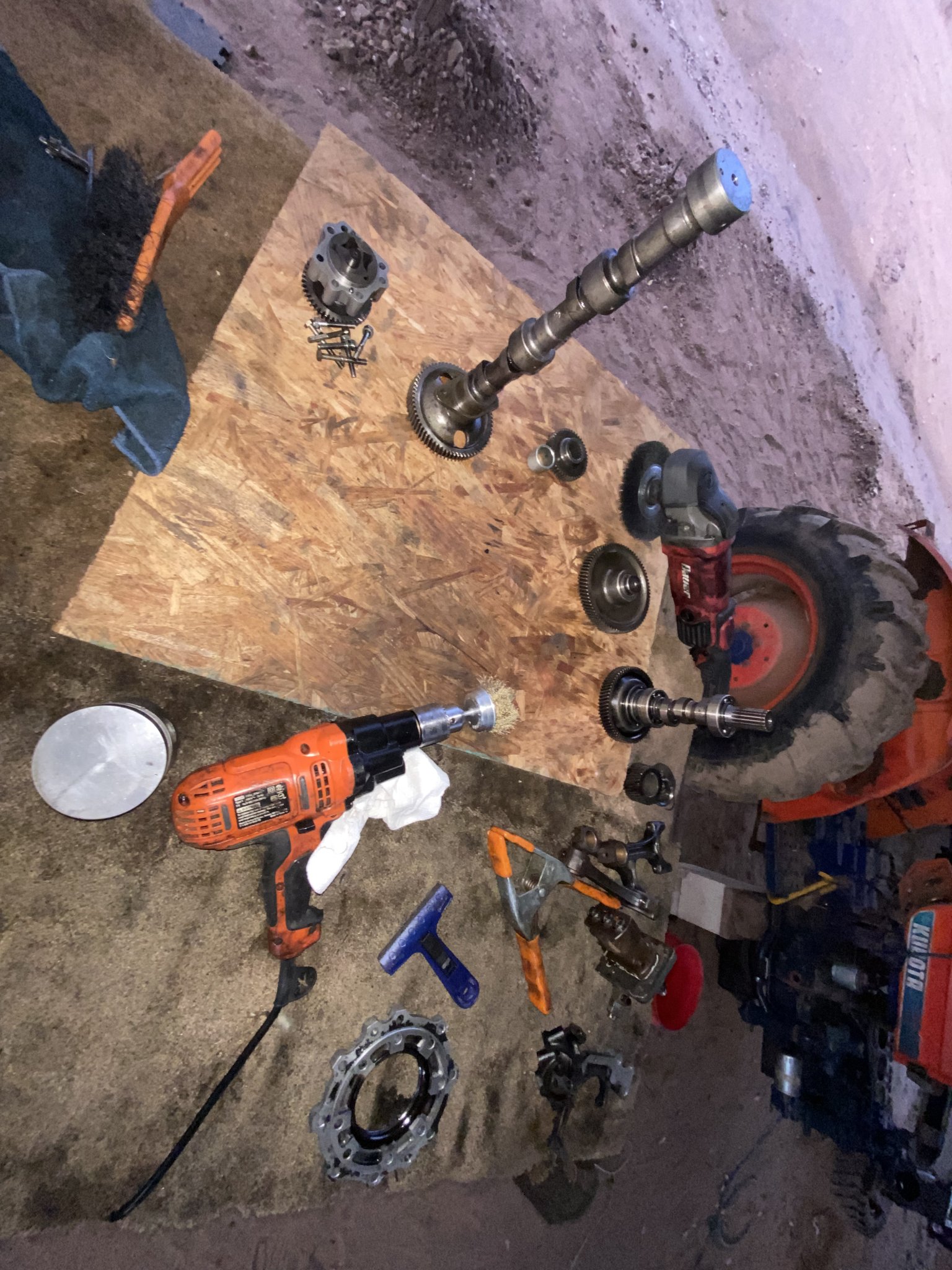

Going through hitting everything with diesel and wire wheel, scraper to remove seized gaskets
hit entire block with nylon stripping disc on drill

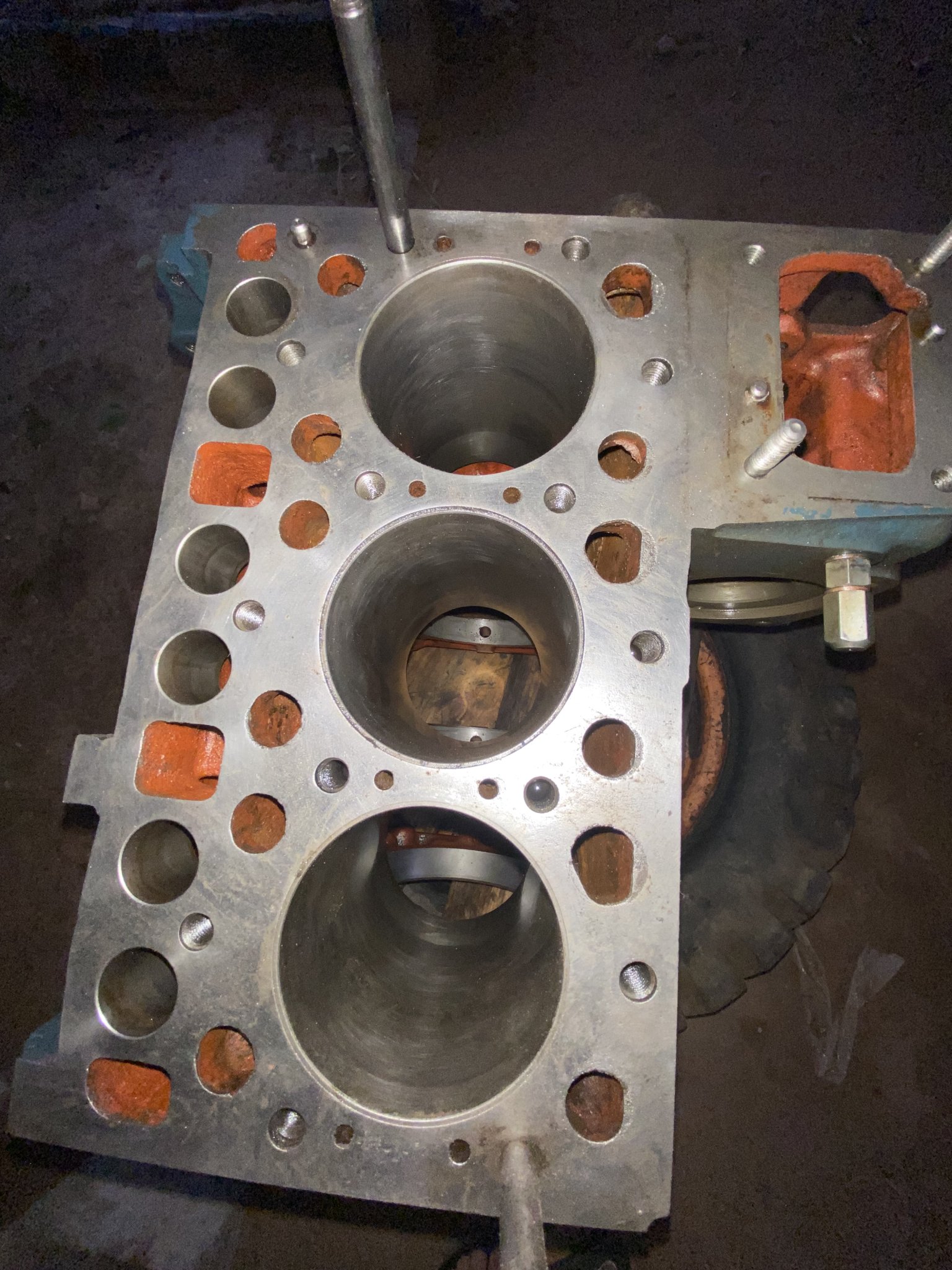

Hitting the cylinders with brass wire wheel, trying to get all the black off the liner

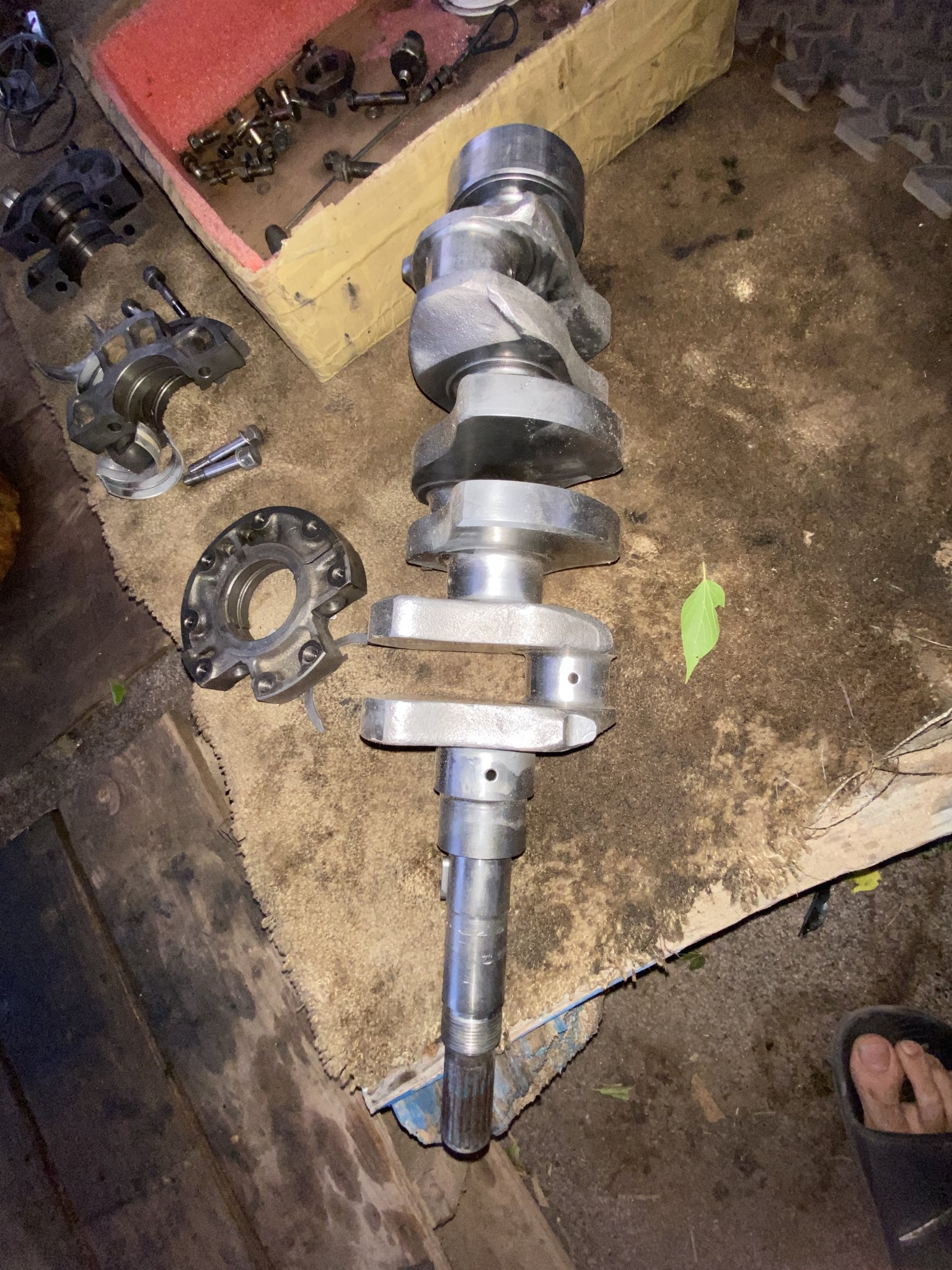

Hit the crankshaft with high speed wire wheel then buffing pad, 2500 rpm, especially the journals
Hit all parts with pressurized parts cleaner
Cleaning while I figure it out

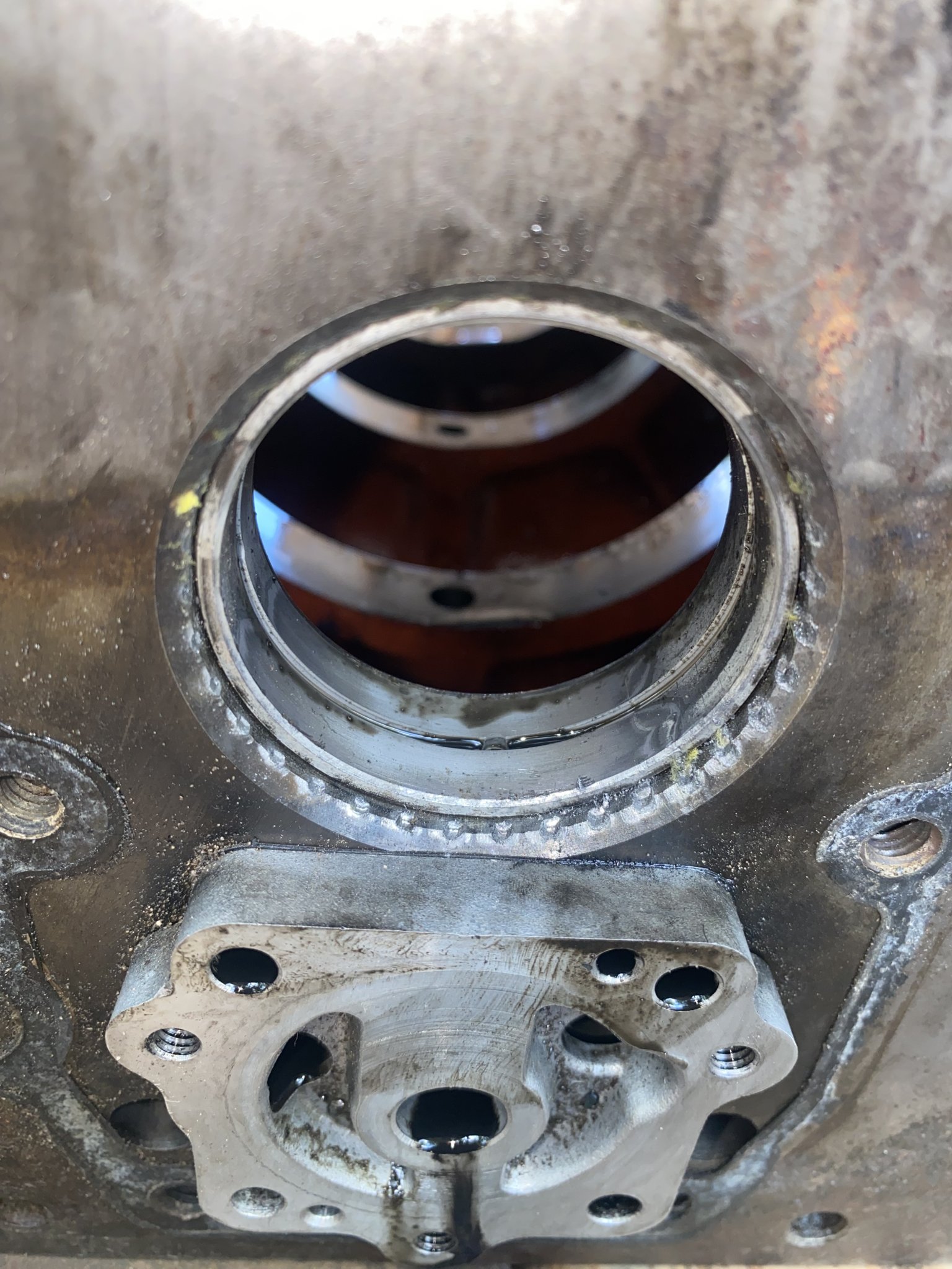

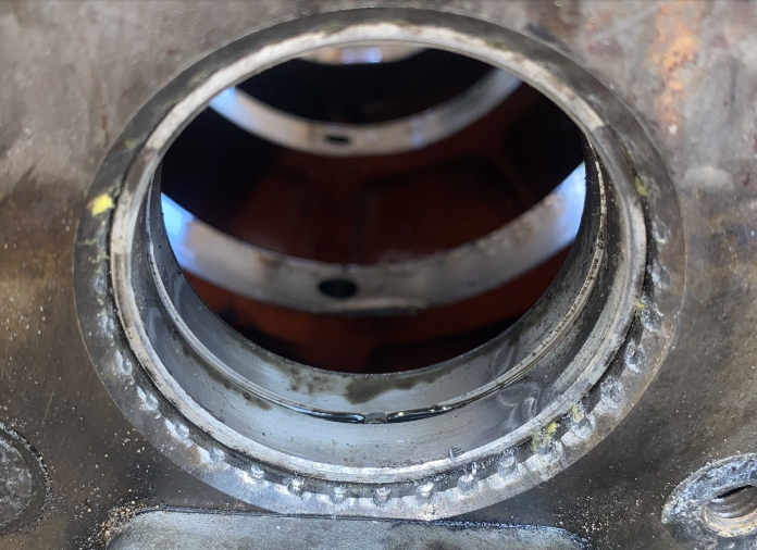

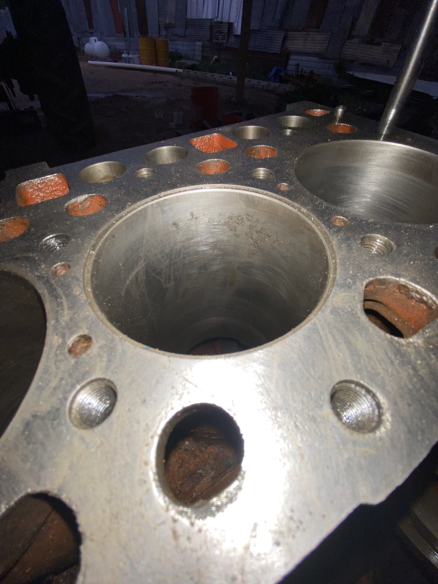

this is one of the holdups: the liner is shifted down a few millimeters
to fix this, I think it would require machine work, is it worth fixing or not a big deal?

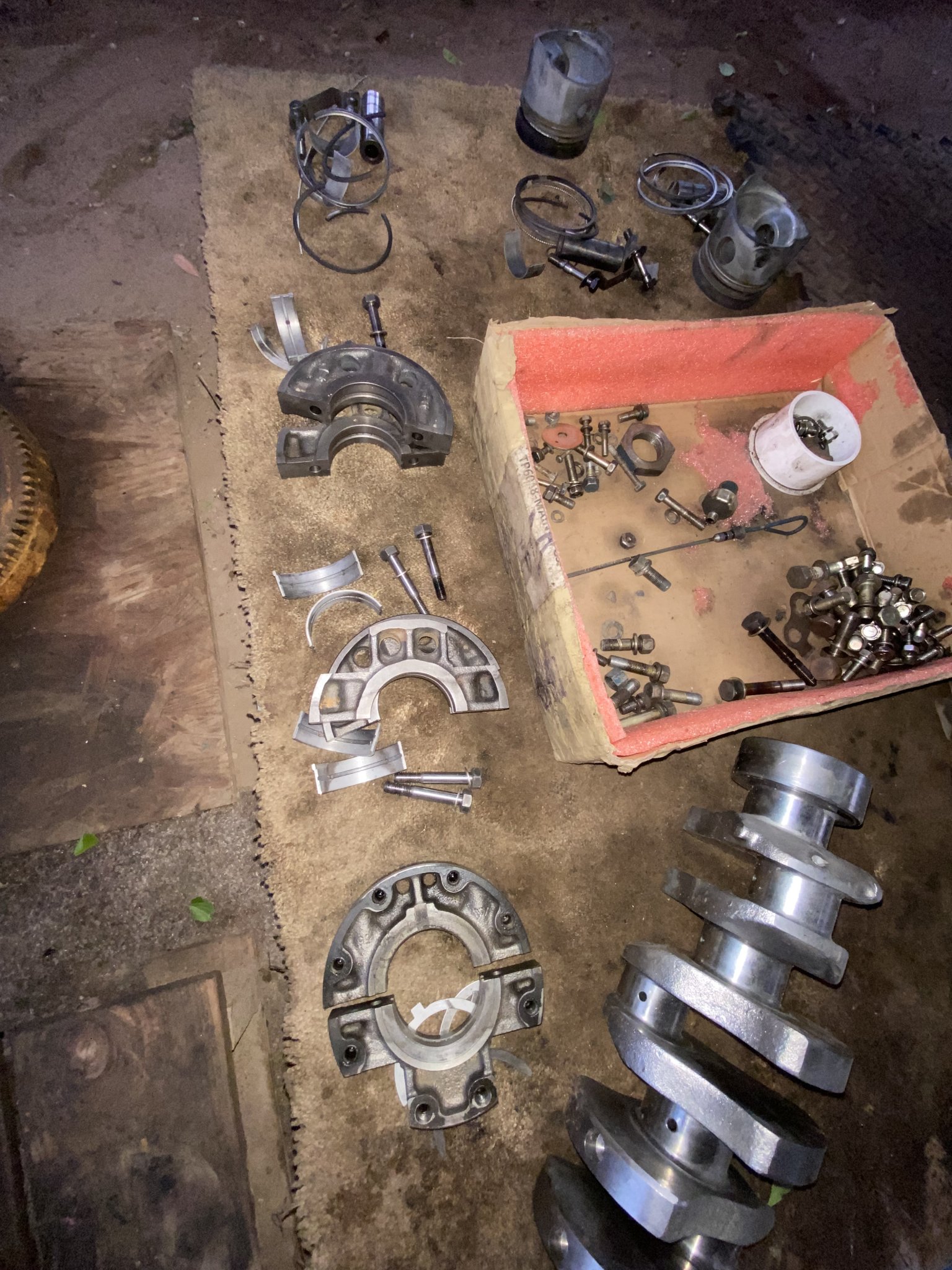

another holdup in my head:
whenever hammering out the crankshaft down, the gear was pushed into this ring, the ring did shift a little bit down
My theory: whenever I hammer the crankshaft back in, it should push that ring back into place
should I also replace this part? Does the crankshaft spin on it? Is it part of the bearing system?
now I am just assessing before ordering anything, it gets expensive real quick if you want genuine Kubota parts
my current assessment: replace all the bearing areas, don’t worry about the liner, it’ll be good for few years, and that ring that shifted, it is not part of the bearing system and does not need replaced

The liner is not great like that, but it will only affect compression, nothing else.
The extra metals are thrust bearings, and yes they only go on the back bearing.
You need to mic the cylinders to know if you need oversized pistons and or reline it.
yes, long as it can give a few years of no trouble, then it’s ok
yes I studied them, they have slits in them and face the moving crankshaft for oil distribution

here’s a micrometer kit, will this be able to mic my cylinders properly? They are 3 inch cylinders
My understanding: instead getting standard pistons, I can get 3 oversized pistons, since I am having to replace 2 broken pistons anyway. And put all new ring on them. Then maybe I won’t have to reline the block
I do see rebuilders using this tool to hone the cylinders with some type of stone, let me know if I should do this and let me know what grit to get
my instinct: hit the liners with the stone honer, make those areas silky smooth where the piston rings rub thousand of times a minute. The liners are the area of most resistance in an engine, and are the most important areas to polish

You need these to measure the bore:
Honing the liners and keeping then to the exact tolerance needed is extremely hard to do.
I have a $1000+ into my precision hone setup and I don't like doing them.
The hone you pointed to is not a precision hone, it's just a deglazing hone and will not size the cylinders.
This is style of hone you would use along with several grits of stones:
Get new sleeves and have a machine shop install them and bore them to spec, it will be the best thing overall.
Just by the looks of the pictures this liner is shot, between being pushed down to far it also damaged, it will destroy a set of rings.
This is a bearing, it needs to be removed and the block surface needs cleaned up.

While you're looking for a solution to the sleeves - Are they (shop) machine capable; does their tool maintain accuracy in three dimensions? Is the machinist capable?
Yes, your statements is the reason why I decided to slow this thing way down, I need to get this part of the process done properly
I'll show yall what I figured out:
Here's someone in the same situation, trying to put in new pistons
Just like the forum said, if you get pistons from kubota, they will not fit, the sleeve needs to be bored for the piston to fit
And the genuine kubota pistons are not coming from japan, they are Indonesian
Piston liners: I might be able to hammer out the liners, and hammer in new liners
Here's a clip of someone removing cylinder liner using flathead and hammer
Ok here's him installing new cylinder liner using: 4x4 wood block, and hammer
Here is another video of someone hammering down on the liner with flathead, removing it from the block
My thoughts before seeing these videos: the liner is fused to the block and cannot be removed with hammers etc
Not true, one can take out liners and put in new liners without going to machine shop
Question: how does the liner not go up and down when the piston is rubbing on it up and down? I get it cant go up since the head will stop it, but what is stopping it from going down?
Let me know if these statement are true:
"Liners are like bearings, they are made to be replaced and should be replaced when doing overhaul."
"The area of most resistance in the bottom area of engine, is the piston rings rubbing on the cylinder liner."
"This engine, since piston #2 and #3 had cracks in them, that is signs that something is off in the way the piston is going up and down that bore hole, leading to the need to put in new liners, and bore them out to factory spec"
What is the yalls theory as why pistons break?
I am slowing things down because I need to get this part of the build right
I do see people when installing new liners: Put the engine block in the sun for hours, put the liner in the freezer overnight, take the liner out of the freezer, lube it up, and hammer it down into the block using 4x4 wood
I am working on another job, but once i get back to it, I will try to remove the liners
