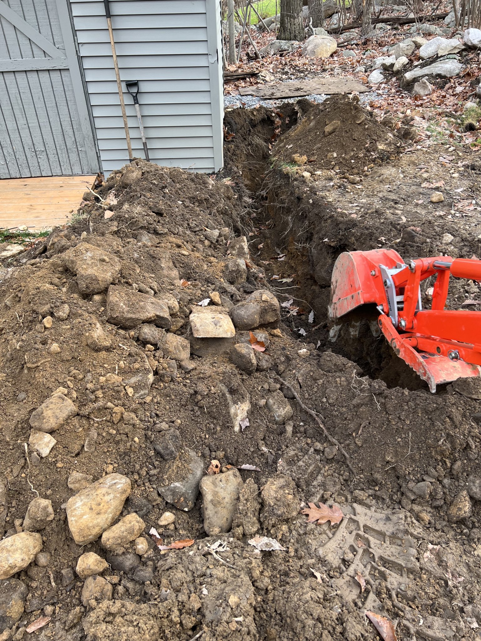

So my first trench is basically done. Now I need to order sand.
BX23-S,57 A-C D-14,
13,959
6,353
hmmm.. hope that's NOT your weeping tile in the trench......!!!
I 'found' a 3" one last week..pretty sure it was for a gutter on the house. It was FULL of silt,so not 'mission critical'.
Take lots of pictures from 'fixed' reference points.
It'd be nice to see a 'sand slinger' fill the trench with 6" of sand....
hopefully you CAN get bucket loads of sand there and just easily shovel into the trench ?

That black tube is connected to the downspout coming off the corner of the shop. I didn’t realize it was there and may have damaged it. I’m going to inspect it a bit closer today and will replace it if it’s damaged. Not sure where it emptied out.

What’s a ‘sand slinger’?
