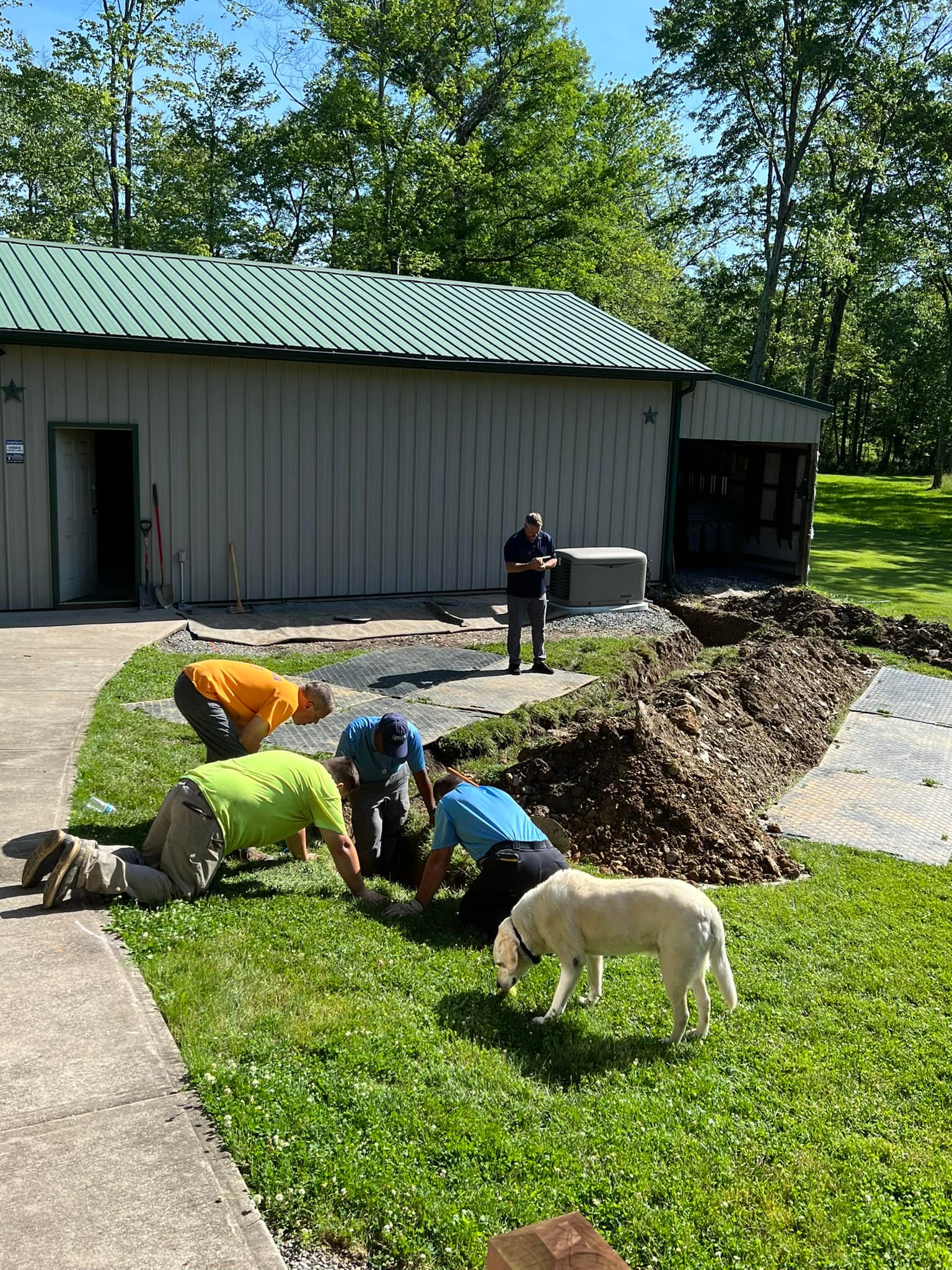

Hi everyone. Thanks so much for the awesome feedback. Here are some additional details.
  • The propane co. told me the trench had to be 24" deep with 6" sand bed. I'm assuming, based on basic math, that code requires the line to be at least 18" deep.
  • I did ask them if I could run black pipe, instead of the yellow-jacket copper, but they did not respond.
  • They are sending the site technician back out here tomorrow. I guess they were not comfortable with accepting my measurements/photos via email, so I will let you know what they tell me.

If you have rocky soil, then the backhoe should do it for you. That's what I used.

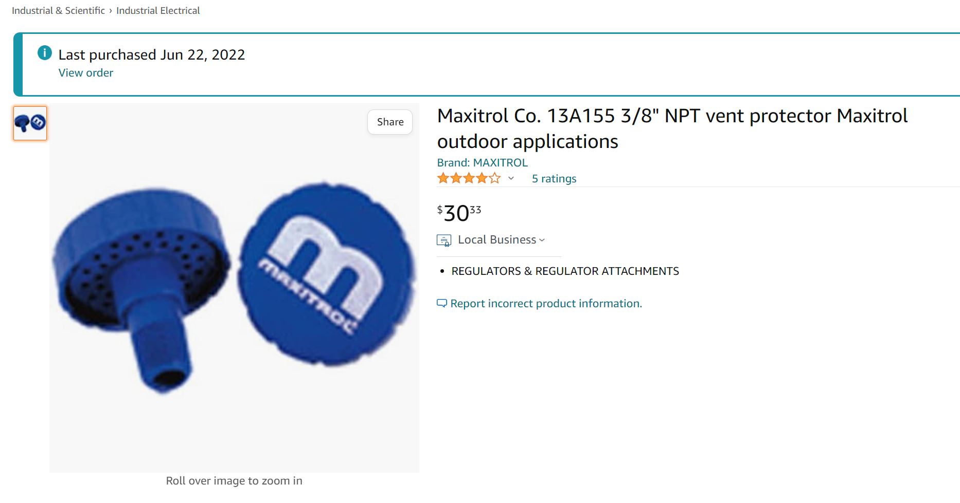

I just had to re-dig mine this past summer due to a tent stake going thru my propane line. @ feet deep should be plenty (at least here in PA). Make sure that you get one of these vent hole plug protectors on your regulator (ask me how I know). It will save you lots of frustration by keeping the mud daubers from plugging the vent.
maxitrol vent protector (just get the correct size). You can find them cheaper from other suppliers...

Vent screens are a good thing. Don't need the fancy expensive blue ones. Just get a 1/4 (or 1/8") brass nipple or short pipe. Fill it with lightly packed stainless steel wool and you're good.
