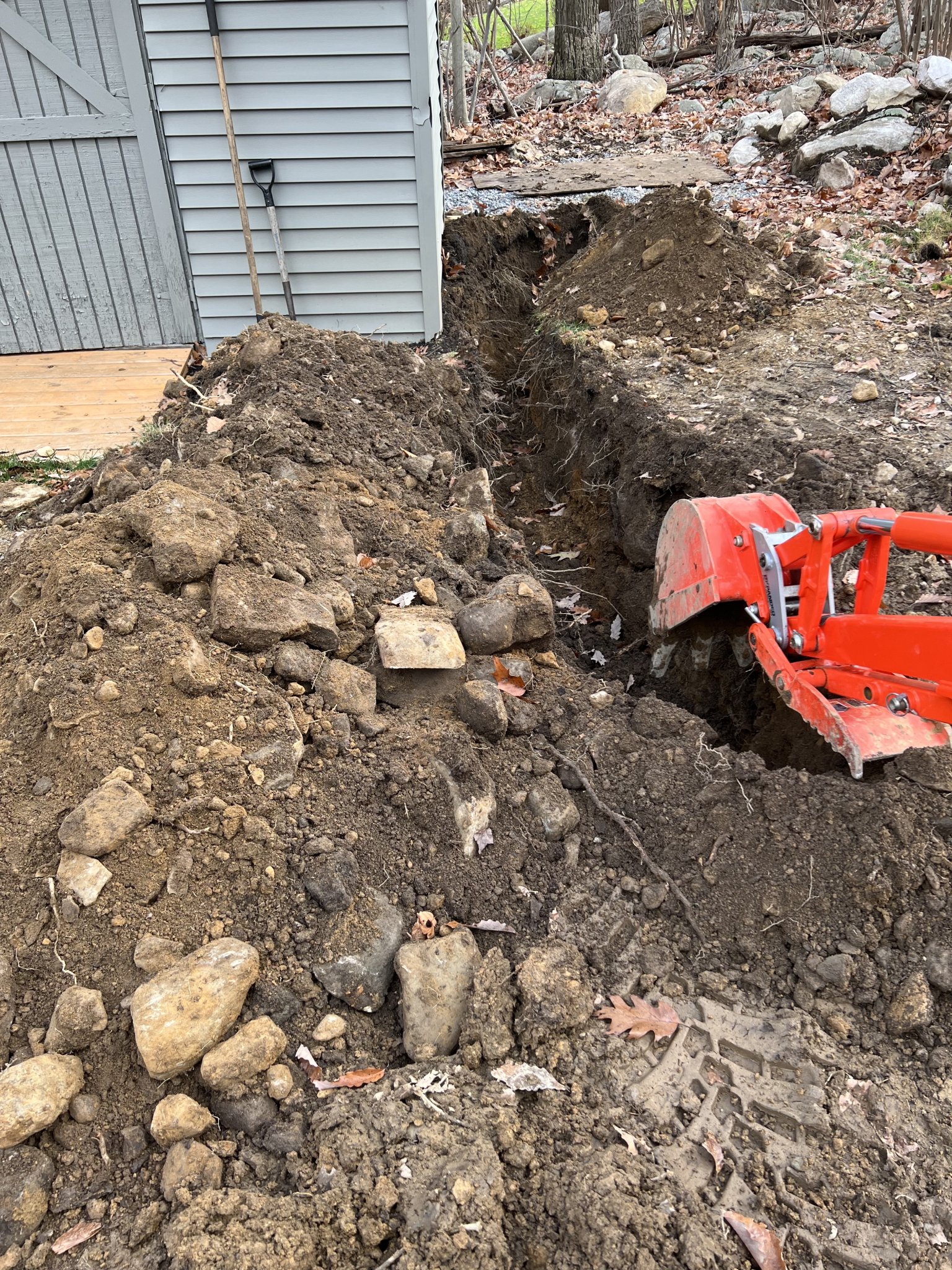

I started on the trench today. To answer some of the questions about using a ditch witch, there are a lot of 14B78006-3C94-492C-9B8F-A45E523D7A17.jpeg rocks in my soil.
racerboy
L6060 Cab, 1055 loader, grapple, BH92; RTV-Cab
May 10, 2021
247
226
NJ
I started on the trench today. To answer some of the questions about using a ditch witch, there are a lot of View attachment 90429 rocks in my soil.
My other question has to do with my tractor. What RPM should I run it at while digging, and I’ve also noticed that it seems to have lost some of its ‘strength’ to lift bigger rocks with the thumb. I checked the hydraulic fluid and that seems fine, but I’ve notice that when I’ve gone to move some rocks that it can’t lift them but these are the same rocks I moved with the tractor back in the summer. I know that probably sounds crazy, but is there something else I should check? Even the speed it dumps the bucket seems slower.
WAS BANNED FOR NSFW PICS
6,517
5,164
You might have to check and adjust the hydraulic pressure. When I had my BX22, there were a lot of rocks that I could dig out, but it didn't have the capacity to lift them out of the ground. I would dig a side hole, and relocate them because of their weight.
BX23-S,57 A-C D-14,
13,950
6,345
rocks ? sigh, you must be real close to where a glacier 'stopped' eons ago ! Have two neighbours down the road, guy to the east live on a sand pit, guy just west ,maybe 1000', WORSE than your place !
I ran tach at 2500-2800 todig and dump HIS 'rock collection' last year. A thumb would have been nice....
Always dig a little deeper( +6" ?), maybe use a 'joint' or something on the BH as a reference so after 3-4 hours 'muscle memory' will automatically do the measuring for you .
Also take breaks otherwise your butt will be sore !
