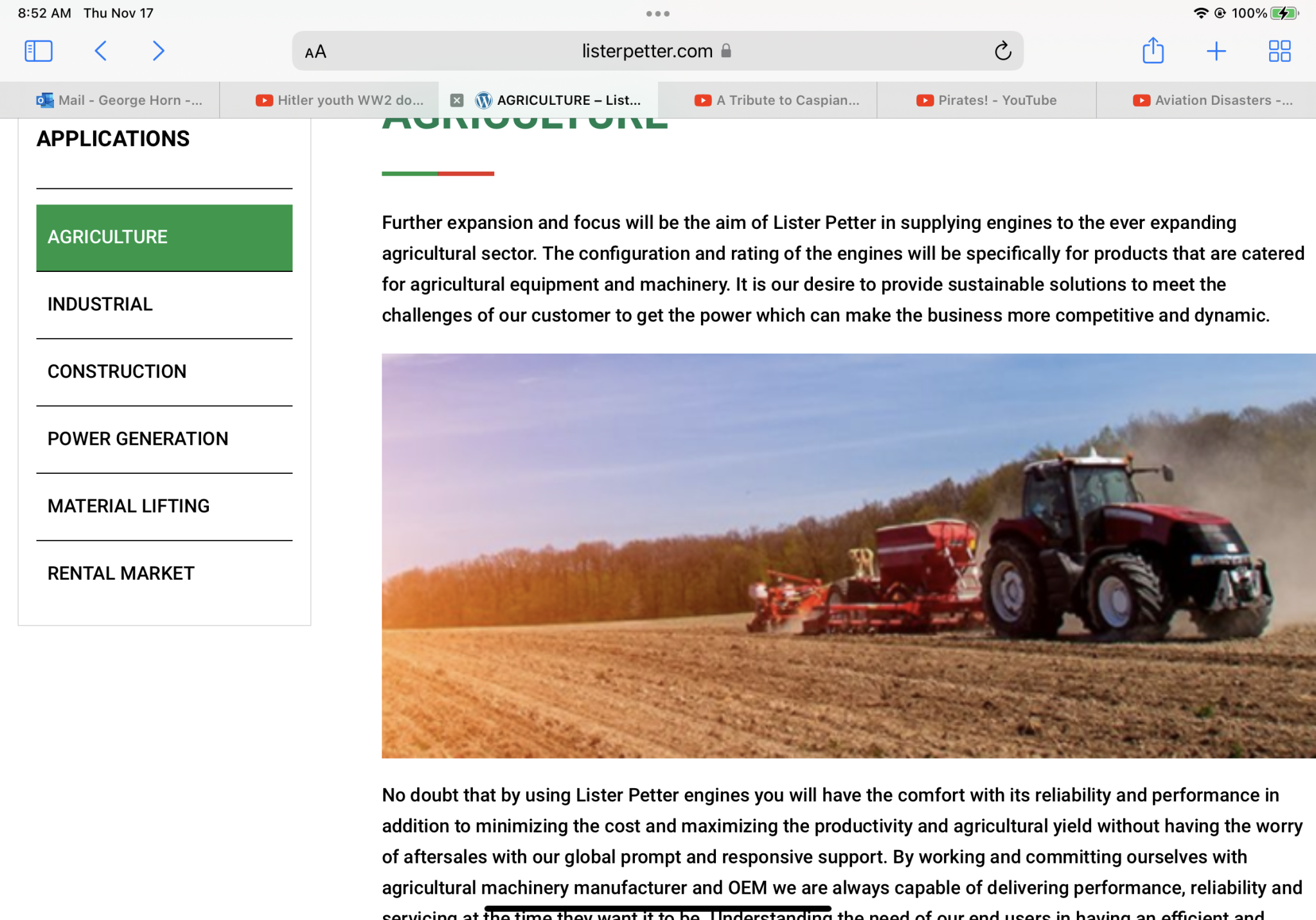

Engines which rarely shut-down usually have great longevity…. That shut-dn/start-up heating/cooling/heating cycles are killers.
Apparently, depending upon which Brand of Tractor you purchase…it might come with a Lister Petter diesel: 93E0197B-8D7A-414D-A20B-AD58117290B7.png
