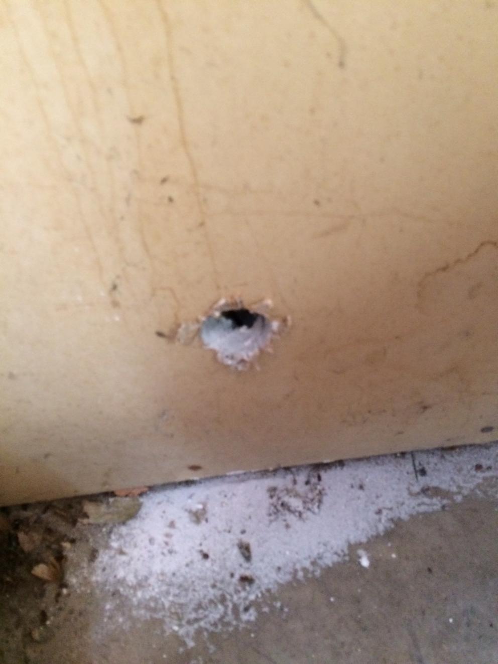

You inspired me to get 220v out in the garage.
Putting a 60 amp subpanel out there. 125amp-12 slot box. Box is placed and wire on hand.
Would have loved an 100A sub, but the wire would have been a killer.
Will do the welder, back-feed for generator, and some other circuits around the garage. (maybe a 220v air compressor?)
Route for the wire to the cellar is a challenge, but nothing LONG SDS bits won't accomplish - unfortunately, found my "bit" was too short!!:eek:
I always thought 12" was enough....:p
My wife just laughed at the whole thing!:p
Anyway - screwed up my day, but I'll get a 16" Harbor Freight bit tomorrow!

I just ran into a similar thing trying to run a smallish wire through slump block. Never realized till that moment that all my long bits were monstrously large for a little hole to feed a motion sensitive LED light. Generally the small bits have been just for anchors and such. But take a look on Amazon. They've got long small Bosh SDS+ bits for surprisingly cheap. I bought several in a range of sizes, don't think I'll ever have that problem again.
Your wife laughing at you about 12" not being enough, well, that's a whole different issue...

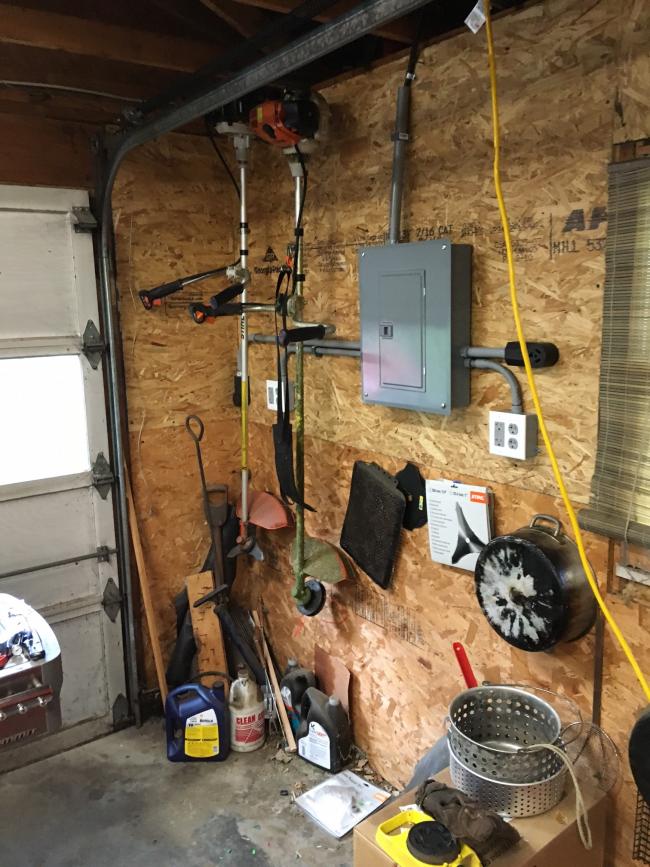

Well, we're getting there.
Wire run one panel to other. No connections yet.
Started with 40A welder plug on #8 THHN. Lincoln 210MP cord reaches well, and tucked into corner, will be good to plug generator into if back-feeding. Will also keep generator outdoors, so we don't have any CO poisoning concerns.
Will also do a 30A dryer outlet circuit on #10 THHN for an air compressor, iff needed.
Probably a couple 20A 120v circuits mounted nearby on #12 THHN for other power tools - one might go to near the toolbox.
So - a 40A 220v, a 30A 220v, and 2-20A 120v circuits will do wonders!:D
Advantage of being 6'4" - outlets on the bottom of the trusses are reachable for me, but still out of the way.;)

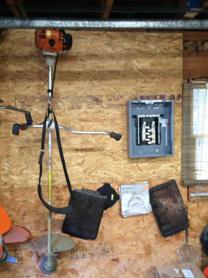

This is the sub, but the connection hasn't been made back to the main. Maybe tomorrow.
There are 50A welder outlet next to garage door, another 30A dryer outlet on the right side, which might be a 230v air compressor, then 20A 120v outlets both sides.
There may be one more 120v-20A circuit for the garage doors, but that can be added later.
