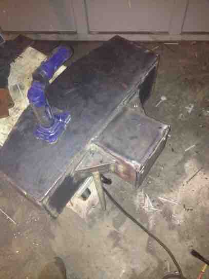

Been making some progress on the bumper.
Got gussets on the mounting plate.
Got the snatch hooks mounted.
Filled it up with 100 lbs of sand.
And been working on getting the top welded on :D

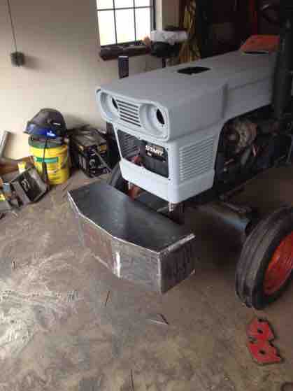

It's all together. Tops welded on, plus the top plate. Got a bunch of grinding and smoothing, and then it will be ready for install. Did a test fit earlier, so I know it will bolt up [emoji51][emoji51][emoji51]
Total weight is somewhere between 210 and 220 lbs. Metal was right at 120 lbs. Took just under 2 full 50 lb bags of sand to fill it.

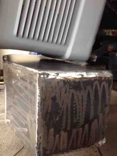

Bumper is finished and installed. Gave it a quick test fit with the hood to check clearance. When hood is raised, the is 1 1/2" clearance :D
Now to remove the hood. Clean up my mess. And hit it with some rust treatment before priming.

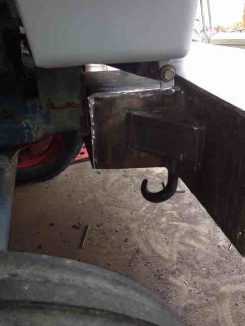

Here's one of where it mounts.

Frank, bumper weighs around 210, to 220 lbs. I had around 240 lbs on the front before the redo, between the bull horns and the 1" plate steel. So it should still keep the wheels planted with the bush hog on the back :D
