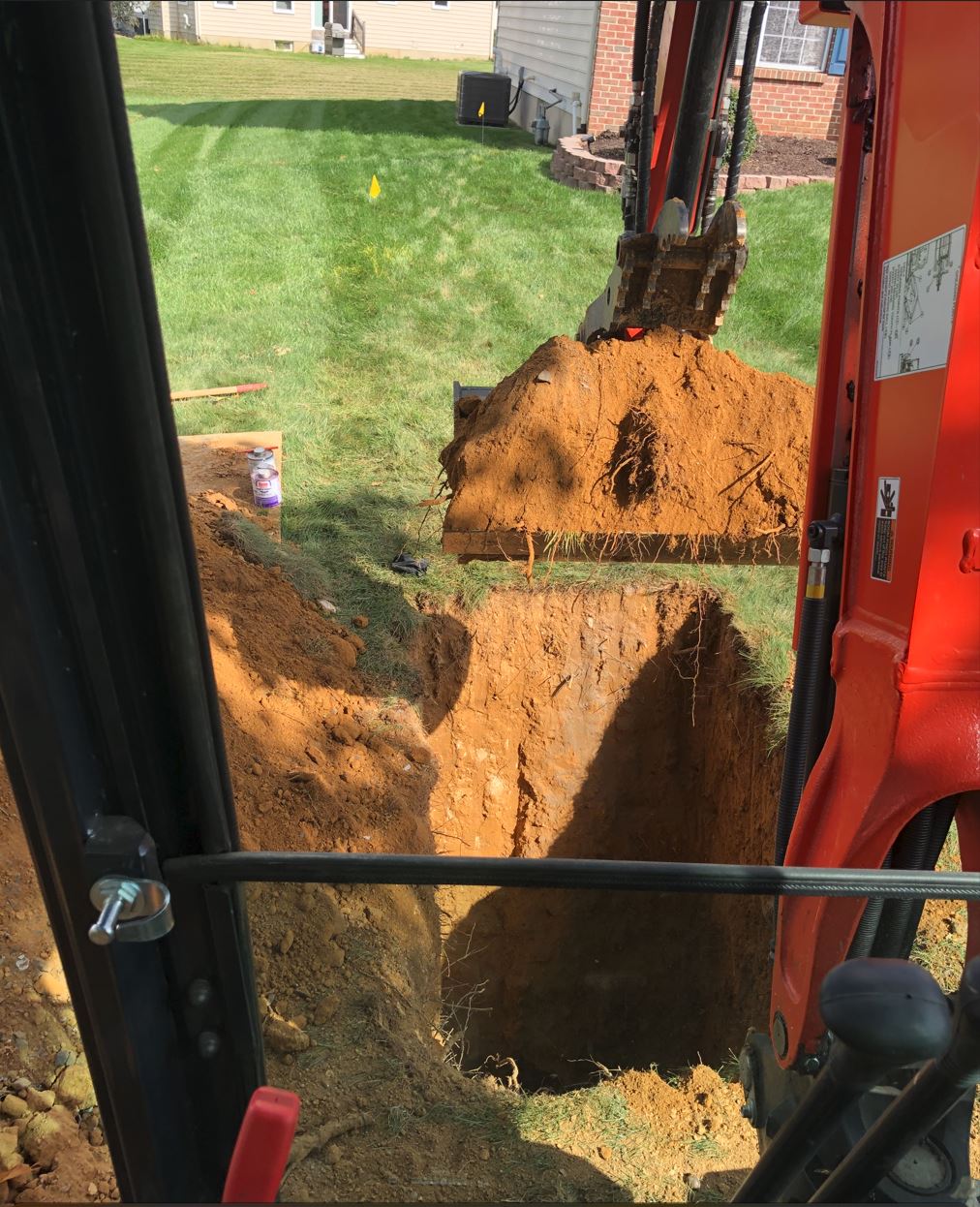

Happy to report that todays job was the kind I like to do. Dig, repair and get home to my other "real" job.
This one was simple. About 8 foot down. Nice, firm ground.

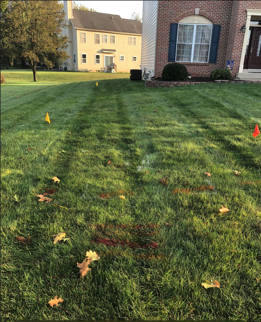

Start (I always get pics of the one call markings before anything else is done).

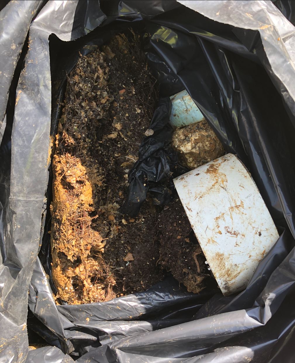

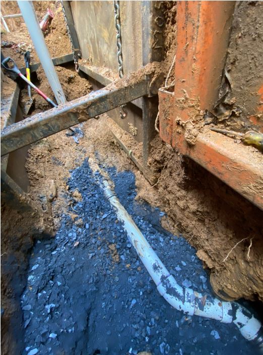

Found this: root intrusion down 8 feet where the 4" pvc changed to 6" sdr. Roots broke the reducer/hub.

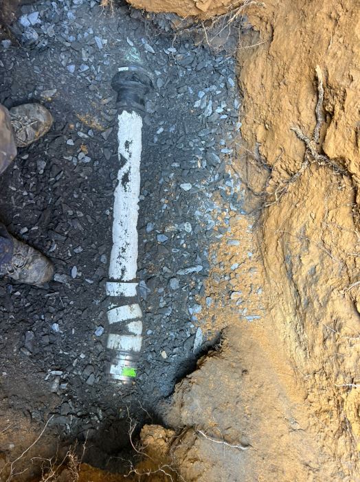

Pipe (with evidence of roots on right side of pic):

DD, is there usually/always a small leak that gives the roots a 'toe-hold'? If so, do you think it's due to a poor installation or a joint break due to settlement, etc.?
3,680
5,961
Good question.
It would appear to me that both of your answers are correct. I've noticed that there seems to be a common cause in each "neighborhood" that we work in. One development may have several jobs where we find glued joints w/o primer. Other's where we find house traps have broken from settling either from lack of stone bedding or something as simple as a clogged gutter dumping water next to the foundation or a combination of all of these.
Then there's the typical joint separation and/or decay when older materials (terra cotta, cast iron) fails. These are to be expected simply due to age.
One additional cause is from the homeowner/renter...many that get plugged with grease. Failure caused be mechanical cleaning of the lines.

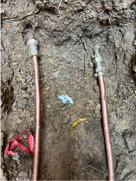

Double Orange day! finished up the job we started last week. It was another 12 hour day wrestling trench boxes, cast iron risers and 6 foot deep water lines. We wound up renting an 18" bucket for the KX080. I was able to fit it inside the trench boxes and kept digging to make the sewer line connection. Depth was around 9.5-10 feet.
I didn't get many pics of this one as I was just too busy/tired. But I did snag one of the two Oranges together...one big, one very small.

I have a 12", 24" and 36" for the U27. The issue was that there's no way I could've reached where I needed to dig with the U27. It was 9 feet down and 8 feet out. I would've had to backfill against the front of the trench box (doable possibly, but we already had the big machine on site).
edit 1: forget to mention that the guys (plumbers) don't like working in any trench less than 24" wide. Most of them are bigger guys, so, I get it. The hate it when they have a deep water service cut with a 12" bucket. Ditch winds up being 14" wide.
edit: glad it was an 18" instead of a 24"...lots of slop in that 007 rental hoe.
Not sure if I posted before, but I had one hell of a time pulling the trench boxes out of the ditch. The walls had collapsed against the sides of the boxes (trench boxes are 6'x6'x3'). The KX080 went into relief as I was trying to pull the furthest box from me. I had to rock them a bit to get them loose. It was roughly 12 feet away from me. That demonstrates just how much pressure the soil exerts. Interesting, and I made a mental note of it.

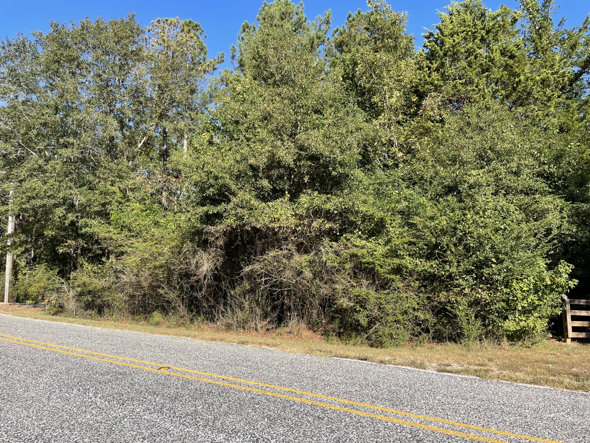

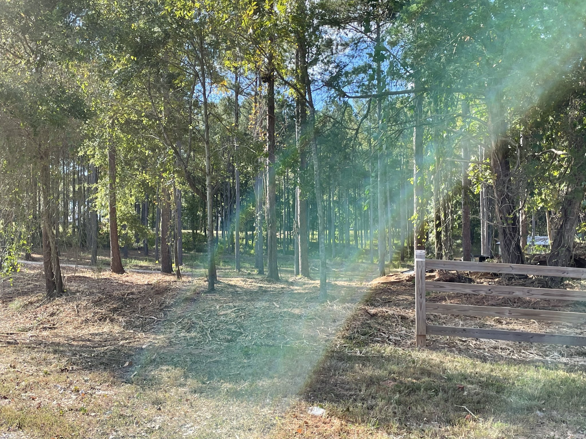

I started cleaning up the front area with my labor and the Kubota. There’s a section where the wisteria and kudu were taking over some trees and I wanted to eliminate them. After a damn hard day, I had accomplished very little and I had broken (yeah, broken) a walnut tree by pulling two vines at once. Its diameter was only about 8 inches and it was full of nuts.
When I came inside, I got a couple of quotes from the local mulchers and went with a local fire department captain who originally cleared our land several years ago. Just because you own a tractor doesn’t mean you should. ;)

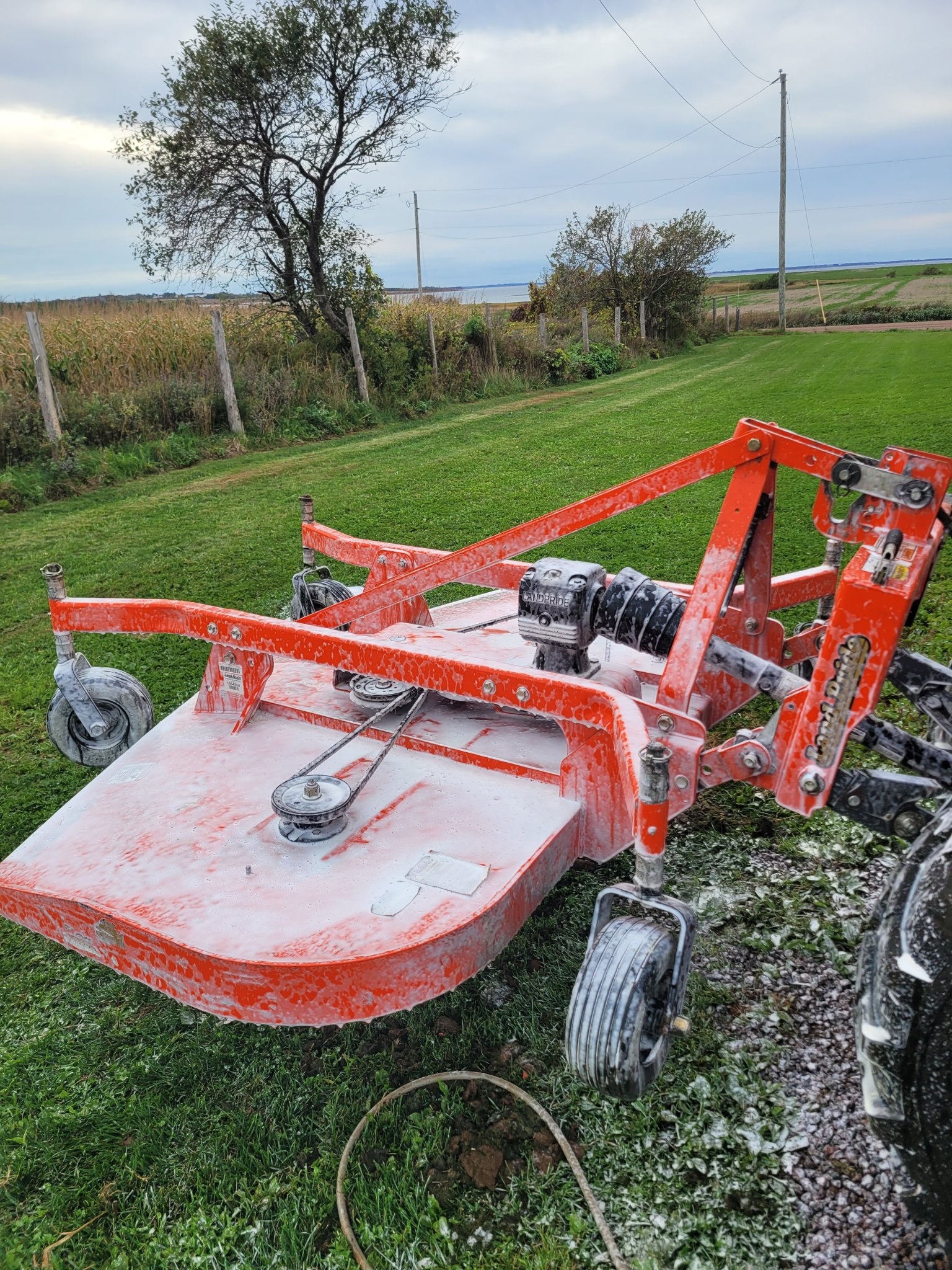

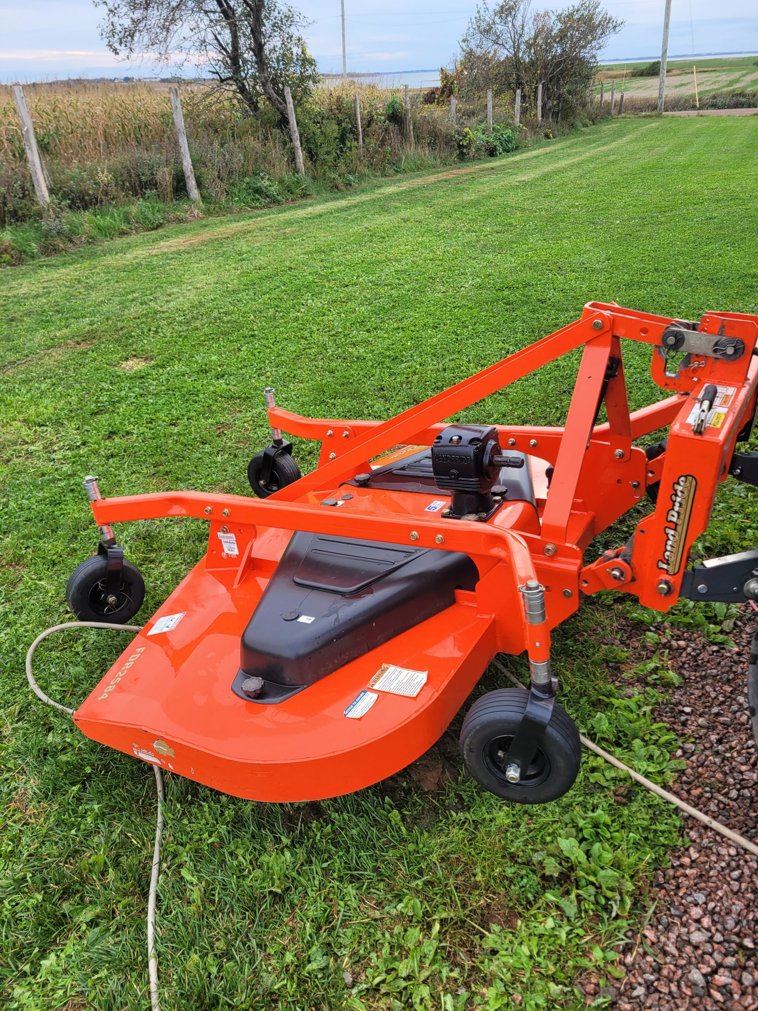

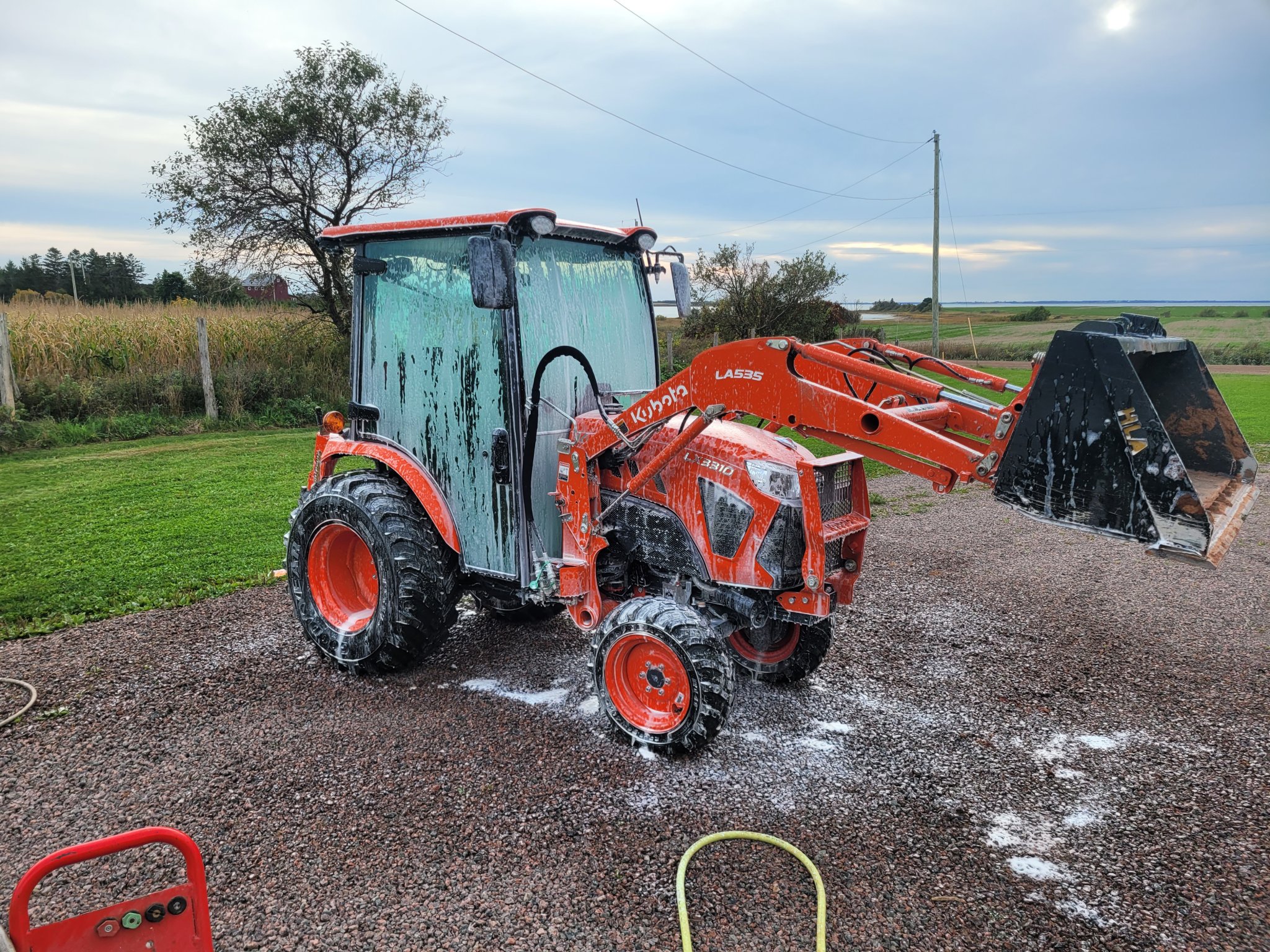

Mowed 10 acres with the LX3310 and FDR2584 then gave both a bath. Last mow of the season so the bottom of the deck was cleaned and everything greased so it's ready for next year.
