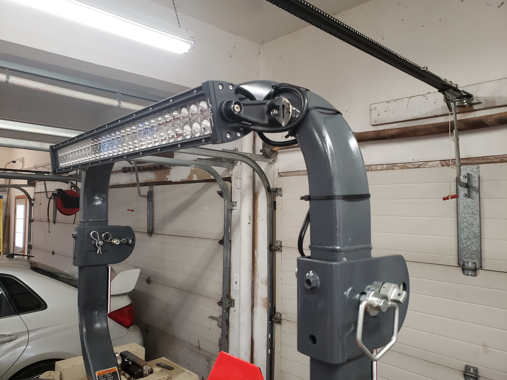

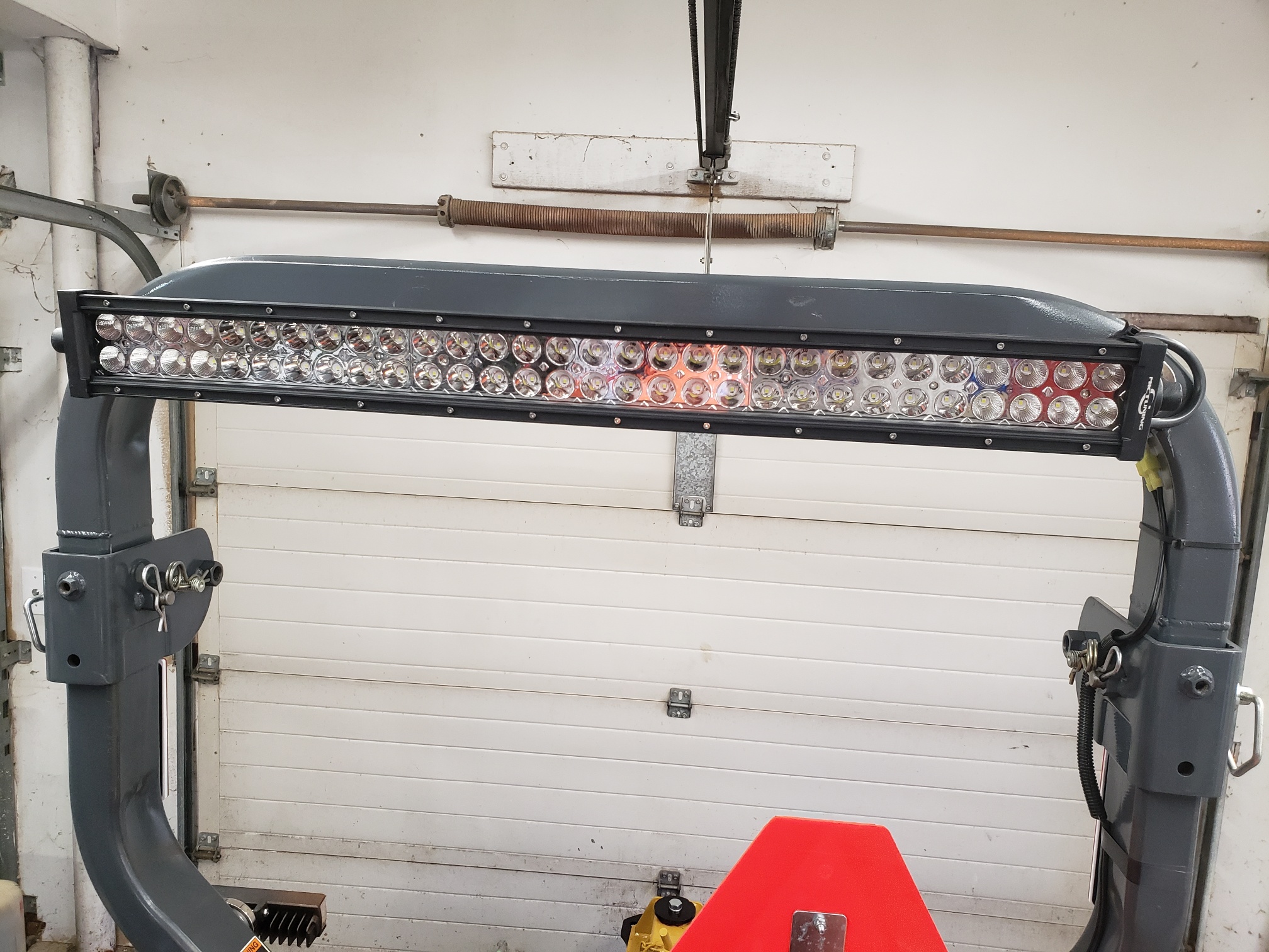

I installed my new light bar on my (now) shortened ROPS. It is held on by magnets - super strong mothers. The side view shows one mount. Of course the 180 watt advertised rating measures out at exactly 70 watts. That said, the sucker lights the night!

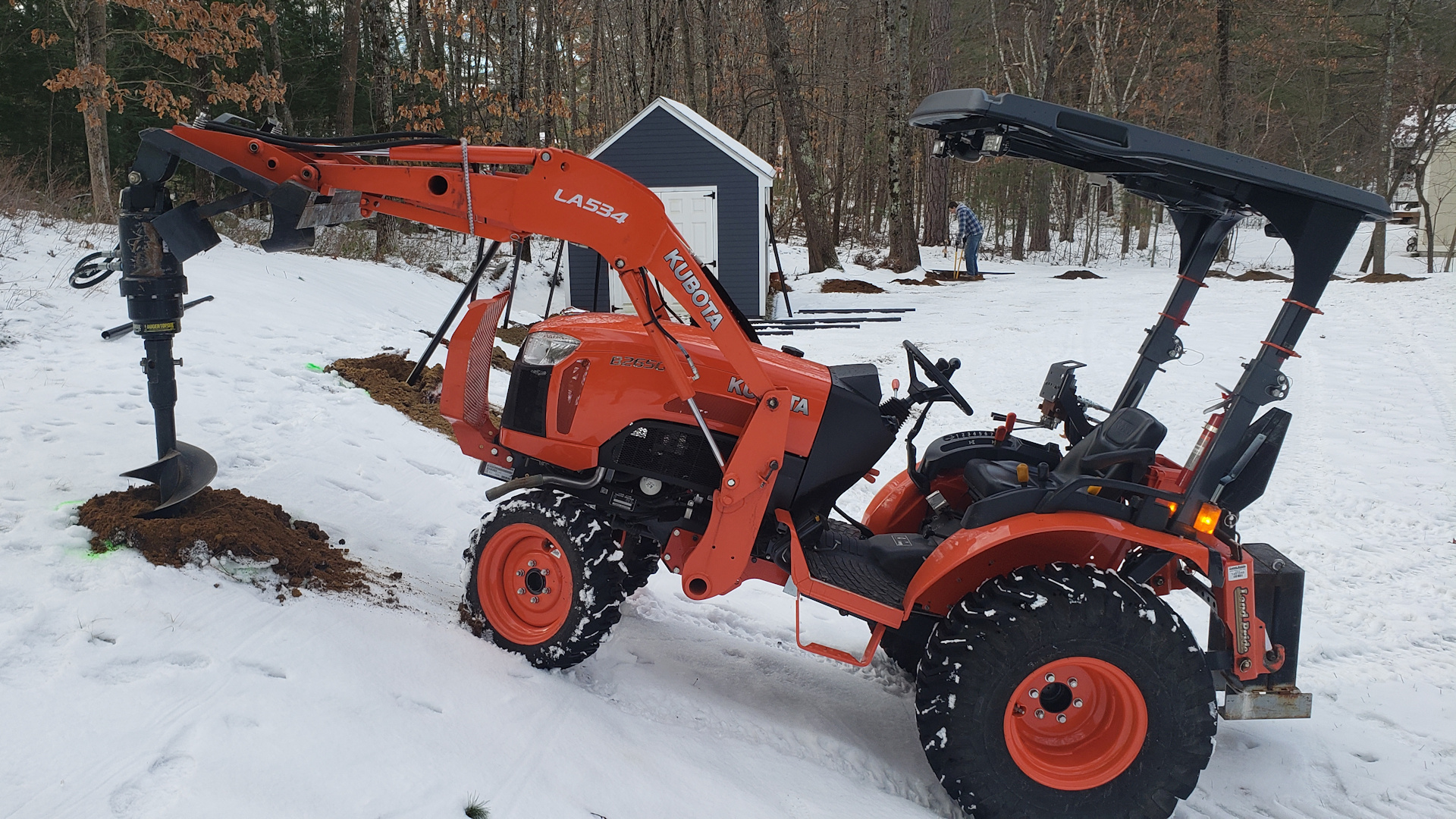

Still punching holes. We have about 6" of frost now and so far, the auger is working well in it. I have modified another bit to aid punching through.
An auger is on the short list, all I've seen are 3-point. But that rig looks so sweet! An in-house design/build?

Our B2650s have enough power and hydraulics GPM to run an auger?
Yes, although low in GPM, there is plenty of pressure. I do not have the LP unit I design/built using an AugerTorque auger unit. I also have a cement drum I spin with it.
I am in NH, we are the "Granite State", digging here is hard. I was told by many on here that it would not work and I am glad I pressed ahead with the project. I have made/modified a couple bits to aid in the digging up here and they make a huge difference.
I have pictures of the project if you want some additional information.
What is that handle on your ROPS pin? I'm looking for something like that to make it faster to screw in my ROPS pins.

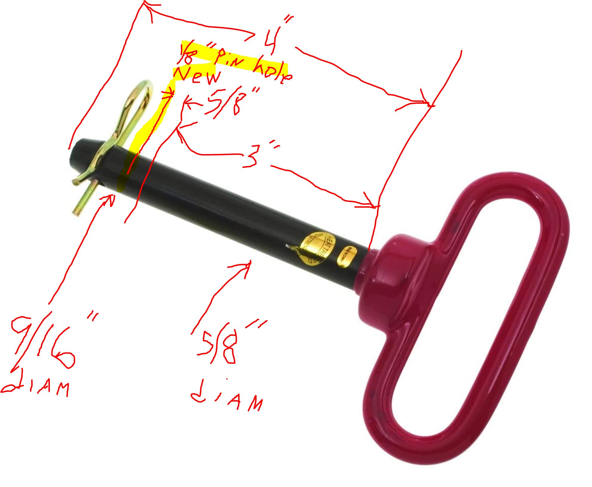

lol, I was with you - a pia every time I took the tractor out of the garage. I got 2 hitch pins from Amazon:
Then I sent this 'professional drawing' to my son:

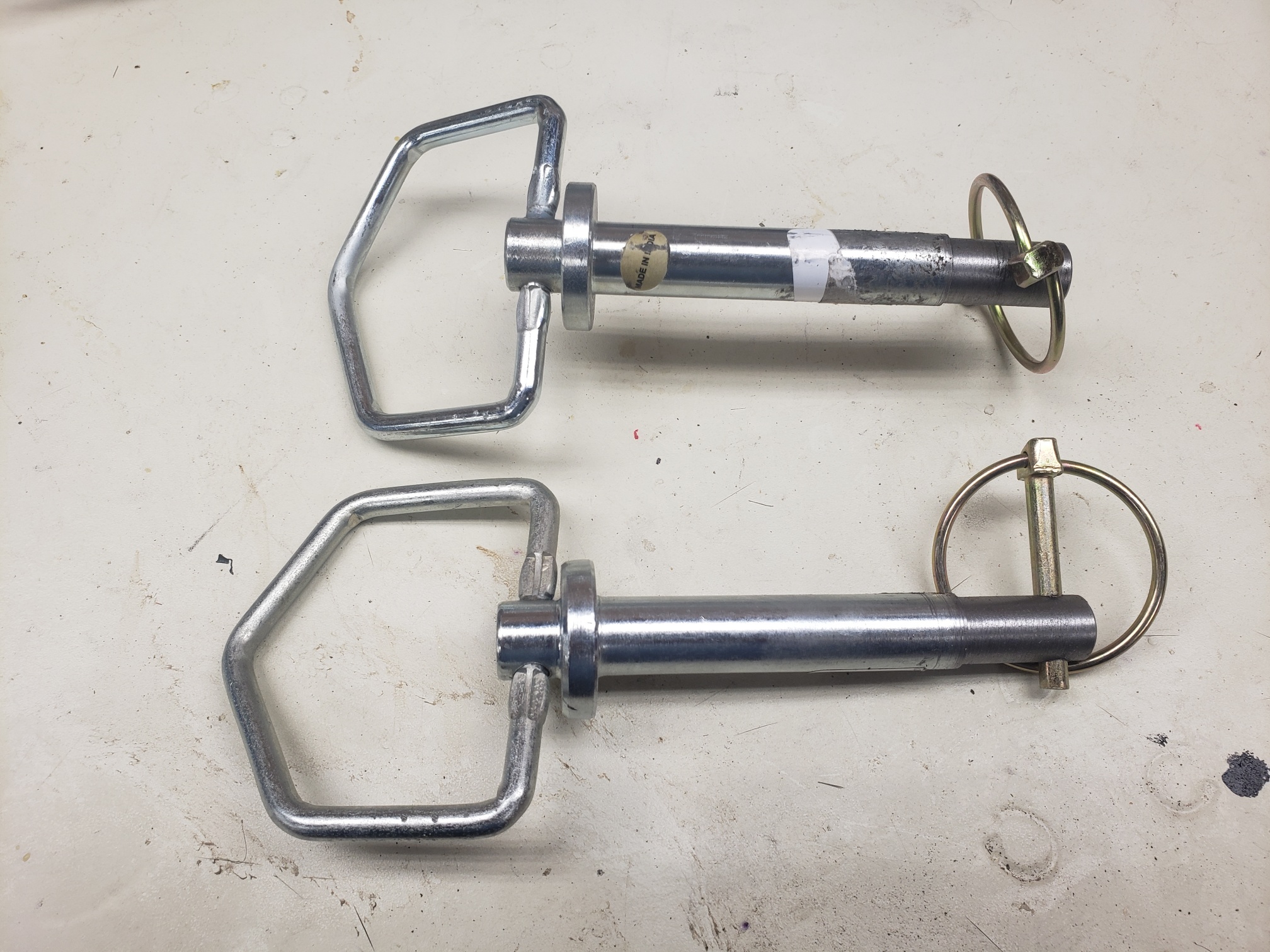

He machined them for me:
No more screwing when I put the ROPS up/down yet the full thickness of the pins are still functional. The turned down part only goes thru the welded on bolt. Note: I had to go with a hairpin as the pinhole is too close to the end.
In the end I cut down the ROPS - solves the "I forgot" problem.

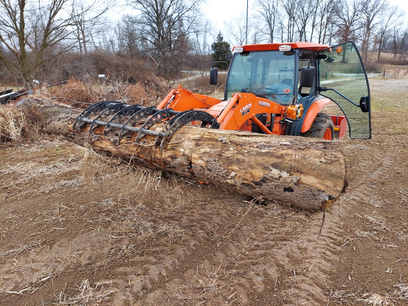

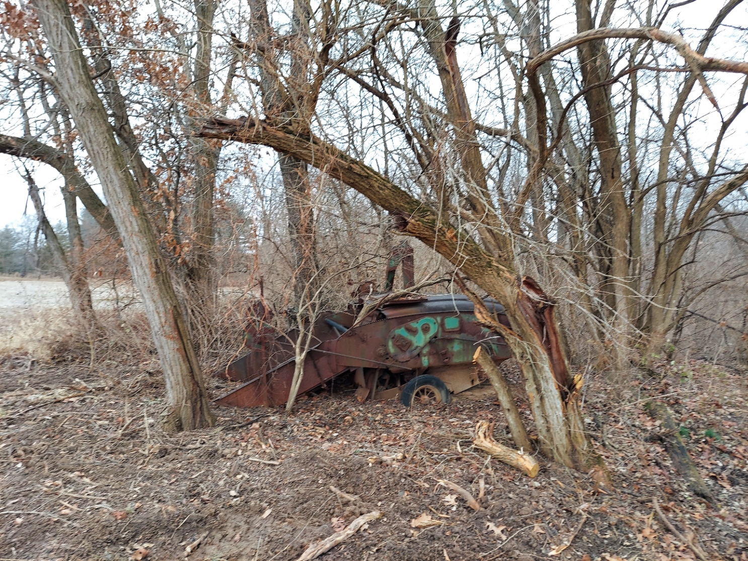

Another day cleaning at the farm. The project today was getting the old John Deere 12A unburied and pulled out to go to the scrap yard. We had several trees in the way and a couple that had grown into the machine.
So I started out with my handy Stihl chainsaw thinking I had grabbed the MS271, but instead I had grabbed the MS170. I started cutting, even though it is a little saw, it does a good job. I started hauling off some of the logs and debris.

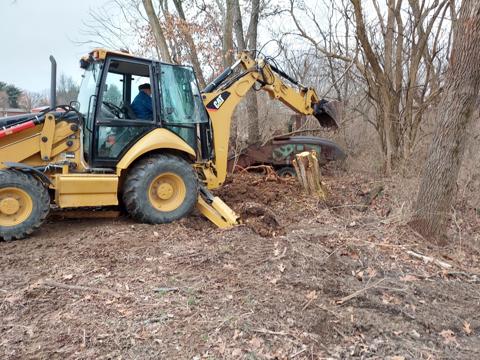

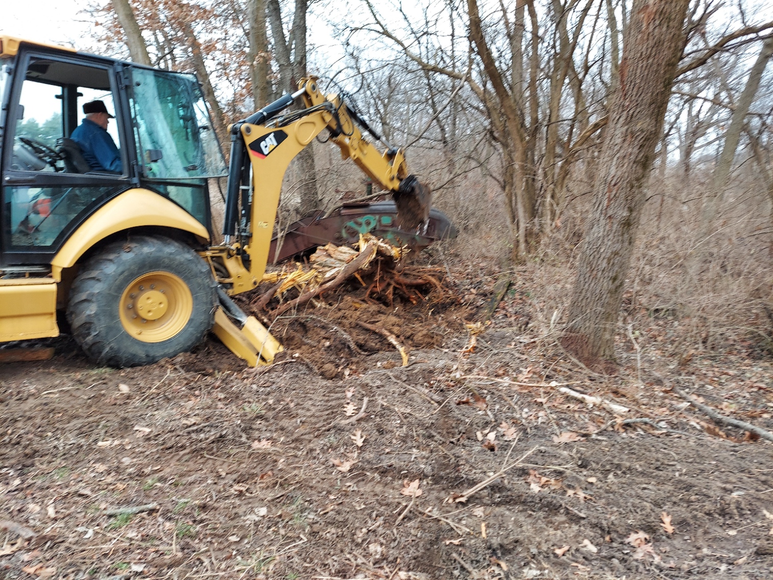

I would love to tell you my Kubota L3560 just ripped out those roots, stumps, and made short work of it all. That would be partially true, but I have to be honest, I had just a little help from the neighbor who was bored and wanted to know if I cared if he came over and played. Of course being a good neighbor, I couldn't refuse.
His little CAT tractor made short work of the stumps, he pushed some of the trees over and got my access cleared to the old pull behind combine.

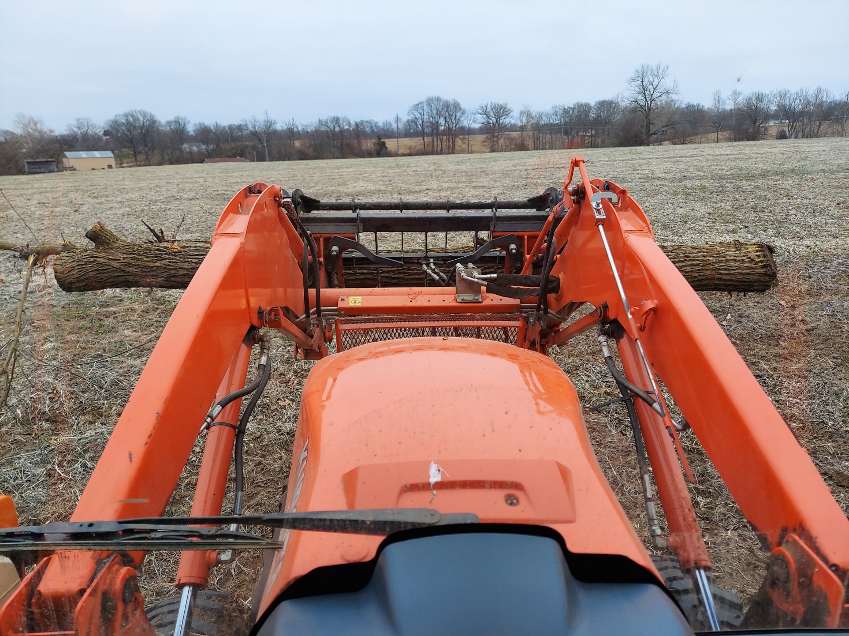

I was able to get it pulled out with the grapple.

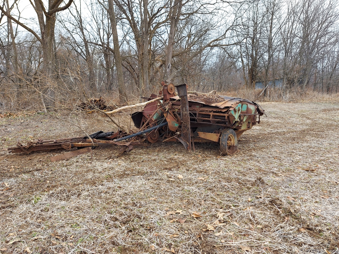

I got it pulled out and moved so we can place it on the trailer and hauled off. Spent a little time cleaning up afterwards.

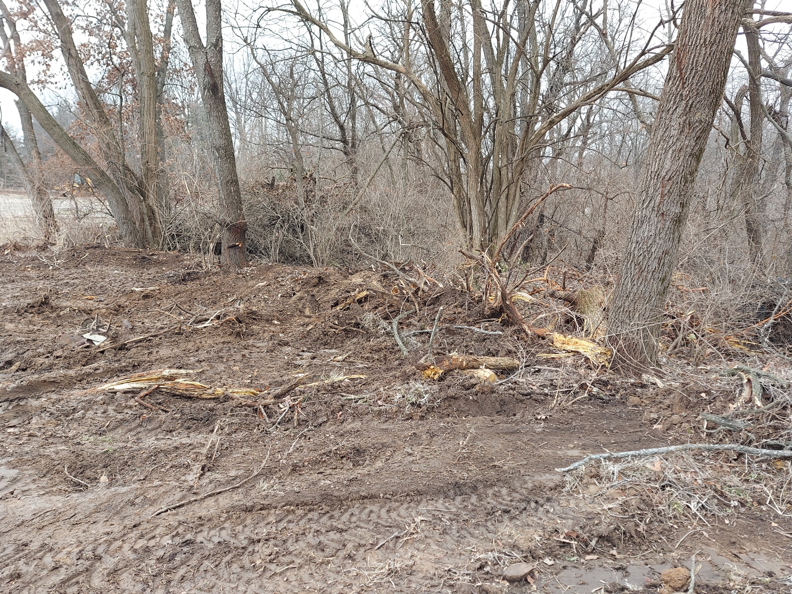

I forgot to take a pictures of when I was done for the day, but I was able to get most of the roots and brush pulled out and moved to the washout. Need to do some box blade work when it isn't as muddy.
Thanks to our great neighbor, he helped make a big project much, much easier.

I would try to sell that for parts before I scraped it. Might get more for it since the scrap prices are so low.

Before we discussed moving it, we looked all over it and sadly because it has been out in the weather so long, everything was rusted and destroyed by the weather. We asked a few to see if there was anything that might be helpful to others versing just scraping and sadly it was to far gone. We had a person interested in the wheels, but once we dug down and looked at them, since they had been buried, the wheels had rusted through.
My nephew had been interested in trying to restore it, but once he looked it over, he realized it was beyond saving. So far the nephew has restored grandpa's 1976 truck and got it running and he has it licensed and saving his money to get it painted. In addition, he got the old Massey 35 running again and even had it out driving it around the farm. It needs new tires and more work, but the nephew likes restoring and has the skills to do it.
Nice, thank you for the excellent idea. I can't believe Kubota didn't come up with an easier way of doing it.
