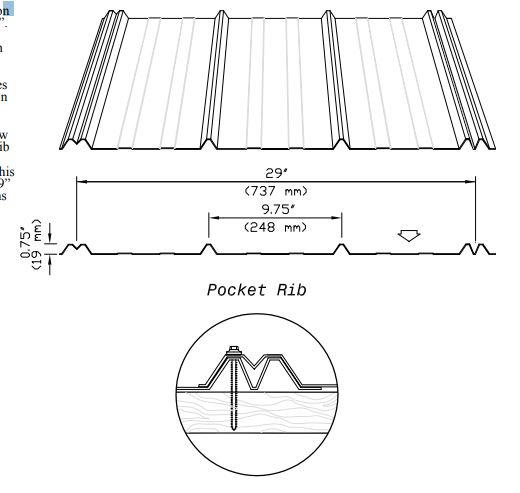

I have yet to see a corrugated steel roof where the fasteners are installed on the flats rather than the ridges. I've provided below a link to the data sheet for the steel that's on the roof of our hangar. This is essentially a pole barn that's 240 feet long by 36 feet wide, clad on the roof, walls and sliding doors with steel sheet as outlined in the data sheet below. Note the fastener location. On the ridge, not on the flat.
http://www.idealroofing.ca/english_us/pdf/products/pocket/DataSheet.pdf
Note this hangar was constructed in the late '80s. Over the last year we've undertaken to re-attach the roof sheets as the screws were starting to work loose. Had it been nailed it would have needed to have the nails re-done many years ago. According to one of the original hangar builders, they did a test sheet with nails. Two years later that test sheet tore off in a high wind. Its replacement was screwed in place like the rest of the roof and is still in place today. We see huge temperature variations, freeze/thaw cycles, high winds (have you known any place windier than an airport?), snow loads and ice, and yet this roof just keeps on keeping on.
An excerpt from the product data sheet is attached here to show how the steel is fastened.
Please don't take my word for it - consult the data sheets of your local roofing manufacturers. If they provide a different recommendation I'd sure welcome seeing it.

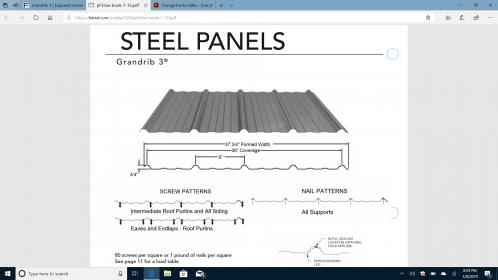

FABRAL can supply either screws or nails for fastening into dimension lumber. Always use screws with solid sheathing. Screws for use with steel panels are galvanized and then coated with an organic polymer for optimum corrosion resistance. For best results with aluminum panels, use #300 series stainless steel screws.
Wood screws with combination metal and neoprene washers should be installed in the flat area of the panel adjacent to the ribs,
Wood screws[ with combination metal and neoprene washers should be installed in the flat area of the panel adjacent to the ribs[/B], and tightened such that the washer is compressed as illustrated above. This will ensure a lasting, leak-proof seal

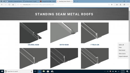

Fabral subscribes to the industry standards for fabrication and installation
RIBBED panels are fastened in the flat surface.
There were a few items to dispute
Flipper suggested using nails w/ the neoprene washers, Although nails are still accepted, a professional contractor would NOT use them.
The coated screws noted in the post above do not suffer from the forces exerted upon the panel by the sun. The panel, regardless of color, willl expand and contract, eventually loosening the nail head and washer.
Flipper mentioned fastening in a standing seam. This is physically impossible.
the profile of a standing seam is very narrow. A standing seam profile is very different from a rib pattern panel.
The standing seam roof is only attached at the seam. The fastener is BLIND, no surface attachment possible. Most are an overlay design that clips into place. there is a blind fastener on the unlaying panel
The more commercial style panels use a blind clip that is incorporated in the seam. See the illustrations. many of these seams are mechanically (closed) seamed.
Words and descriptions do matter. Federal legislation concerning warranties should reference the proper ACT name and tapered front roller bearings do not exist on Kubota tractors.
https://www.atas.com/products/metal-roofing-systems/standing-seam

Never seen any metal roof or metal siding where the fasteners were installed on the flat either. Not called 'standing seam' for no reason. The roof on my old barn is Grand Rib 3, same as my pole building shop. All fasteners are in the standing seam and all fasteners are neoprene washer'd nail in.
I didn't do either, had a contractor do it.
If you had a contractor install your Grand Rib 3 sheet with the screws in the peaks... You got ripped off!
And there is no standing seam on a grand rib sheet, that term is only used on a standing seam roofing... AKA hidden fastener roofing.
We have one of the largest manufacturer of steel roofing products just down the road and they are an industry leader, Fabral, they are also the manufacture of Grand rib 3 sheets.
I didn't make up the screw location, This is out of their book!
And their video!
https://www.youtube.com/watch?v=fX_ZmPKSKyI

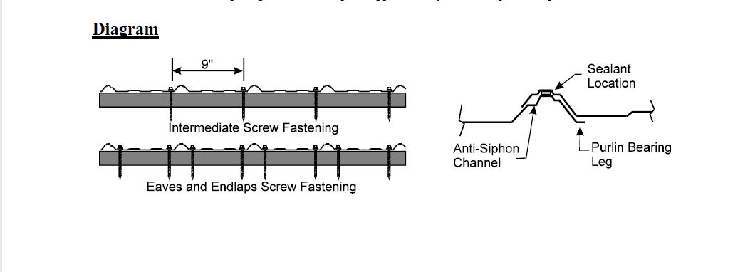

This is the one D2Cat's post from Metal sales.
This is the one I posted from Fabral.
2 seperate companies and both have them on the flats.
One small difference is Fabral recommends butyl sealant on the seam sheet where Metal sales suggests a stitch screw, that does not go through the roof sheeting.

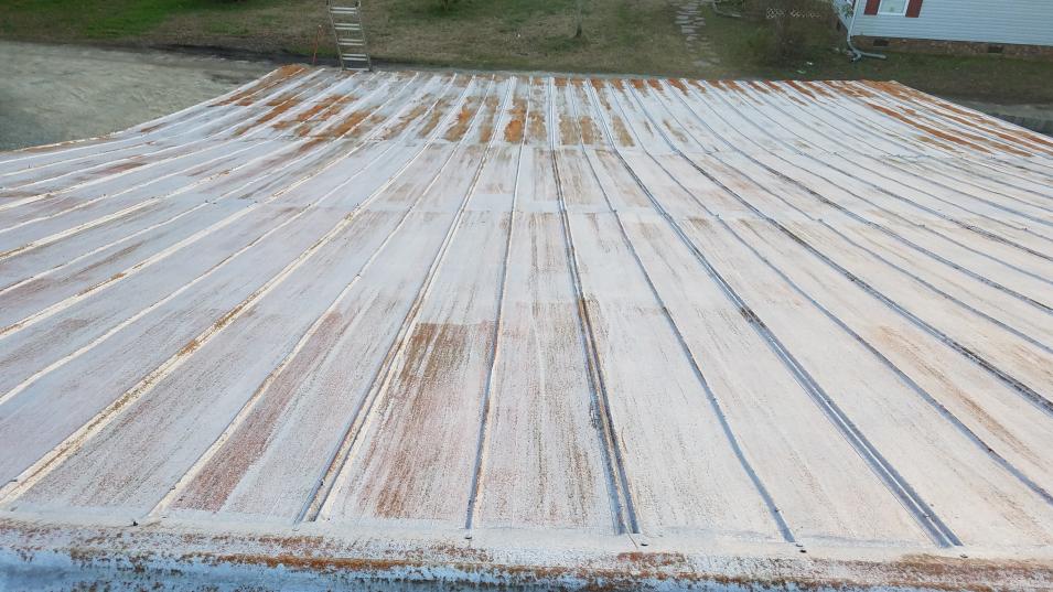

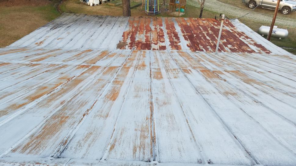

The tin when it was installed back when 70's maybe or earlier. Only 48 and remember the barn when I was a boy. The v was dented and a roofing nail with a rubber washer on it was used. Over time they have worked loose. I ahve replaced them with screws that have rubber washers on them. They have done well and no leaks where they have been installed.
So does anyone have some suggestions of type of coating to use:)
Here are couple pics of the barn from the roof.
