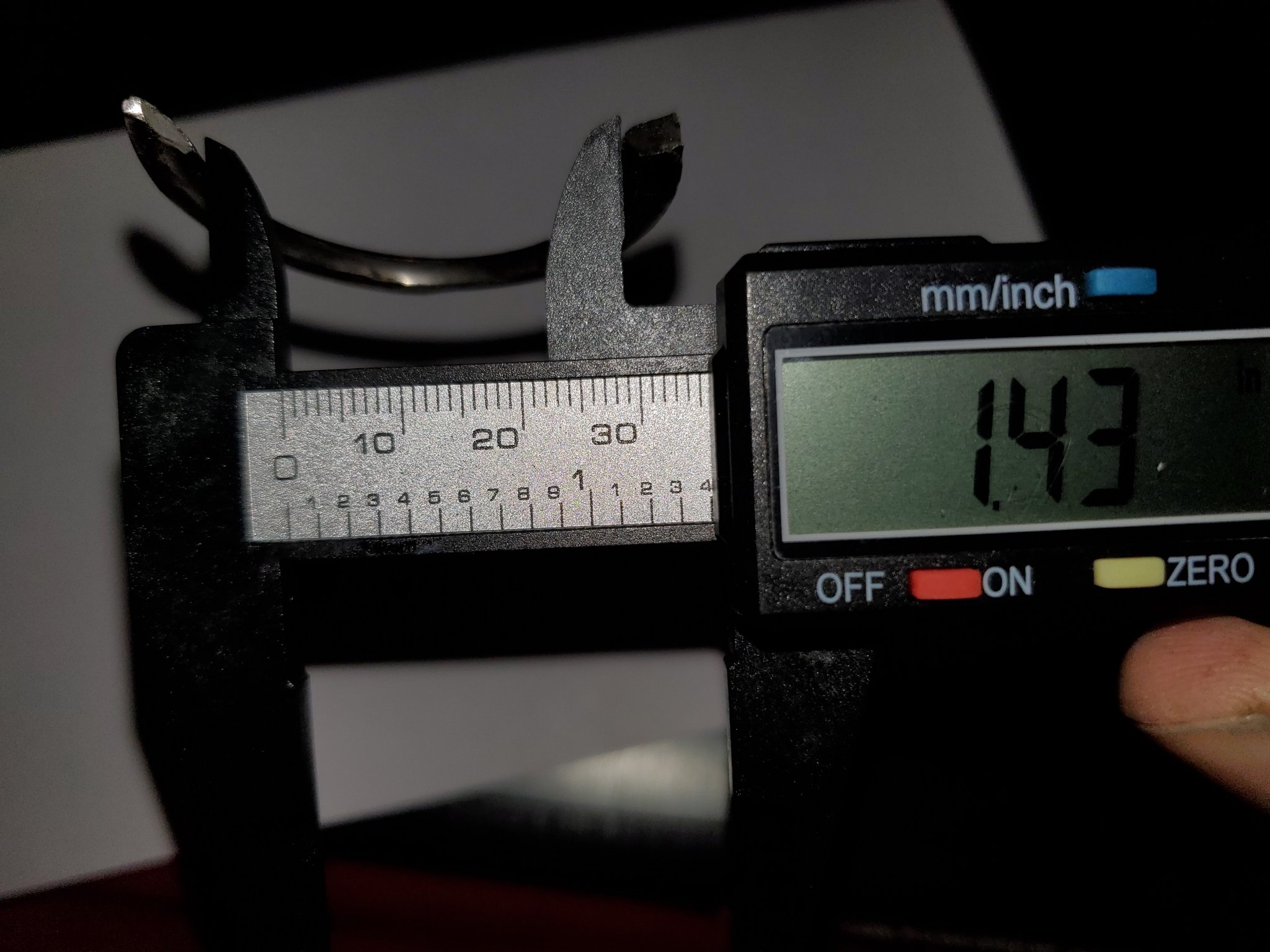

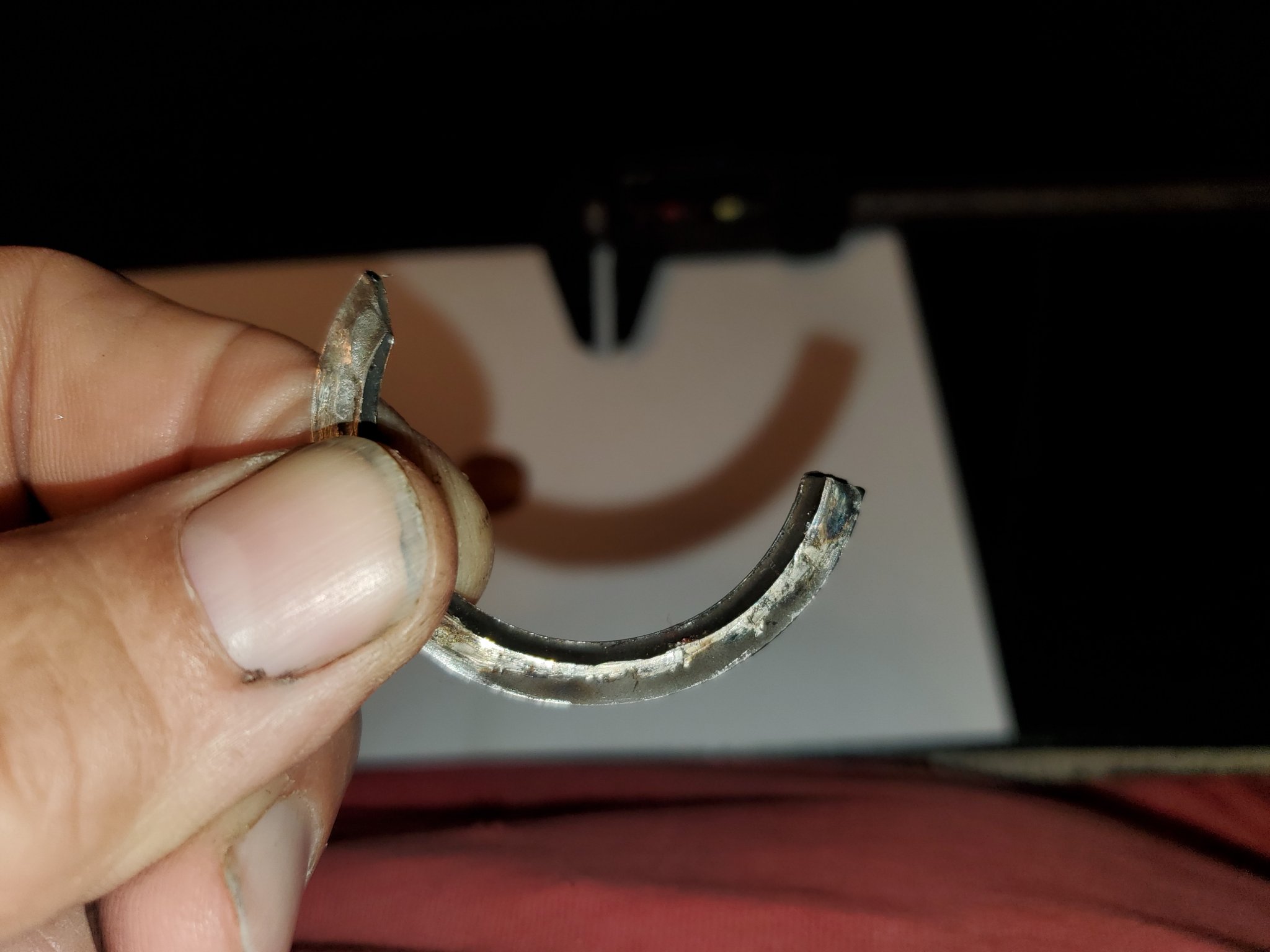

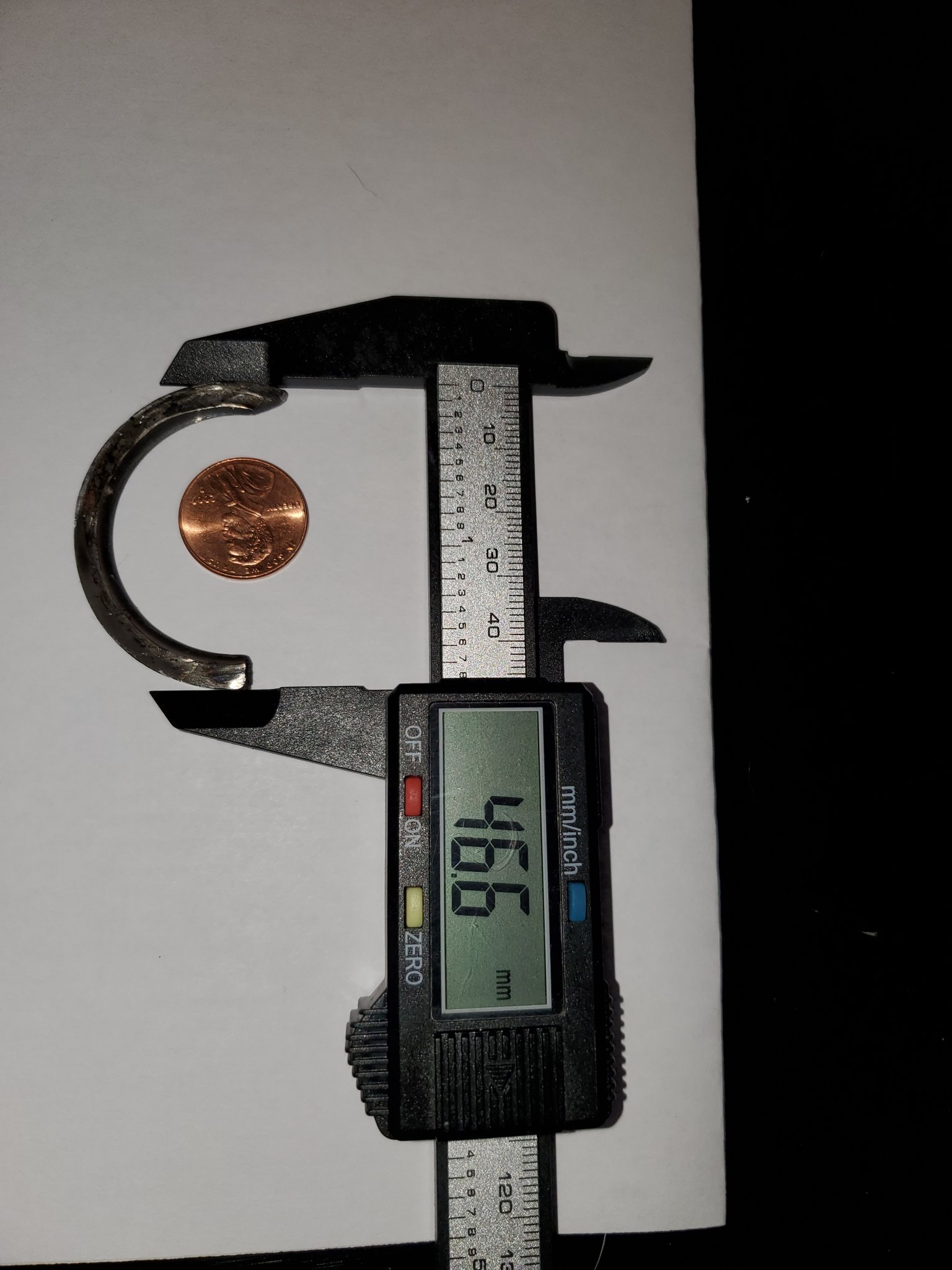

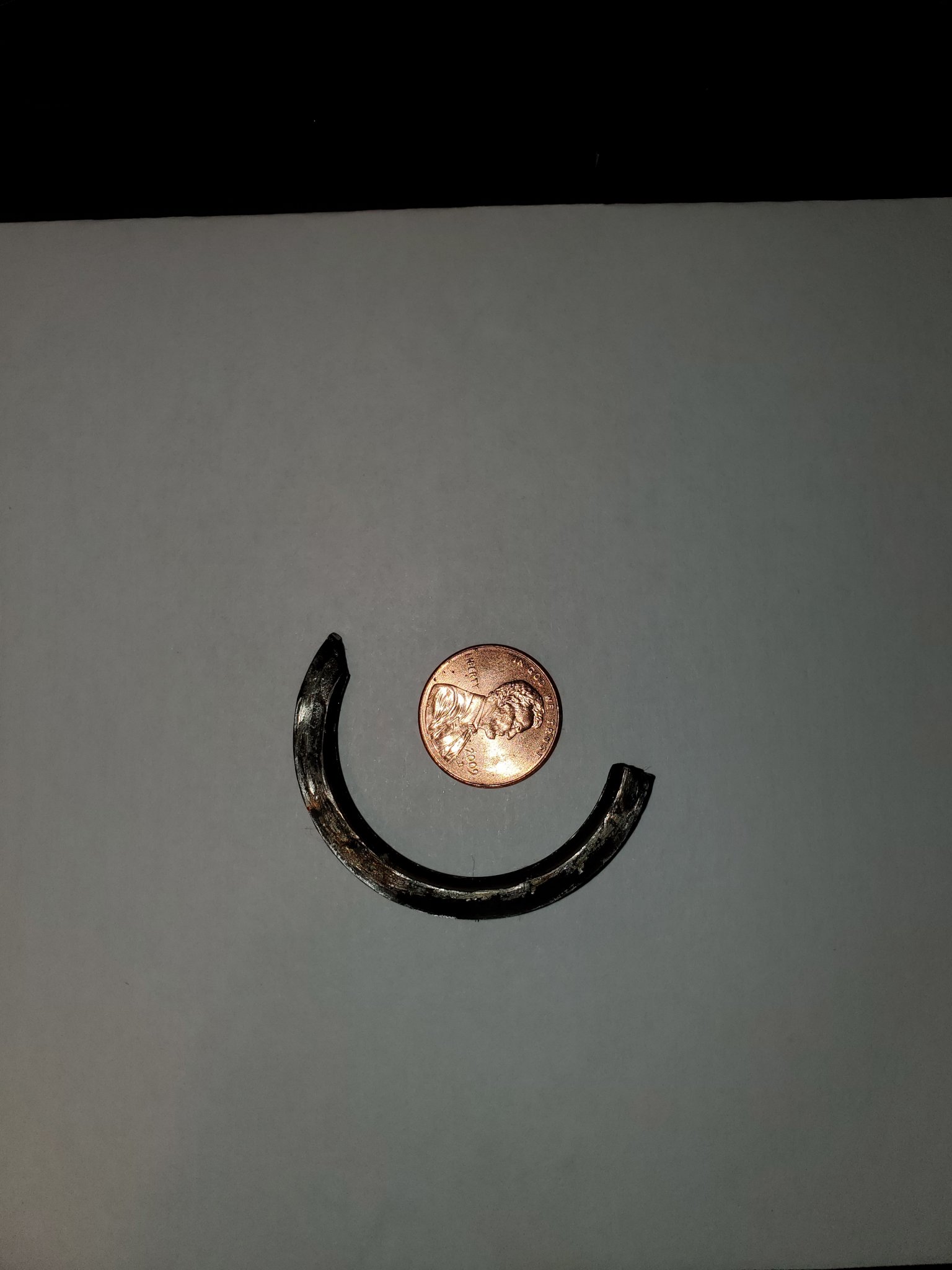

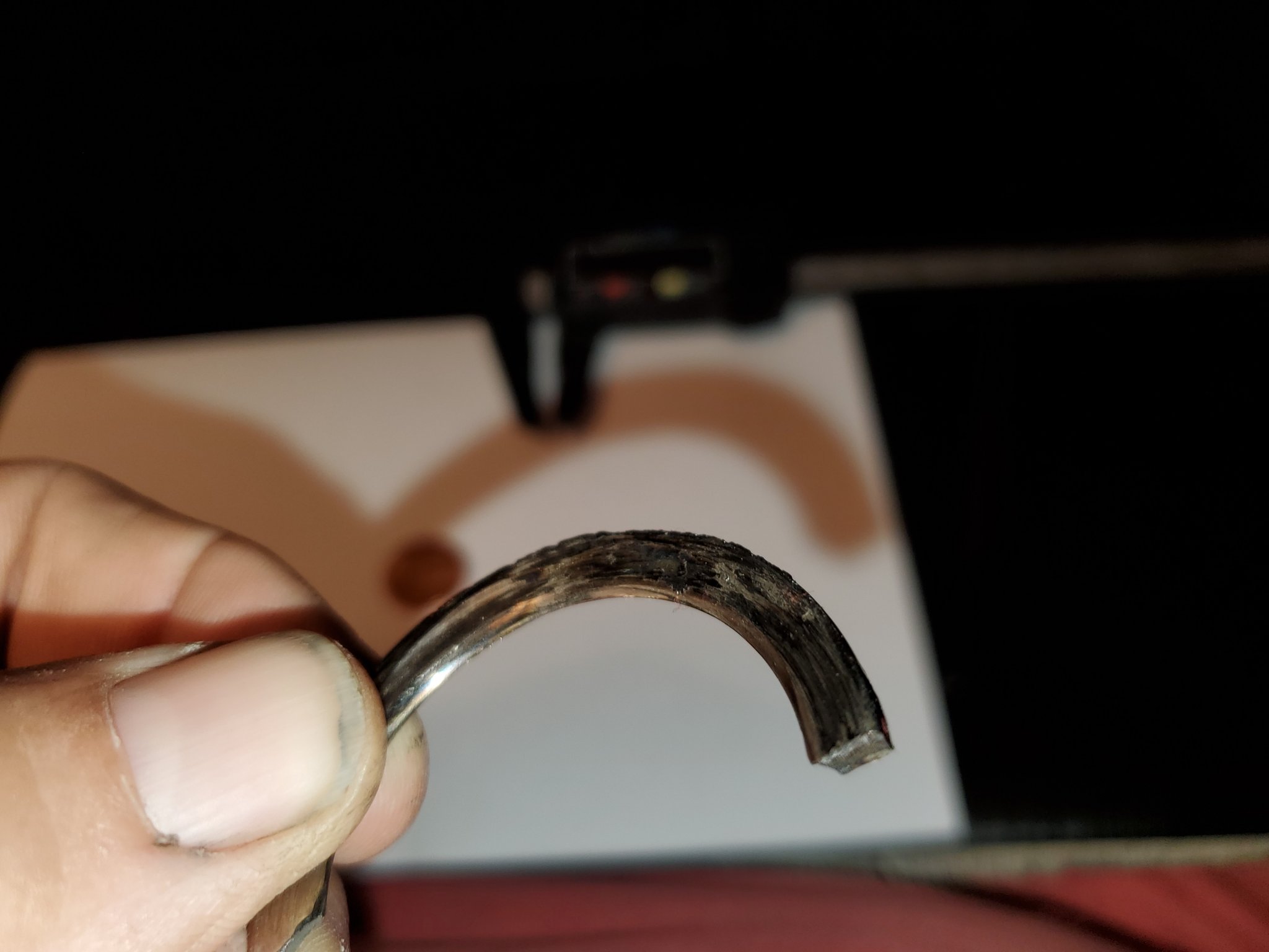

Which compartment did the broken ring come from? The transmission/range section, the differential where the ring gear resides or the axle case where the pinion and bull gear are? I doubt all the pieces of broken ring would migrate from one compartment to another.
I also doubt that item #030 in the brake parts diagram is the source, as that is a circlip or snap ring.
I also do not see damage that could be attributed to lubricant, even though I agree that "303" oils are an obsolete spec and is not a wise choice to run in modern equipment. It does appear that someone has replaced the differential locking collar due to repeated improper engagement. They did not replace the shift fork or the differential case of which both really need to be replaced
You are correct, diff compartment sump, and no it couldn't have migrated from fwd compartment.

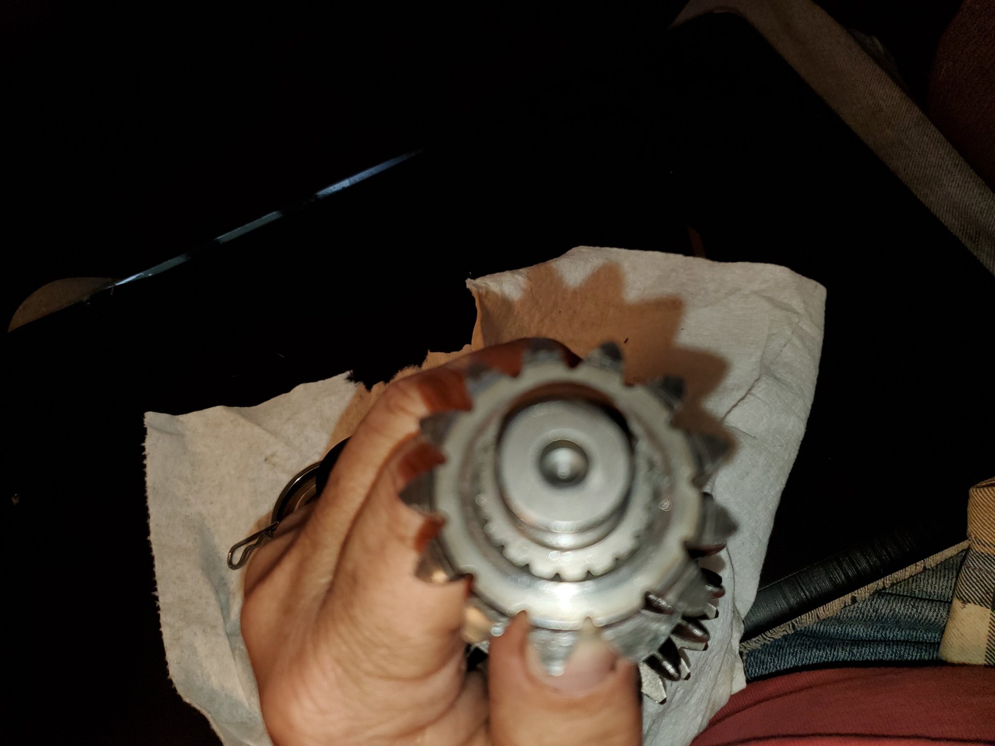

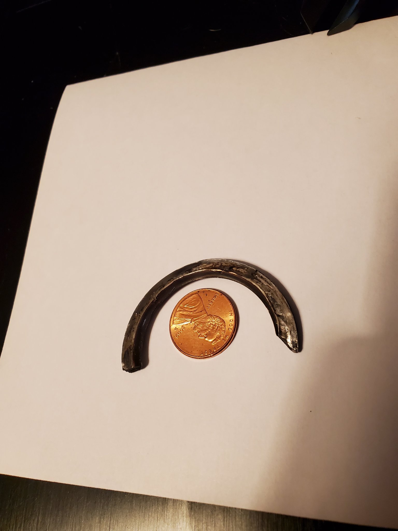

Some additional info and pictures:
The "spacer", part is sized as shown in the pictures. It is deformed and not symmetrical anymore, it shows wear on all surfaces, it also has the look of a washer that was over tightened and is starting to "pull-in" or is tapered from the id to the od. All pieces were recovered! The thickness is also different across the part, there are sharp edges also. Still have no idea where it's from! Measurements are as it is now, it is not accurate for a new part, just for reference. I will clean my nails later! lol

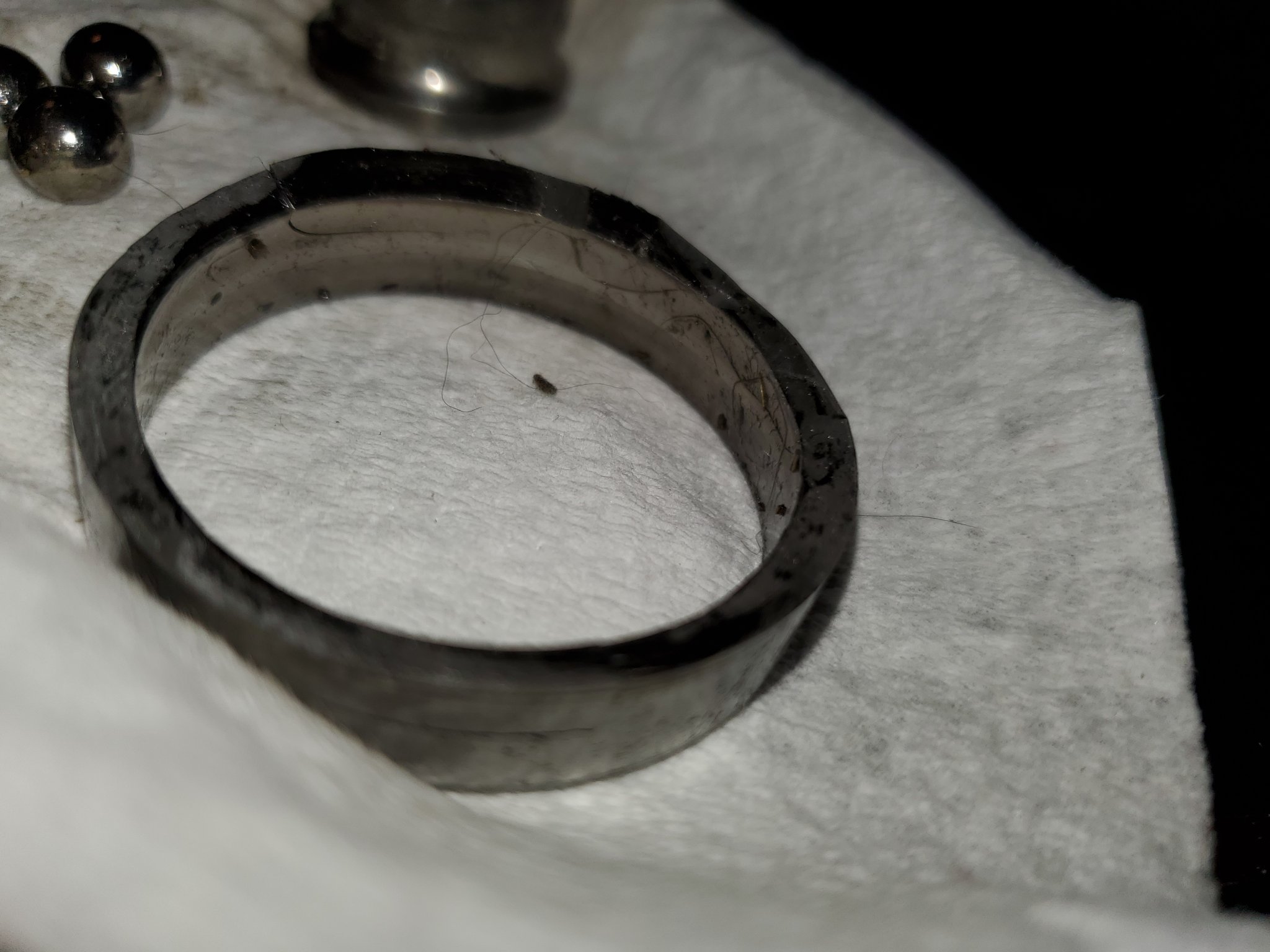

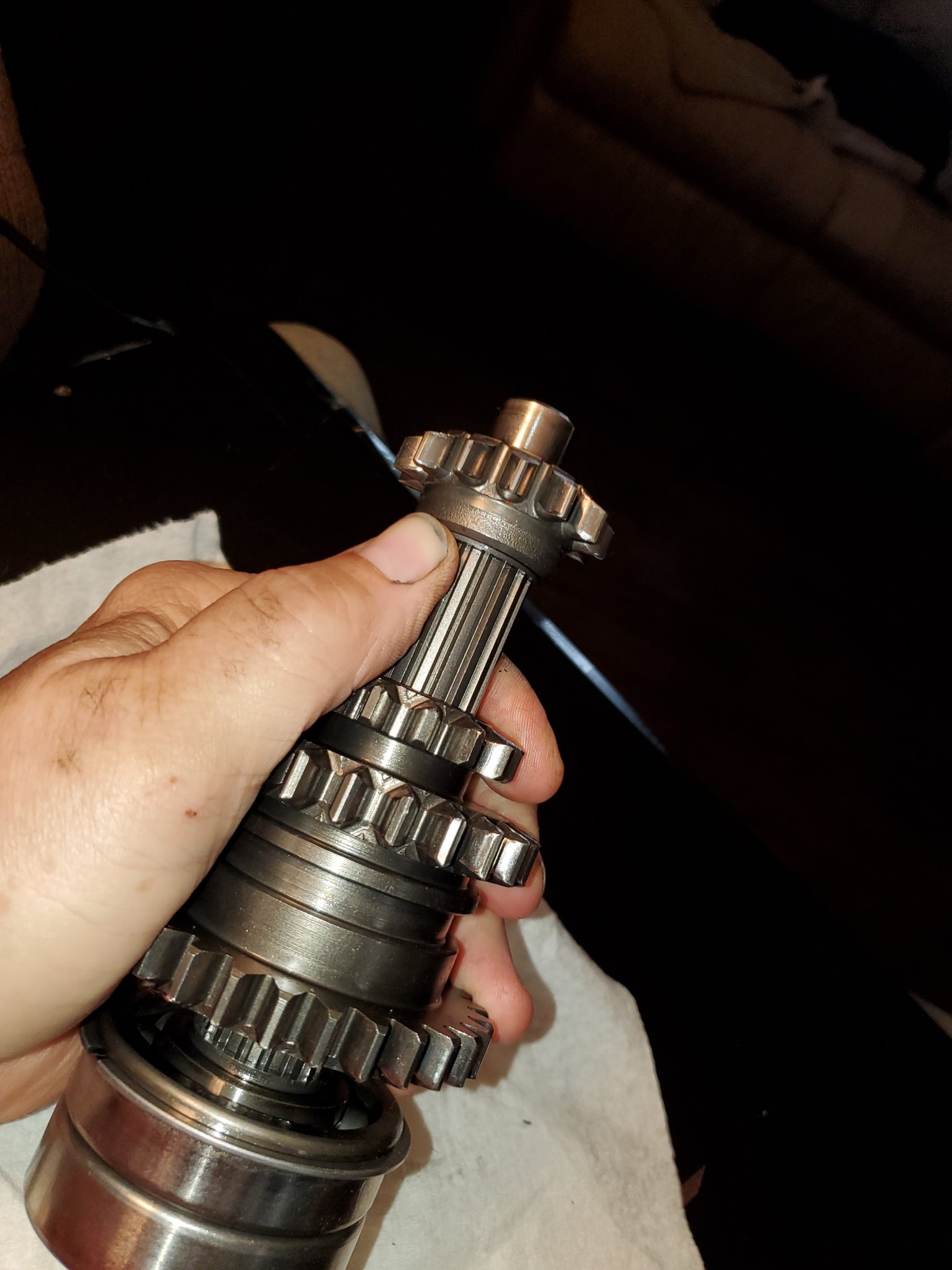

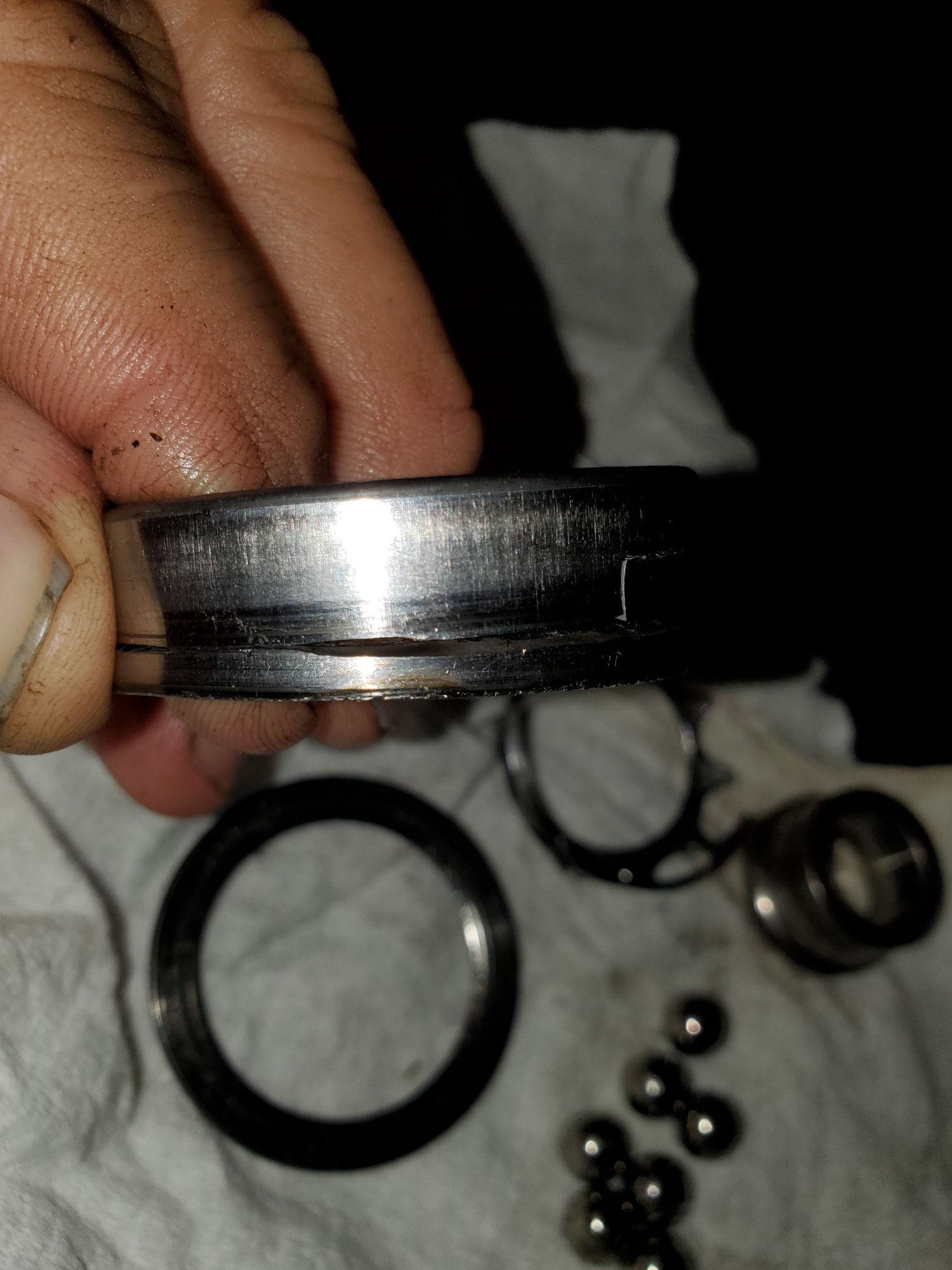

Mystery solved, the "Why!" not so much. If you stare at something long enough, something not right will show itself!
I was inspecting the Transmission case and components after letting it drain overnight. When I noticed a bearing that just didn't look right. low and behold, it was my problem. And the pieces had indeed made their way to the Diff housing somehow? How I will never know!
So I removed the shaft and the rest of the parts came out, the bearing fractured around the circumference of the outer ring. I've seen the guts come out of bearings but never the out ring crack. $25.00 bearing.

Glad to figured it out. Odd to see a bearing fail in this manner without a major shock load of some sort. I would inspect everything very closely. And double check all tolerances and side play.
34,110
9,298
Read the original story (bottom of page #1) and you'll see how bad of a Shock that poor tractor got.

So... is the assignable cause for the most recent failure a component that was compromised during the wreck or the use of unapproved fluid?
I don't think anybody could answer that question definitively from some pictures on the internet.
Poor lubrication could lead to excessive wear of transmission components. As parts wear, clearances increase and I have seen transmissions where excessive clearances allowed gears to bind or even be forced apart, breaking clips and castings, under load. I have also seen worn bearings bind, jam and come apart under load. So it is my personal opinion that it is possible that poor lubrication was a contributory factor.
A conceivable scenario is that sloppy transmission bits rattled around but in general alignment until subjected to an unusually higher force -- such as pushing the tree over -- that finally popped the clip out of place allowing further binding. The subsequent drive home, with repeated stalling and shifting of gears to get it moving again, caused further damage. Or maybe the bearing jammed and broke first, pushing the clip out of place. Who knows? I certainly can't tell from here.
All that said, I would think that wear caused by poor lubrication would first manifest itself in the HST pump and motor. They are built to very close tolerances and wear there should result in low HST pressure. In other words, I would have thought you would have problems driving to the tree in the first place, not just driving home after pushing it over.
