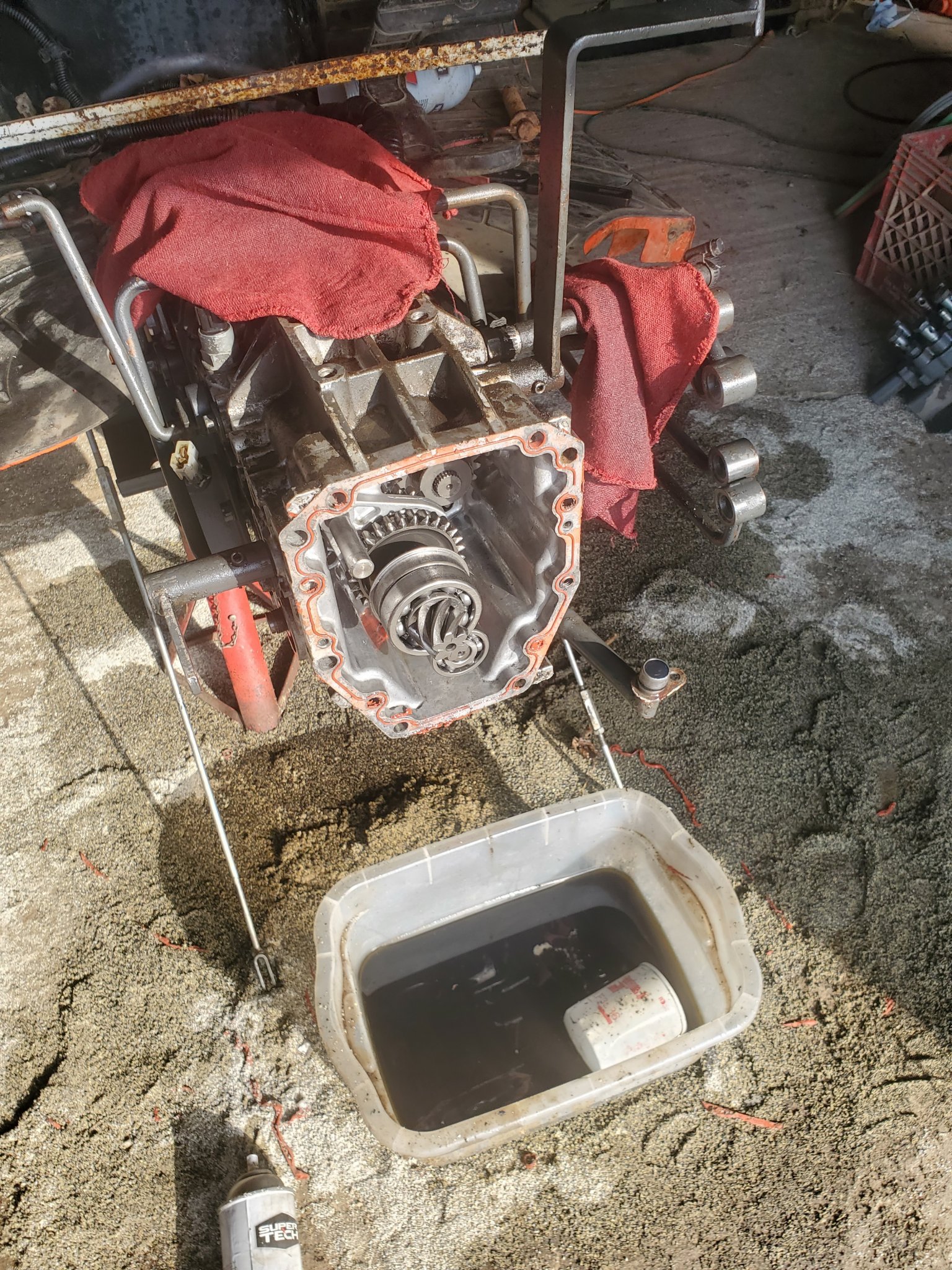

Well, Tractor is torn down for the 7th time.
I know it now without even labeling anything, not a good thing.

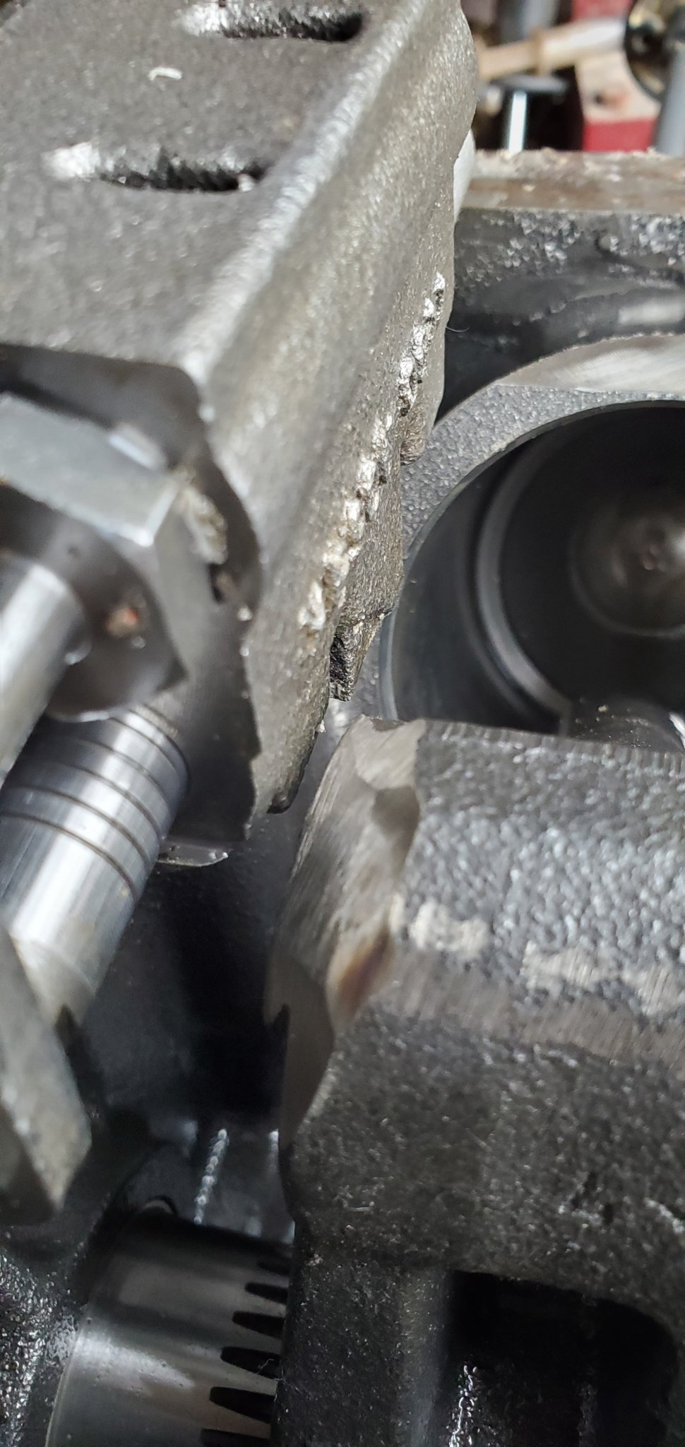

So far I've found a couple of issues! As I said from the beginning, I knew why my 3pt wouldn't raise anymore. The control valve casting was fractured at the mounting point. This prevented any pressure from going to the piston that raises the link arms. I have the replacement part and seals for that.

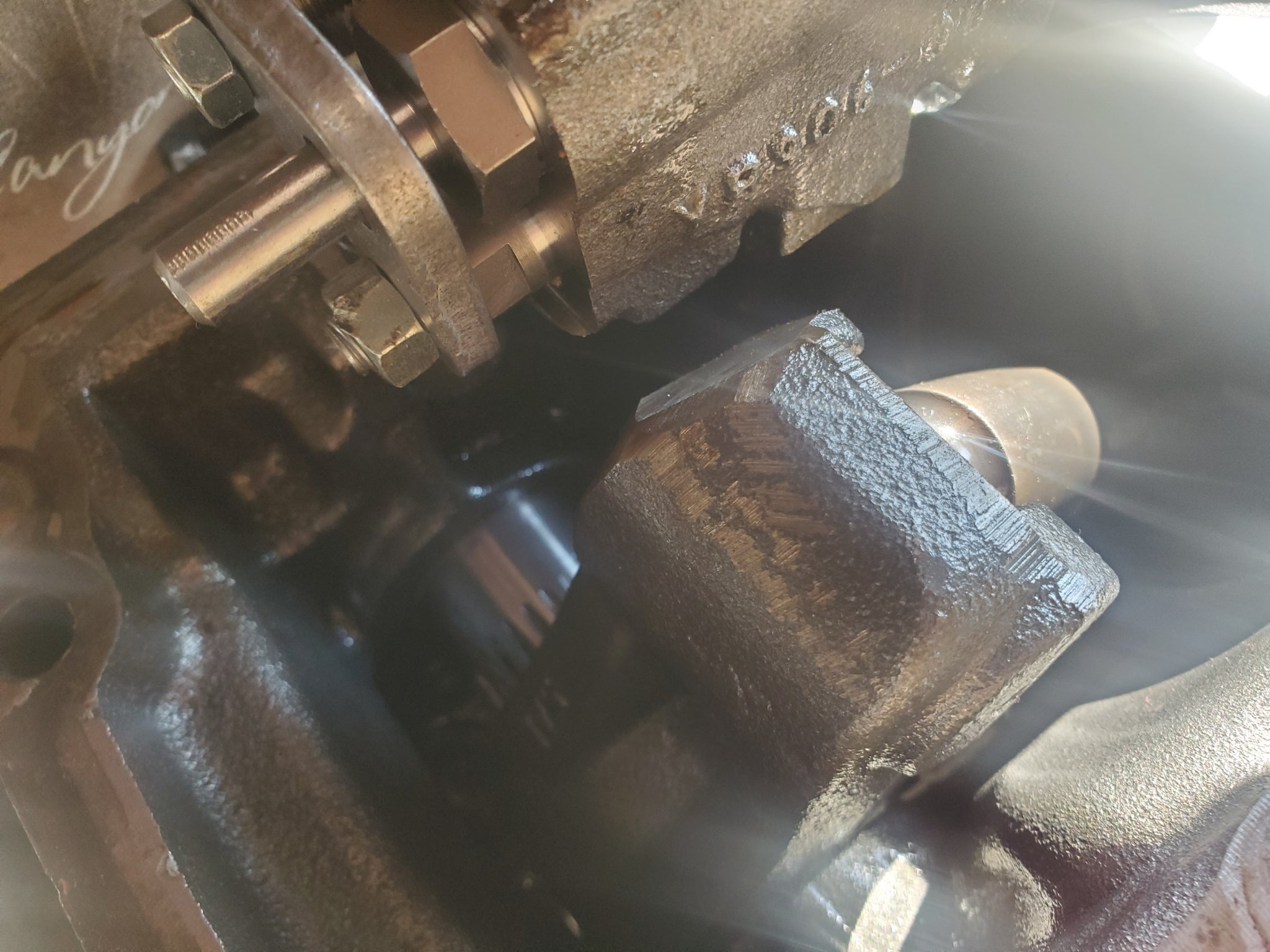

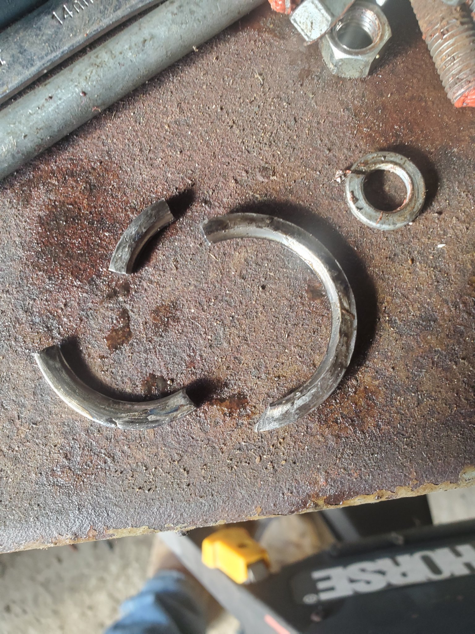

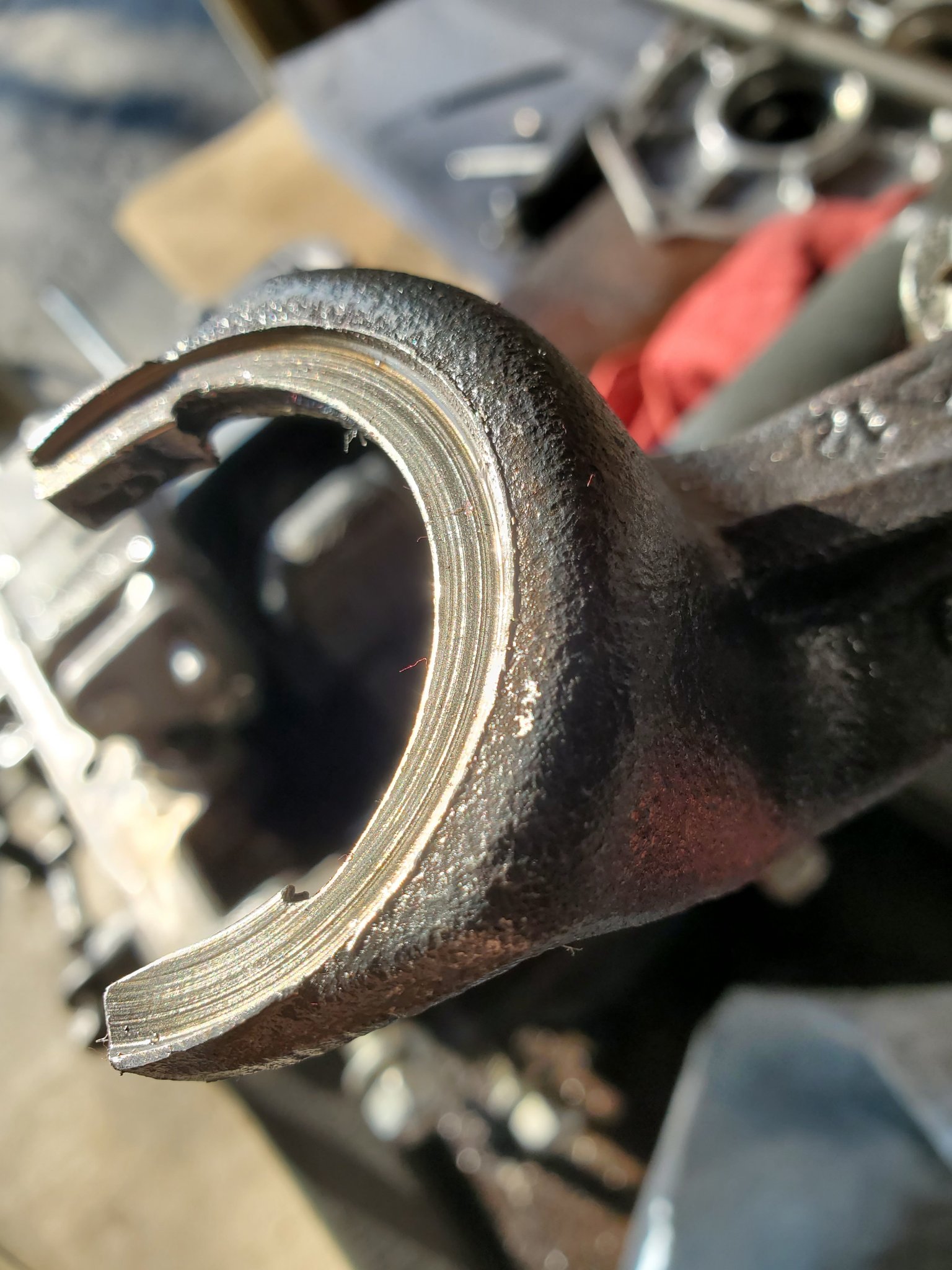

I found two problems in the rear transmission case, metal particles and a broken ring on the bottom of the case in the sump area.
The particles are from the yoke that engages the rear diff, it is worn for some reason, the lugs on the inboard side are also worn. The yoke is cast metal. Assuming the return spring was not strong enough to disengage rear diff so it was worn instead of kicking out, it stayed engaged. Will investigate further.

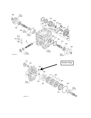

The ring has me puzzled, I'm actually puzzled, I don't know where it came from. Impossible for it to travel from the middle or forward case. Pass-through holes are too small. It had to come from the rear axle, left or right, possibly the differential. I will call Messicks to get the dimensions of the part I believe it is.
What I need to do is just go out and tear it apart some more to see if the part I believe is broken is there or not lol. Basketball is keeping me tied up. Lol.
The brake assy hides the location of the piece I believe is broken. Item 30 is the broken part I believe. No 30is the broken part. No idea why it broke, tied to wear on the diff yoke I'm sure.

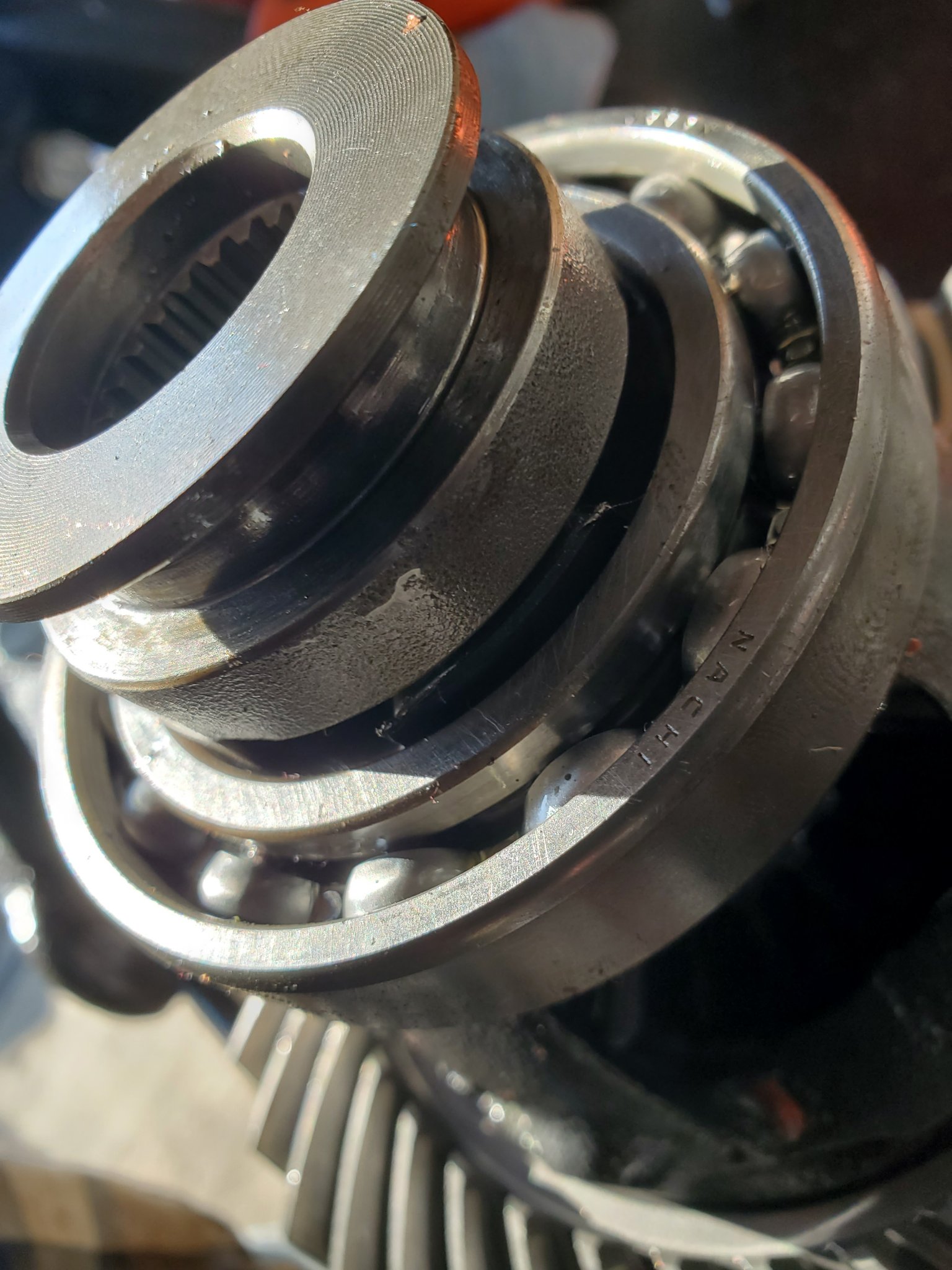

Took some time to try to find where the broken ring came from. No luck, I just can't find a part that's missing.
Here are some additional pictures that show some of the wear inside. Rear Diff shows some wear for sure.

Check the timing on the lift arms on the rock shaft to make user it's not lifting too high thus causing the piston arm to hit the valve.
It actually travels past the valve and did strike the valve. That was the 3pt issue. I solved it by grinding relief on the knuckle of the arm. Very beefy area, won't compromise strength.
I can't explain why it hit the valve but it did! Not once, but 4 times. I figured it out too late and it has cost me both time and money.
The clearance between the valve and the are is slight at best. After I discovered that was the problem you can see I chose to grind the piston rod to allow ample clearance now. I have a new valve installed, there were and are no shims on the shaft that the upper lift arms are mounted on. There is very little side-to-side play in them. Both that are struck the valve every time and broke it but lifted it off the mounts.
Someone at the dealer accused me of running it with the lift arms not installed which would allow it to shift sideways and contact the valve. That never happened, it always broke when the tractor was in full use!
Anyways, in the picture you can see the relief I ground to prevent it from happening again. Now to solve the Diff wear and play the fluid was the issue, I will get it back together and replace the fluid again. With the entire trans disassembled I can jack the tractor up and just let it flow out!

Which compartment did the broken ring come from? The transmission/range section, the differential where the ring gear resides or the axle case where the pinion and bull gear are? I doubt all the pieces of broken ring would migrate from one compartment to another.
I also doubt that item #030 in the brake parts diagram is the source, as that is a circlip or snap ring.
I also do not see damage that could be attributed to lubricant, even though I agree that "303" oils are an obsolete spec and is not a wise choice to run in modern equipment. It does appear that someone has replaced the differential locking collar due to repeated improper engagement. They did not replace the shift fork or the differential case of which both really need to be replaced
