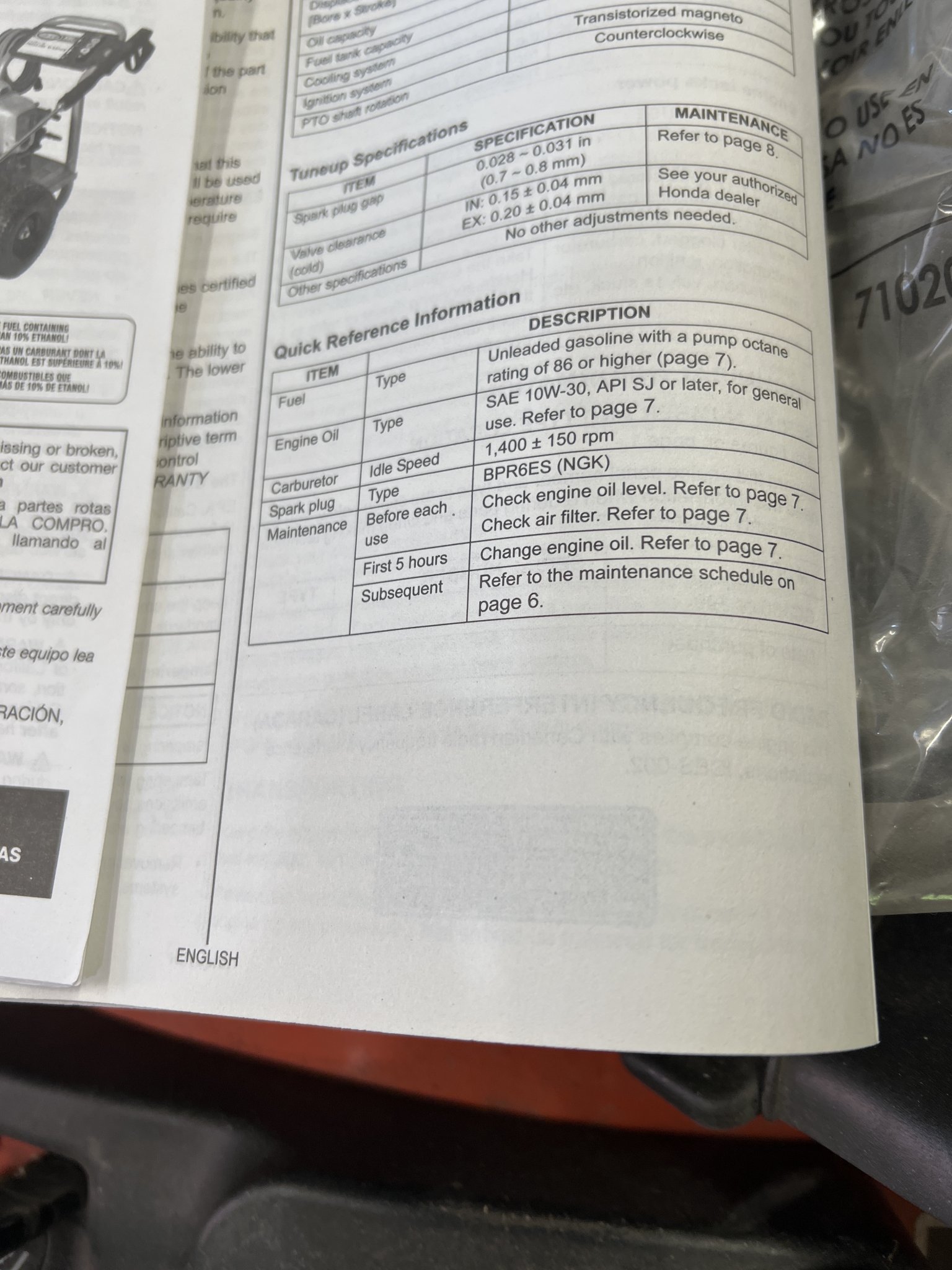

I will agree it’s not a serviceable pump. I have a Honda powered washer with a serviceable pump, it calls for 15-40 and every 100 hrs for the pump. The engine calls for 5-30 (if I remember correctly). I use rotella 5-40 in all the small engines around here (even the kubota 🤫)
the oil you pictured is for a serviceable Simpson pump and not for the Honda engine

Call me an idiot….RTFM they say…..😳 🤓
I have the gift of literacy, I should use it. 🤓
Gosh I feel foolish….yep,been using PUMP crankcase oil, not motor oil. DUH. I know better…..or should know better.
Just 10w-30….. glad it doesn’t have a lot of hours on it..
Also glad I asked the question….🤓
Thanks again!

It has MOTOR OIL in it now!!! 😉
