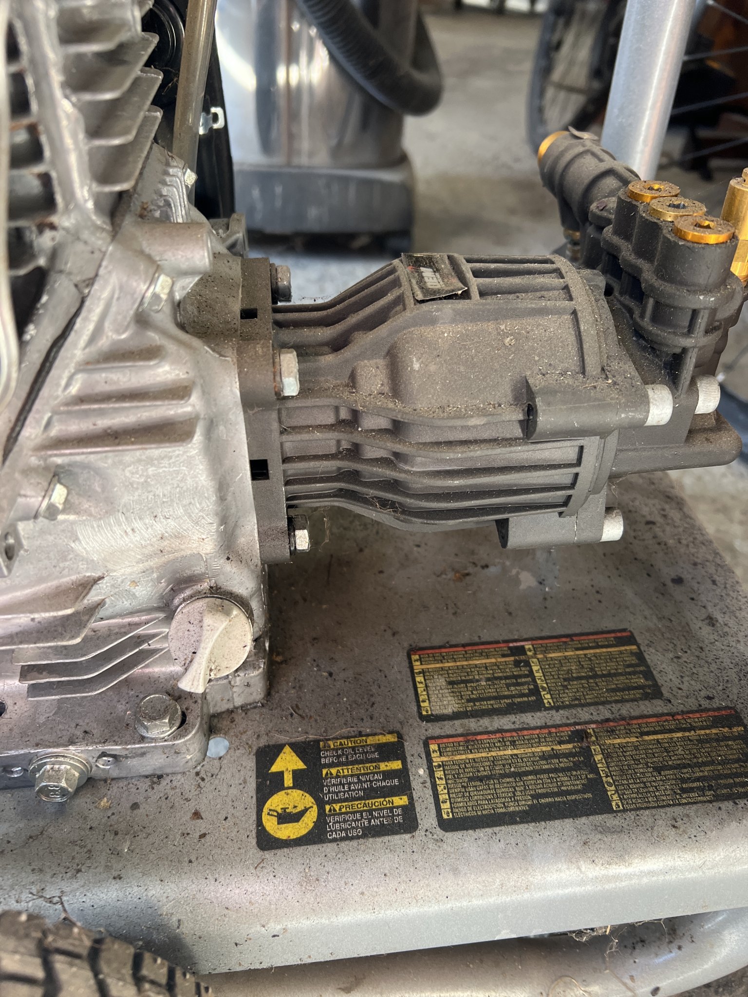

Have a Simpson Pressure Washer with Honda GC 190 engine.
I’ve used the Simpson oil a few times, but the stuff is ridiculous in price. $17 for a pint.
Today saw it’s 15w-40 at TSC.
I started to look for an equivalent a couple years ago, but didn’t know/realize it’s 15w-40.
I’m thinking just plain old diesel-rated 15w-40 should work? I’d probably use a synthetic; just my preference.

So the crankcase oil from the Honda, also lubes the pressure pump? Or am I missing something?

I dont think so. Crankcase refers to the pump crankcase not the engine crankcase. Where do you add it?

Tom - far as I know. No oil fill or drain on the pump itself.
Dan - just one drain and one fill on this machine.
Honestly, I didn’t put a lot of time into the Owners Manual….😀 I have operated a lot of stuff for 50 years, figured I’d be okay…

Looks to be a non serviceable pump. Or you could pull pump apart with those Allen bolts dump out the old and put in new. Will be a heavy spring in there, nothing will fly, just might need a clamp to go back together.

OK, so you need the ISO # and type of oil, i.e regular non-detergent dino or syn for that pump and go with it. I wouldn't switch from dino to syn or vice a versa, due to seals in the pump may not like the new oil.

Might be time to read the manual. In my experience pumps simply bolt to the outside of the engine and have a separate drain and fill. Pump drain at 8:00 in the video.

When I saw the 15w-40 tag today, I wondered if a similar motor oil would work. When you talk ISO, I’m thinking that’s a hydraulic fluid?
Again, this is labeled a “pump crankcase” oil….

I downloaded a couple Simpson manuals.Based on them the oil you pictured is a non-detergent pump oil. It is not an engine oil.
For gasoline engine pressure washers most times you get a pressure washer manual specific to the pump/washer components and a separate engine manual specific to the engine make and model.
Its entirely possible there is no way to change the pump oil on your machine.

I wondered about the type of oil, but it does sound like I can’t swap it for a motor oil.
The 15w-40 tag at TSC today piqued my interest, but it is what it is. I’m okay with using an OEM product when needed.

When I tore a freebie Karcher gas version apart, I just used 'air compressor' oil to refill the pump. That was 3 years ago, probably 200 hrs on the thing since then.

That Honda engine is bullet proof. Take good care of it and it will take good care of you. I have owned the Honda 390 engine with a Cat pump for over 25 years (same setup). Still runs like Forrest Gump.
Here is a good library of manuals. Free for a few validation clicks.
To your question; 15W-40 is fine as a substitute. Page 17 of the manual.
No synthetic.
