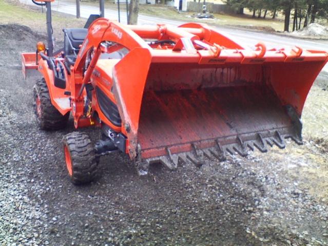

I used my Piranha toothbar yesterday to break up some thin concrete spread on a buddys driveway that wants to make an apron into his new shed. The teeth are large and tough, stand the teeth straight up and wiggle the bucket a bit and it will vibrate a nice straight path.

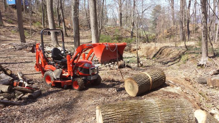

Here is the toothbar helping me get some large poplar out of a creek bed. If nothing else, the extra length of the teeth sticking out are a huge plus when trying to scoop a large branch..etc...

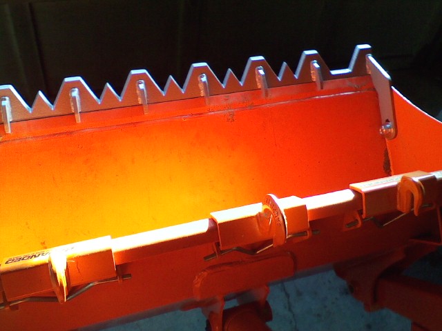

I dont have a picture to show you, but the 1/2 thick plate steel slides under the bucket (by about an 1 or so) and the edge of the bucket is locked into the vertical runners. So the tooth bar is under the bucket too. Back dragging is even better, there is that 1/2 lip to grab rocks or whatever. It is well worth the price and shipping. It not only adds strength to the cutting edge, it multiplies the cutting edge 10 fold, plus it allows you about another 3, 4 inches of "scoop":D

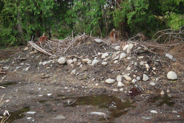

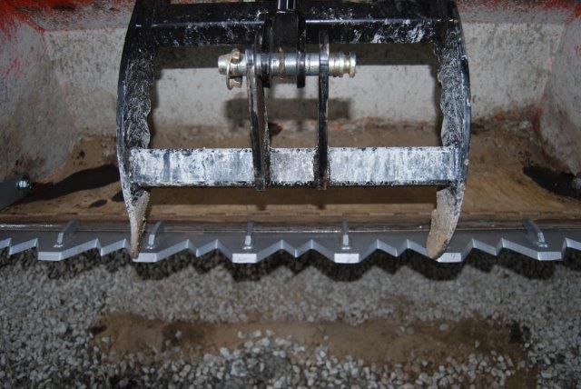

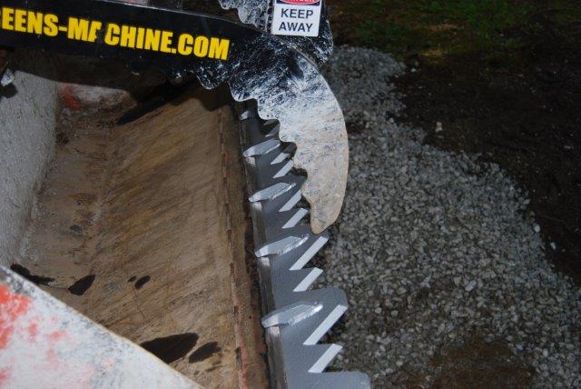

I put mine on a week ago and have used it for rocks, dirt and black berries. It is doing everything I wanted and more. It makes my "Thumb", which is outstanding, even better. I have had the "Thumb" for about a year and wish I had added the toothbar at the same time. The pictures show only two of many piles I am working on.
