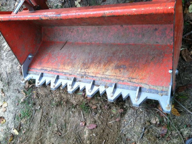

I've got a 60" bucket on my B3200, so it's the same as your's on the B3030.
It works great ripping out small trees and brush. I burned a big brush pile last month and the toothbar came in handy pushing the brush up on top of the fire.
Here's a photo of what the Piranha looks like on the 60" bucket.

I am getting ready to mount the Piranha toothbar I purchased last month. (Man does it look like it will do some serious "damage" to the work I've got planned) Just had my new L3800 delivered that was purchased at end of 2013. This is the first tractor I've ever owned so very excited to put it to work when early spring decides to begin...:eek: It looks like I just need a "good" 3/4" bit and keep it lubricated during drilling to get the job done. Anything advise for "fail-proof" installation of bar? Thanks OTT friends.
Use the toothbar as a template to mark the position of your holes. Drill a pilot hole first then your larger hole. If your keep a squirt bottle of oil to keep the drill lubricated the bit will live for another project.

I ordered earlier this week and got my piranha bar today for my B2320. Took about 15 minutes to get it mounted. Just followed the included instructions. Took it out and moved some dirt. I can verify everything that's been said! Really improves the capability of my tractor. Well worth the reasonable cost.

I was wondering how you back drag the dirt with the bar on. How do you get it smooth?
No. I did some back dragging this morning spreading a gravel pile. You get a ridged corderouy effect. On the other hand it only takes 3 minutes to unbolt and remove the tooth bar if you need smooth.

Back drag with the back of the bucket, not the lip or bar. Smooth as silk.

I had a chance (finally :D) to test mine out and I am very happy with my purchase. This thing makes a huge improvement when digging. I went to the back of my field (conditions were not wet or dry...somewhere in the middle) and started by digging in about 3 imches then moving forward and it peeled 3inches by 60inches for as long as I kept moving forward. I could not do this nearly as easy before this toothbar. I also had some old dirt piles that had grown over with heavy vegetation that I could hardly get my bucket to bite into due to the growth, now it eats right into those same piles no problem.
