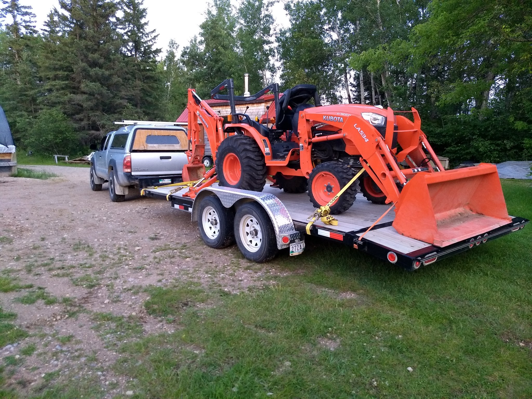

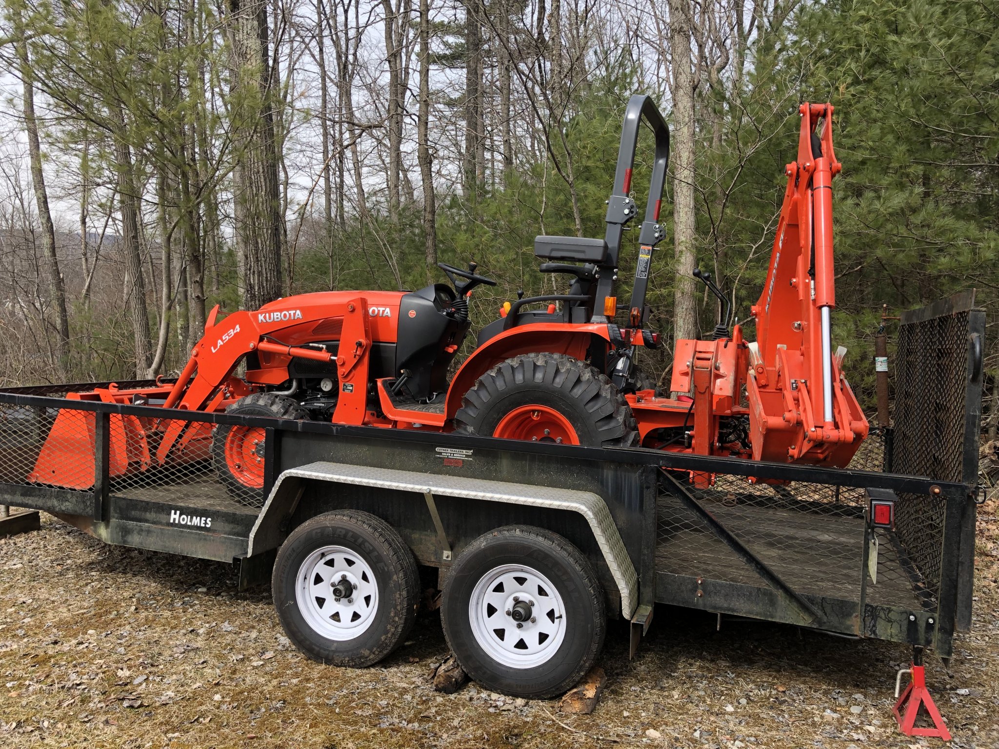

My 18' PJ car hauler carries my B2650 with loader (basically same as the LX2610) and BH77 backhoe attached with a little room to spare, even. How much does the grapple project from the front of your loader bucket?

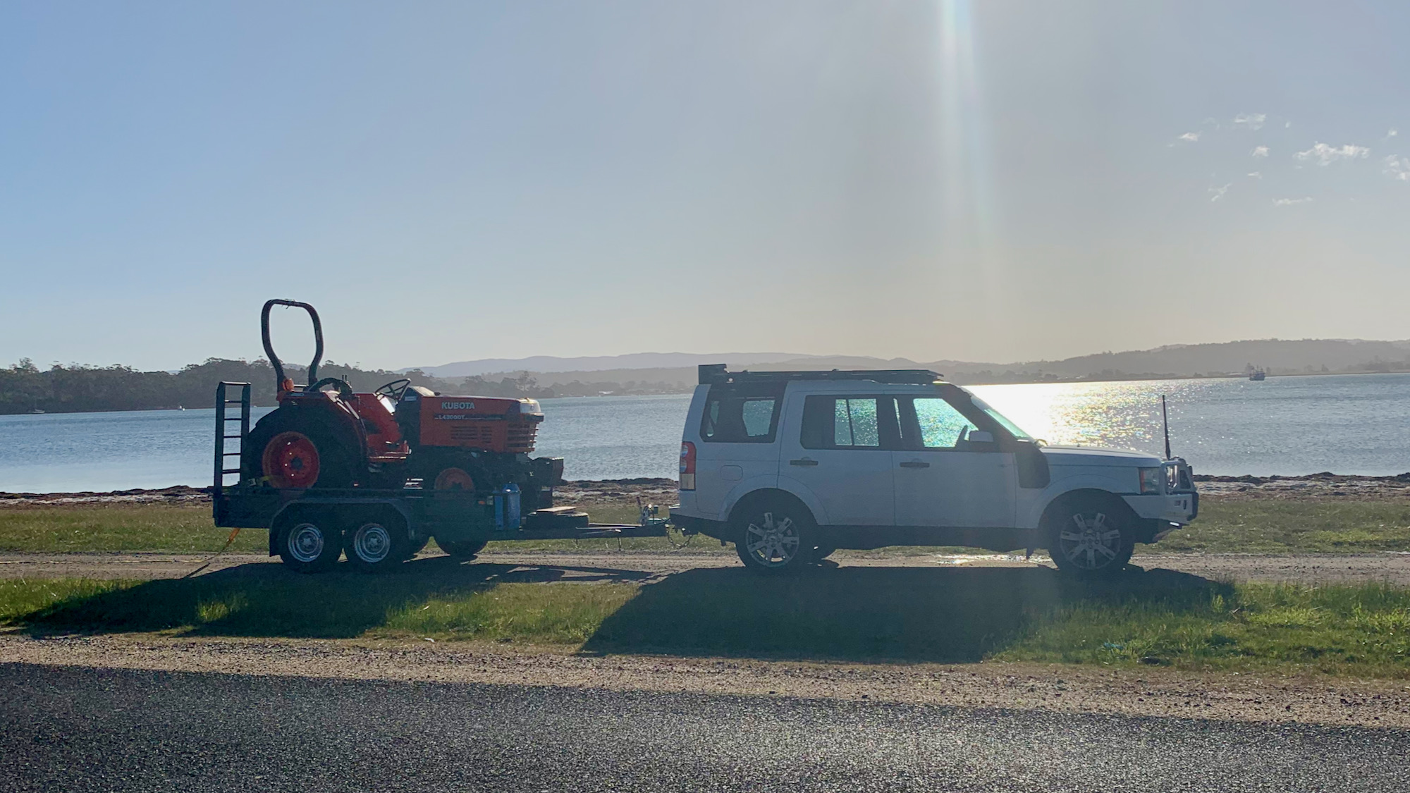

Here is my 20yo L4300DT the day I brought it home. The tractor now lives in the shed and rarely gets to ride on the trailer.

My 18' trailer has got a foot or two front-to-back wiggle room for tongue weight adjustment when any of my usual combos are attached to the tractor. Like backhoe/loader in the photo above, or box scraper/front snow blower in the winter. Now I know the sweet spot with each. The largest, the loader/M5-4 5' bush hog combo, just fits, and balances very well. But the bush hog just got a ride home and hasn't been trailered somewhere else. The other combos are regularly trailered. And adding the forks/chipper combo probably soon too.

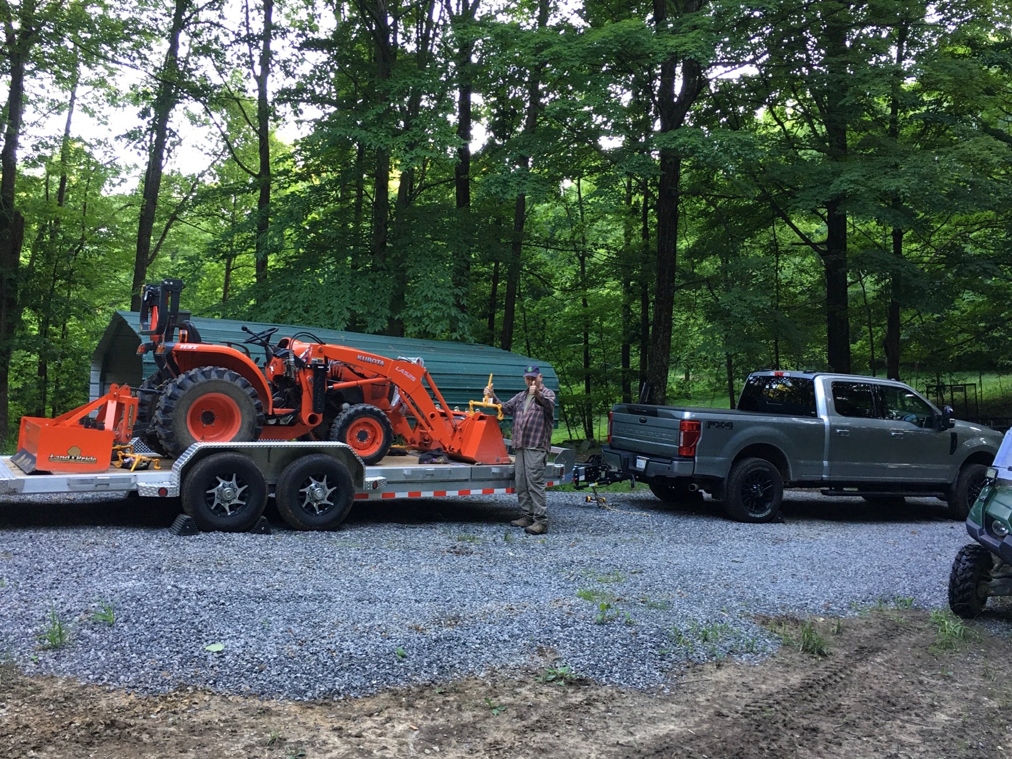

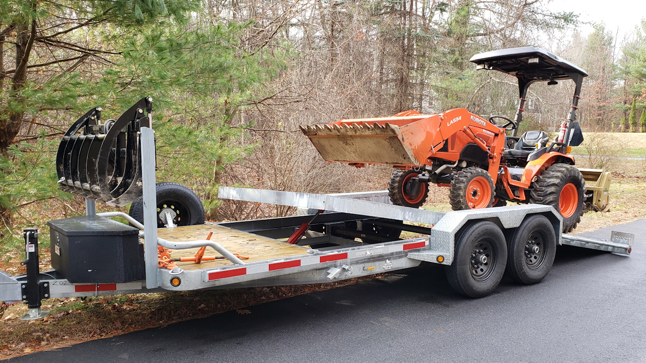

I made a mount for the grapple on the front of my trailer, I like always having it with me.
This is a 7x22' 14K. I haul my B2650 with various attachments on it. My old 20' at times would get tight.

Thats a really nice set up! I think i just bought the same trailer box.

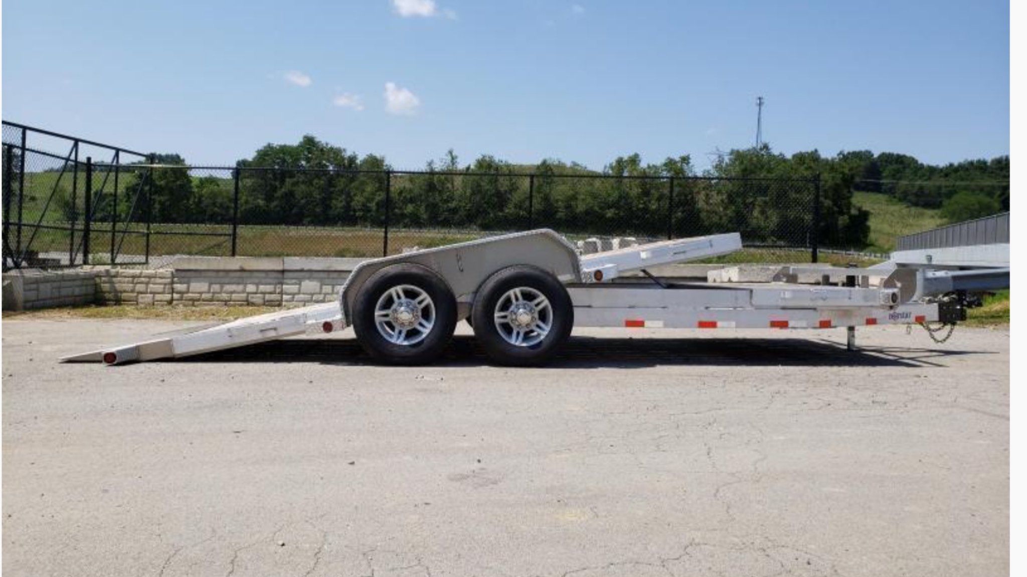

I went gravity-tilt as well, but in a 20’ 14K

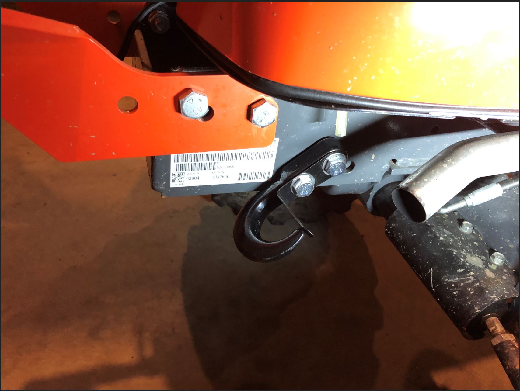

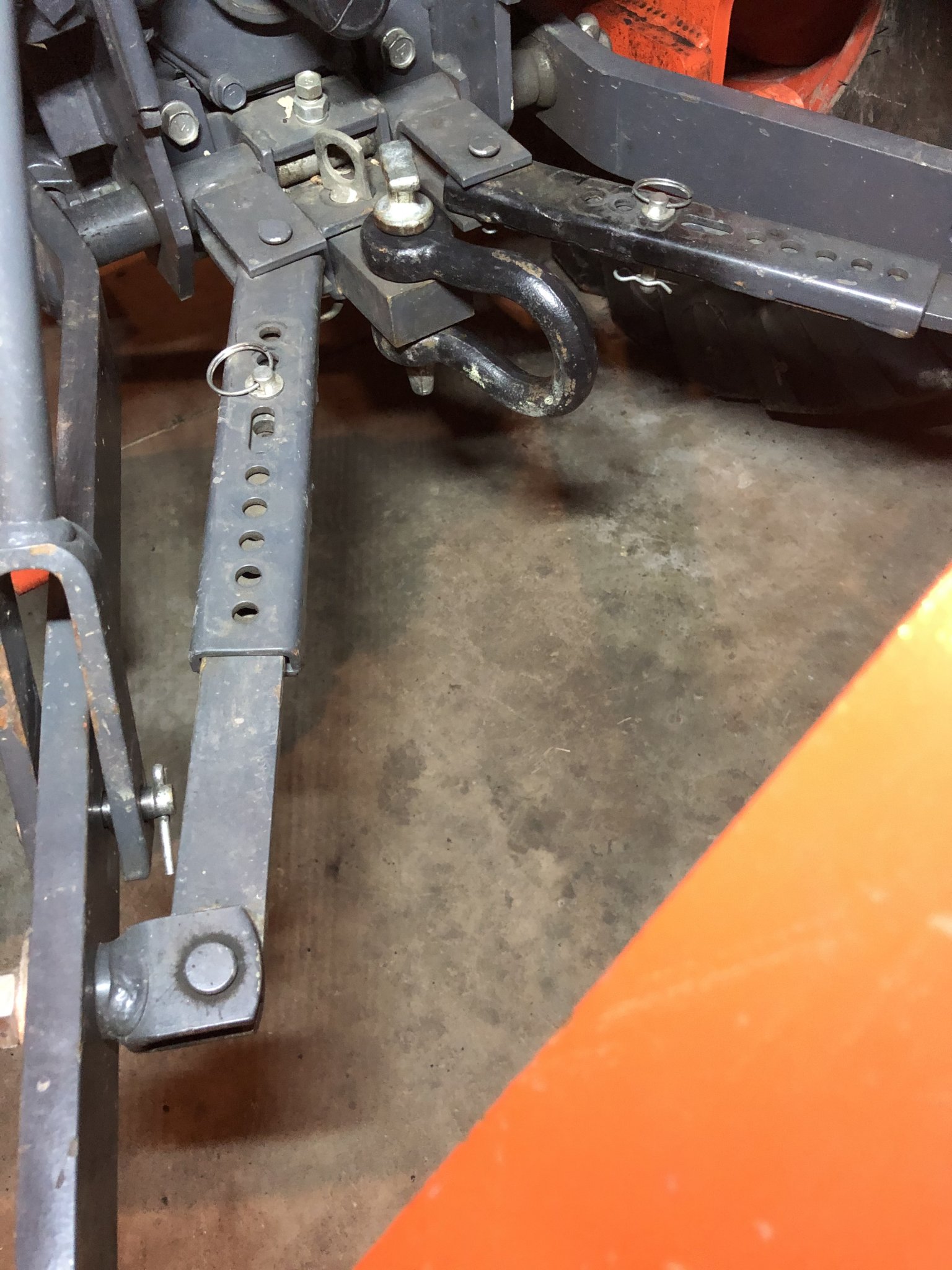

Here's what I use...
hooks (one per side) are from harbor freight (no drilling) and clevis came from TSC. The clevis works with the backhoe on as well.

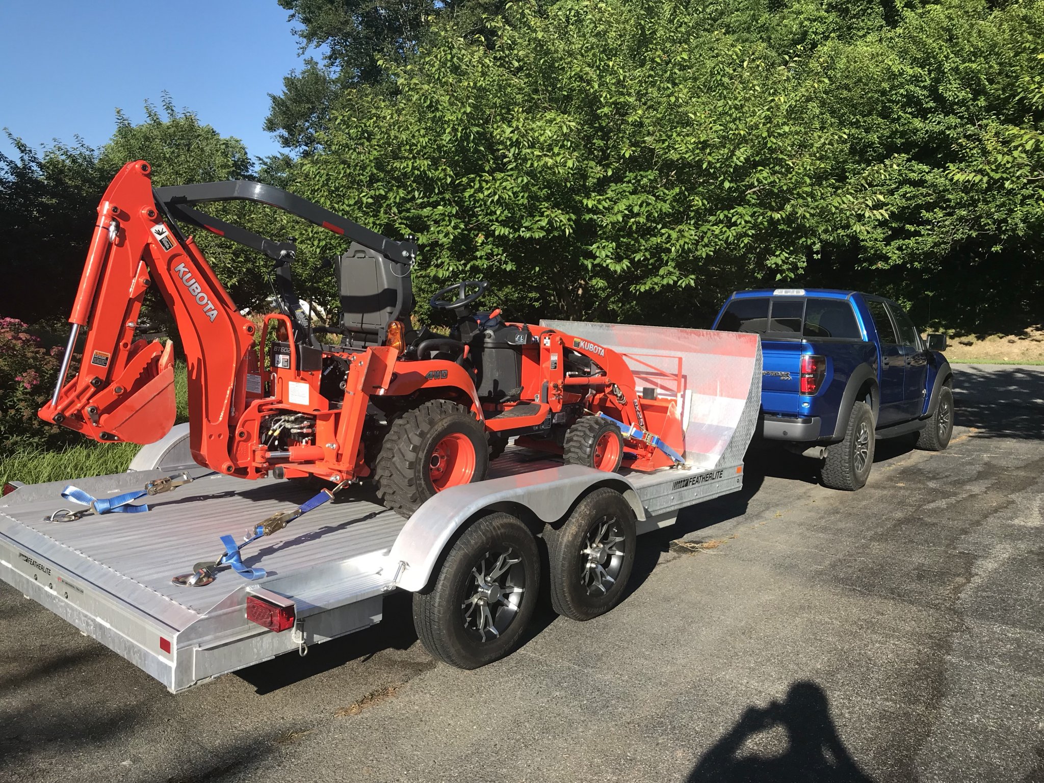

The reason I ask, I've only trailered my L48 once. Unfortunately i only took 1 picture of it. To get decent tongue weight, I needed to back it on (even with the forks strapped under the loader bucket). Then the trailer deck wasn't long enough to set down the hoe. I ended up setting the hoe on the tongue, then strapping securely. It didn't look the greatest but it towed well. FYI, the trailer has a 15'6" deck, with 2'6" beaver tail.
If a can leave the hoe up and locked, I could load it forward. It would make things easier.

I leave mine up and turned to the side (I have to, trailer is too short) and I've never been hassled. Ran that way (hoe up and locked) even when I had a landscaping business with placards on the truck. I was never stopped. I think you'll be fine...unless you really WANT another trailer. ;)
I think when stuff is hanging beyond the back of the trailer is what gets their attention.
