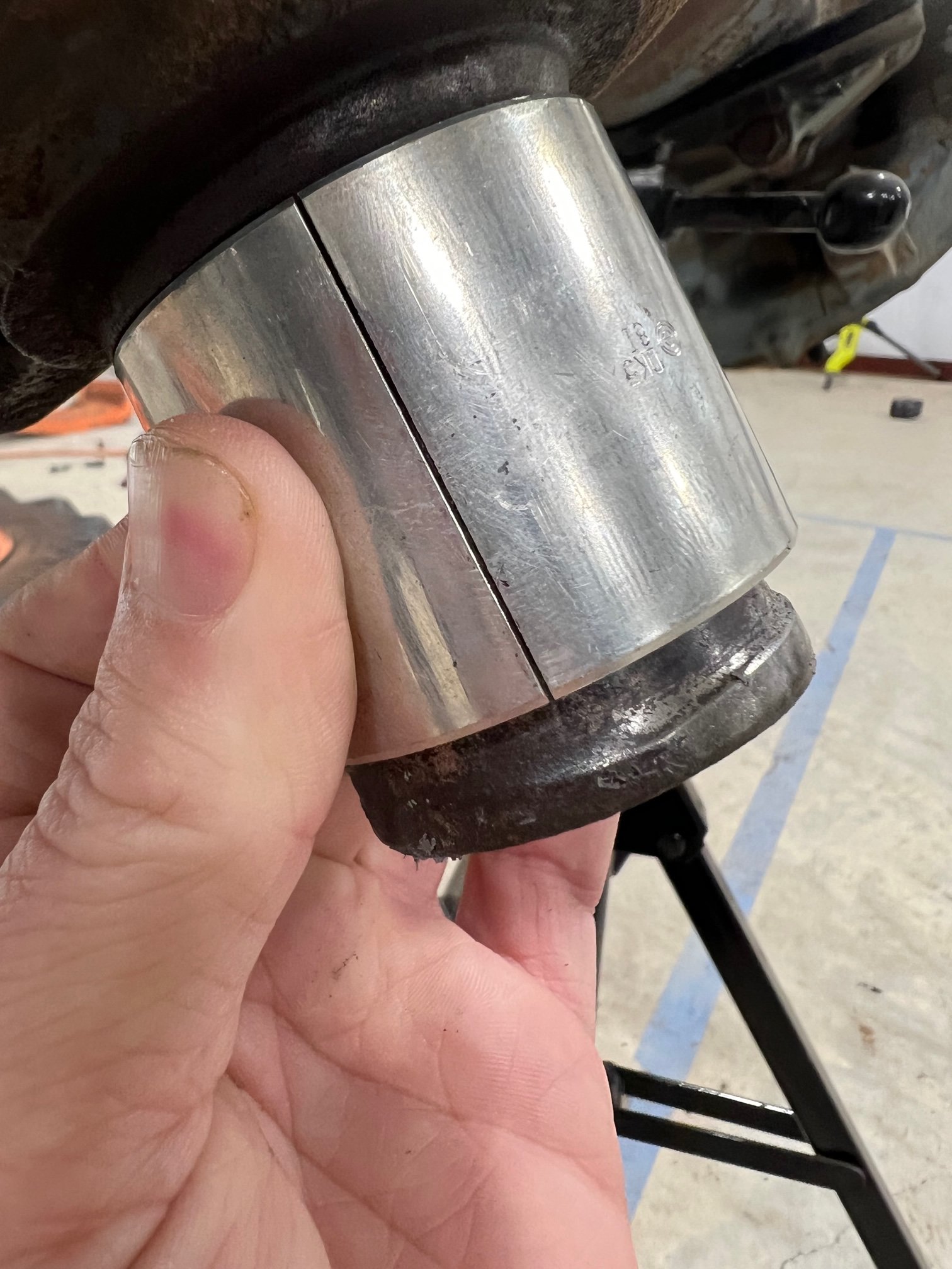

Your idea on the sleeve got me thinking if i cant find one, I may be able to just have these guys make one to the max current OD of the boss, to the correct ID of the new bushing. Then JB it in there. That’ would help it be as centered as possible, and got to be a little more cost effective than 2k per side. Hell, I could do that in a couple hours with a lathe and a piece of round stock.

Thanks Dan. I think I’ve jettisoned the secondary bushing idea. It’s hard to describe in text, but initially I thought some sleeves (should have used that word instead) may be easier to use for the build up of the boss, than using the new bushing. Because the new bushing is only about 60% of the total length of the boss. I’ll post up pics if I ever stop drinking coffee on the porch. 😜

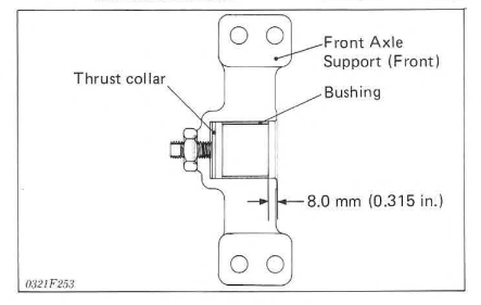

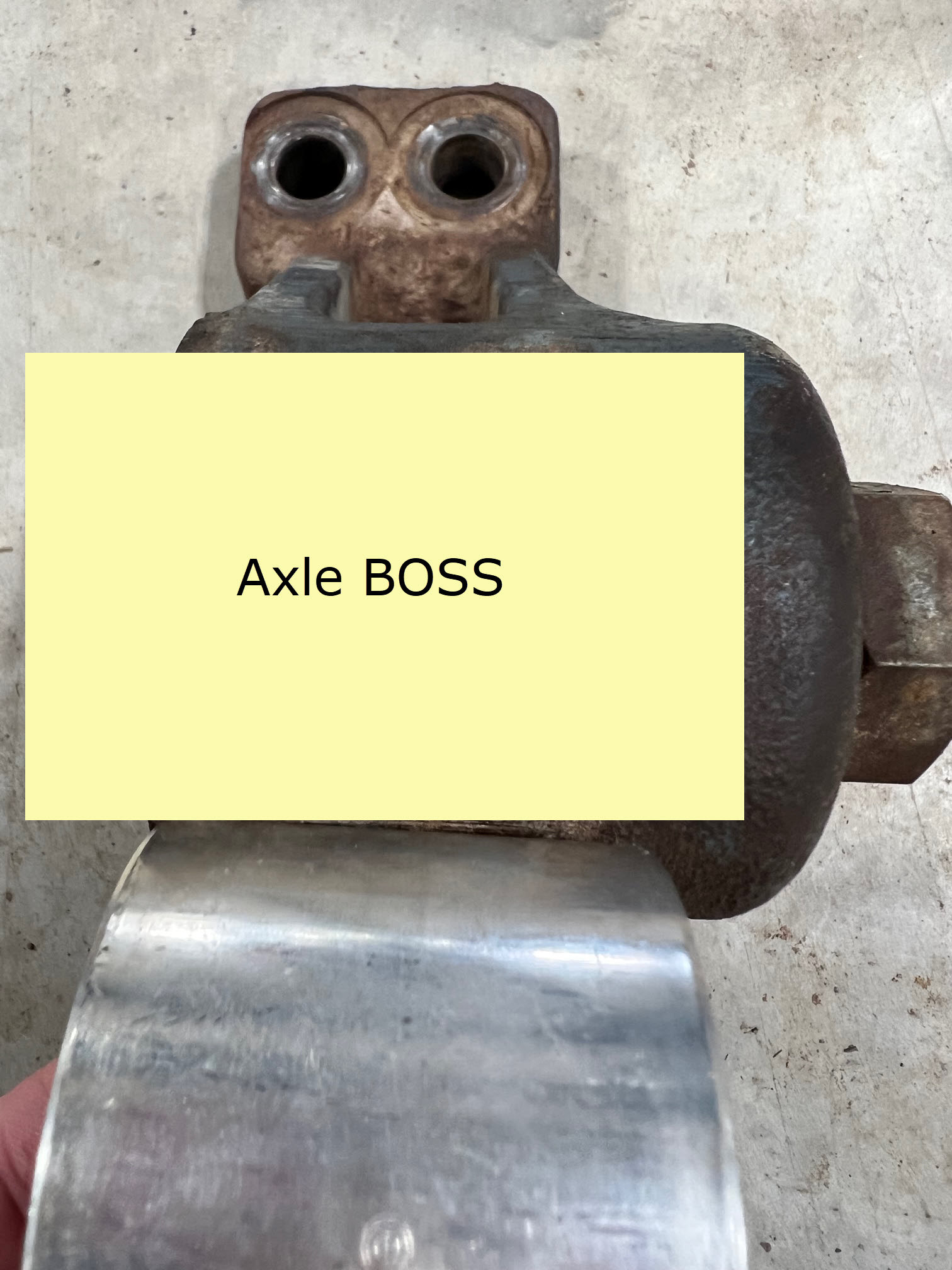

Ok, tell me where I am thinking wrong on this one.
The axle boss goes into the axle support housing, all the way through and past the busing until it hits the thrust collar and the lash adjustment screw. So the bushing is not intended to be as long as the boss, and since it is shorter, if the wear on the boss is not brought back to spec, the axle housing and bushing will fall right back into that same wear groove.
This is roughly where it rides on the boss.
IMG_1454.jpg So, my two options (according to the awesome people on here) to bring the boss back to spec diameter are to have someone weld and turn down, or I use the new bushing as a form to fill the wear spots with JB Weld.
I had considered using a sleeve (as @PoTreeBoy had pointed out) the length and proper factory OD of the boss and epoxying that in. So it wouldnt really be 2 different bushings, just a fixed sleeve, riding in a bushing. It would go into the housing, through and past the bushing. The issue was, no one makes a .010 sleeve that length. max I found was about half the needed length.
The housing seems fine, so I'm not sure I understand why I would want to bore that out.
Hope this helps?
View attachment 102511 So, my two options (according to the awesome people on here) to bring the boss back to spec diameter are to have someone weld and turn down, or I use the new bushing as a form to fill the wear spots with JB Weld.
Hope this helps?
