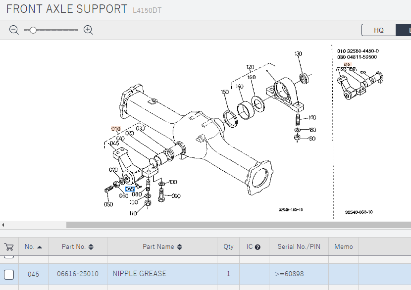

If it were mine, I would want to get it fixed, but the size of the casting would be problematic and expensive.
I don't think the amount of wear is such that it couldn't be safely run like it is for many a year.
just getting rid of the slop because of the failed trust bearing will help tremendously. There isn't supposed to be a hole in the trust collar.
There is a home grown solution, the would be to build up the wear with JB weld using a new sleeve as a form.
As far as the support goes, on the right was early support casting that didn't have a grease zerk and just an O-ring seal, and on the left was the newer support casting with a grease zerk and a lip seal.
I don't see why you couldn't drill and tap a zerk into it if already not equipped.
Interesting. Shoe polish the inside of the new bushing and inject some JB in there.
I’ll call around tomorrow to see who does what for things like this or kingpin sleeve work etc just to get an idea.
need to get the bushing on order anyway so some things to consider.
I was wondering about the hole in the thrust collar. I’m assuming it wore thru from Parts 50/60/70 which seem to be how the forward/rearward lash / play / pressure (correct term?) is set for the axle to sit between the two axle supports? I have a note to look that procedure up in the wsm as well.
36,493
11,273
Yes your right, the bolt wore a hole through the trust collar.
And yes it takes out the front and rear lash.
