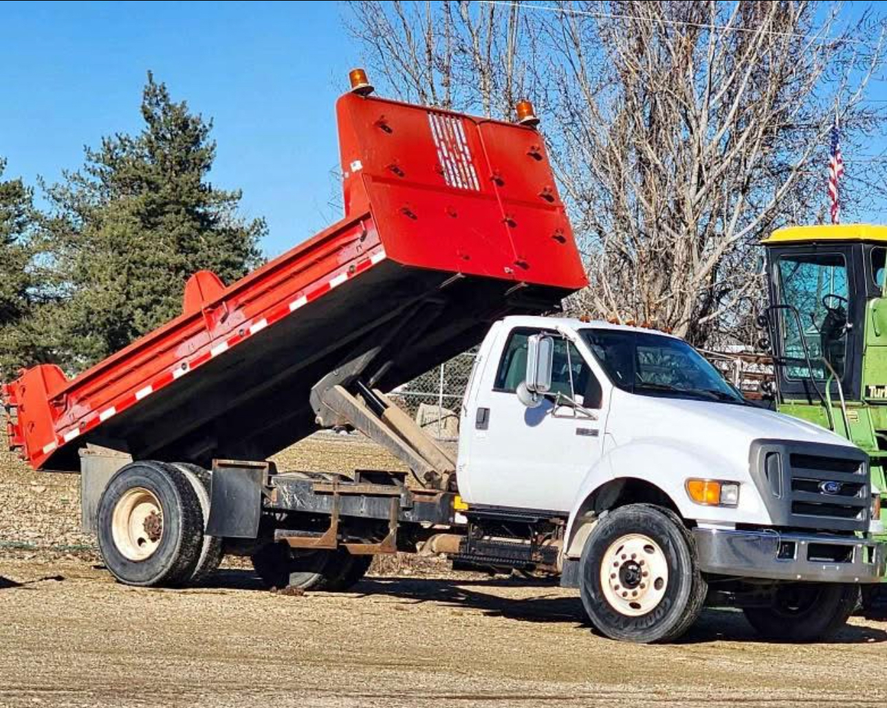

My good friend is out of town on a work trip to Dallas, TX (pilot for a billionaire) and since he's in a hotel for a week and probably bored, he sent me a bunch of dump truck adds from Facebook (which I'm not on). The one that looked promising is a 2010 F-750 dump truck with the 6.7 ISB Cummins engine, 7-speed manual trans and 54k miles. A DPF delete only requires a downpipe and programmers/chips are available for this engine. It's dirty and has some flash rusting on it but overall a decent truck. It's hard to find the specs on a 2010 F-750 it seems.
This is a good option to add a gooseneck hitch to a dump bed. A well would need to be made in the bed with a removable plate to access the ball that would be connected to the frame. Shouldn't be too hard to fabricate and weld up a nice gooseneck receiver that adds to functionality while taking nothing away.

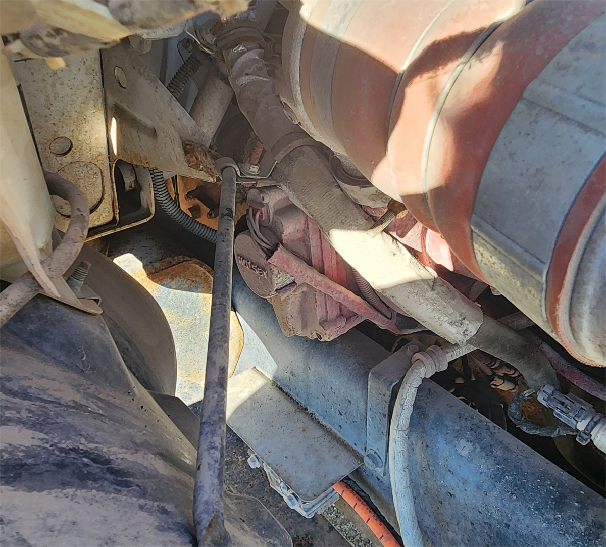

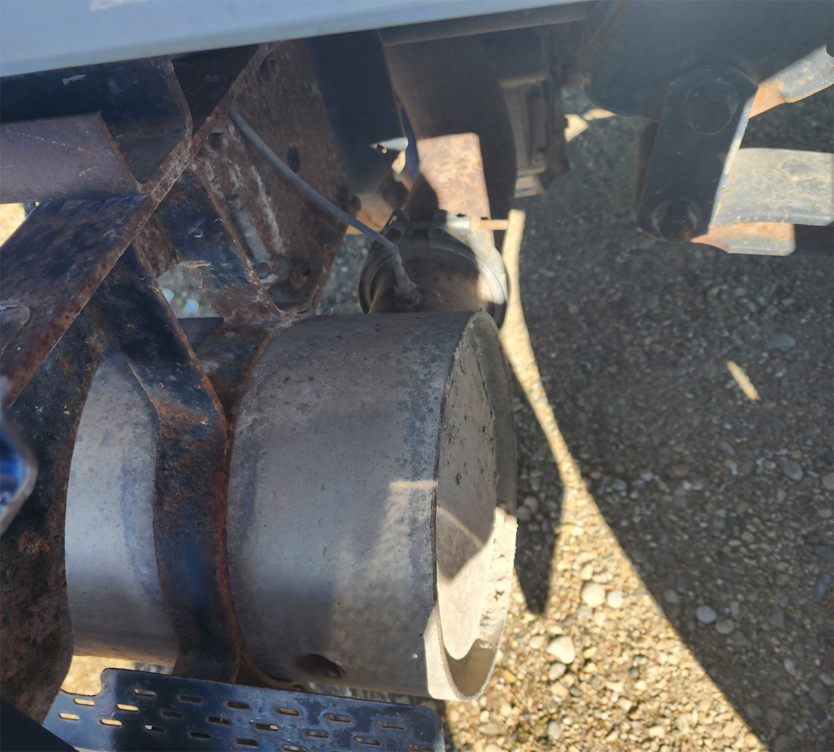

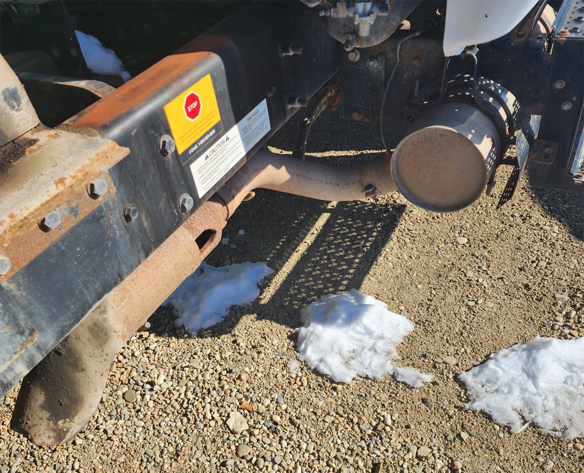

The seller of the 2010 F-750 sent me some photos of the exhaust system yesterday. He wasn't sure if it's a true DPF system or a catalytic converter.

I really appreciate the feedback, and every comment and suggestion helps with the decision making process.

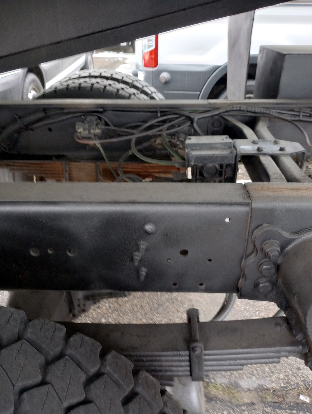

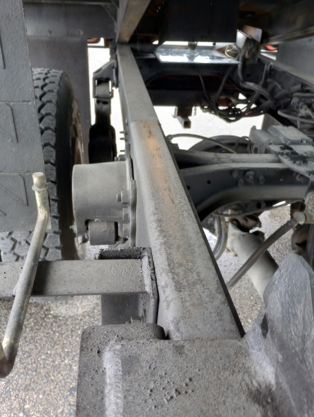

Yesterday afternoon my good friend in Boise, ID was able to stop by the dealership selling the '01 F-650 with the 5.9L Cummins engine. As some of you here suspected, it was a case of a 5 gallon restoration job where the dealership has tried to make the truck look a whole lot better. Looking through the photos that my friend sent me it's obvious that they painted the areas that they could easily get to and are trying to conceal the true condition.
For the casual observer the frame appears to be in very good shape, but the undersides of just about every bolt and any surface facing the ground is covered in rust. Not saying that it's a bad amount of rust, but it's there. The bottom photo isn't particularly well focused, but look at the inside of the rear leaf spring stack on the driver's side.
My friend also took a video of the truck while it was running but it'd give a NASA astronaut motion sickness if they watched it.
So the bottom line is that this truck is no longer on the short list.

Doesn't look terrible from the photos for the vintage, but in obviously is bad enough to make a hard pass. Makes sense.
Hope you find something that works for you.
