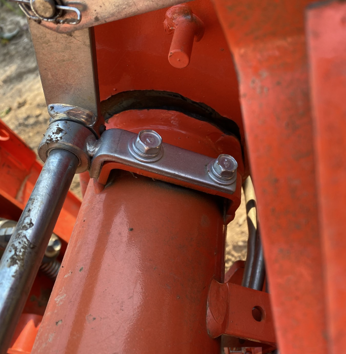

That's an obvious manufacturing defect that I bet is on a bunch more loaders, they're just not used hard enough to break that.
I agree and the fact two identical failures showed up here at the same time proves it.

I don't disagree that the weld is very poor but if the tube had been installed through the tube it would be substantially stronger even with the rotten weld job.
Based on that line of thought would you agree the repair would be improved by adding a plate? After weld bead has been ground off a plate with hole slides over tube then welded to tube and frame.

re: thru hole vs butt. I don't think there's enough 'meat' in the lower section of arm and the reenforcement plate to have holes in them for a 'thru hole' design. Not only would the tube be close to the edge, you have to line all of them up and weld on both sides. Those extra steps, while producing a stronger joint aren't needed when you consider the light duty use of the frame.
The welds weren't deep enough ( penetration). Not enough amps ? Bad wire ? Not clean steel ? I don't know. What I found interesting was the amount of RUST on the 'inside' of the frame.
If I hadn't had my neighbour do the welding,I'd used my buzzbox and 7018AC rods once I got the two pieces cleaned,perfectly lined up and clamped down.
I was typing that out but I just dont have the data as to how many people use the bucket for heavy lifting at what % of run time to conclude my theory, lol. All I know is I use the loader 80%+ of the time the tractor is running, in piles of dirt (heavy lifts). After that comes the backhoe, then she goes to bed.
I too was perplexed about the NOT through cross bar.

I was traveling at a high rate of speed in the woods. I rounded a corner which I thought I would make. The mud sent me sliding on a crash course into a tree. It as I hit the tree, i could see the boom twist and you are correct, the round cross pipe came off the right cross arm. Factory defect, with a touch of slamming into a tree?
OBVIOUSLY, NO Penetration !!!!!
The joint may have been stronger; a weld of that quality would probably still have cracked.
A hole that large in the loader boom may compromise it's strength though. And the boom is probably more important than the crossmember joint.
Considering how absurdly thin the joining metal actually was, how long it held out for, and how many other unbroken loaders potentially with welds like that, that joint with a proper weld is probably just fine. :)
Not to mention if you look close it looks like there actually is a recess in the boom for the crossmember to seat in.
Loader frames are robotically welded.
That's even more comforting.
A machine consistently did a crappy job on god knows how many loaders, until someone finally noticed and adjusted it, if they ever did.
It's no good without penetration.
