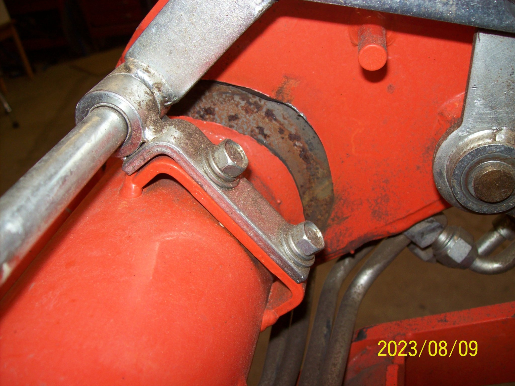

YES Factory defect !!! Same as mine. Local dealer had never seen it before. It took 5 YEARS(1100hrs) of USING my loader to finally have the two pieces 'part ways'. Welder said 'defect' and he has enough welding certificates to wallpaper a house !!! The loader frame is about $2600 Canadian, last year.
It took the welder less than 2 hours to PROPERLY repair the joint and me 4 to reattach all the hoses and other bits and pieces.
I wrote a short email to Kubota Canada, nothing NASTY, about the situation, 2hrs later local dealer infomed me my account had a healthy input! I asked was it Corporate Coins, or 'dealer dollars' ? Andrew said corporate ,so I said, That I'm OK with. If it'd been dealer dollars , I would have returned them.
Curious, do you have the serial number of the loader frame ? Be interesting if yours is close to mine !
so.... does MY picture look 'familiar' ??

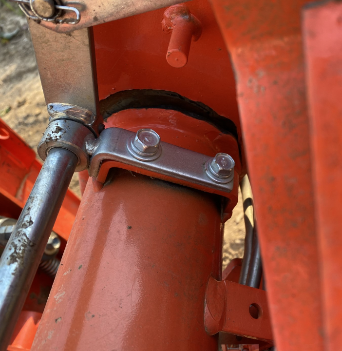

Nice! :/
Too familiar, brought a tear to my eye!
What number is yours? Can I use you/yours as an example when I write a letter? Very odd, Mine is 2 yrs and 6 months old with 907 hours, almost the same hours.
