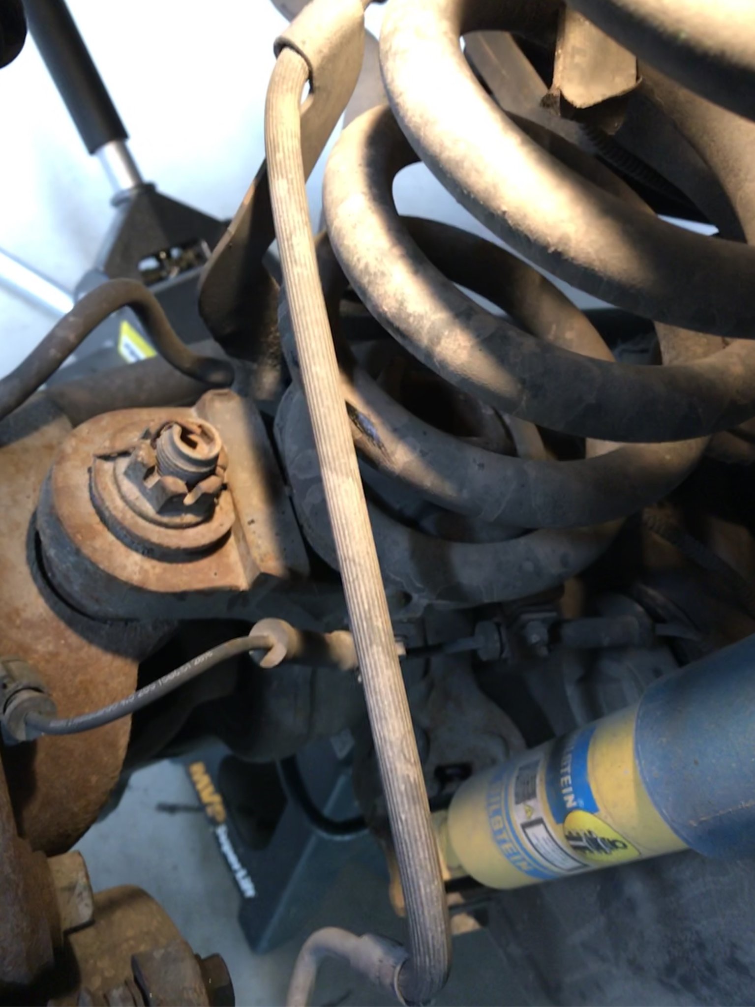

I had a sticking caliper on my F250 and thought that the Ford warranty should make the repair. They said that it was due to rust and I would be charged over $700 to repair the front brakes. I said that I would repair it myself and found some very light rust that didn't harm a thing and the sticking was simply dry pins. In this photo you will see that the skilled Ford technician bent the hard part of the brake hose to get at the bolt with power tools and then left it clothe lined across the coil spring where it could have failed at any time. I have to do absolutely everything because of the nutjobs in the industry.

Damn! That's very disappointing for sure, but once again reminds me why I prefer to do all my own maintenance and repairs.

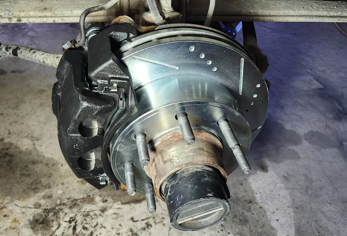

I finished the front brakes this evening and will get to the rear brakes early tomorrow. Many of us here have done plenty of brake jobs over the years and they're probably one of the easiest jobs to tackle on a vehicle.

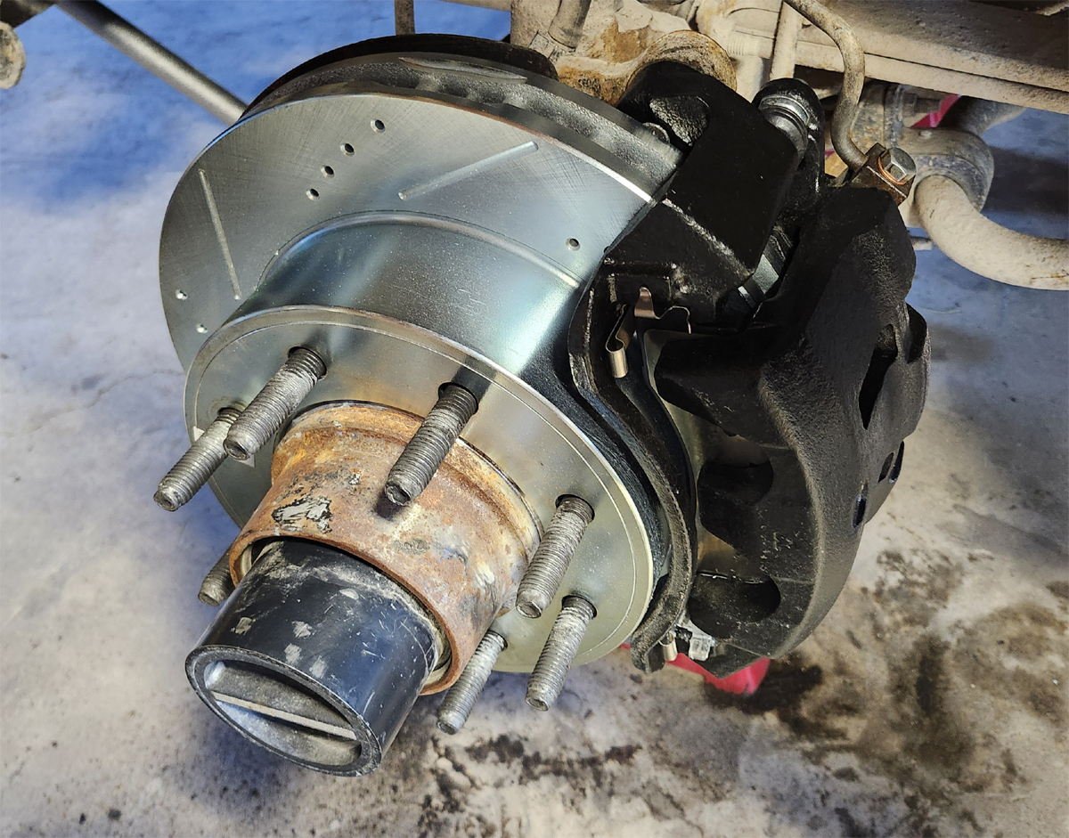

I finished up the installation of new rotors and pads at all four corners yesterday. I decided not to replace the parking brake shoes for three reasons. First, there appears to be enough pad material if the Ford manual spec of 1.0mm (0.039") above rivets or backing plate is to be believed. Second, replacing those shoes requires the axles to be pulled and I don't want to deal with seals. And finally, a new set for the rear is $106 and it doesn't seem like money well spent at this point.
I cleaned all the important parts, installed new rubber boots on the caliper pins, and greased the caliper pins and every other part of the caliper and pads based on instructions with the brake kit.
Now I'm just waiting on the Motive brake bleeding kit to show up so that I can bleed the brakes.
Back right.
Back left.

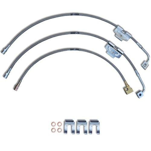

I've checked the rear brake hoses and have confirmed length and ordered a set of brake hoses from KLM Performance. I do a lot of towing and 22 year old brake hoses might not be the best for that application. I installed stainless steel brake hoses on my Jeep decades ago and it improved braking, not to mention the fact that the braided lines are more robust in off-roading situations.

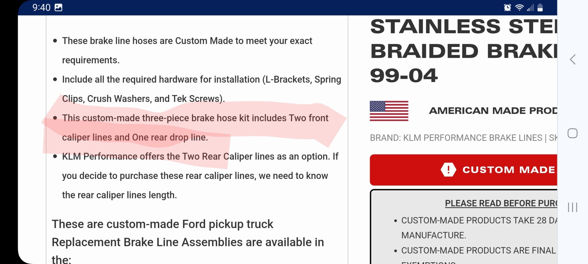

Does that set of lines include the jumper hose from the axle hard line to the caliper?
8,356
11,752
@Fordtech86 is right, and I ordered the complete set with the clear stainless finish. I'm not into all those fancy colors. My Jeep has the clear stainless steel braided hoses which look good decades later.
Oh, I also added the +2" lift option for an additional $3.75 so the total cost with UPS ground shipping was $330.51. Not a cheap upgrade, but worth it to me. The ability to stop is probably more important than the ability to go. 😂

Braided stainless steel brake hoses have always been expensive. I remember installing them on an Accura Integra back in the mid '90s and they weren't cheap then. I just remembered that the braided hoses on my Jeep came with the Rubicon Express 3-1/2" lift kit that I installed.
Given that a complete set of Motorcraft brake hoses costs around $160 or more and doesn't include the line from the axles to the hard lines on the body, these KLM hoses aren't ridiculously expensive.

Oh, I know they aren't cheap. 3 motorcycles, 2 Jeeps, 2 BMWs and 2 VWs have them. I was talking about the $94 for just the jumper hoses on the rear axle. That's the proud part.
The $94 is for the rear caliper hoses and the hose from the axle to the hard line on the frame, so that's three hoses.
The description on the base set says it's two front lines and one drop line (frame to rear axle). I assumed the $94 caliper lines are from the axle hard line to each rear caliper.
Ooops ... you're right ... sorry about that! The front includes the frame to axle hose, so five hoses in all. It'll be a while before I receive them based on their published lead times. It'll be a good test to drive around with the new rotors and pads and a properly bled brake system, and then to upgrade the brake hoses and see/feel how much of a difference it makes.
